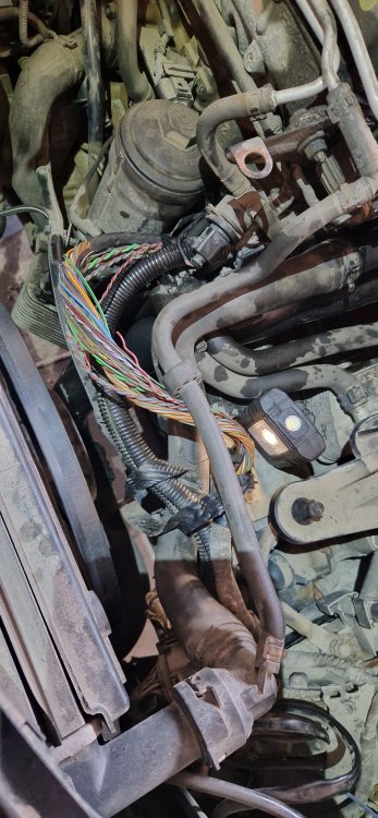

I have a fault code for my coolant temperature sensor p0118. From what i've read it seems to be a normal fault to become faulty. Now to my problem, where the heck is it? I uploaded a picture of the engine, and another picture where I think it might be. But nothing happened when I disconnected this one. I found the intake sensor, and the temperature skyrocketed when the sensor was out.
#5
Below the Diesel pump? Thanks for the clarifying picture.
#9 is the hose from the top of that radiator so easy to follow that back

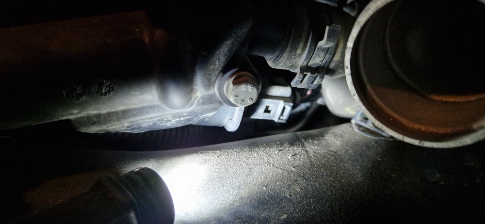

This placement is really annoying. Very limited space. I dont think I will be able to get it out without disconnecting some of the water hoses. How is this procedure supposed to be done on this BMM engine? There is a hard plastic housing in the vicinity of the sensor. I guess its a gasket between the engine and this? It would be much easier to replace if I remove this. But I might get away with just disconnecting the house above the sensor. How have you done this procedure, need a little help 😅
AFAIK the sensor is retained by a U-clip and seals with an O-ring.
Slide the clip out and pull the sensor out being careful to retain the O-ring, not necessarily for reuse but to keep track of parts.

The sensor is easy to replace. Getting
the plug detached from the sensor is a bast*rd. I broke the wires on mine. If changing the sensor change the plastic housing also because it will leak in the not to distant future

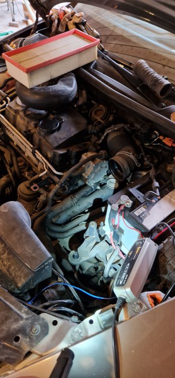

Well in this case even after removing the airbox it looks almost impossible to change it. There's a metal pipe that takes preheated air into the airbox that's really close to the sensor. Best way looks like draining coolant, remove the housing and change the sensor outside of the engine bay. I broke the tab on the connector to the sensor though... So maybe I'll put some glue or zip ties to hold it in place.

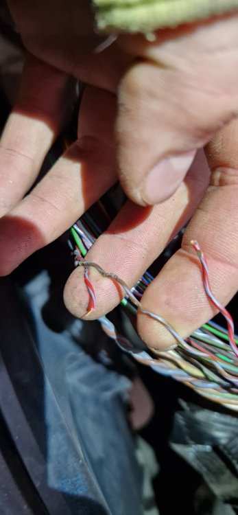

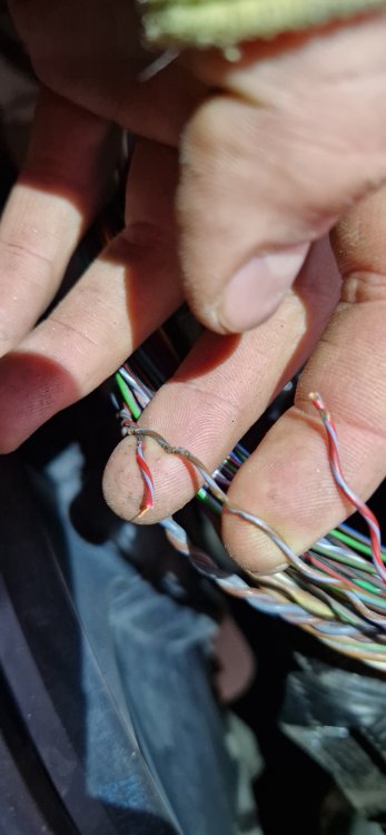

I found a broken wire. Is this the color for the sensor? Unfortunately I'm colourblind and have no chance to check what cable colour is at the sensor. I guess I could fix this and hope for the best.

Circuit diagrams say brown/grey,  and red/grey are the two wires for G62.  I think that could be what's in your picture, yes.
  • Sponsor
Red/grey from pin 1 of sensor connector finishes at engine ECU pin 52,  brown /grey from pin 2 goes to ECU pin 53.
I don't have the circuit diagrams but agree re the pictures showing those colours.  And a break like that would cause the issue.
Either way it ought to be fixed regardless of what it is.
I didnt have any solder sleeves, so I used WAGO connectors just to see if this was the issue. When I first started the car the fans started blowing but they stopped shortly afterwards, then I cleared the fault codes and it seems to have fixed it. Dont know if it was because i replaced the sensor or connected the broken wire. I had to tug a little for it to break, but it was also badly corroded. So I guess it was totally separated.
Lets see how long this "fix" lasts 😆
