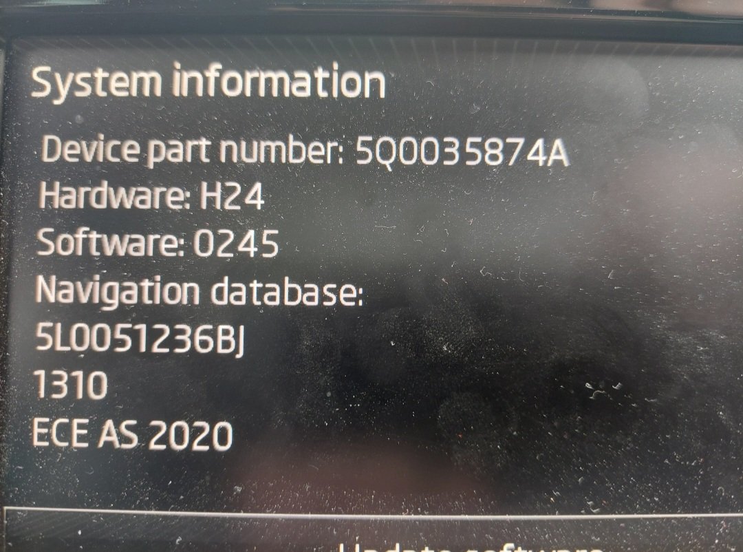

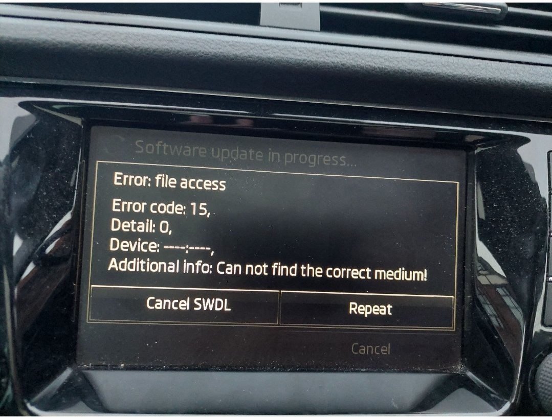

  1. It didnt work from a usb but it is working from Sd card. Thank you
  2. Any ideas. I unzipped and copied to formatted fat32 usb.
  3. Hi do you have a software update for this unit. It crashes after a few minutes when using android auto

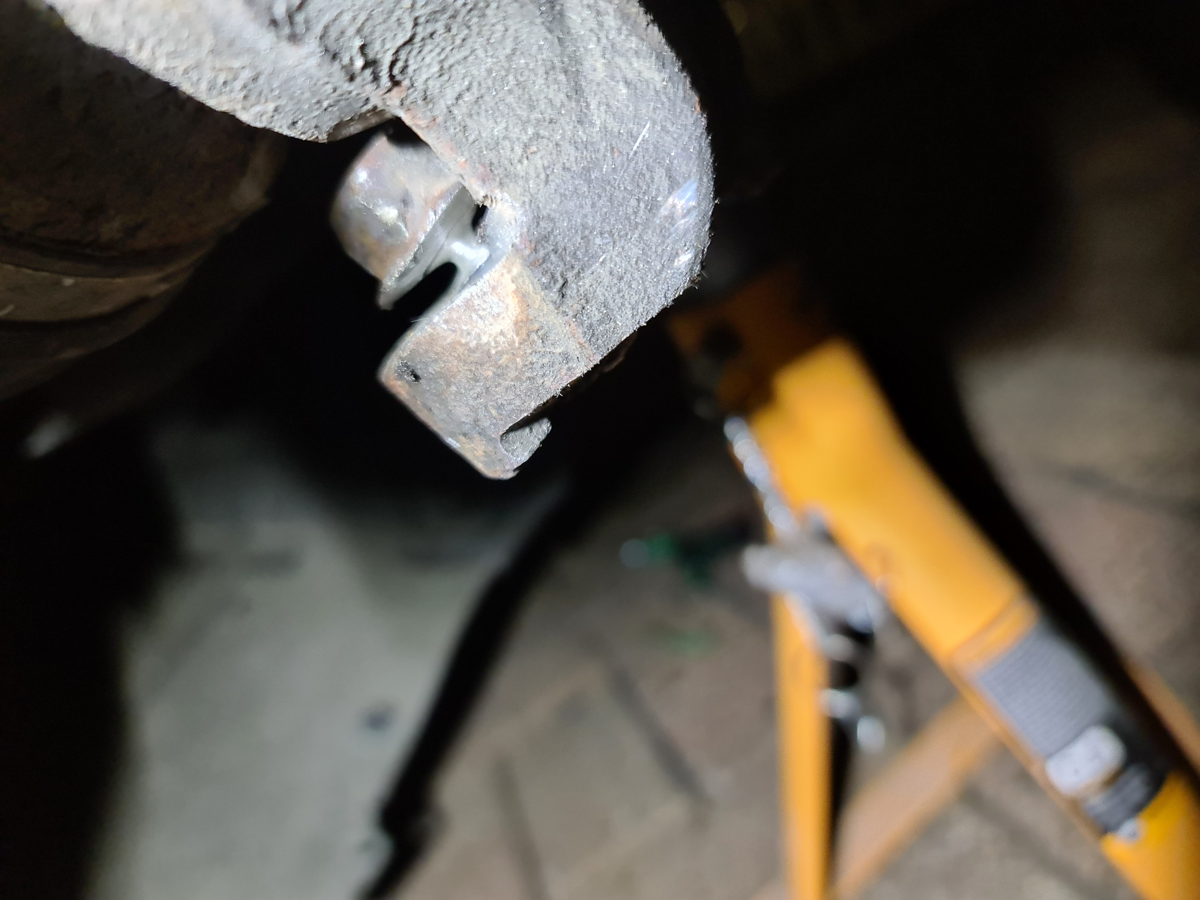

  11. Tried to do the ball joints this week. Didn't go well. The nut was seized and I didn't want to remove the drive shaft. Tried removing it with an angle grinder. I've ruined the knuckle. So I've got a new knuckle and hub on the way. Hopefully I can get the drive shaft out without putting it back on the floor as the ball joint is in pieces.

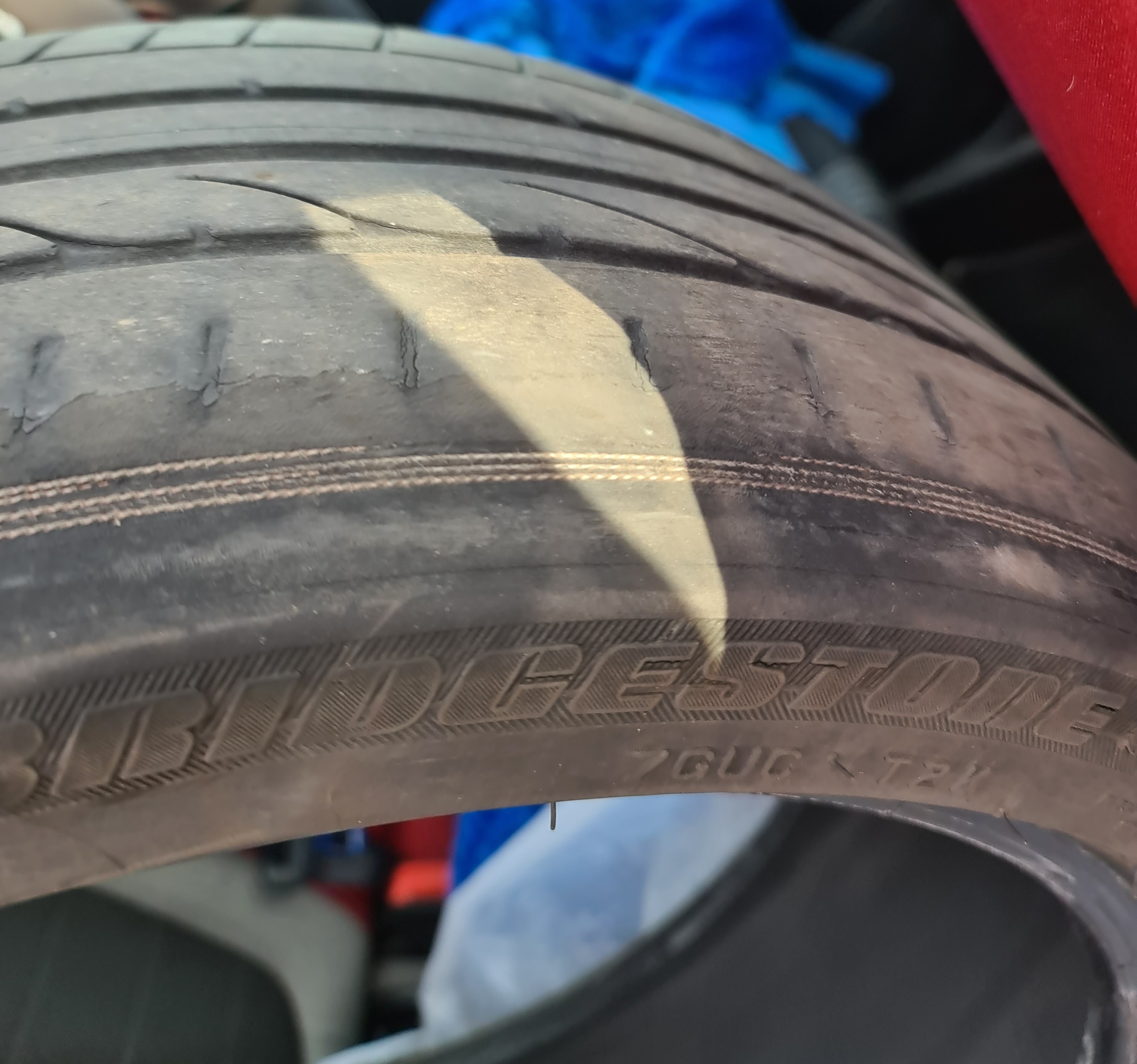

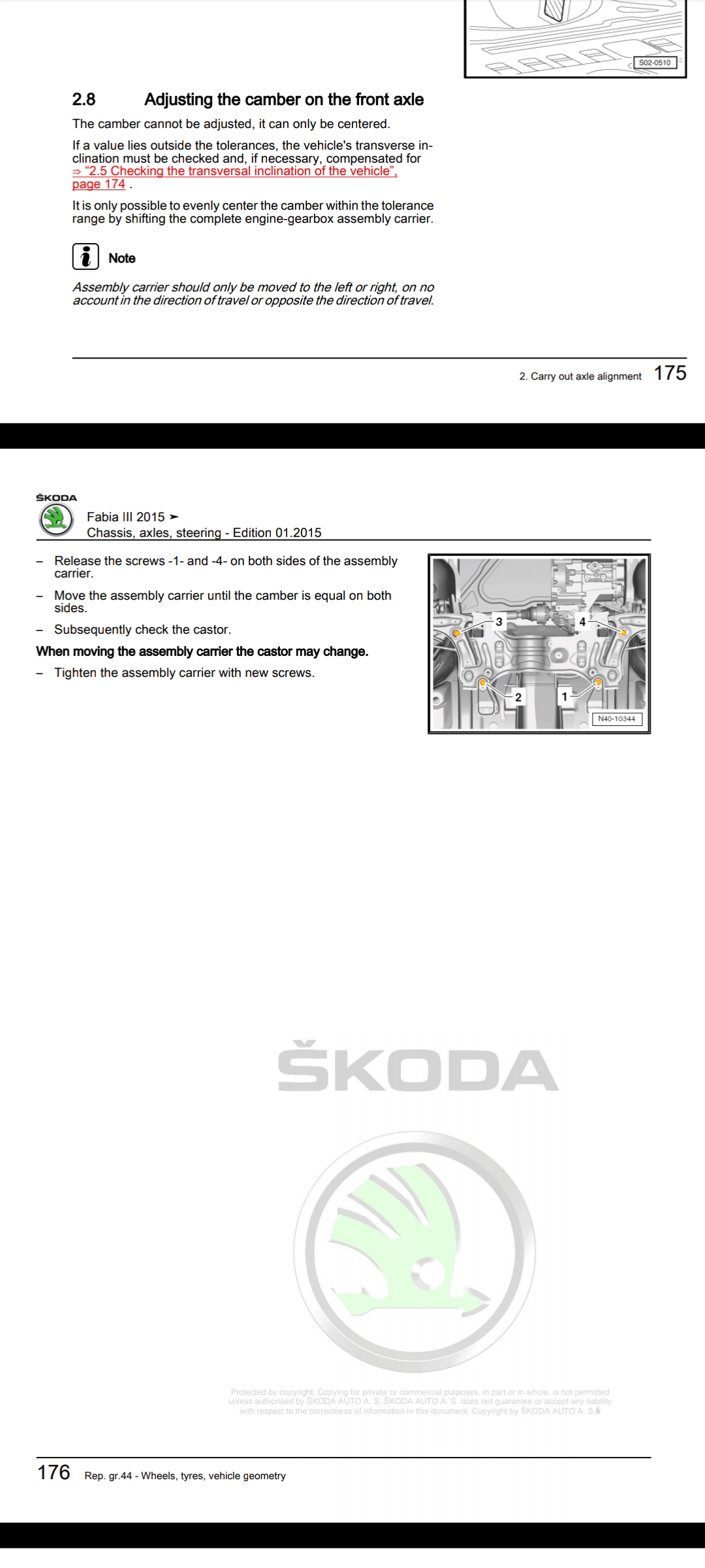

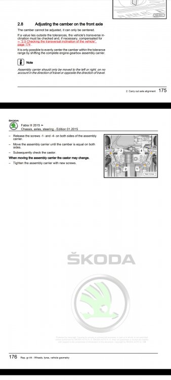

  12. I have been getting arround 35 mpg. Car went in for alignment today. It said laser alignment on their website. They only did the toe. They didn't check anything else. In the service manual it says camber can be adjusted by loosening the subframe bolts and prying it. It seems better but not perfect. Steering wheel was aiming slightly left when going straight now it's slightly to the right but not as much.
  13. Found some genuine vw ones reasonably priced on eBay. I think the tracking is definitely out.
