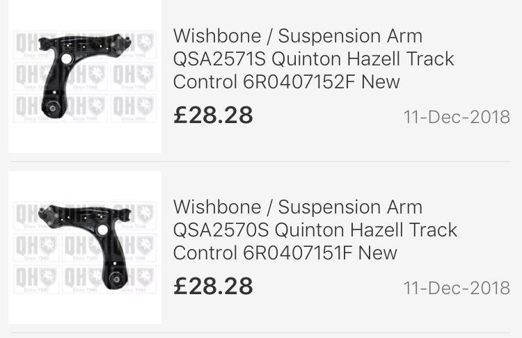

If you're up for doing it yourself, grab the bushes from your dealer, and get some wishbones off t'interwebs.
I put Quinton Hazel wishbones on mine and i'm sure they are the oem manufacturers.

How have the QH wishbones held up. I've just ordered a set as the rear bush on one side is looking quite sad. It's now squeaking over smaller bumbs. Im also going to do the ARB bushes at the same time

The Quinton hazel wishbones have served me well, still going strong nearly 2 years and 27k miles later. I found the powerflex bushes really improved accuracy and response/feel of the steering (make sure you get a laser alignment though), they didn't affect ride quality at all that i noticed.

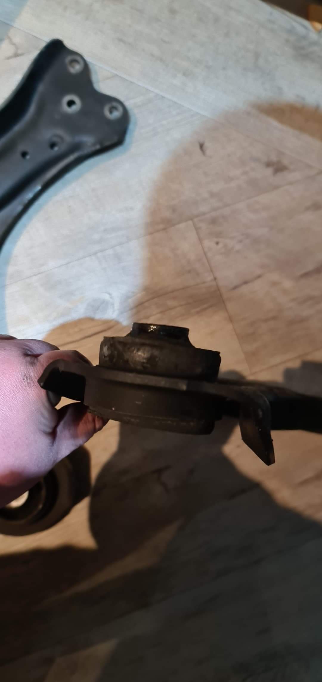

I pulled the wishbones out last night the bad side had the rubber separate from the metal ring. I was able to fully remove it with one finger. Only symptoms were a knocking at full lock. Was fine at speed😯. Luckily it didn't come apart while driving.

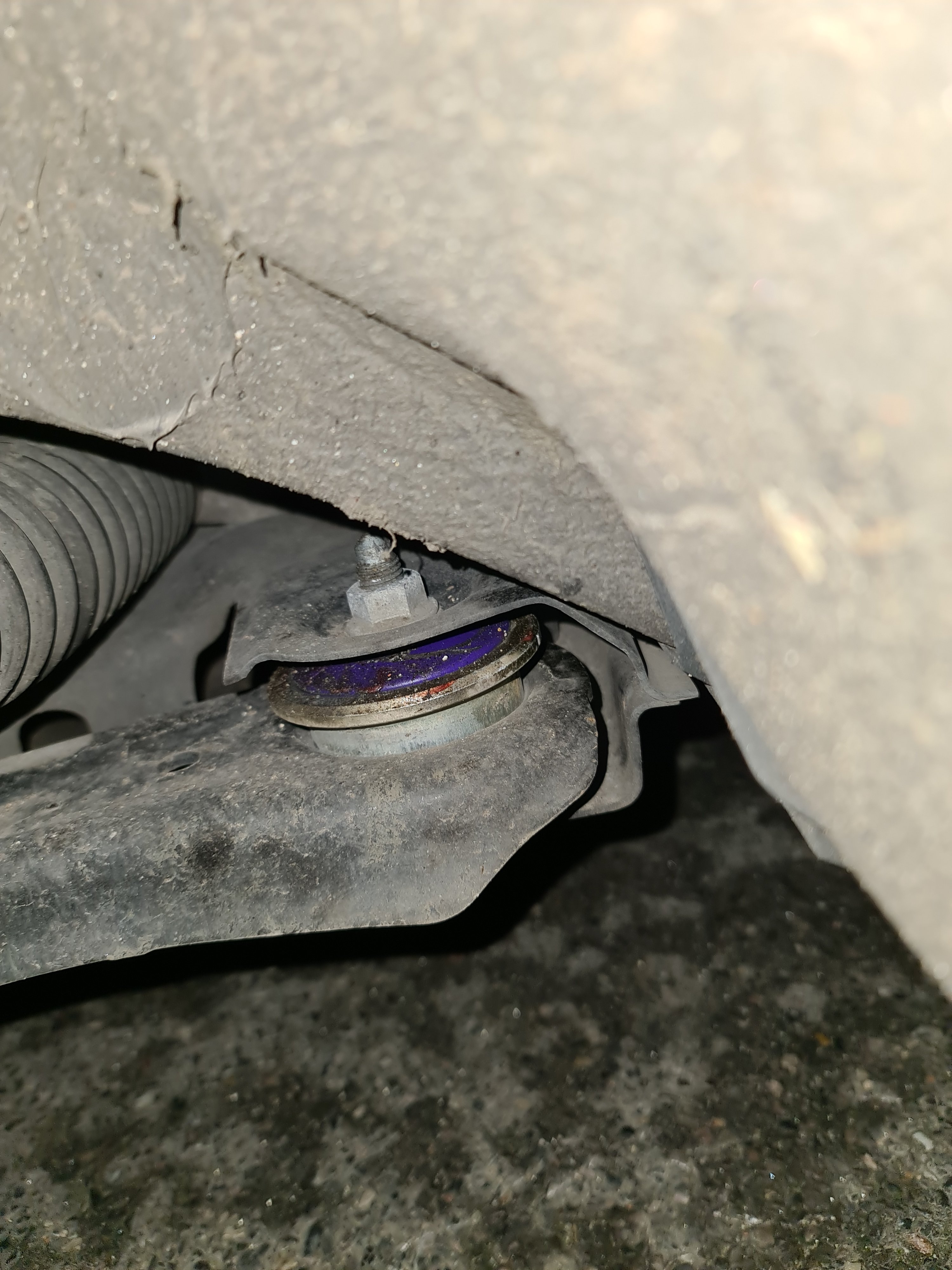

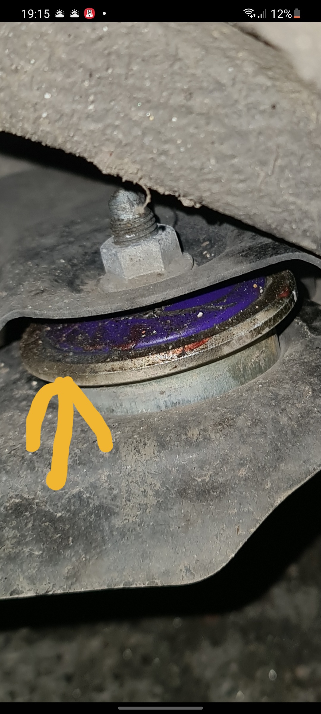

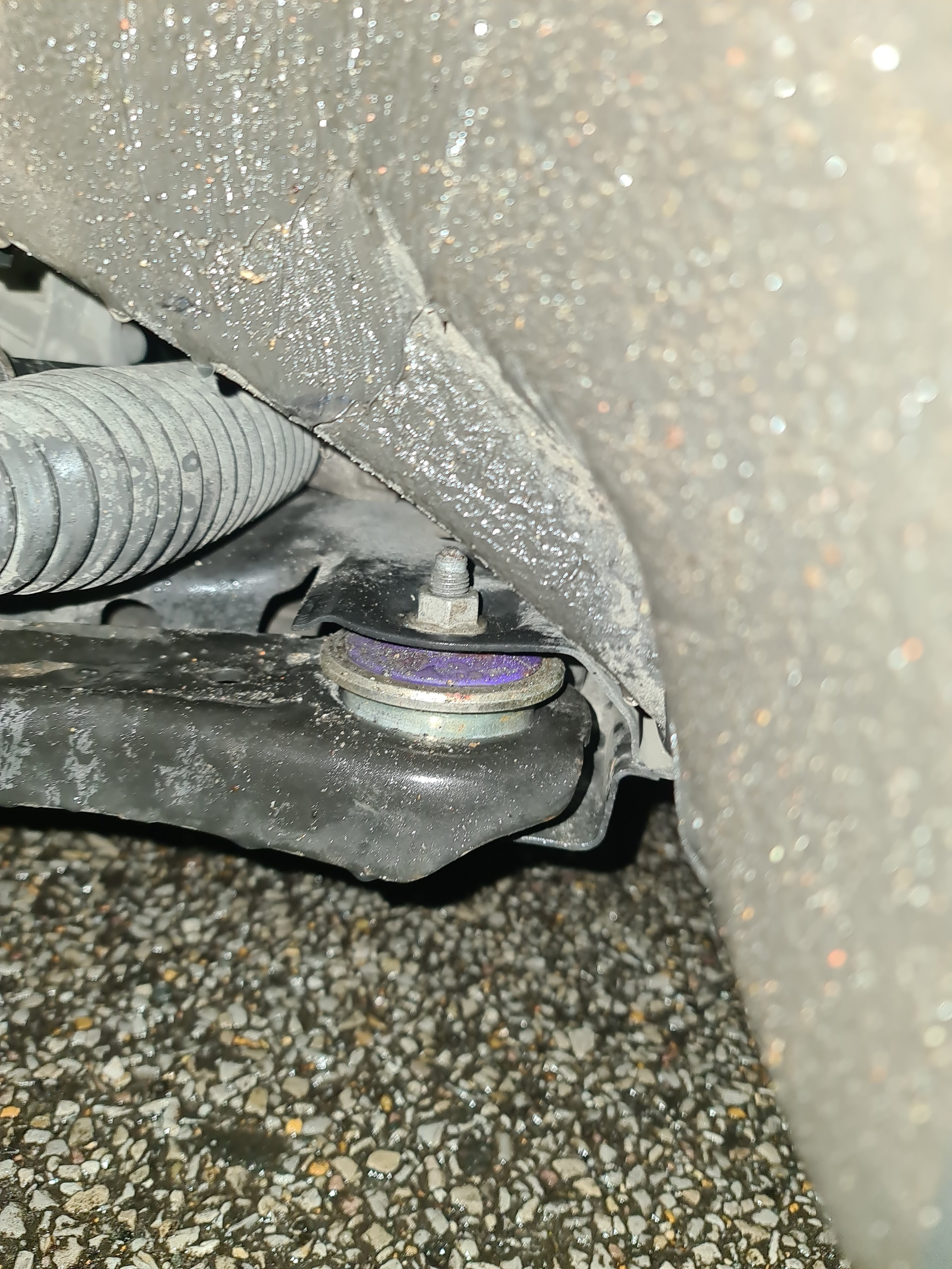

The knocking has returned. On the other side. The bushes were fully seated. the metal rings were frozen and driven in with a mallet. Then I pressed in the poly bush. Why would it come out. This is on the near side. Oppisite side to were I had problems. I've hit a few potholes on that side would that be enough.
When fitting I used new nuts and bolts and did them up with suspension in normal position. Used a jack under the wishbone
Edited by cm9876
Oh! Not much good if that outer shell can not stay down in the arm! I don't have an answer though, the usual tool that DIYers buy is for the original or upgraded Golf mounting bush, and it draws the complete original bush assembly down into the arm.

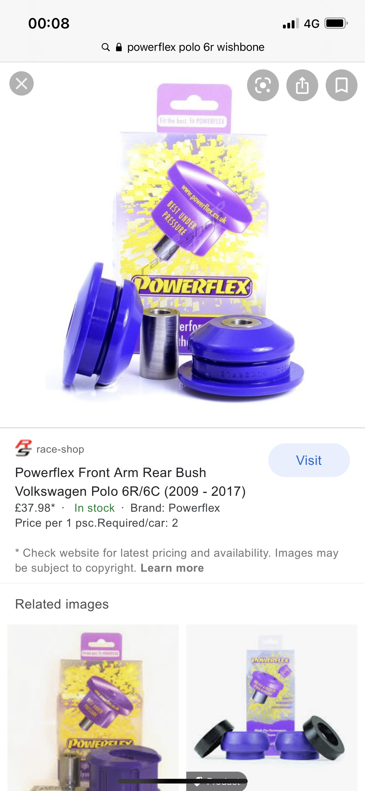

I went with powerflex bushes for this part, they're designed to lock in around the lip at the bottom of the wishbone. I've not had any issues with them popping out or any knocking.
That said though i'm going for Ibiza Cupra R wishbones with the solid rubber bushes when i do my suspension upgrades.
I've managed to get them back in. It was much easier than the 1st time though. I home they don't come out again. Do TT mk1 / R32 bushes also fit.
Are your powerflex bushes different to mine. Mine are part number PFF85-1202
This is what mine are like, it seems they've updated the design, for the worse aparently.
Ibiza Cupra R bushes fit our wishbones, or you could get the whole wishbone with the bushes already in (it's the same wishbone just with a different bush) but that's obviously more expensive.
I'm not sure if TT/R32 bushes are voided and soft like ours standard or solid rubber like the ibiza cupra r. And i'm not sure on dimensions either as ive seen some with different outer diameters on my travels through t'interwebs looking for bushes lol.
Ibiza Cupra R bushes are a definite though and you can get genuine ones for like £20 a piece from Seat. They're not a whole lot cheaper from aftermarket manufacturers.

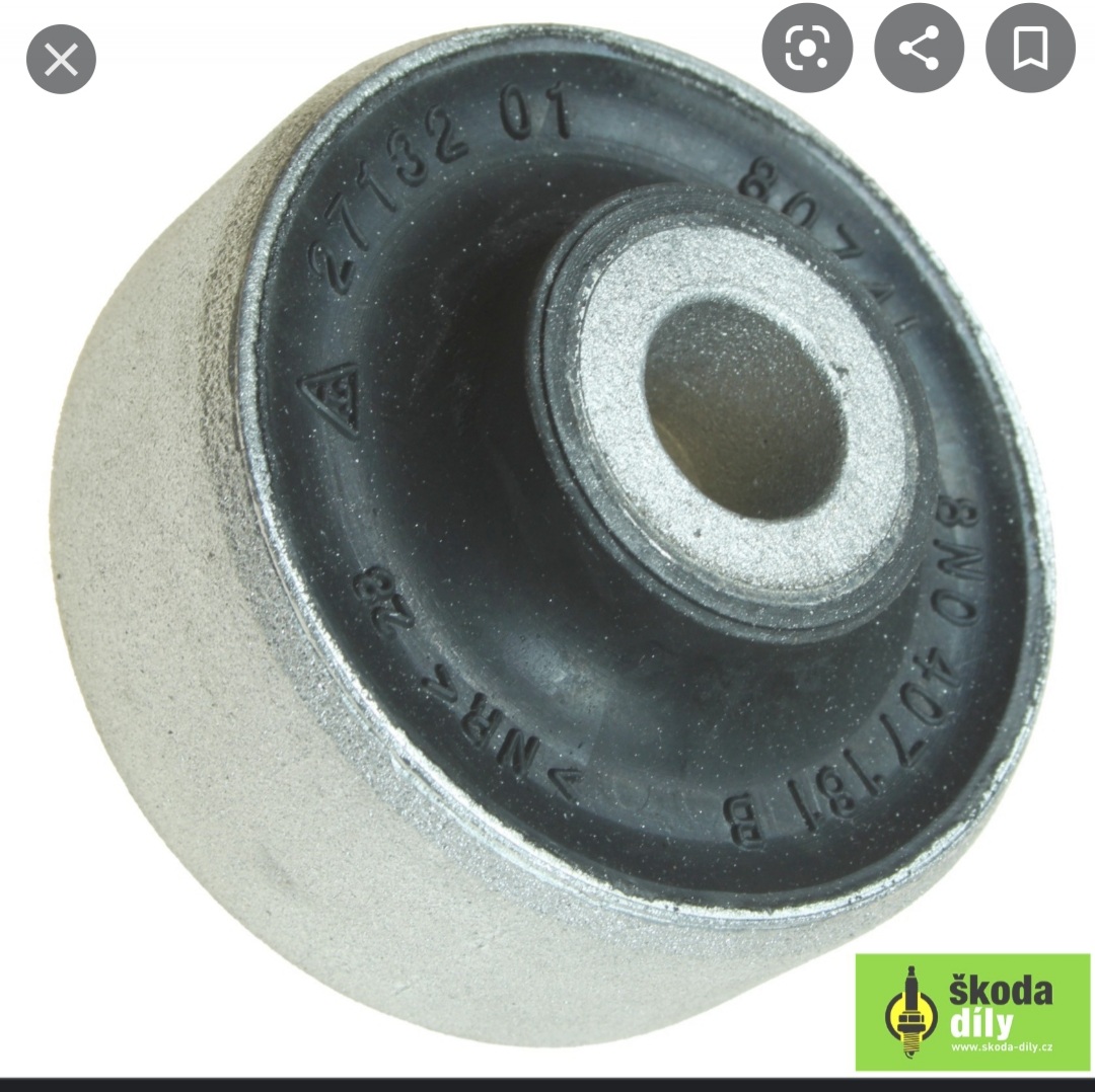

These are the TT R32 bushes according to the polo forum they fit. They were also fitted some Ibiza 6j upto 2010. They are part number 8N0 407 181B
Edited by cm9876
That's the Ibiza Cupra R bush, 8N0 407 181 B
You can get them from seat directly for not much at all (i think it was like £19 a piece or something, just ring them and give them that part number and ask for a price) or get a pair from another manufacturer for probably cheaper but possibly lesser quality.
Think I will go for them if the powerflexs pop out again. Is it better to also get an oe bush for the front bush. Would it be bad to mix poly and rubber.
