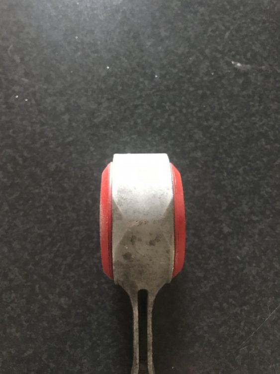

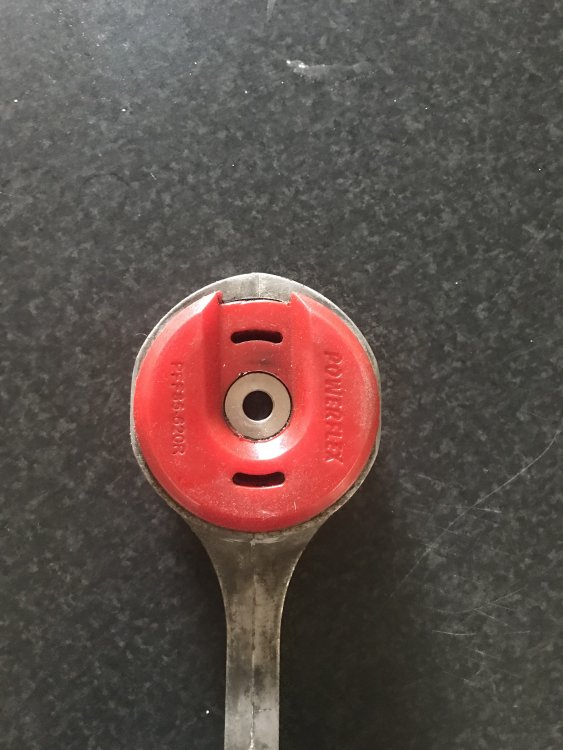

The design of the bush is quite poor, the only place the subframe is meant to contact, is the metal part in the center, but because the bush was so thick, it was clamped in there like a sandwich, effectively reducing the amount of gap between metal-metal to like 10mm, rather than 25mm from center to mount.
IMG_9988.thumb.jpg.886c677a18380a95b2b2f62428898458.jpgIMG_9987.thumb.jpg.dedc6be6b21206ee8d1e5b6c71d4ca76.jpg
I still have the red-deisel bush inside the old dogbone from my car, if anyone wants it..
