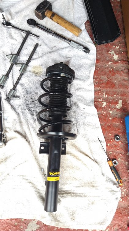

When I got the car last year it had brand new springs on so I only replaced the shock and mount and moved the spring over, I put it on the same way as I took it off the old shock, I checked the ends and they was still coated in paint so there was no broken ends. It did look abit odd shaped when I put them and the same when I was taking them off. I noticed the flattest end of the spring was at the top so I was assuming it was the right way up. It's either upside down or the wrong spring for the car, I guess I'll live and learn. This it what it looked like on the old shock

Oh bugger, it looked like it was the flattest part was the top but when I put it back on I kept them the same way up as o took them off. Guess it will be easier to get new springs fitted I was going to get new springs when I did the shocks but I've not had the car that long and they had just been replaced so I thought I would re use them. I guess it's a lesson learnt. Thanks for your help I'll get some ordered tomorrow.

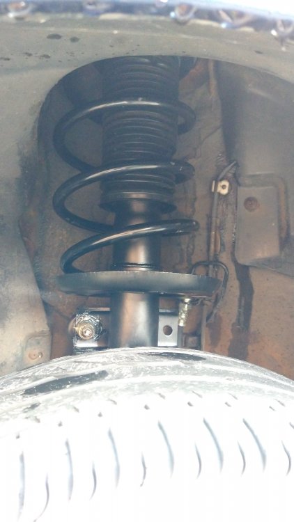

Thanks I decided to strip the whole area out on both sides and give it a good service in that area. Now I've ran into a another issue. I originally had a creaking noise when I turn the wheel which I assumed was the strut mounts. Only to find out the creaking was still there after I changed them along with new shocks. I reused the same spring and ive just got to the bottom of the creak it was the spring rubbing against the inner arch so I'm guessing the previous owner had the wrong spring fitted and now it's all fitted back on my car :s

Hi I've had an issue with creaking when I turn Ive checked everything and changed all ball joints and put new shocks and mounts in hoping it was the mount or the strut. As soon as I put it in it made no difference to the creaking. So today I jacked the car up and started dismantling one thing at a time off the steering knuckle to narrow it down i ended up with just the driveshaft and strut left on it and then I managed to find the creak and it was the spring rubbing against the inside of the arch when I turn it. When I got the car it had new springs on so I reused them as I've only done a few thousand miles on them. I'm just concerned now that if I buy another pair they could be the same or the previous owner had fitted the wrong springs on. I've put a photo of the springs on does this look like it's the wrong springs and way offset. I seated the springs properly in the groove stop. Looking at other struts online the springs sit closer to the dust boot at the back but then more spaced out towards the front to allow room for movement. If I get new springs from BBC Superfactors or ECP that say it's for standard suspension would this be the right fit. Thanks for any help
