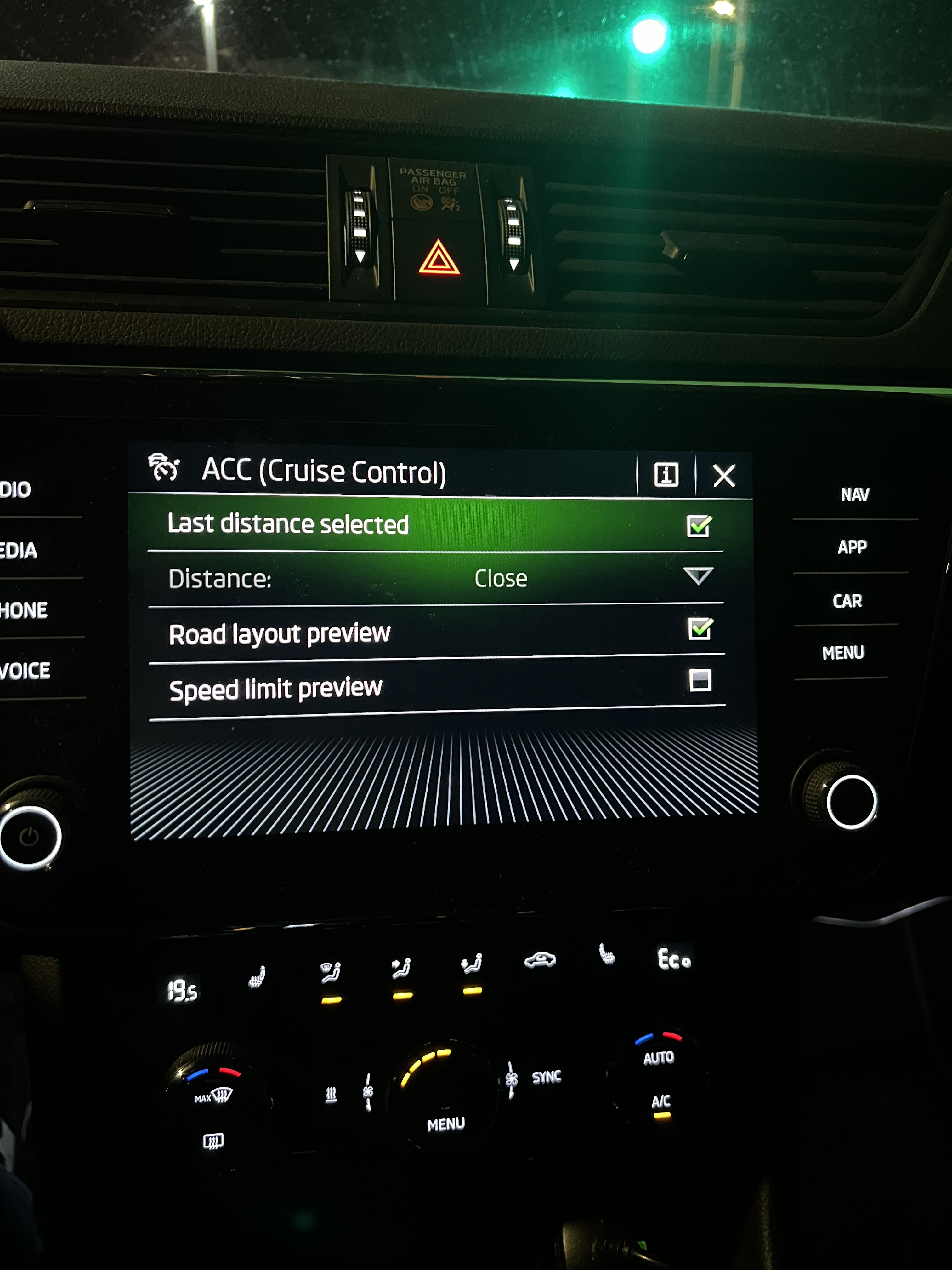

  7. You need to go to ACC and disabled speed limit preview
  8. That you can turn off and I turned that **** right off, I manually adjust the speed lol. ACC is nice for heavy traffic and long journeys
  9. That doesn't override it. As soon as you let go it starts again
  10. Hi Does anyone know if you can override the ACC when it thinks the road ahead is somehow too bendy (when it isn't at all)or it thinks you're going on an off ramp? I've tried pressing the right wheel button, holding the accelerator while doing it.
