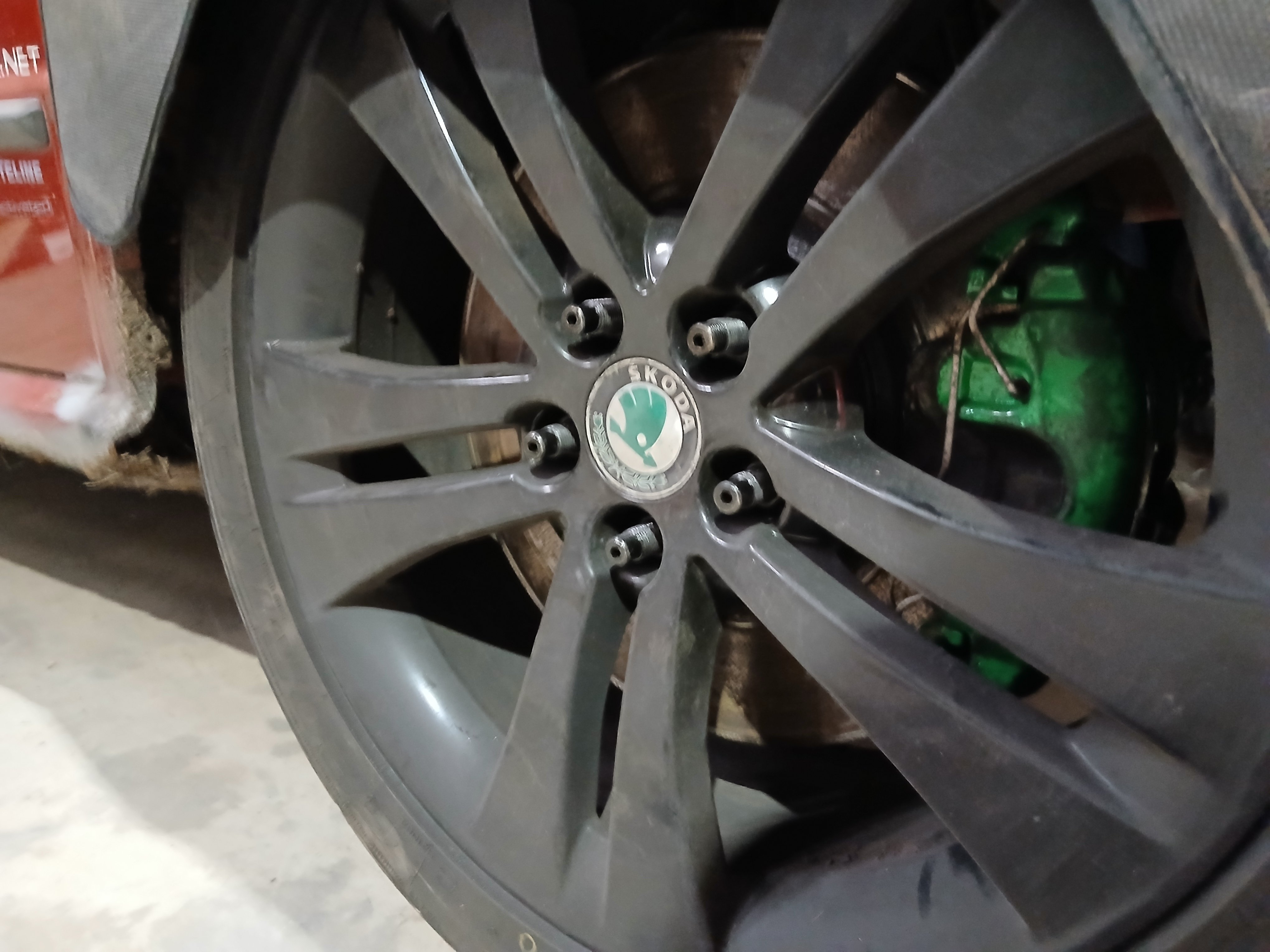

  4. Brakes are done. New Mtec Discs and Textar pads for the 312/256mm octavia setup on this. Also got new slide pins, some bolts etc all new. Don't mind the rust on the faces so much, i'd washed it and put it away Rears while working fine looked a bit scruffy Front pads were poorly. Forgotten they were mtecs own pad. Theyve been squealing this while. In all fairness to them, they did hold up pretty well in all. Took my time cleaning up heat shields and such Paint job on the calipers is good from far, but far from good Arches really need a good clean up Not actually driven it more than a few miles since, paint/coating on the discs hasnt even worn off it. Initial impressions are very good and so far quiet as can be.
  5. Brakes all painted up and done Camera is very kind to this car New rad acquired and installed, easy job but not happy having to spend for one. Used triple QX blue coolant for it. G12 seemed to be corroding some of the pipes. All bled up fine, took for a run this morning to a car show. Busy as usual but car drove great. Brakes feel very good, handbrake too is very good. Quiet too. Took it up north to fill with 99, found one station in camlough that does it. As usual much more hassle than i'd signed up for but its done. Coolant temps staying solid, even the gauge on the cluster (which read hot almost instantly before) stays solid in the middle, even though it is basically a dummy gauge its nice to have it read normal.

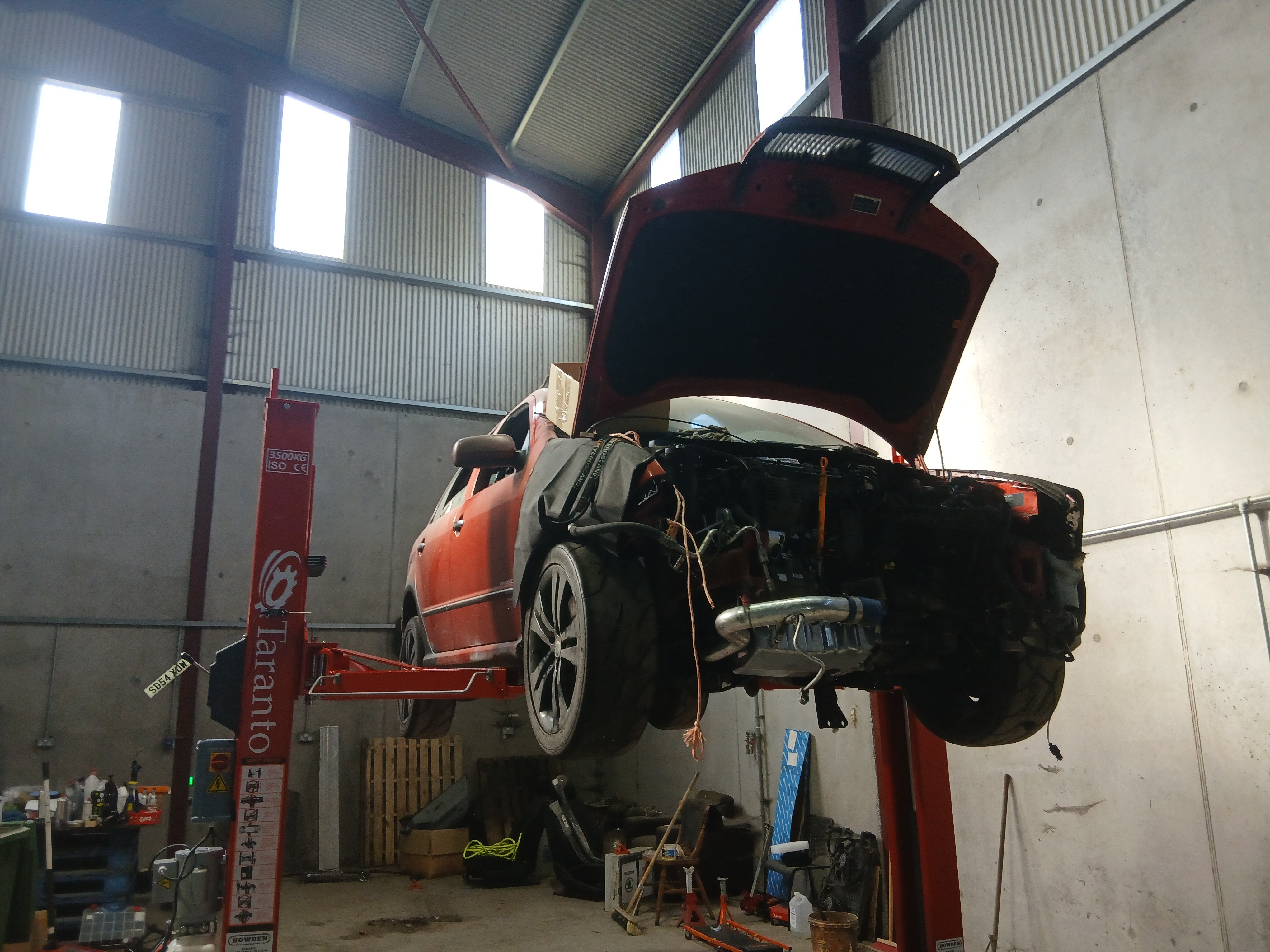

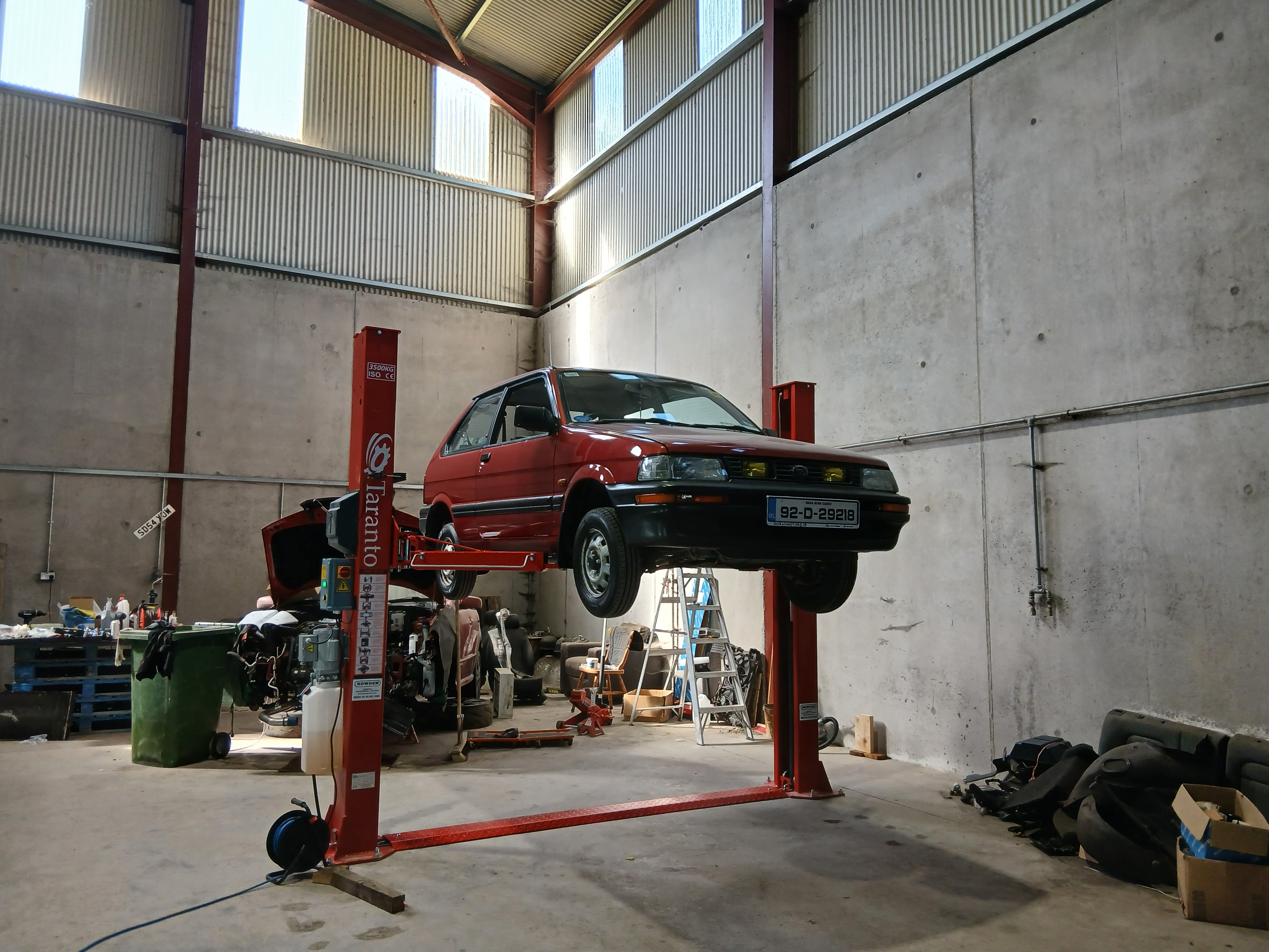

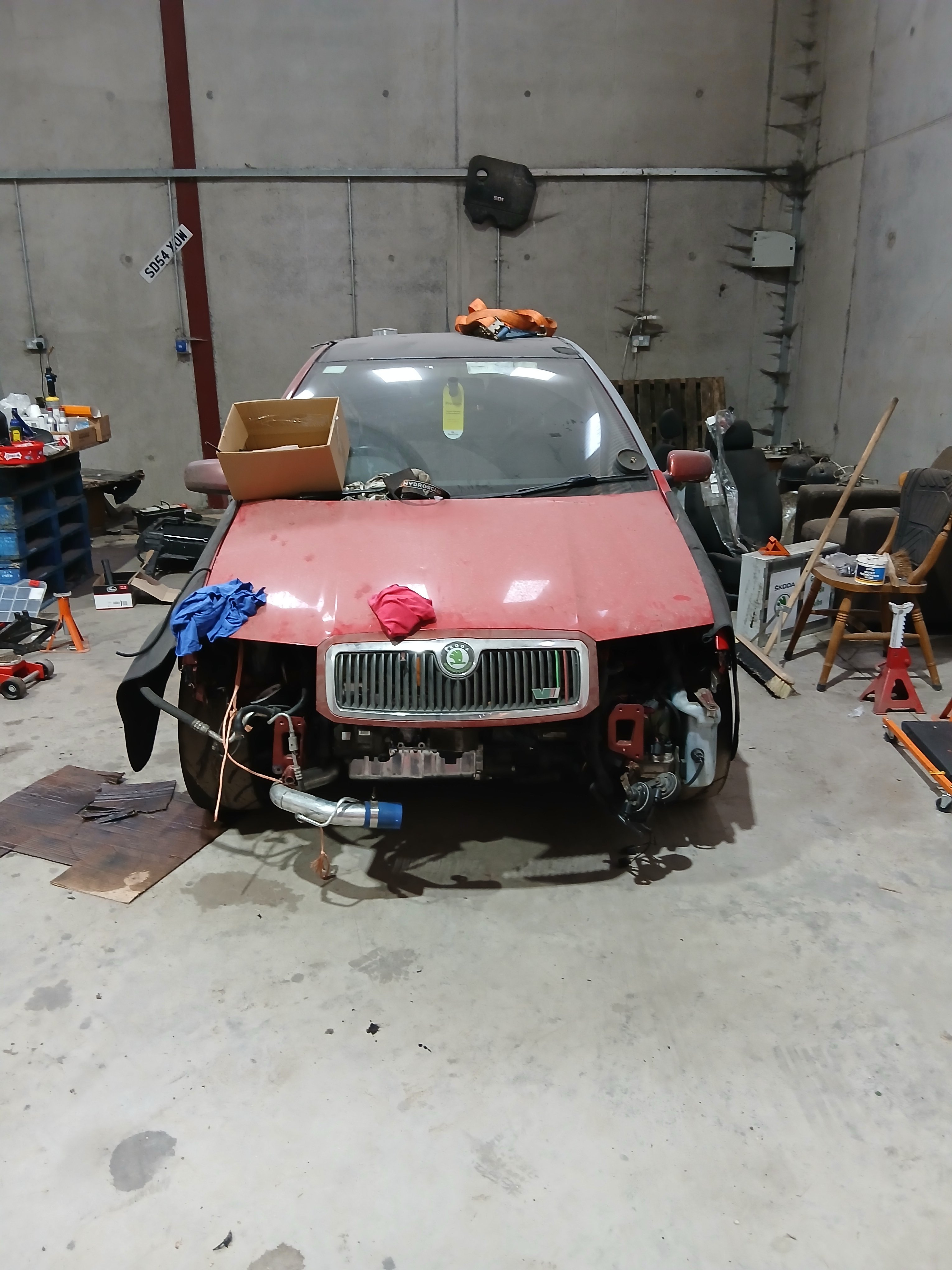

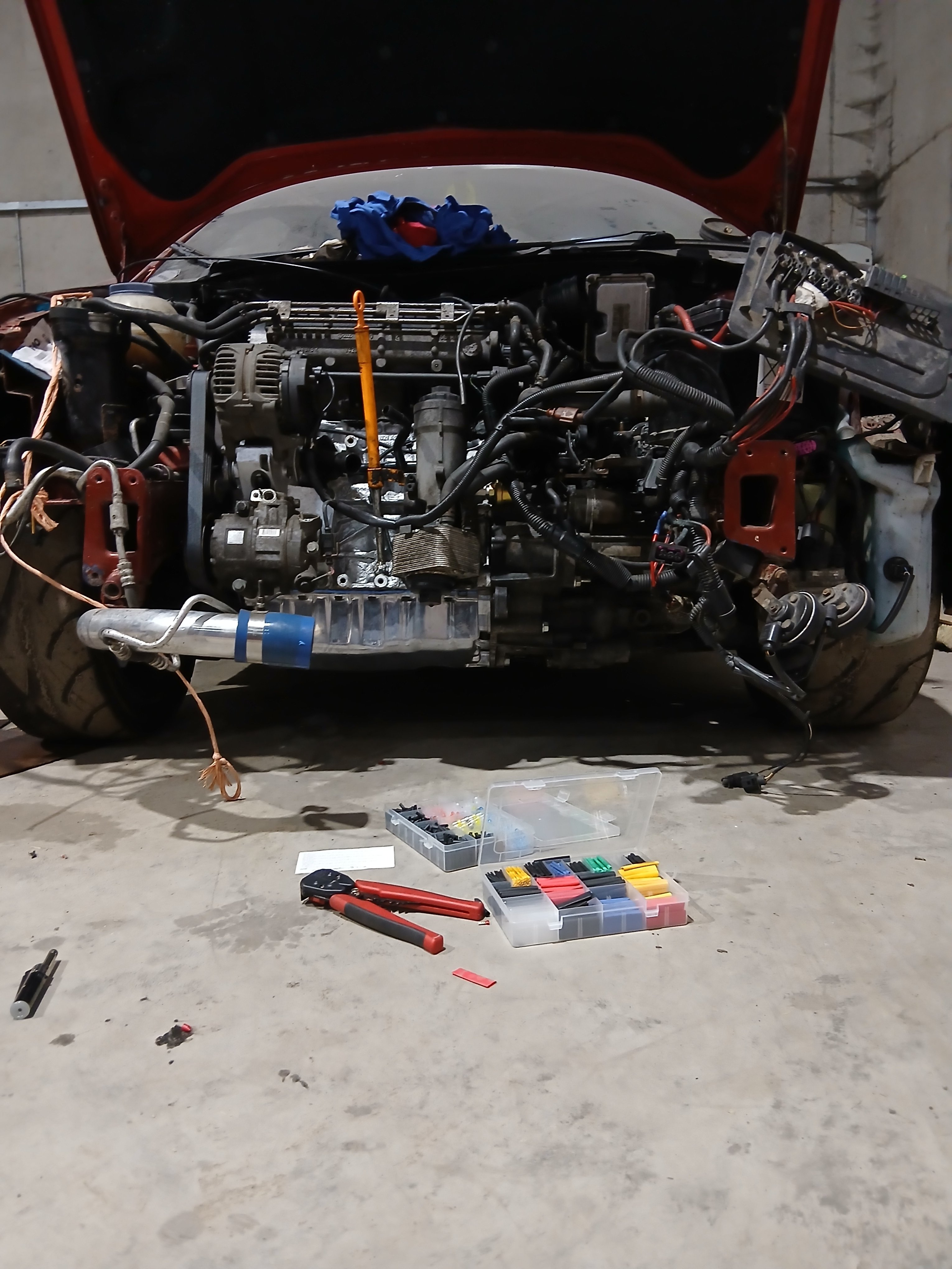

  12. Back on 4 wheels, New lift in, godsend. Mx5 took up more time and money than id thought but its in decent shape, justy is broken again but thats nothing new, so got more time to get on this. Subframe back on, driveshafts back on etc. Radpack built up with new rad. Snazzy stud and nut kit installed, and back on 4 wheels. Repaired some more wiring, again. And had it running, not for long but still. Bit long to crank, so further fettling needed. 20250608_212402.mp4 Also fitted an oil pressure sender, a spare from both mx5 and justy parts. Ran it to a gauge in the engine bay testing it out. Oil pressure is strong so good signs there. Will be routed to the 3 gauge thing in the din. Dont know if i mentioned but ive a serviceable set of underbody "cladding" and exhaust tunnel heatshielding from another parts car which will go on in time.

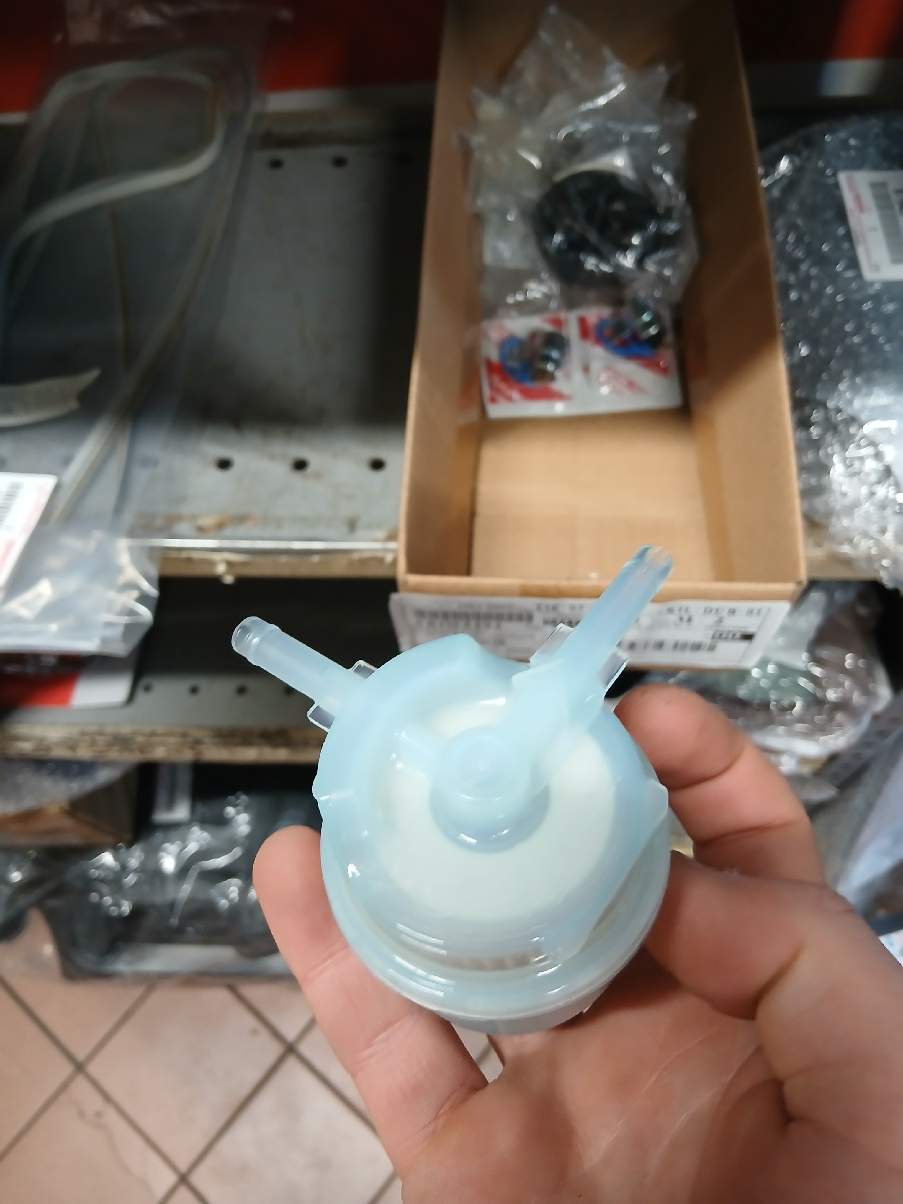

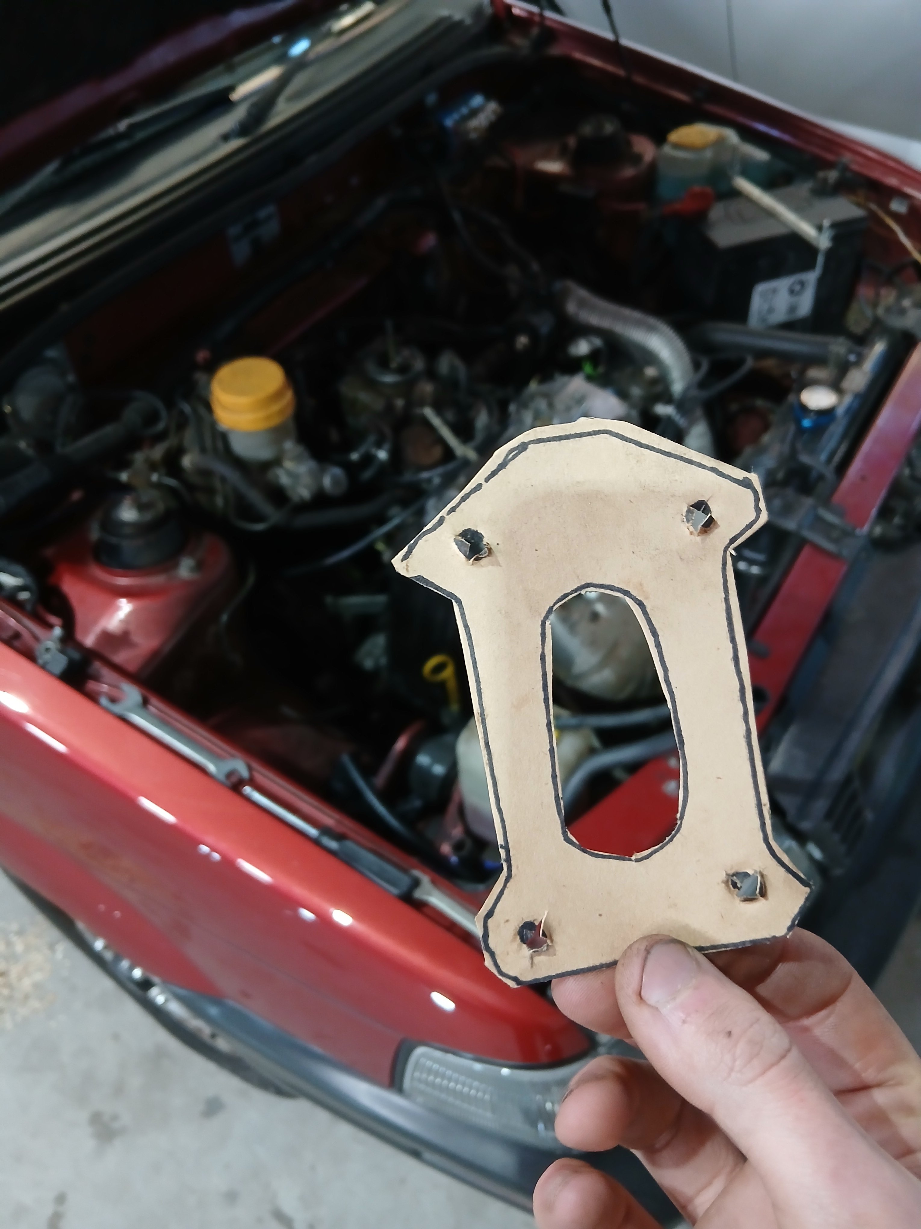

  18. Been meaning to update. Didnt make retrorides yet again, this time was a vacuum leak on the carb. Could only get thin gasket sheet locally, tried it. Worked. For about 5 miles. So got it back to the shed and took the mx5 Ill post some stuff in that thread. Trying to get some thicker sheet just have to wait. Also changed the oil and air filter ahead of that. One good thing is while subaru hasnt made anything for it in 20 years, Toyota still makes some parts for their older coronas etc. I work at a toyota garage now so was able to cross reference aftermarket numbers back to toyota oe numbers, and so ive got decent fuel filters, exhaust mounts, condensors, etc from it. Pretty cheap too. Now have a lift and all too.

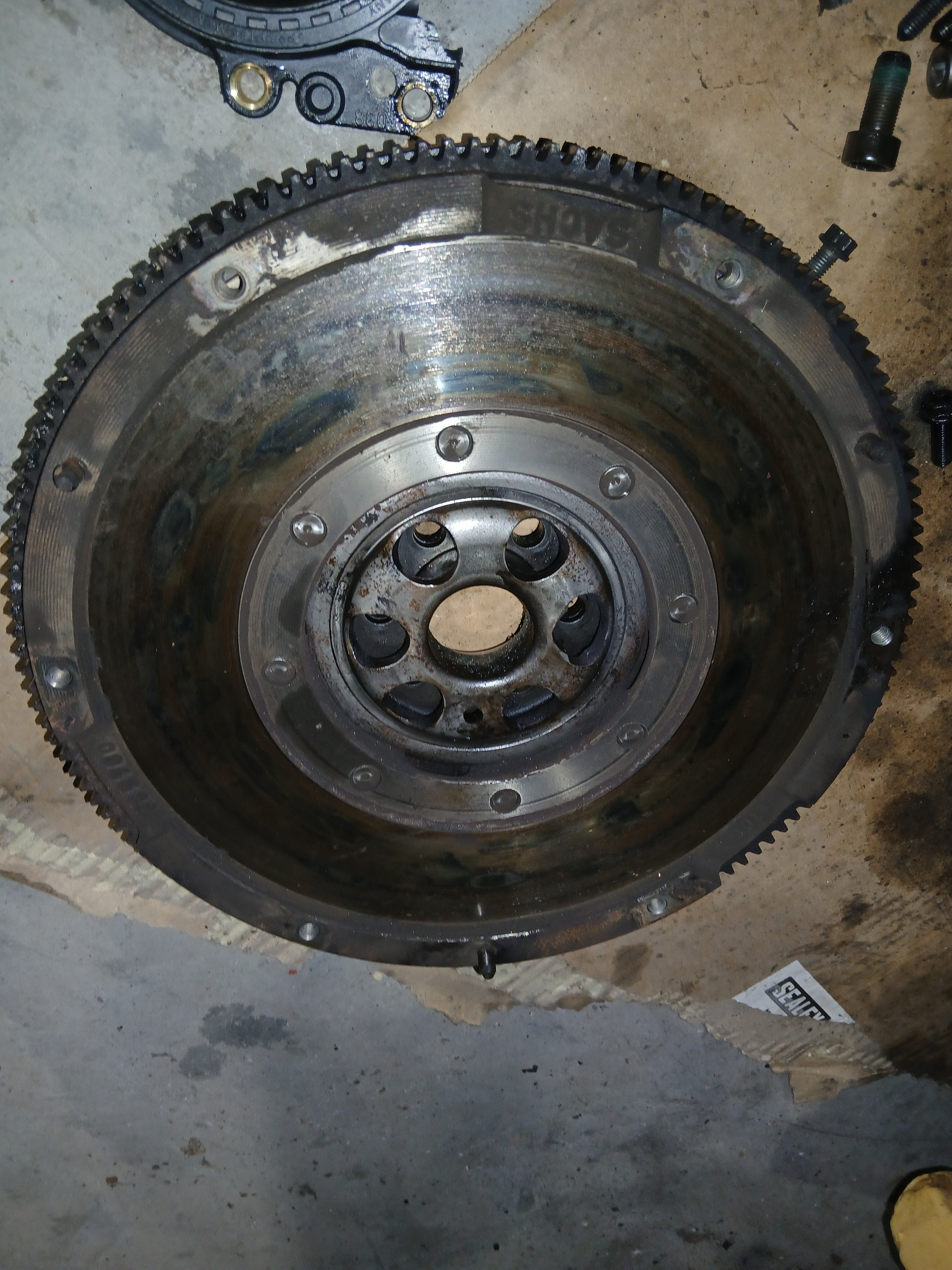

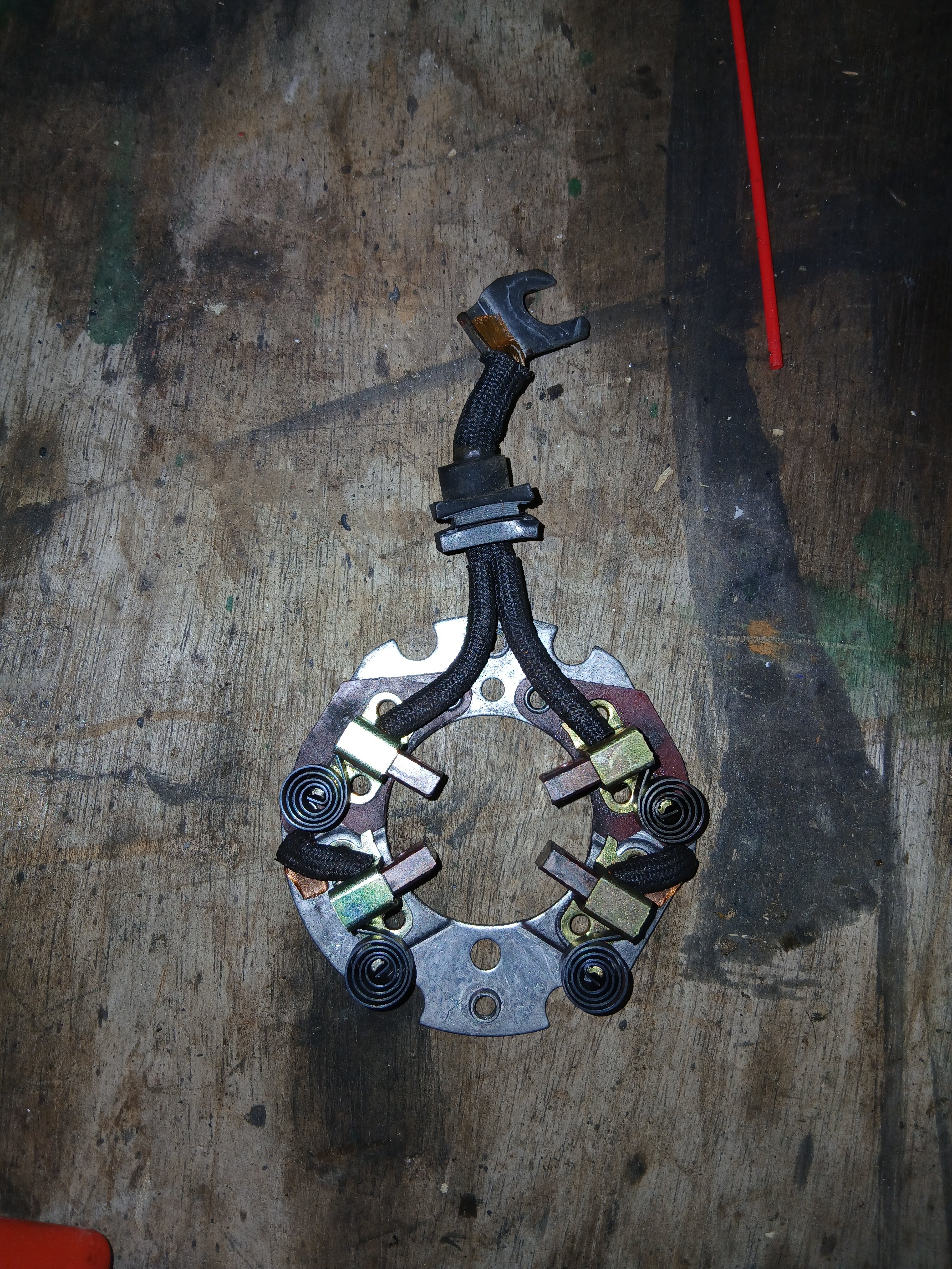

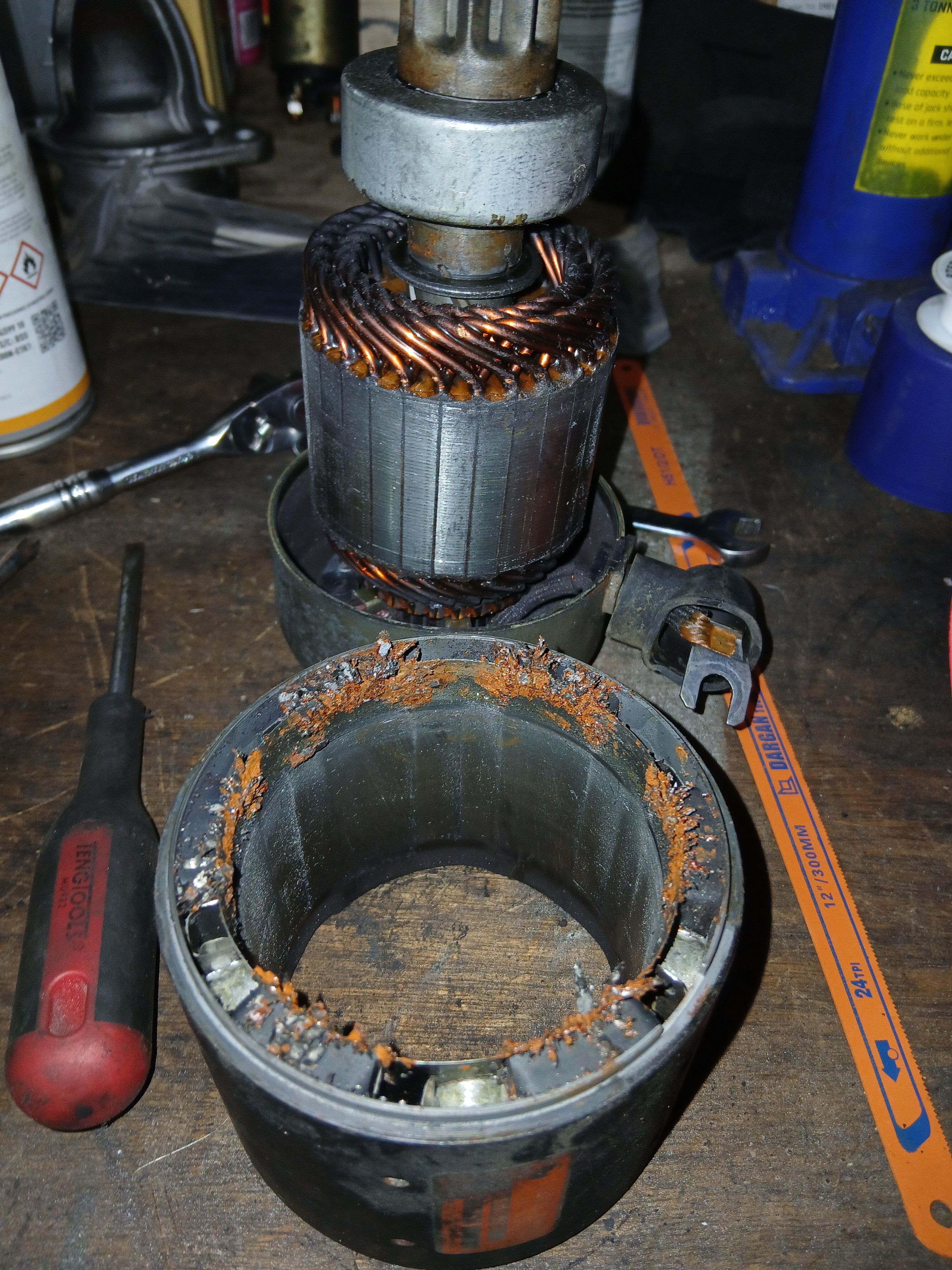

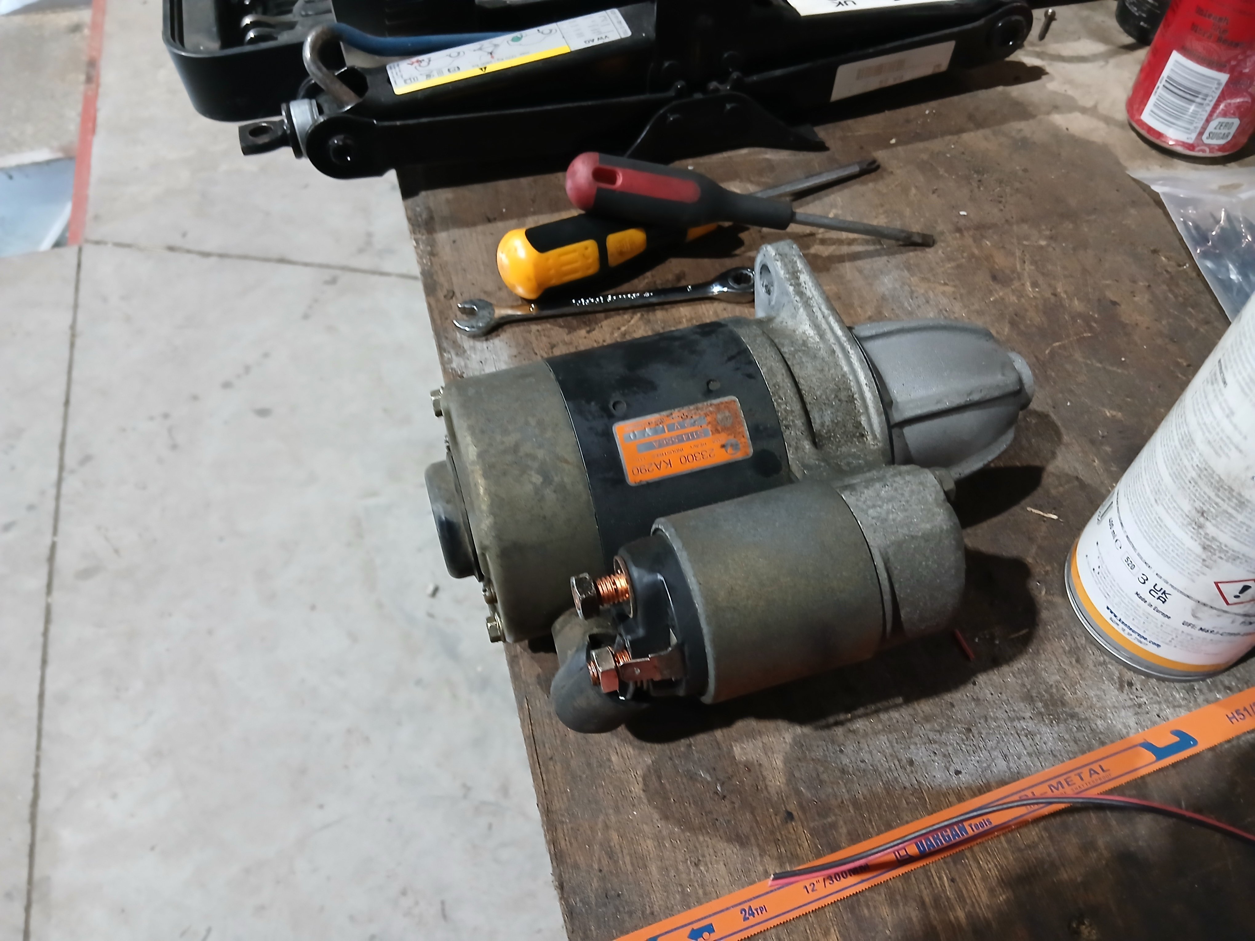

  21. Took the original starter apart to clean it up. Stripped it down, cleaned it up. Wasn't great, wasn't terrible. Put it in there and it seems to be doing a better job. Flywheel doesn't look wonderful on the teeth mind.

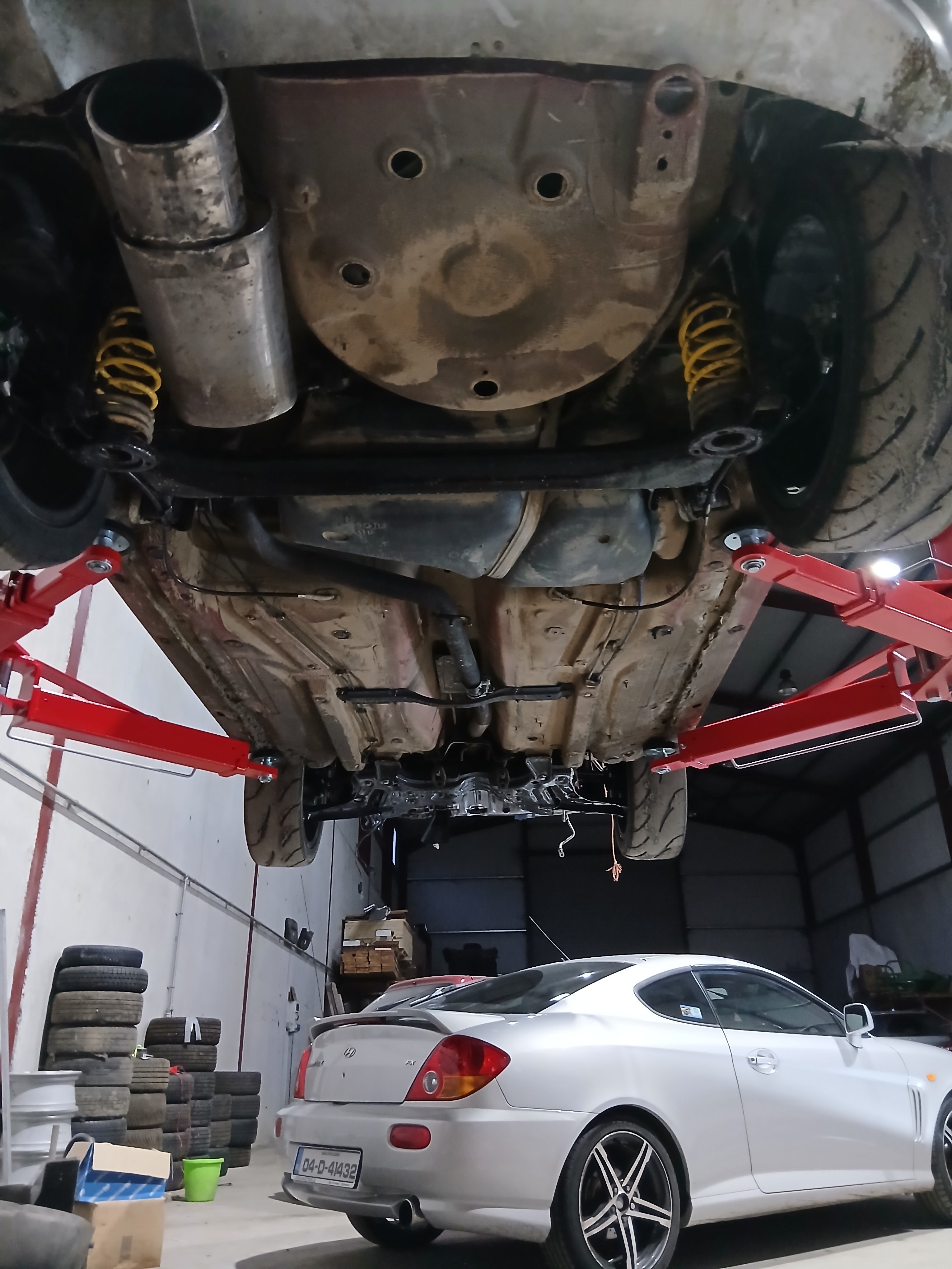

  22. Currently tackling some surface rust underneath. Won't be used in winter, or do massive driving so won't need to be perfect.

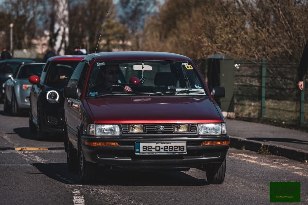

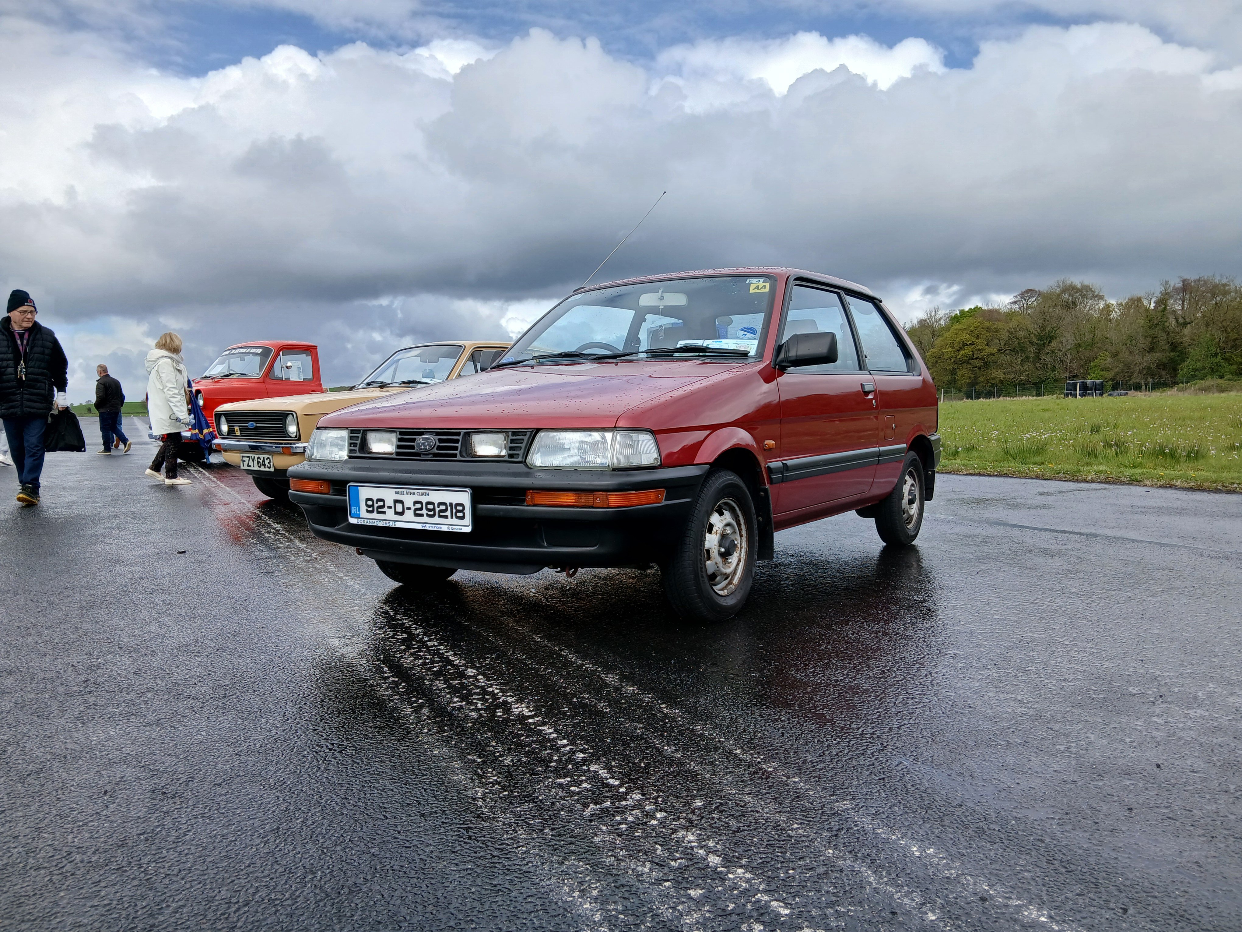

  24. This thing is going pretty well. Slackened the clutch cable some more and that's stopped it slipping. Had it up in Enniskillen Easter Monday for a car show, good mix of driving. Had changed coolant and adjusted the timing a little so it was more a shakedown run than anything. Fairly packed, weather was horrid so made it a bit of a wash. Some nice stuff at it. Just the weather put a damper on it. Filled up with some e5 since I was up north and got 50mpg on the way back. Very surprised. Seems to be going well, really hoping it'll do goodwood in a few weeks. Installed an Oil pressure gauge too. Fixed up some wiring to the spotlamps aswell. Only thing I'd like to get sorted is the starter but we'll have to see.
