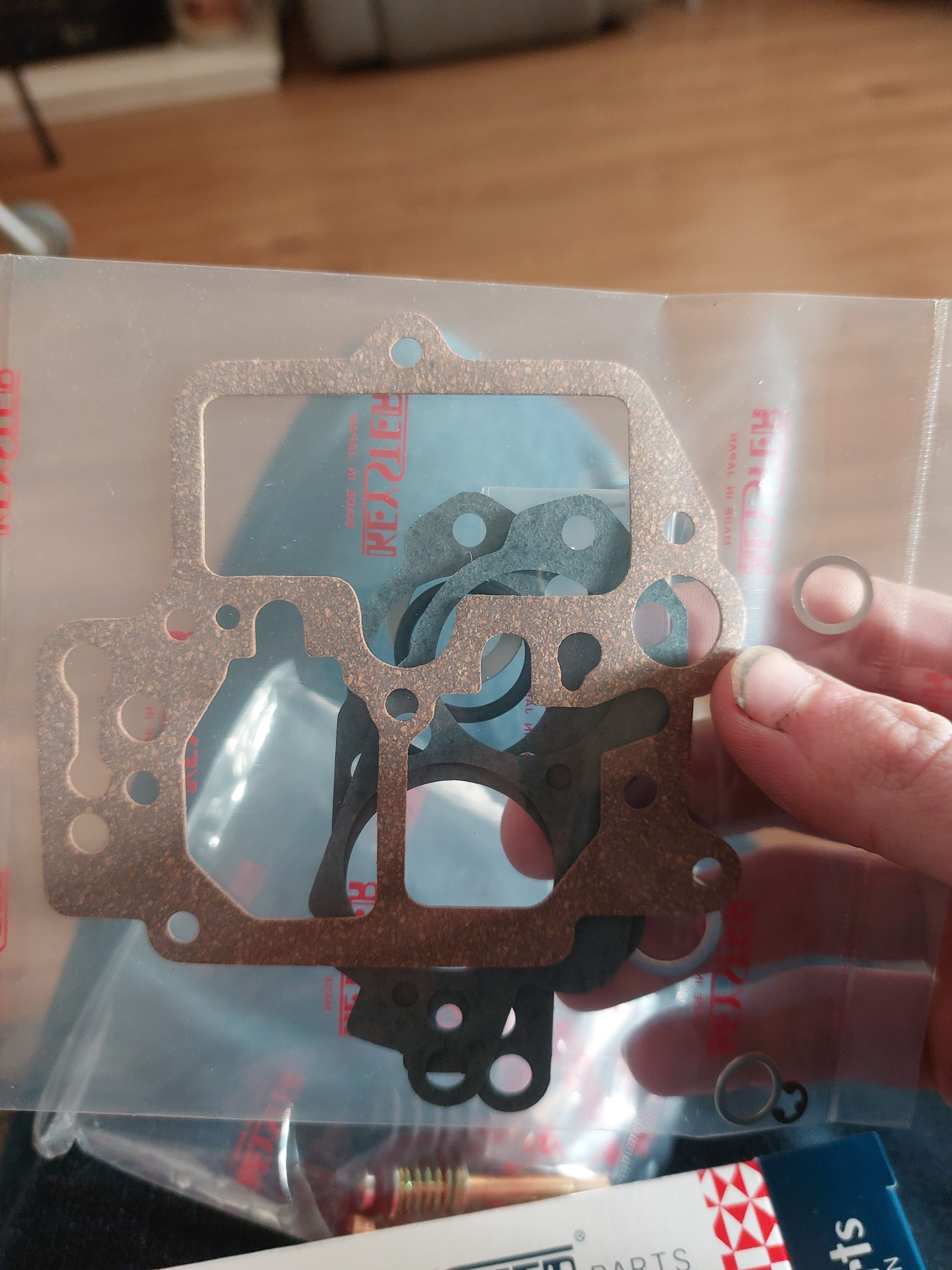

DieselMontes BarnFind Subaru Justy
Did some checks on this today. Pulled the top of the carb off to check the jets and bowl for rust. All good. Lowered the float slightly as I was told it might help with hot starts somehow. Pulled the plugs and 1 2 And 3 Seem to be burning pretty good. Cleaned the contacts on the cap and rotor and lubed the cam for the Points. Running well. Gonna recheck timing, idle mix and idle itself next time I'm arsed. Still need to change the brake fluid, change the coolant. Replace a coolant temp sensor (gauge reads low). Intending on making retrorides in it. So far it's proven to be reliable enough, considering it's been out of action since 2010. Found a few things out about it recently too, namely some records of it. Came into work in 2002 for an nct prep. Some time after that it came in on a no start, which was just a bad battery. Last record of it was in 2008 where the mid section of the exhaust was replaced. It still looks brand new and when I got the car I figured it had been changed when it was off the road. Not 14 years ago.

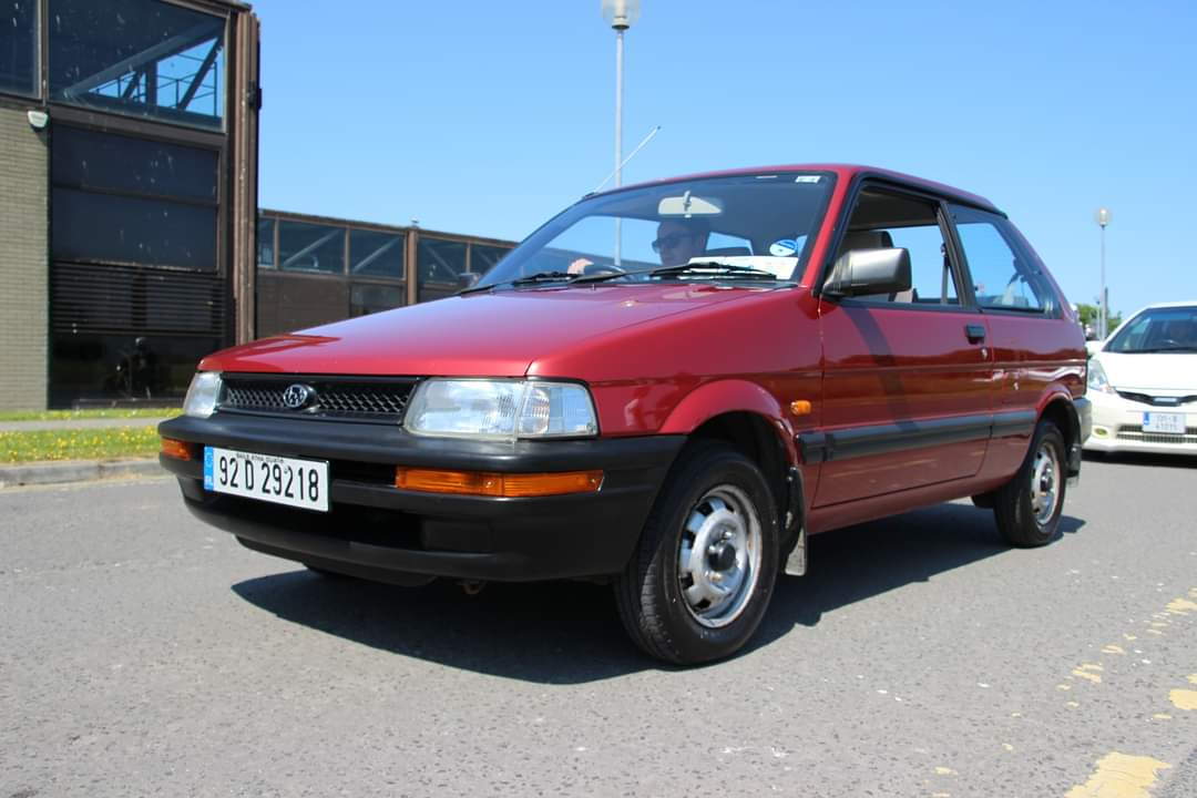

Few pics of this turned up. Also found the government's e10 checklist says any subaru after Jan 31st 1991 is good for it. Then found another which states the same, except all vivios and justys before April 1994. Nice. Closest station to me is a fair drive but looks like I've no other options as all fuel stations near me use e10.

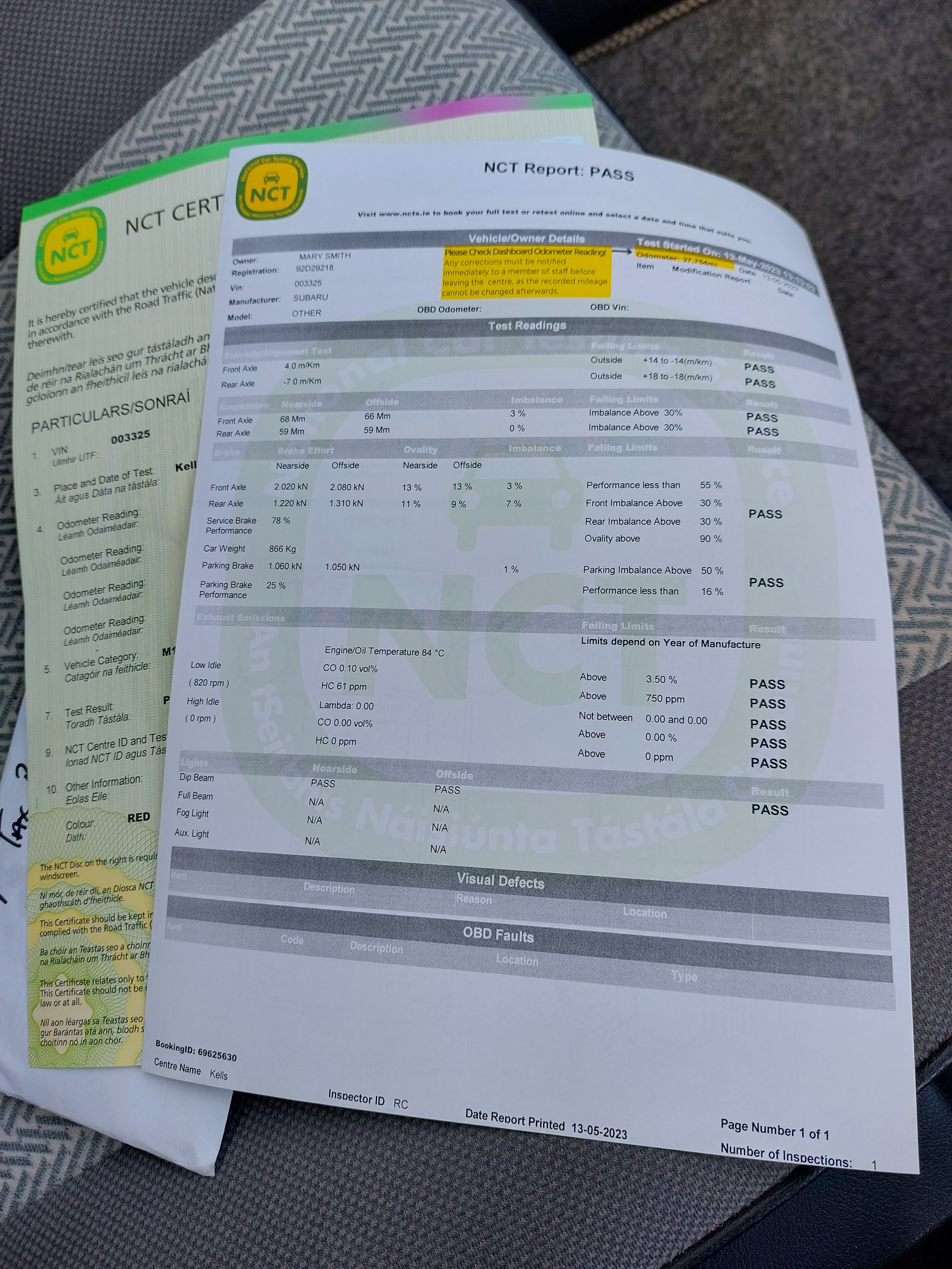

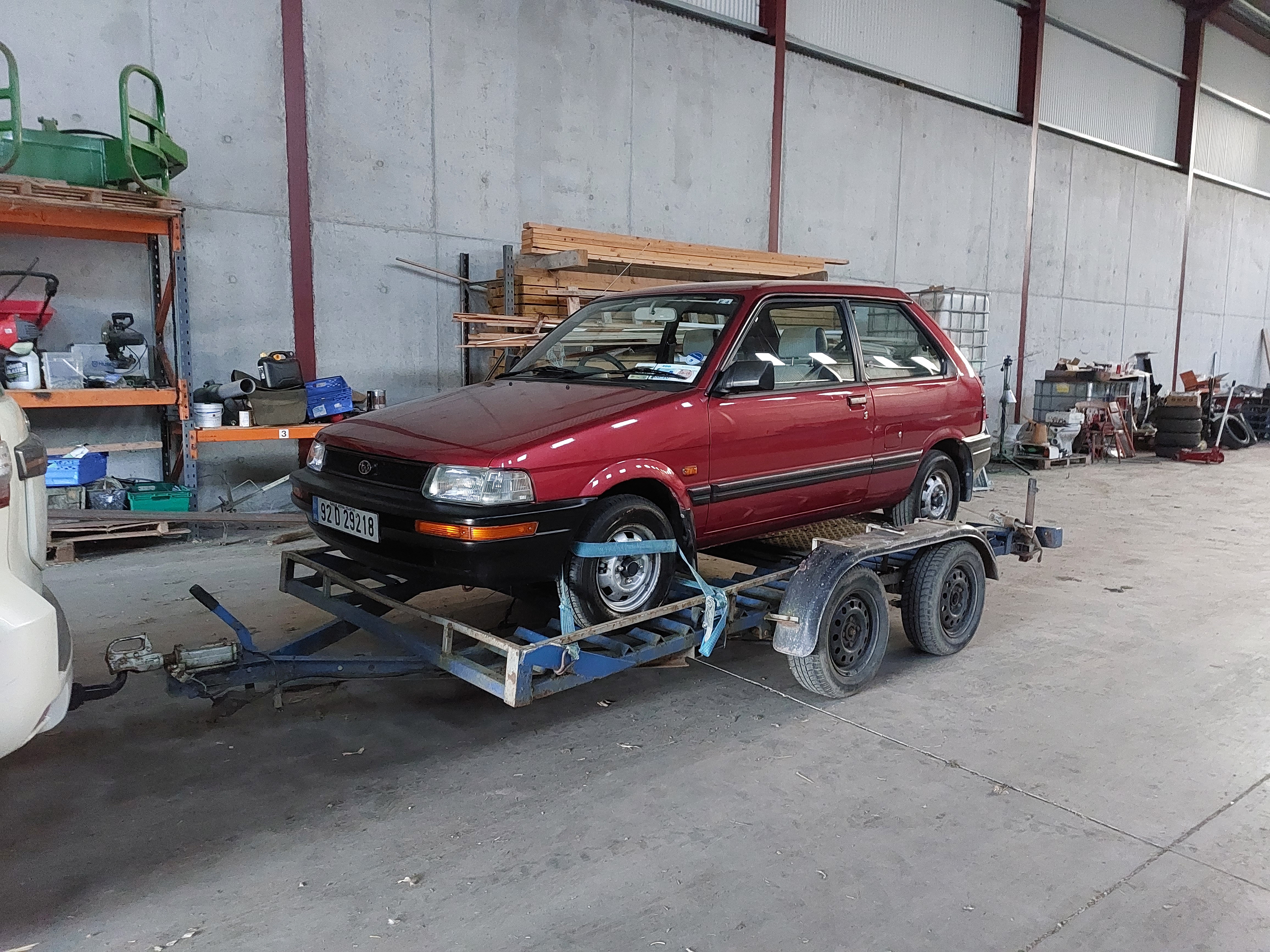

In for nct this afternoon Towed up because I didn't want to chance getting stopped. And... Clean sheet pass. So now tested until September next year. Should be 2 years but due to the unique way nct works, it goes from the month it ran out to that month the next year. Because it's over 30 years old it gets a "2 year test". If it were any younger it'd be tested until September of this year, and have to go back in again. Makes complete sense right?
