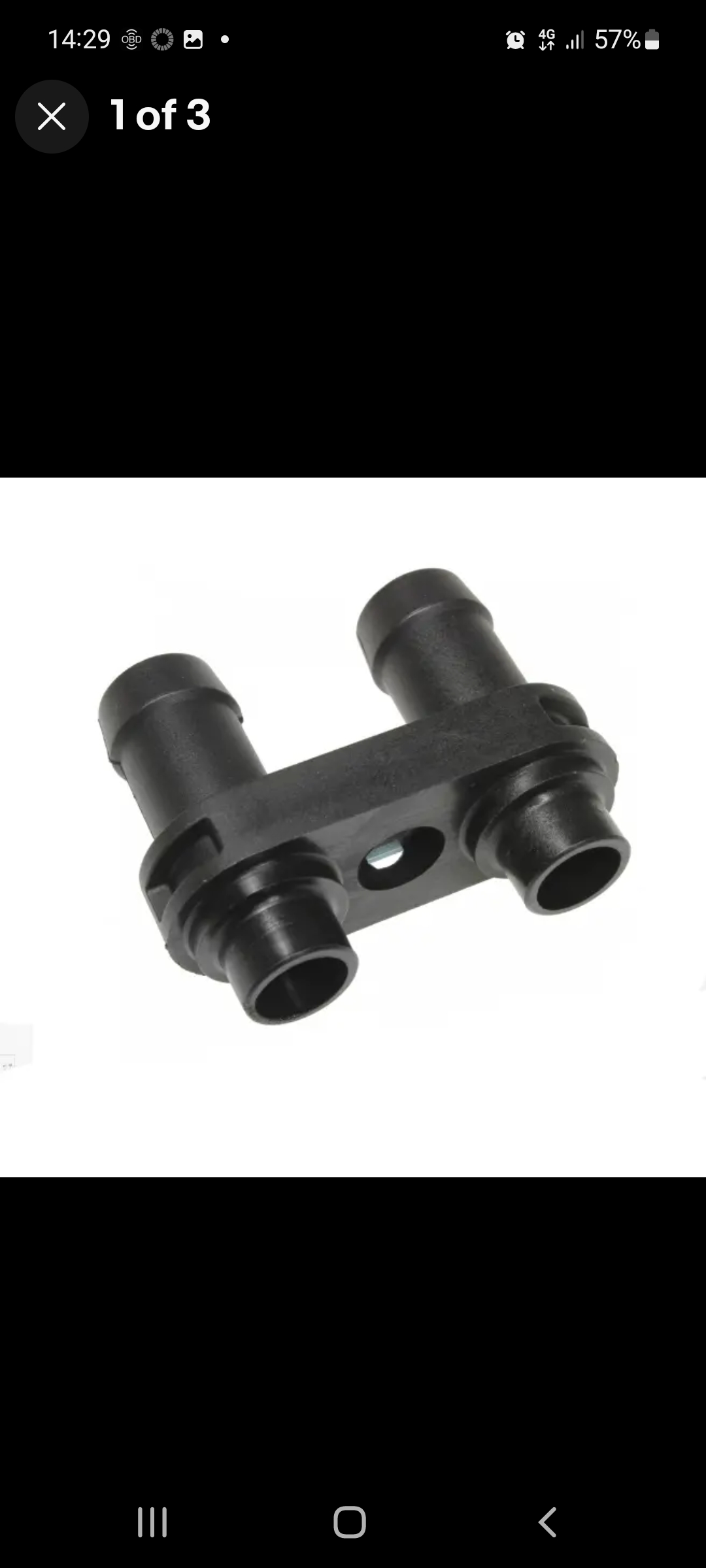

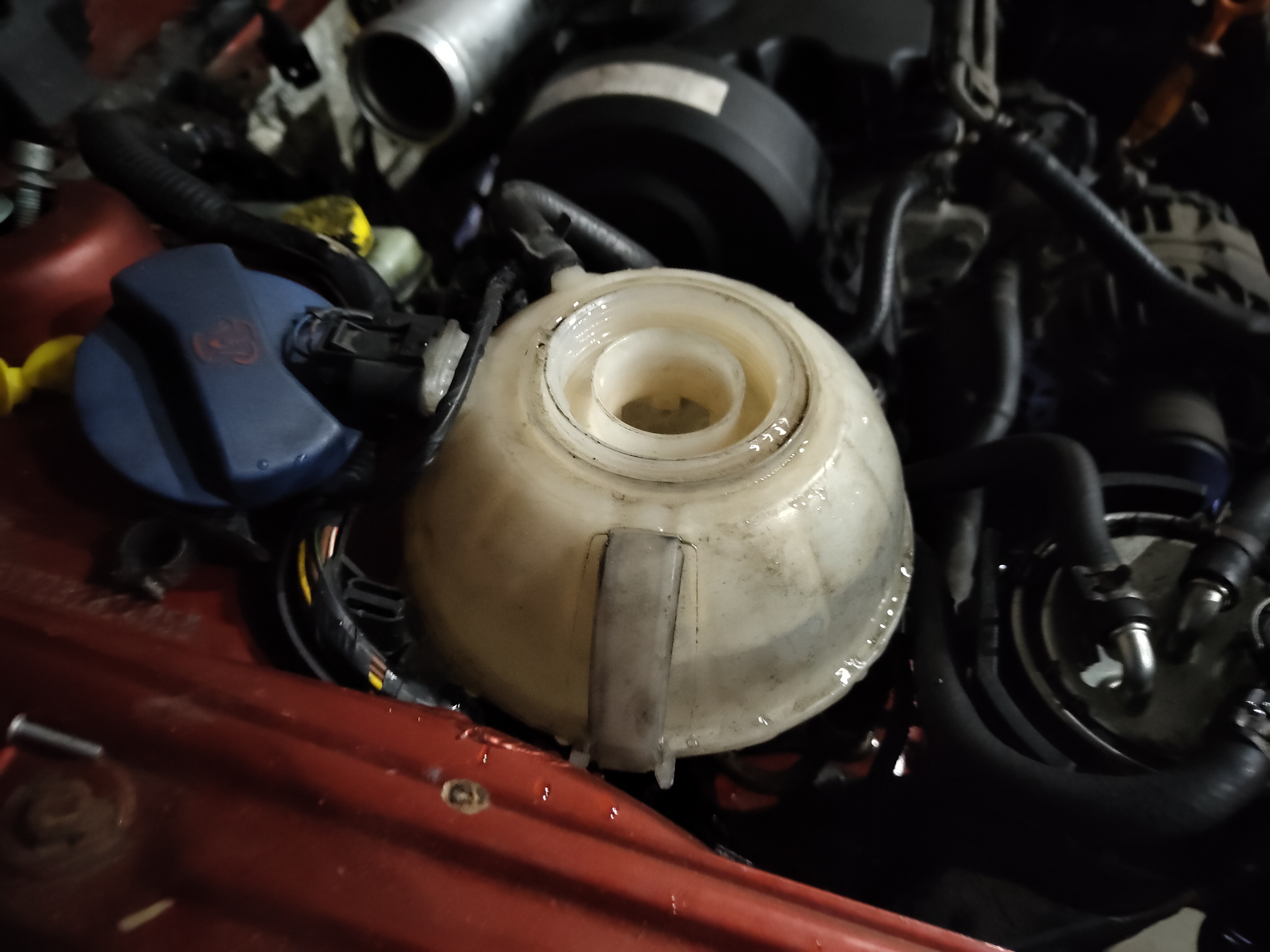

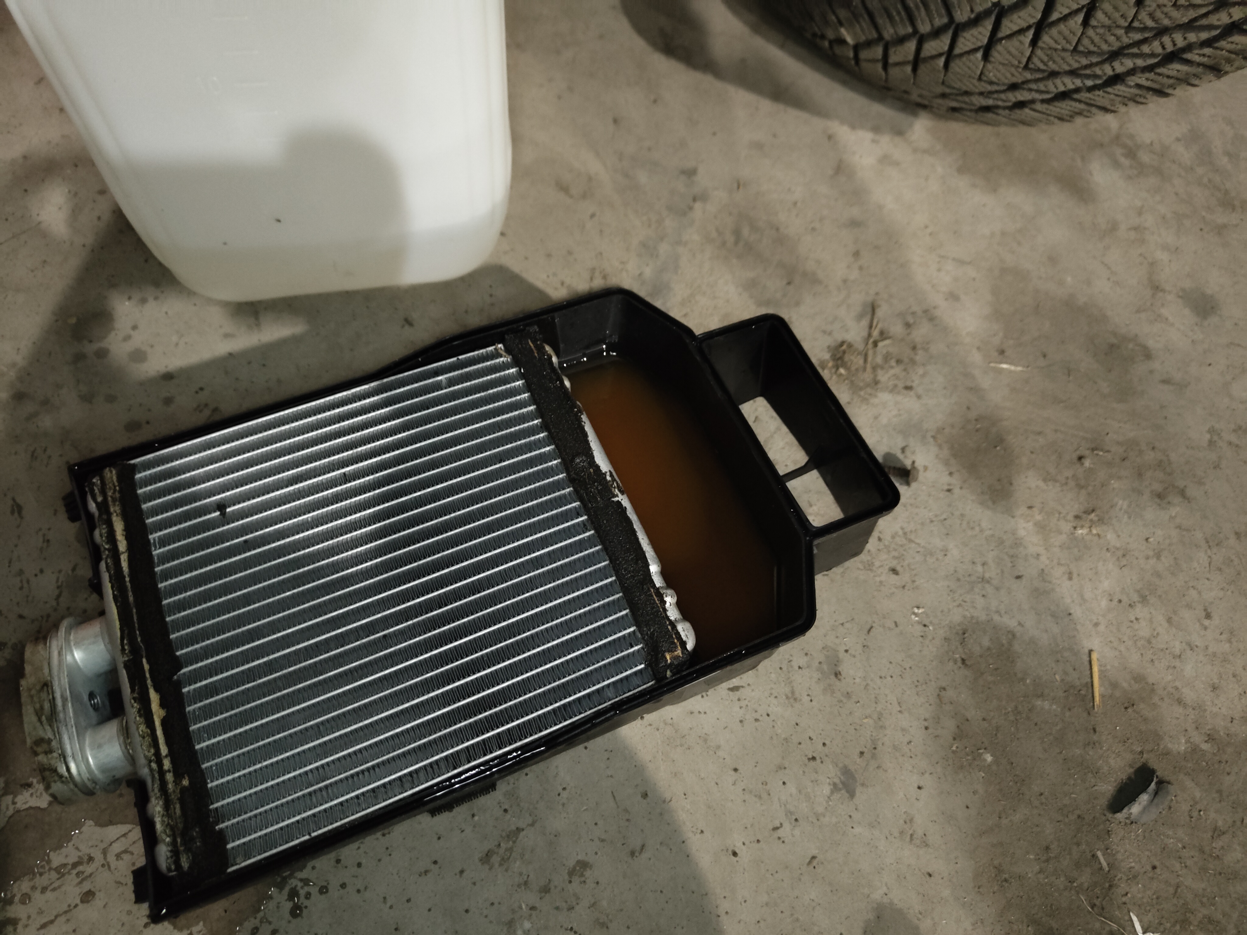

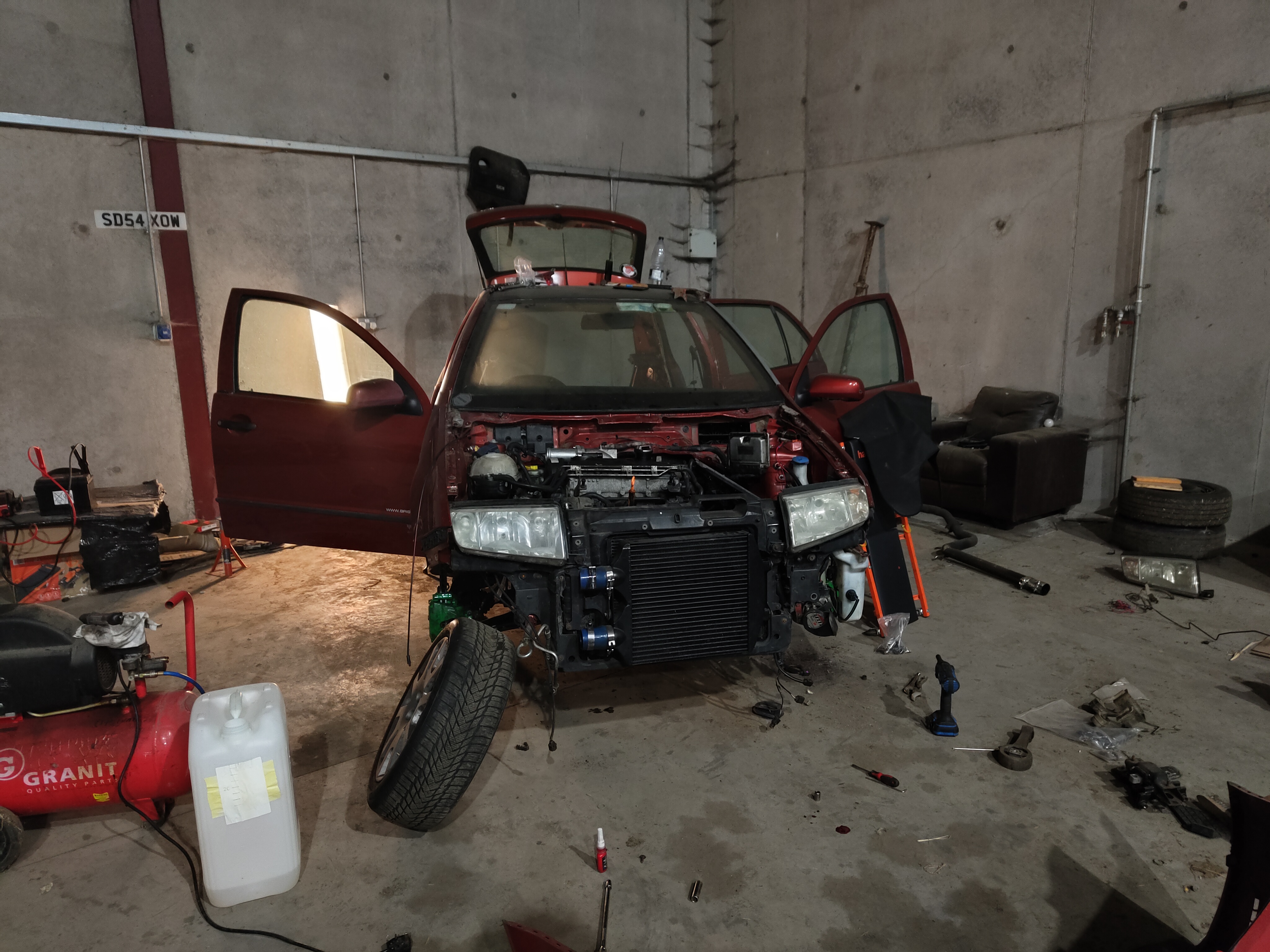

So been a while. Was absolutely tortured with a coolant leak at the heater core. Wouldn't seal, wouldn't seal. So tried one of those adapter things from Skoda. Didn't work. Eventually got a new heater core because... ****ed. So that in, plus new silicone hoses to replace the crappy hardlines and FINALLY got it holding fluid. Had to borrow some brackets for the Monte so sourced some ones new genuine. Only €8.00 odd a side plus vat. Exhaust, intercooler and a few other jobs and I'll be able to test drive it finally.

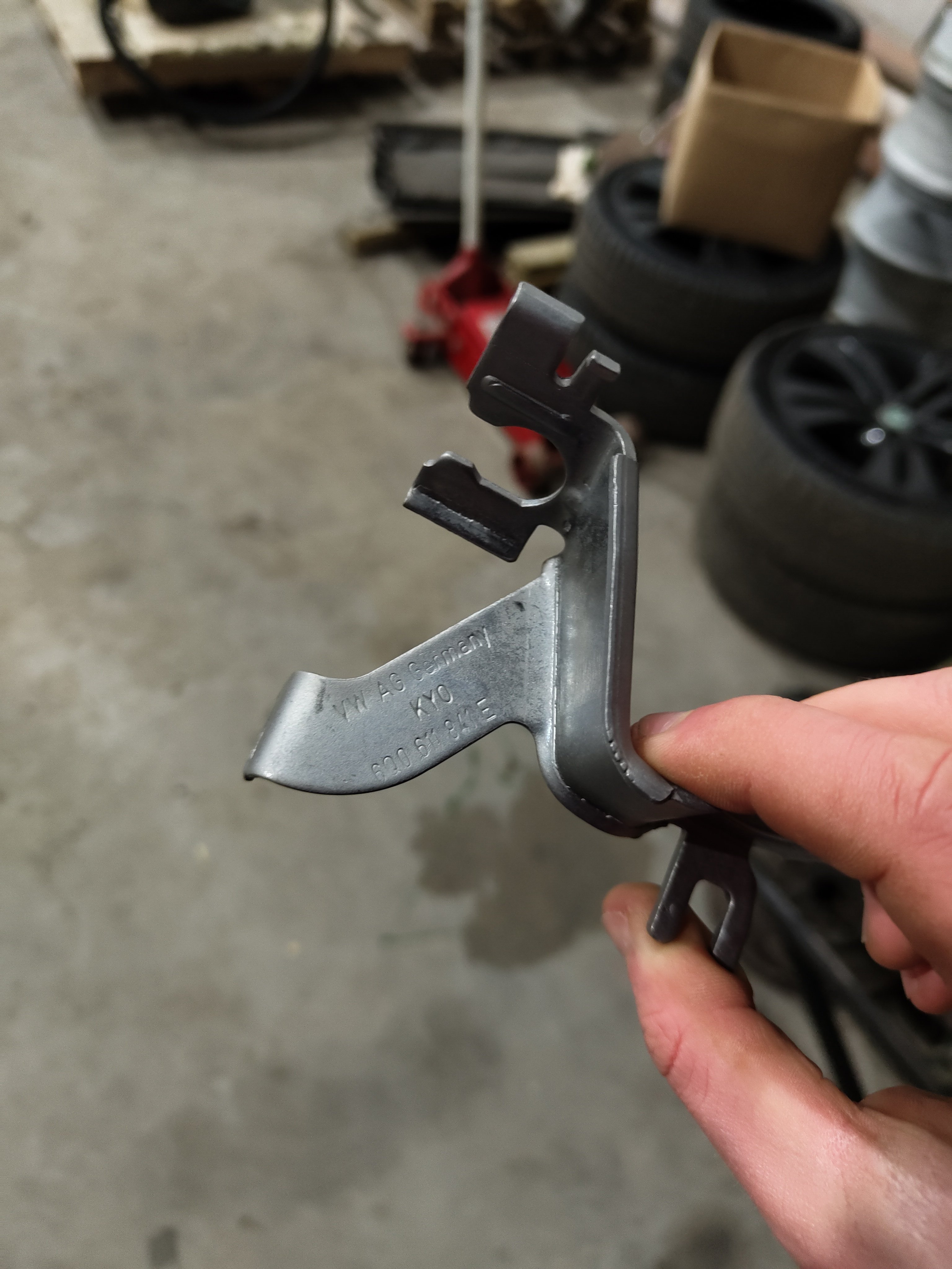

Broke the bonnet catch the other night somehow so swapped it over from a parts car. Central locking button went so swapped it, and it was boosting funny (why I was popping the bonnet ironically) so swapped the N75 too. Now onto some more fun stuff. Have gotten some very nice very cheap upgrades and bits recently. First one being a sunglasses holder. New old stock genuine Skoda one Believe it or not a fair bit cheaper genuine than on eBay. Nice and cheap. Swapped the top vents over to some less haggard ones too. No pics. AND finally got an upgrade from my ropey Swing headunit. Got my hands on an Amundsen+, so Bluetooth and satnav. Neither of which work currently as I haven't swapped the satnav aerial and I need to do some poking around with vcds to get the Bluetooth to work. And I THINK I'll need to put in a mic for the Bluetooth to properly work. Saying that it works well, still have my Bluetooth adaptor so using that. Nice to have a working CD player again too. Did want something Android auto but this is costing me basically nothing and is OEM. Have an oil pickup tube and seal got too, want to drop the sump and some point and have a look see. Nearly 160k so curious to see how it's holding up. Suspect I have an injector seal weeping too. Plenty of stuff to be sorted to keep it in good shape. So mixed start to the year but I intend on making the most of it. Lots to do.

Update: It did fail on something very stupid. And it shouldn't have. Failed on front brake pipes fouling (they weren't) was told it needed a bracket (It didn't the bracket is on the shock), they failed it then your man took it BACK in for a retest on the spot because it didn't print an emissions reading. It passed that with flying colours. Retested it failed again, so to appease the sour bastards I robbed some brackets off one of the Mk1s and cleaned them up. Also got new brake lines which ended up not even working, would not seal on the caliper. So used the old lines which I am NOT happy about. Did come out pretty slick. Drilled a hole in the hub and ran a tec screw through. Ended up finding an OE number so have 2 new ones to go on the SDI. While all that was going down I wanted to swap the gearbox mount as it was poorly. Then broke a bolt. Was over Christmas, Ordered a new one and it didn't come to January 3rd. So was out of it for a week or so. Sorted through other means but I now have a spare bracket brand new just sitting there. Have to do another full test and that's in just under 2 weeks. Have to get 2 tyres on it Saturday as they're nearly on the wear bars. And I'll change the oil before I do the test.

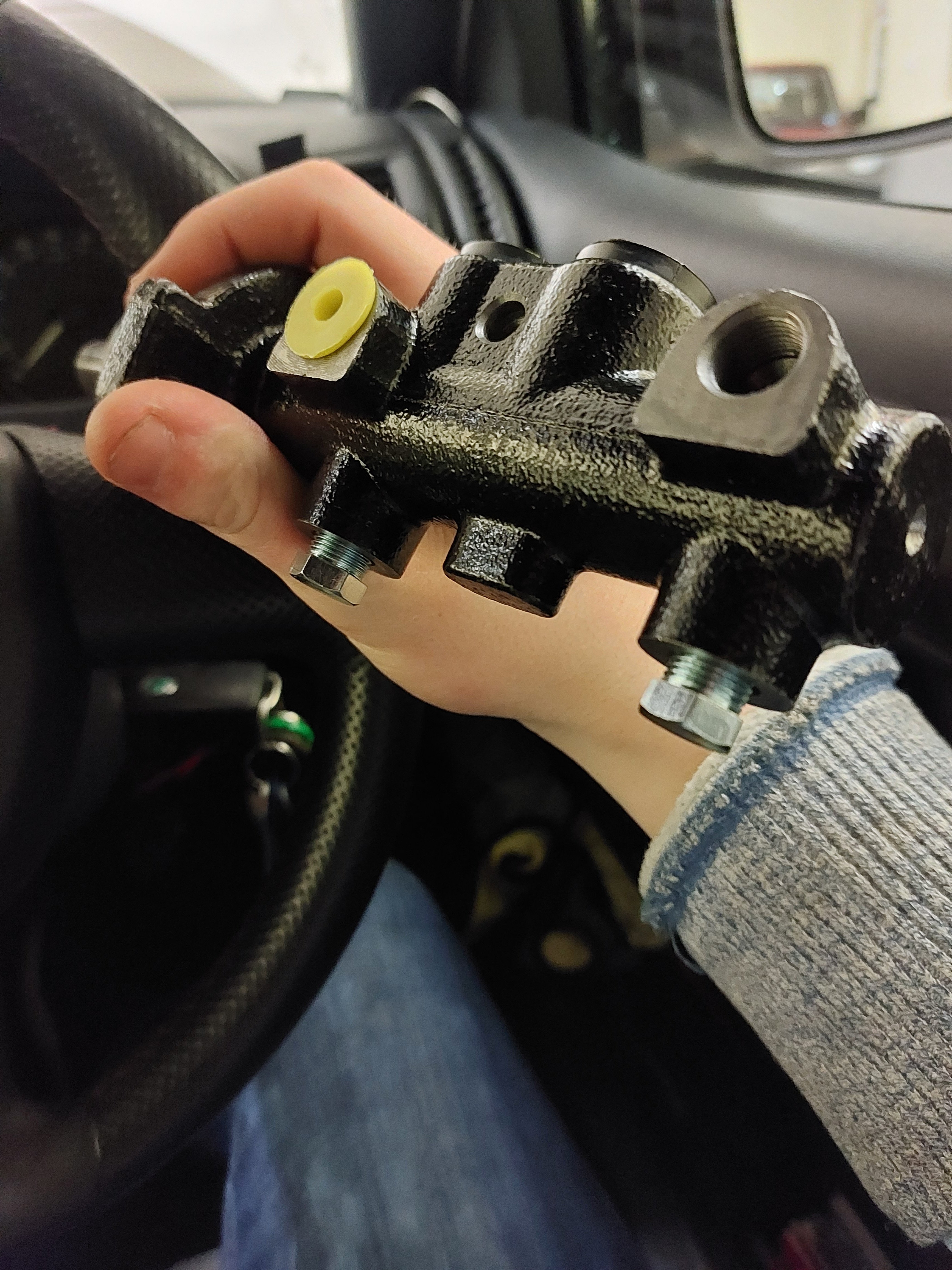

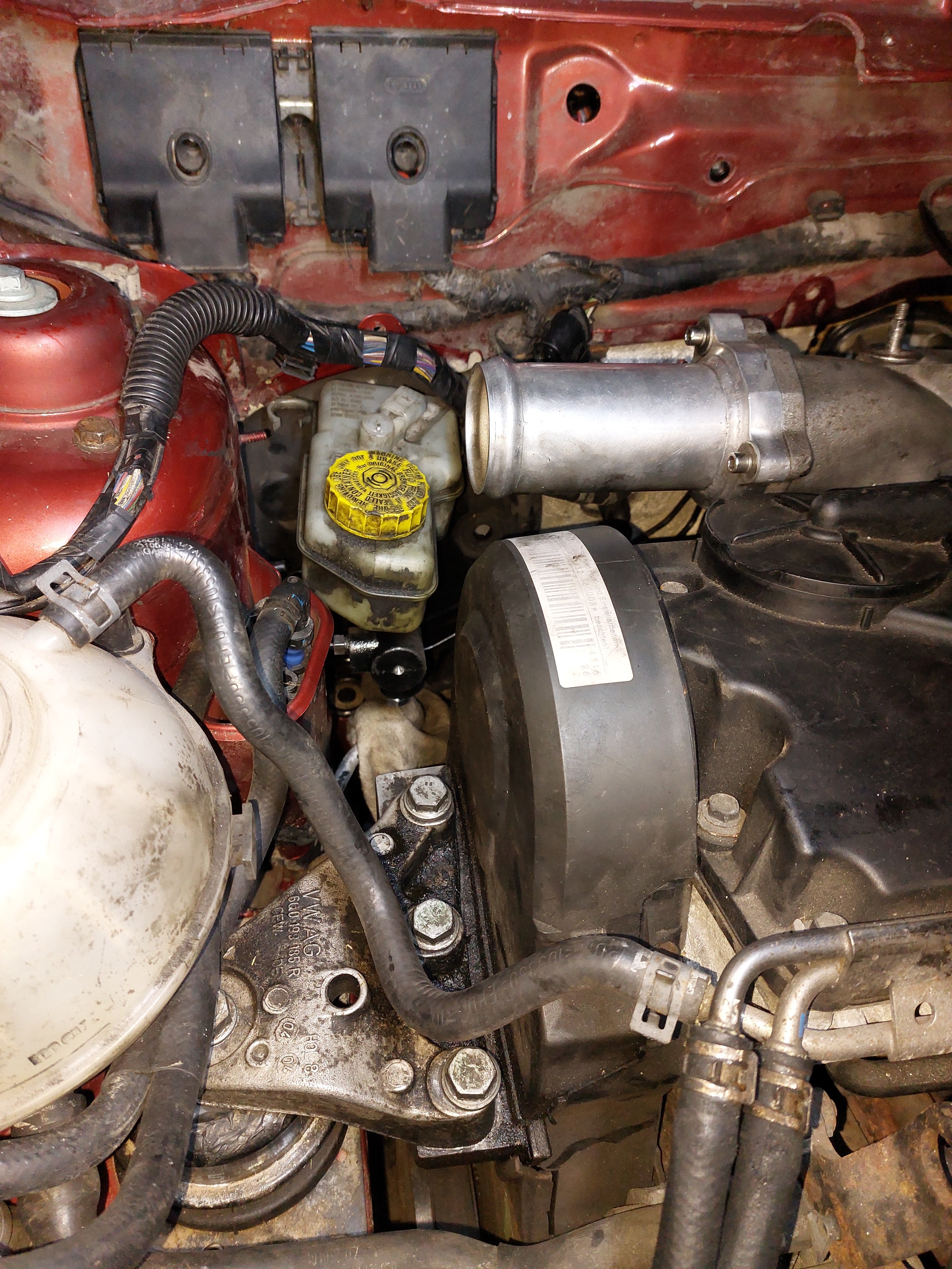

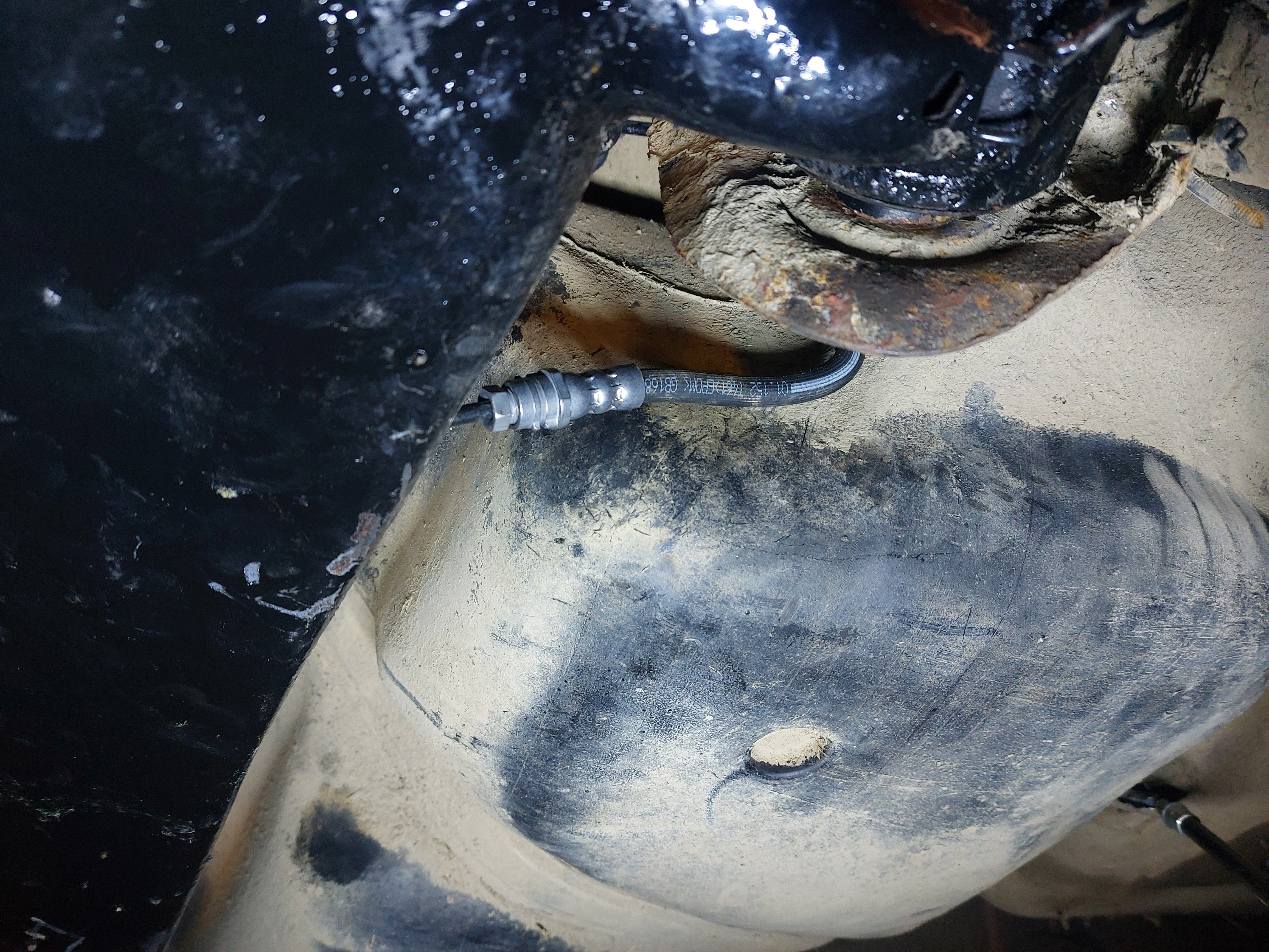

Had to get a new master as I damaged one of the threads on the old one, can't be helped. came with bolts to put into the bottom holes. Obviously they make the same master for ABS and Non ABS. Not a lover of it but if it works... And one of the brake lines under the car started weeping when I put pressure to it, so getting a flare tool and doing it next day. Put coolant to it and quickly lost it because of a dodgy O ring going into the heater box. Silly stuff. Got a box of O-Rings so that'll be done next day too. Really that's the worst of it now, all that's stopping me in my tracks. All things considered, it's not much. Oh and I've been trying to see about fitting some driving lamps I originally got for the justy to this. Best place will be to put it onto the bumper in the grille. Have to see how much room I'll have with the intercooler though.

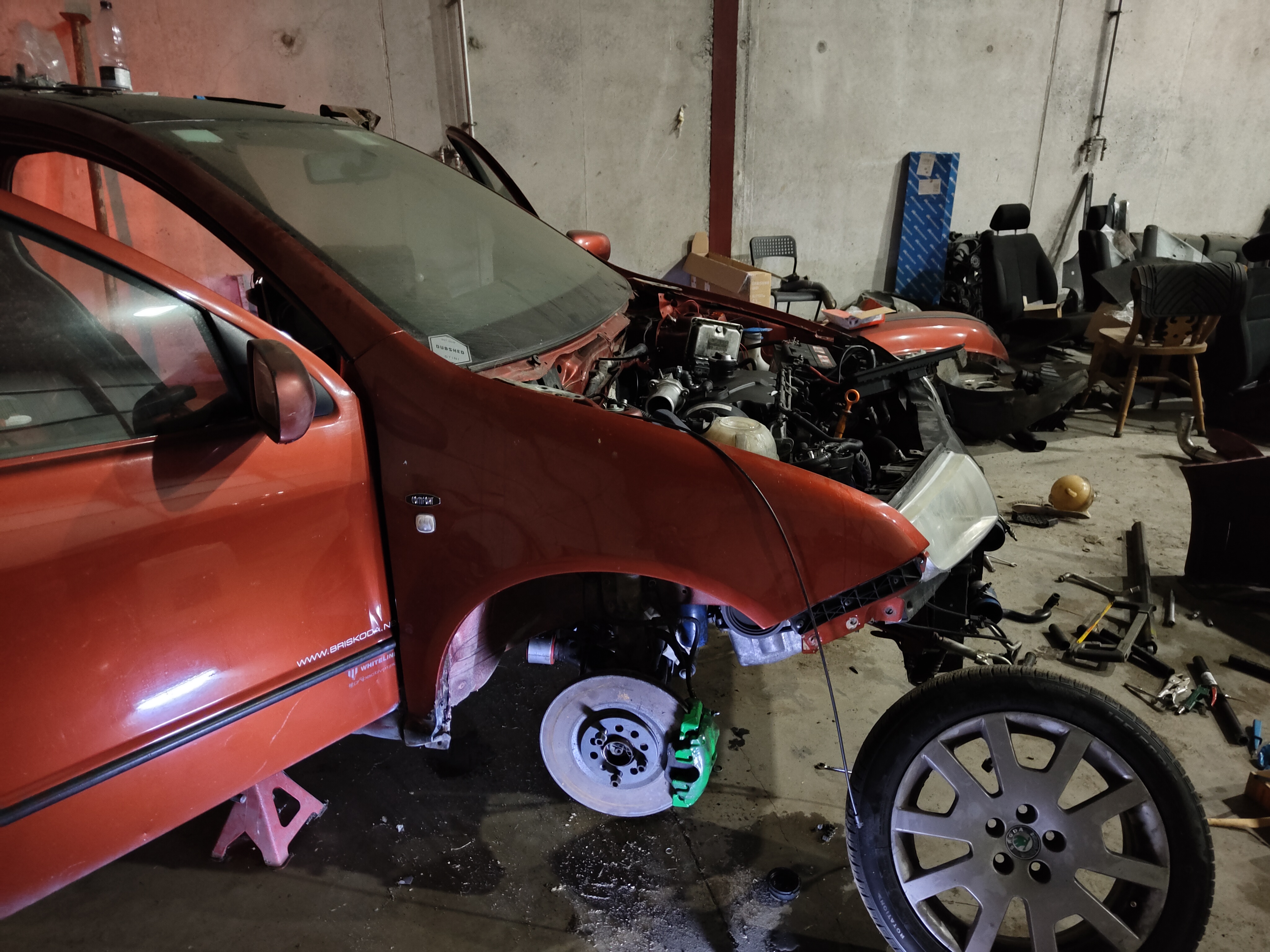

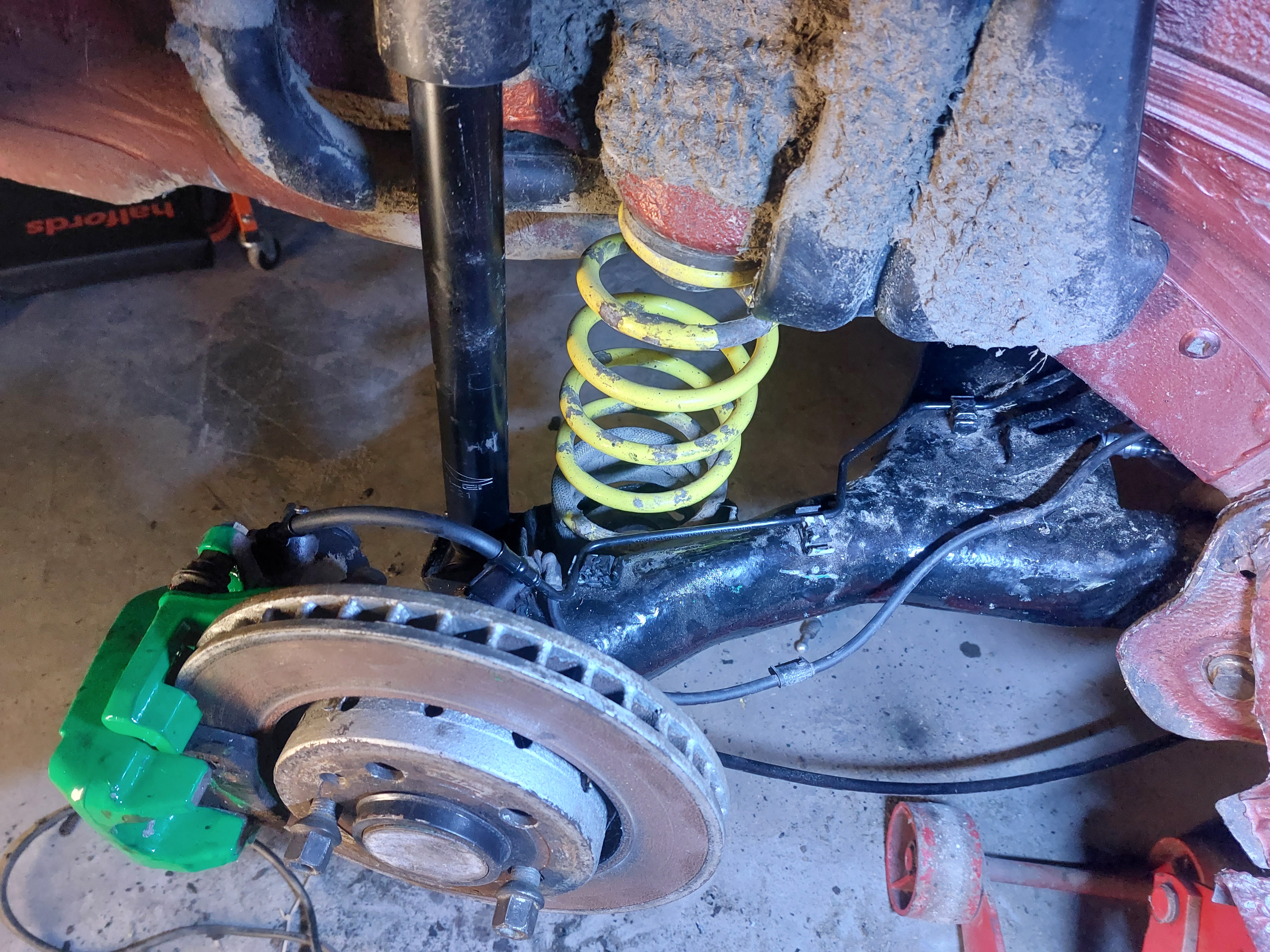

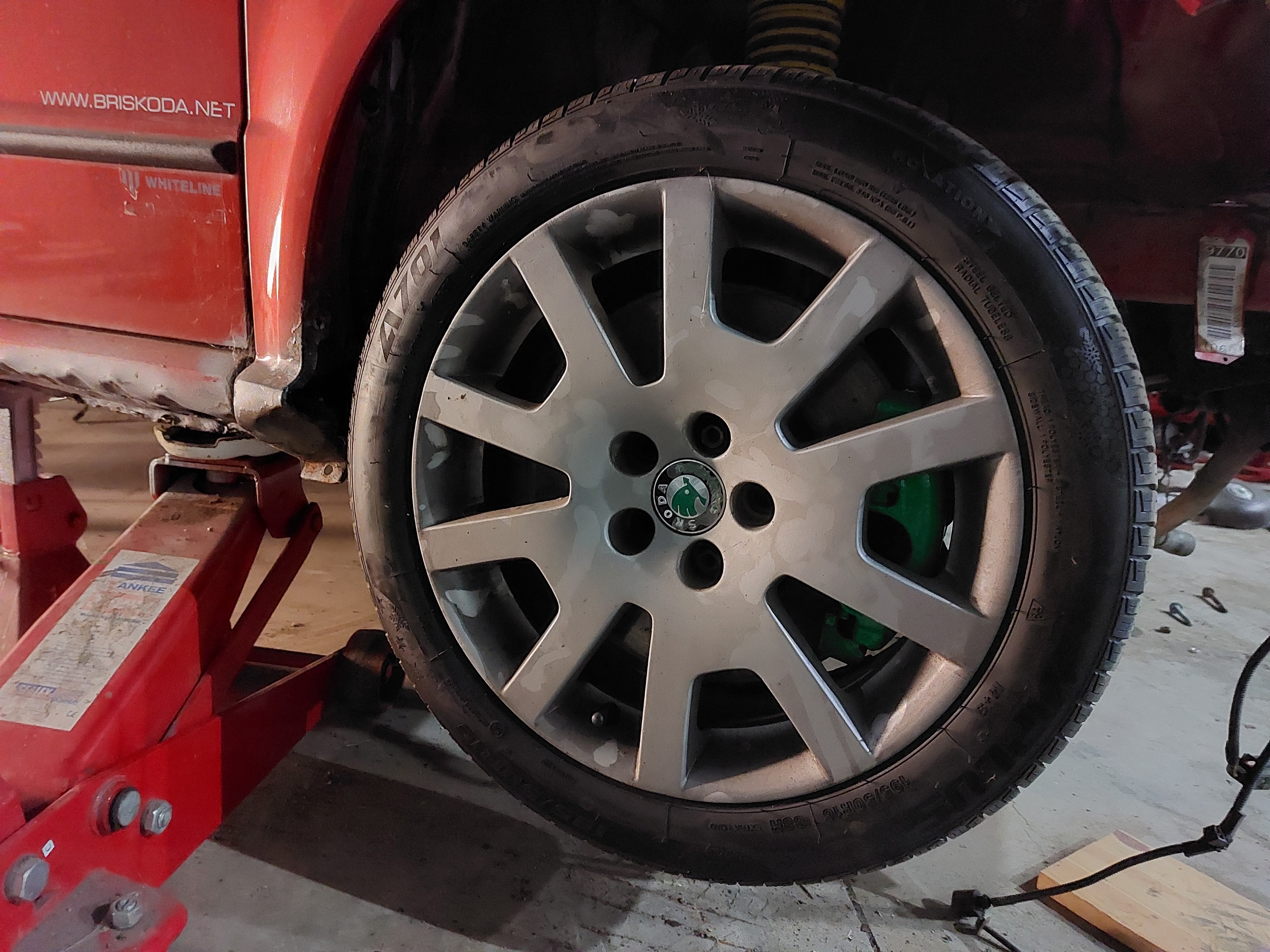

Test fitted the brakes today. Tried to do heatshields but the stub axle bolts wouldn't budge. So deleted them instead. Said before but old pads and discs on purely to get it moving. Will have new discs and pads when I can afford to.

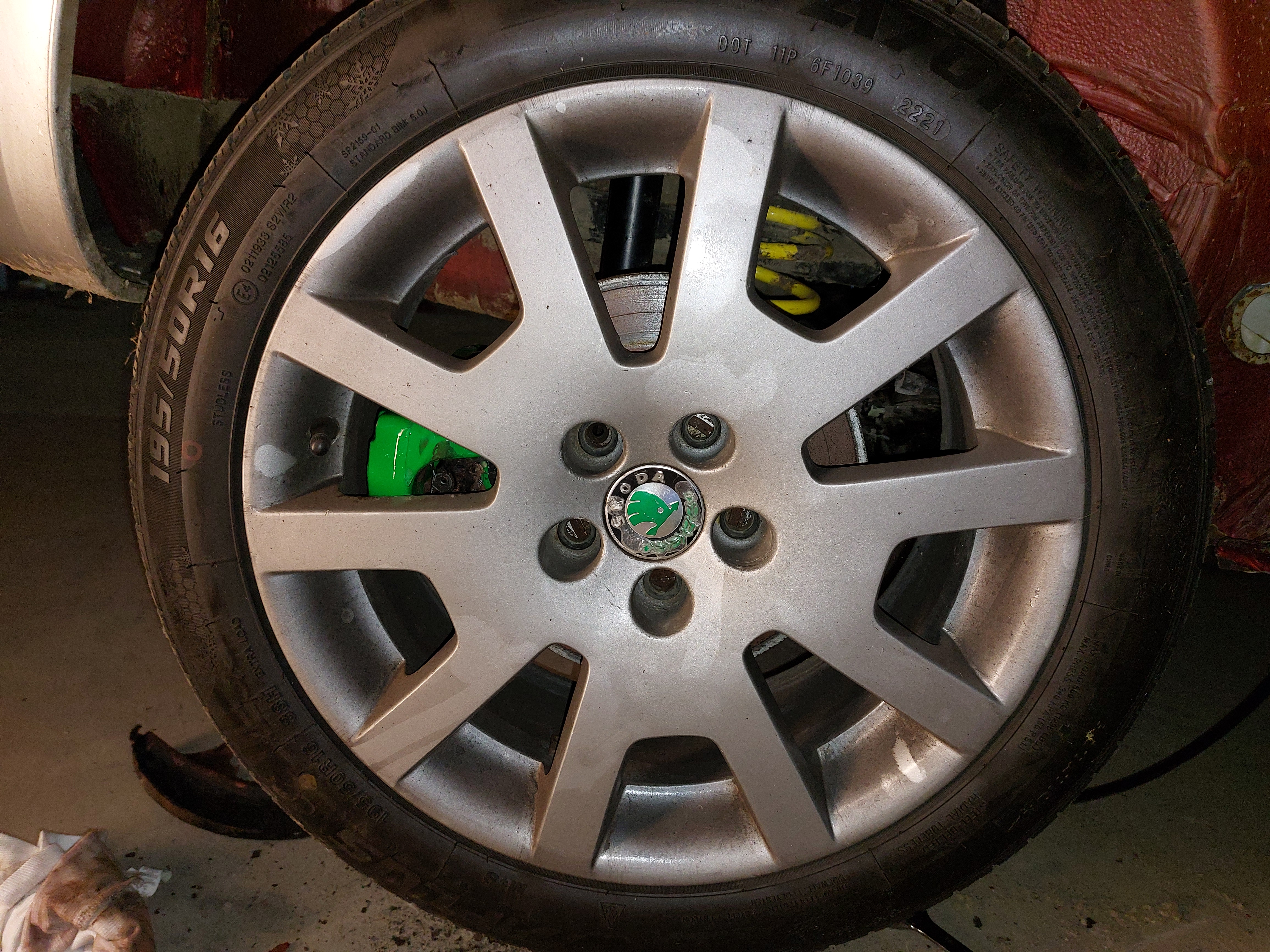

Carpet in. And made my way down the country to get some bits off of this. Namely... Full 312mm 256mm setup off of it. And the front lines to boot as they're nearly new. Better than what I have. Did try getting braided lines but mtec had em on backorder, so cancelled it. Was going to paint them silver. But they were mostly green, and I had the correct green so. Quick hit of green. Also got 256mm rear heatshields to go on too. Getting there.
