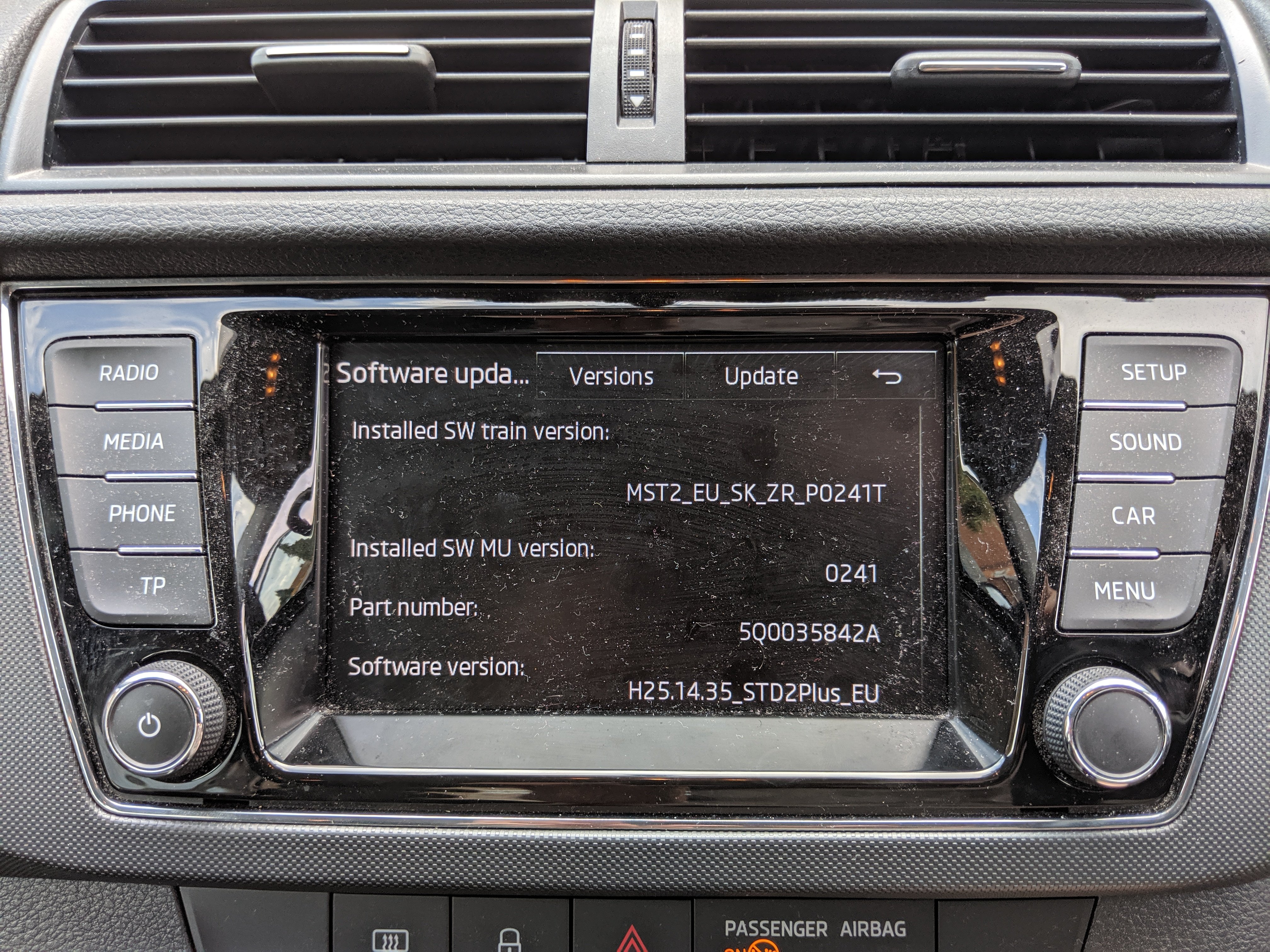

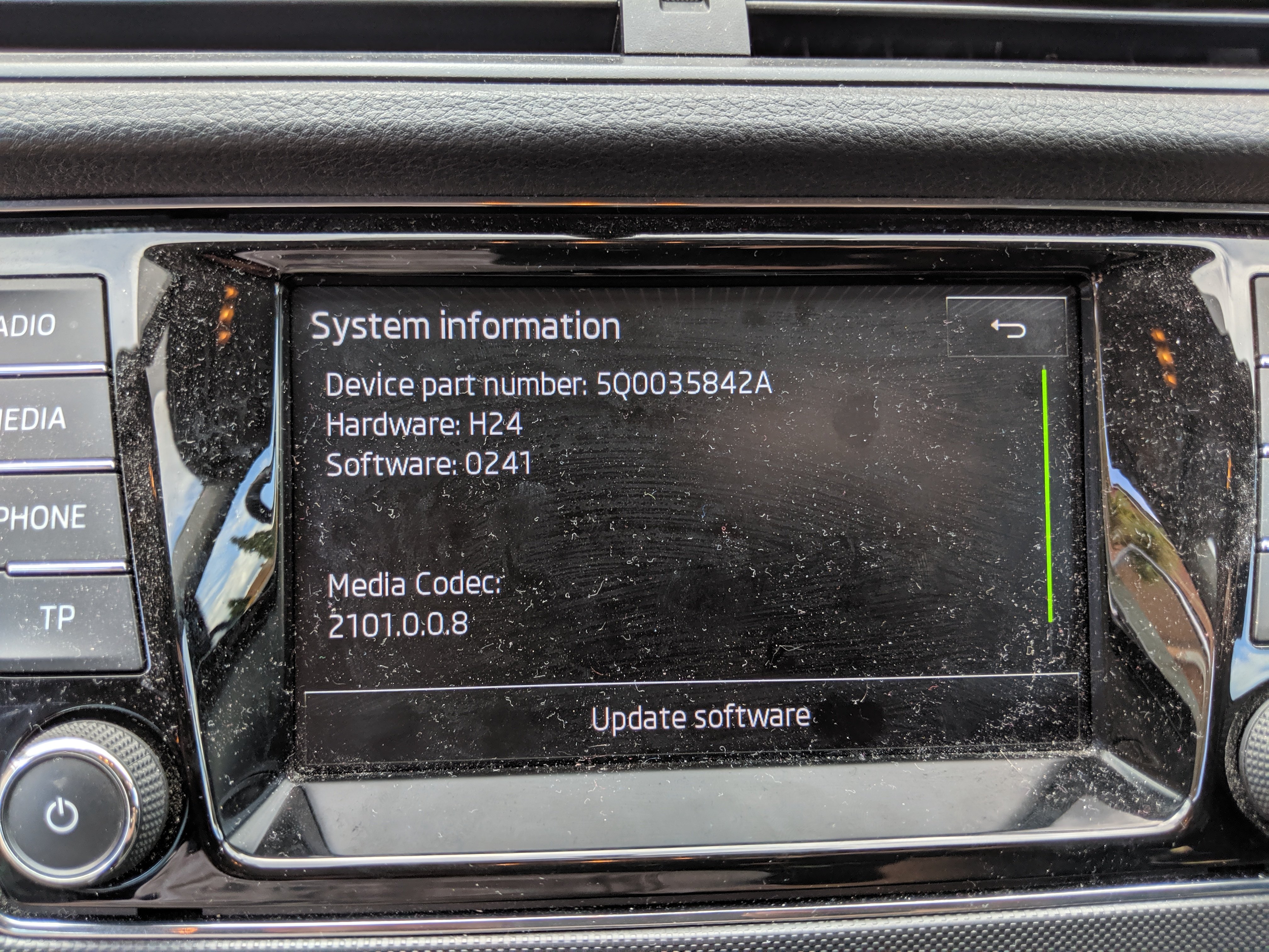

Is there an update to Infotainment System (5Q0035842A / H24) newer than 0241?
Bought a second-hand Skoda Fabia a short while back, as my first car after passing my test.  While I'm normally fairly tech-savvy, I'm a bit new to cars and infotainment systems etc.  I've found the service menu by holding down the [Menu] button and can see the software appears to be from April 2015.  I tried the Skoda update website, but it says there is no update available for my VIN.
I don't buy that for a second. that there isn't a newer version after 4 years, but have spent last few hours googling more info or a download link (which brought me to this great forum) but can find very little.
Any of the experts around here able to point me in the right direction? I've attached images below, in case helpful, and feel free to ask any questions.

Thanks @pab567. Am I correct in thinking I can do this by USB stick (FAT32) via the hidden service menu?  Don't have an SD card reader.

Yeah, I know there is one in the glovebox.   I meant I don't have an SD Card drive on my PC. I have no way at moment to get update onto an SD card.  The service menu listed USB as an option.
Got it :) Yes, you can do it from USB pendrive as well

@pab567 So my USB stick was broken, trying an SD card now, i've tried both the 7z itself (which i didn't expect to work anyway), and the contents extracted to the drive, which it says "cannot read version information file".
How are the files supposed to look on the USB for it to recognise properly? I don't seem to be having any luck at the moment 😞
My part no. is 5Q0035842A same as the OP on SW 241 also.
Edit: Never mind, i found i had to put the contents of the 7z in the base of the drive, making sure metainfo2 and all the many folders were there and not in any other folder.

I have indeed, it seems to be a bit more responsive with no little freezes and glitches, time will tell i suppose. I wonder if there is any more recent version? Googling the filename brings up a list of other versions which have higher numbers still, though i guess those are for different 5Q0xxxxxx numbers though?
