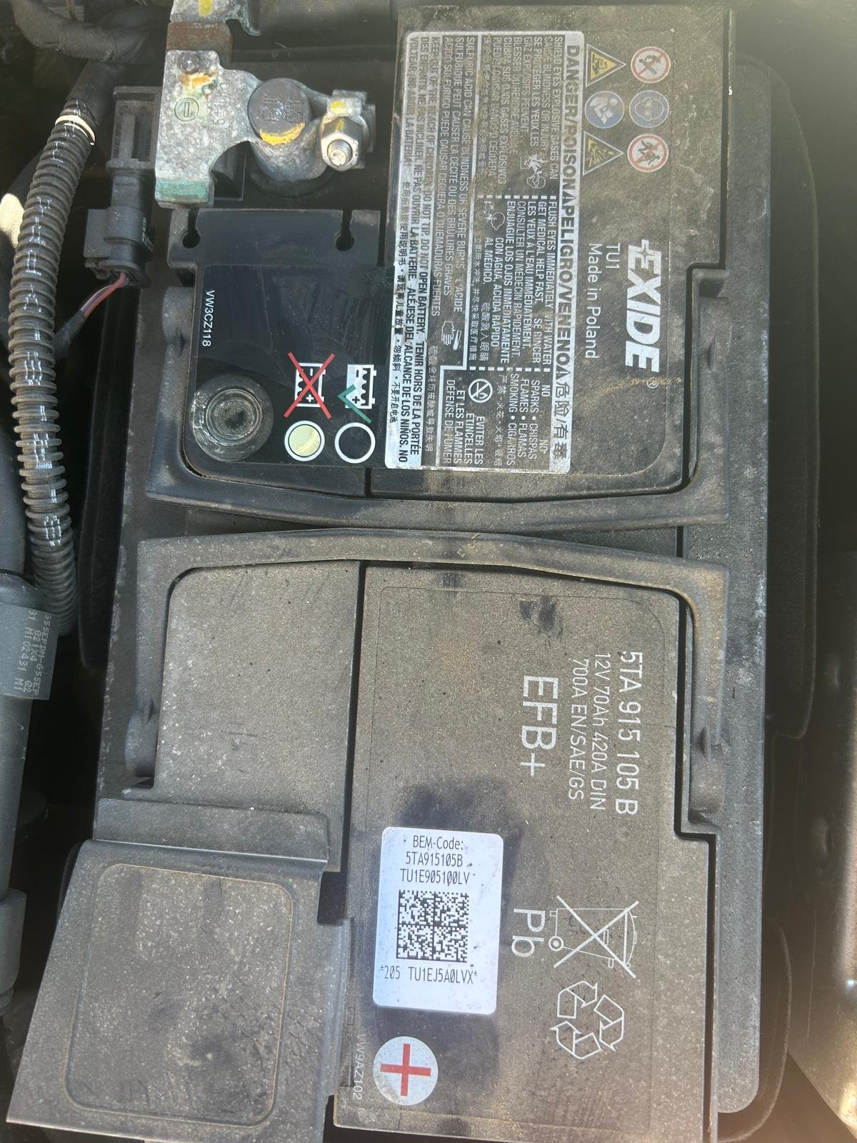

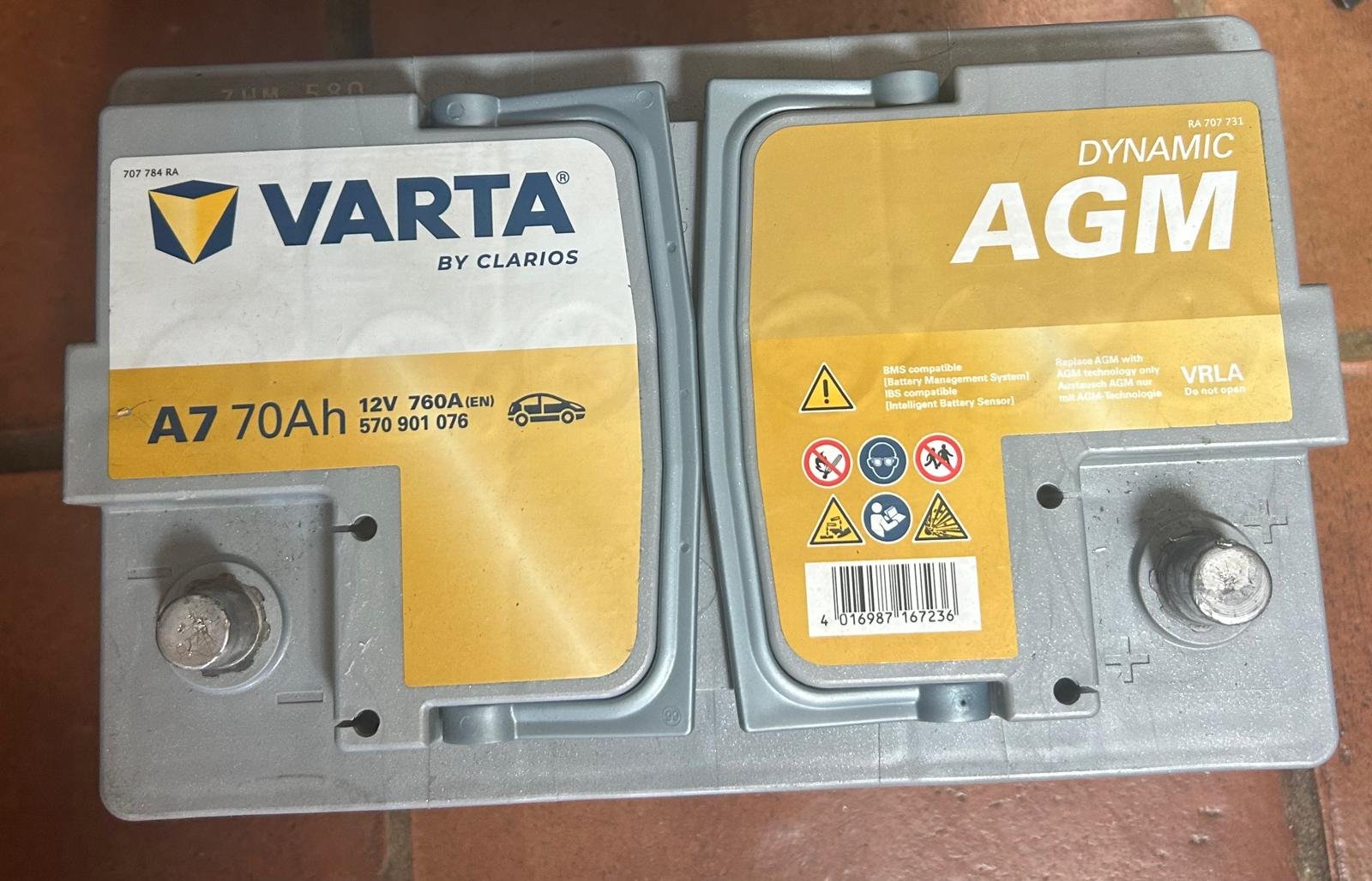

  2. Hi all, I followed this excellent guide - thanks to SomethingSuperbly - a change a dead battery on my 2019 Superb Mk3 estate. The car hadn't been driven for a while and when I first tried to start it I got a Glowplug warning and the car was sluggish to start. I then got loads of errors about ABS, ESC, Brakes, etc, so after some quick reading of this forum, I decided to upgrade my EFB+ (see picture) and purchase an AGM (as per picture). The uninstall and install went easy, the coded seemed to work (Fleece, VA0, 70ah, a new 10 digit serial number all using OBDEleven Pro. Excellent - the car started first time. When I watched the battery status in OBDEleven whilst driving, with foot on the accelerator battery showed as discharging, when i took foot off the pedal (rolling down hill) it showed charging at 14.7 Tested battery with a meter after stopping and it showed 12.7 Turned the car off, left overnight, tried next morning - wouldnt start - tested battery and it was 11.4v Any clues or tips where to go next with this please? Car is outside and not being used as cannot trust it! :-( Many thanks Paul

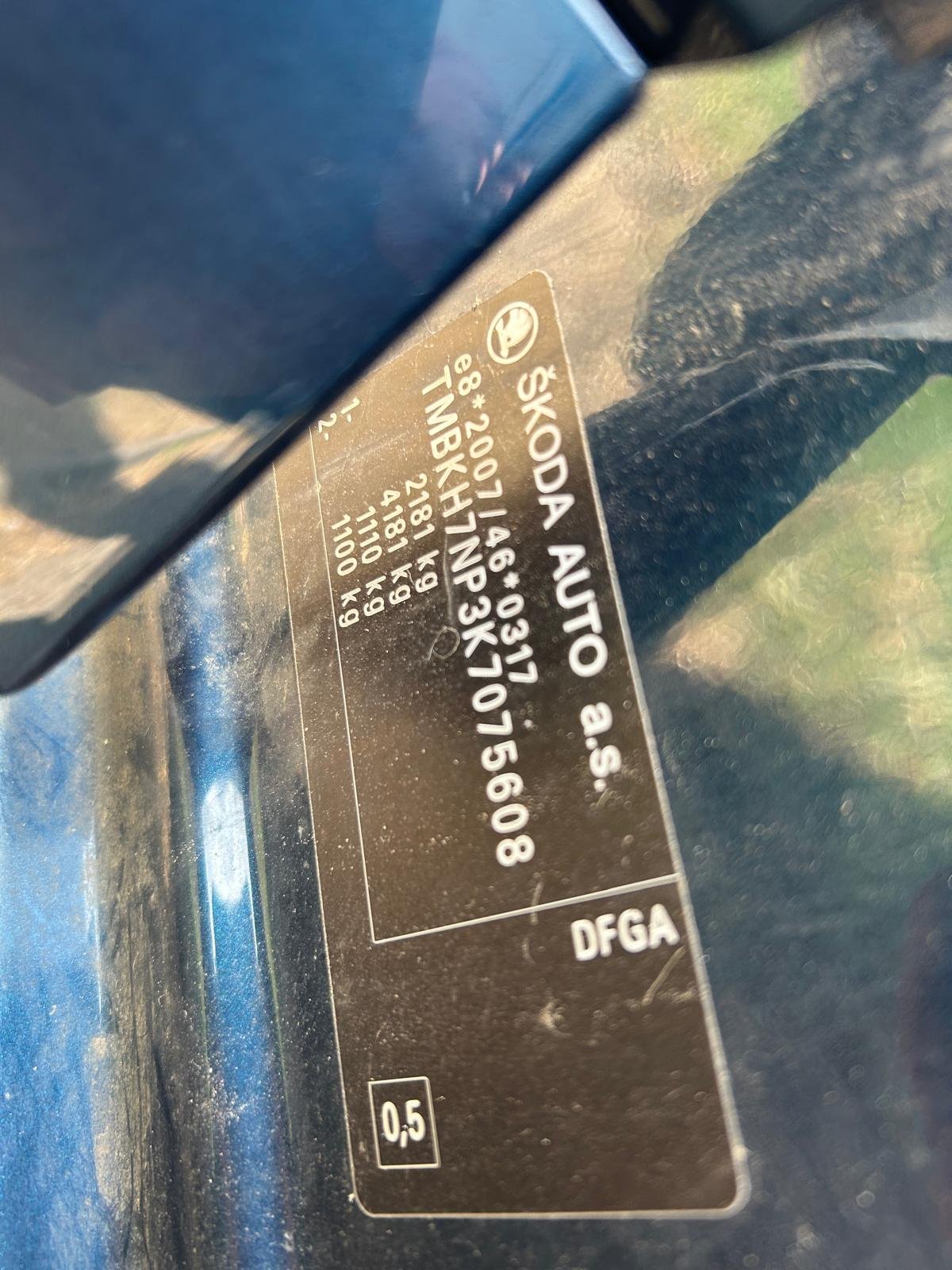

  4. Hi all, sorry to jump on the thread - might someone be abe to confirm the correct Blue for my 69 plate Superb estate please? Many thanks in advance Paul

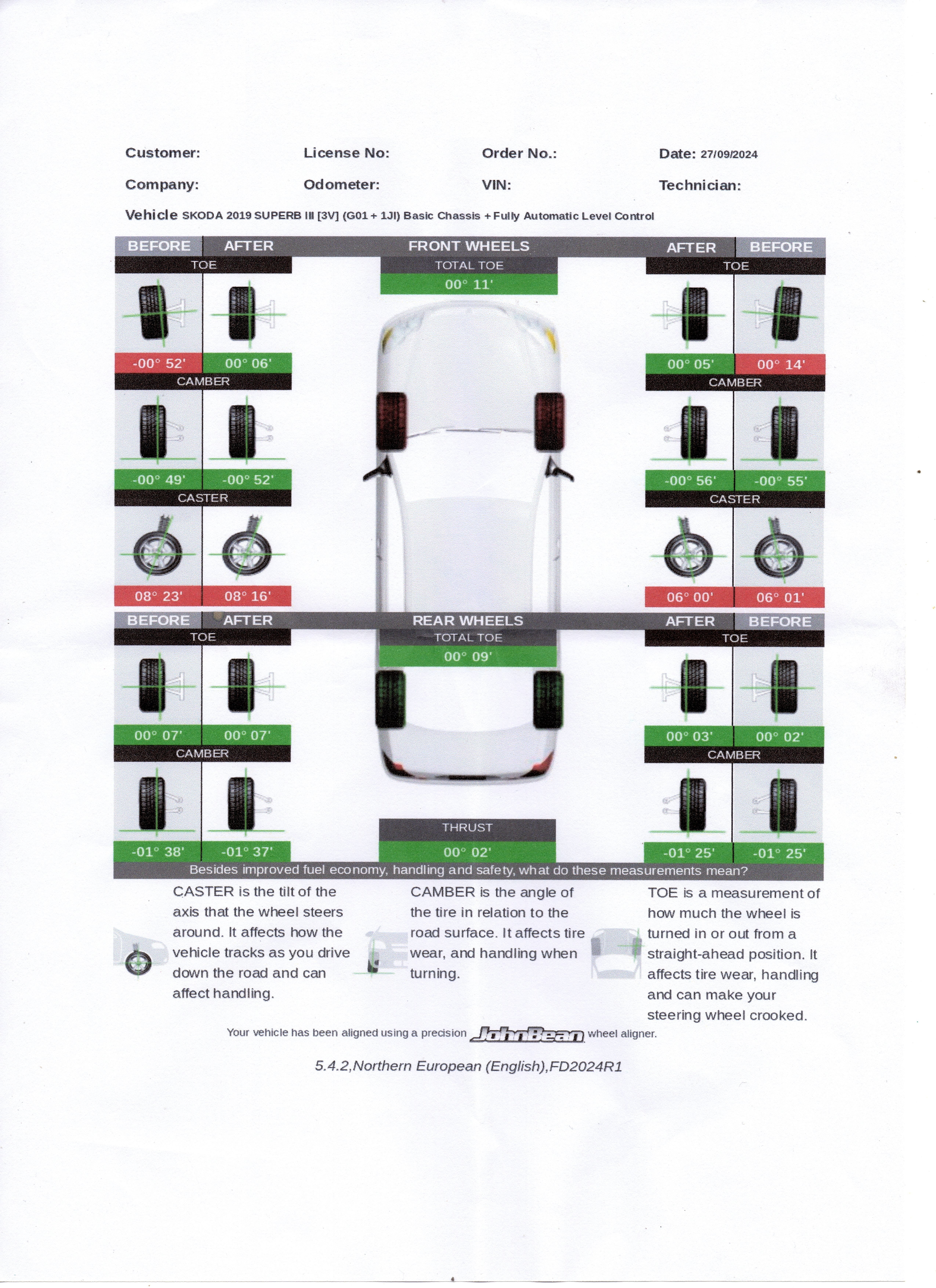

  6. Hi all, Was wondering if any technicians might have a look at the image and comment - particularly on the Caster reading... Just had the car in for MOT, Service, Alignment (due to both NSF & OSF wishbone replacement). Should I be concerned about the AFTER being RED on the Caster reading for both front wheels? Any comment / advice most appreciated... Many thanks Paul Skoda Superb SE L Executive TDI 150
