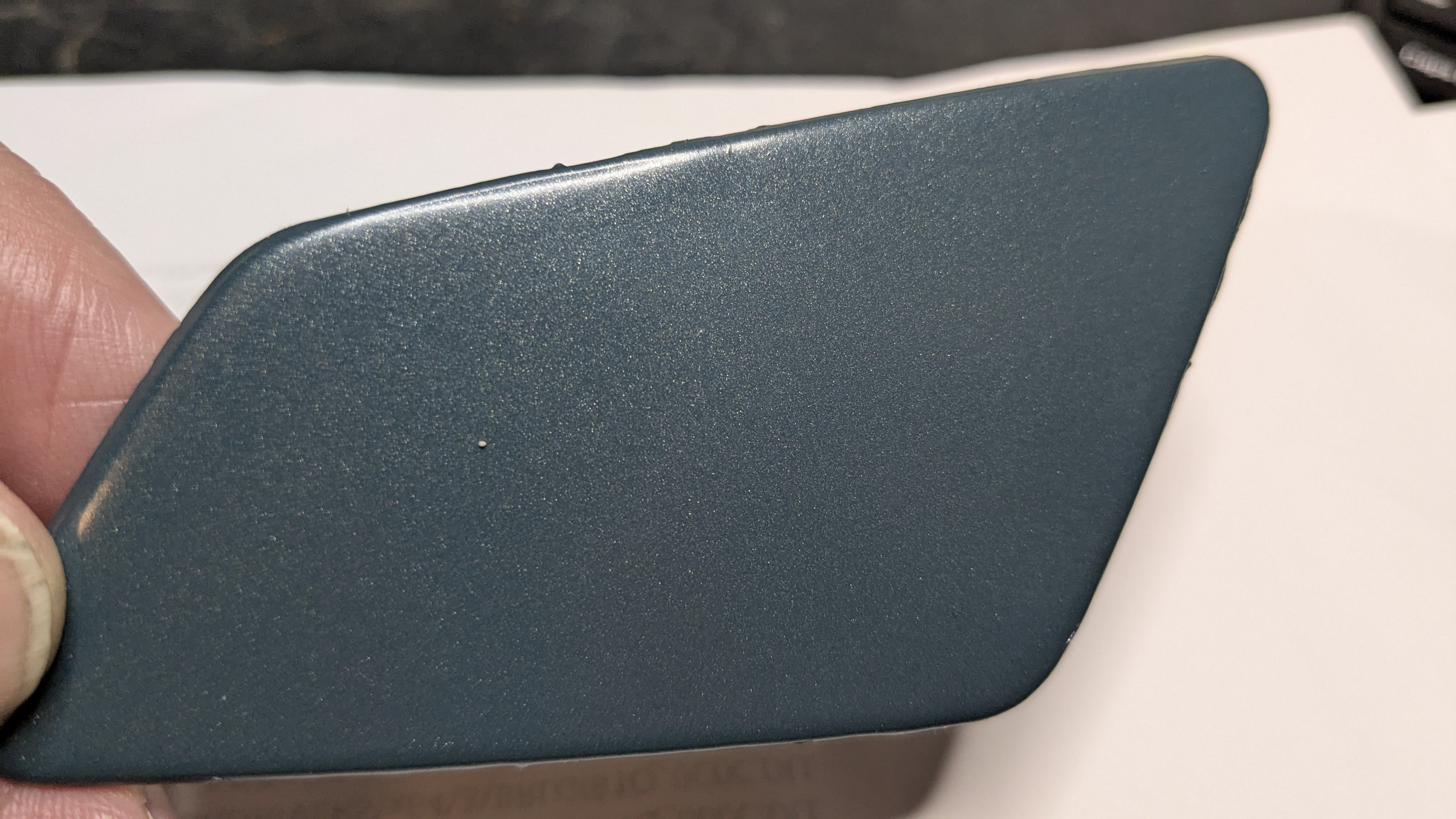

I need to purchase the correct colour touch up paint for my car. A while ago I lost one of the headlamp washer covers and sourced another replacement and found a online seller that claimed they had the right colour in stock. At the time, the weather was really suitable for spraying outside, but today it was ideal, and upon spraying the cap it is more greeny than blue.
I was told that the colour of the car is petrol blue, the same as my old one. I can't go back to the seller as it was purchased before Christmas so I doubt that they would replace it, especially as I have now used some of it. The colour on the cap of the spray is about right, but the paint is not.

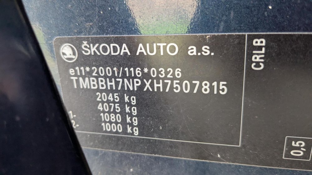

Yes it is but not displayed in a fashion that I can understand, it basically the Vin number along with vehicle weights.code.jpg

Ah interesting... I thought the CRLB bit was the code but it appears not...
  • Sponsor
That's his engine code.

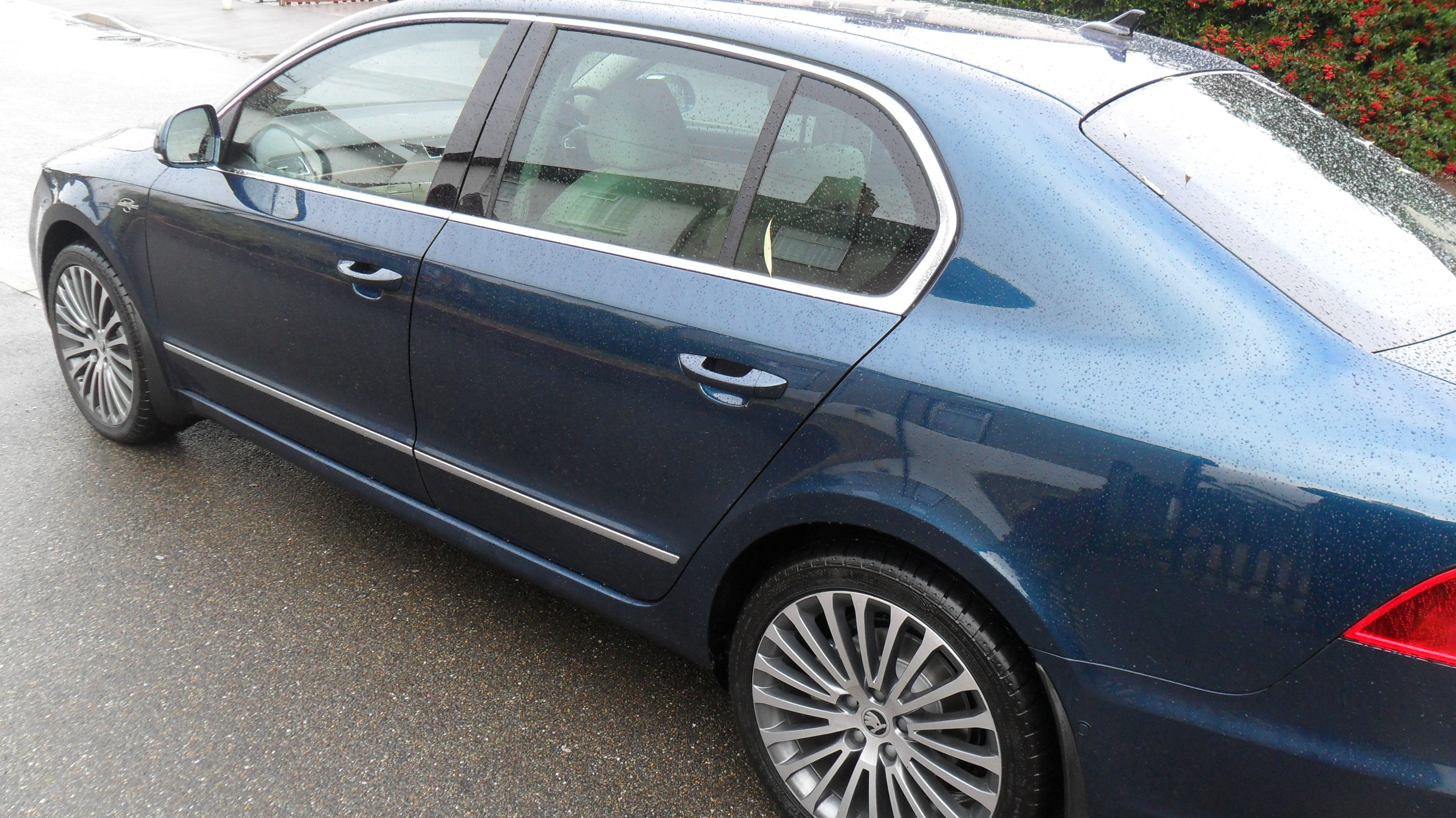

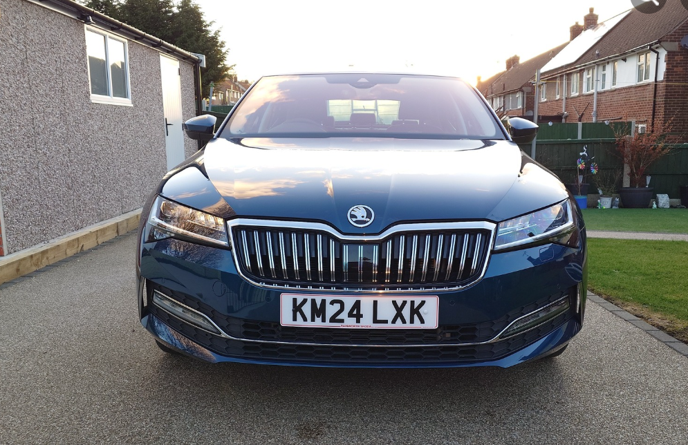

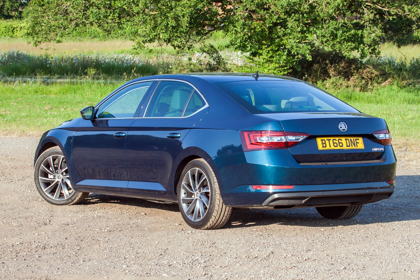

I agree, that is my colour, here are a couple of photos of the last 2 cars I had in that colour, the first is the one that was written off and the 2nd is my current car along with a photo of the sprayed washer cover.SAMSUNG ES28 - VLUU ES28 4000x2248_026584.jpgCanon EOS 50D 1600x1066_027805.jpgcover.jpg

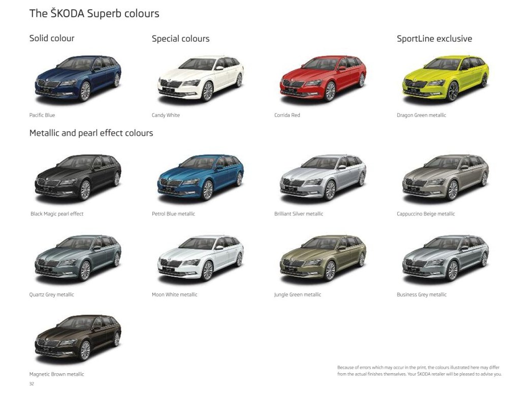

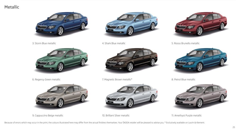

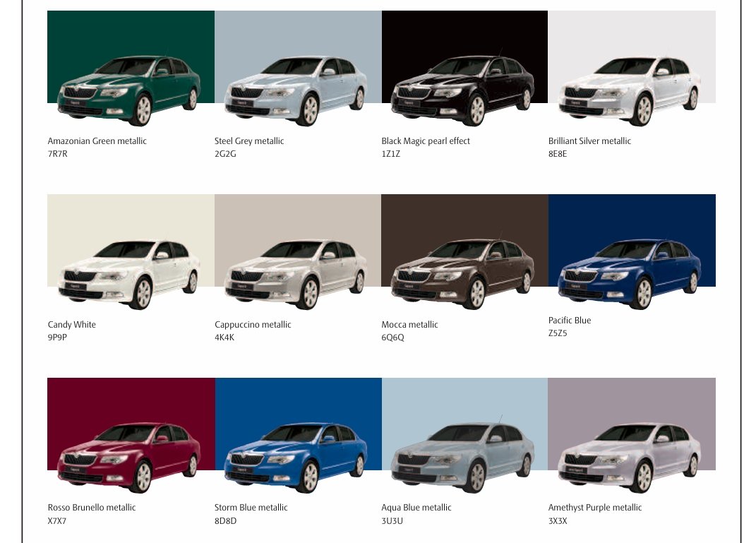

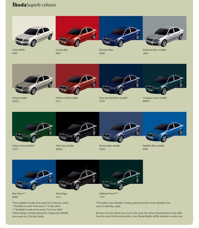

Over the years I have had 5 Superbs, 1st was 2004 Mystery Blue, 2nd was 2007 Cappuccino, 3rd was 2010 Amethyst Purple, 4th was 2013 Petrol Blue and current car 2023 Petrol Blue, colour charts below and there is no Lava blue2007.jpeg2010.jpeg2013.jpeg2016.jpeg

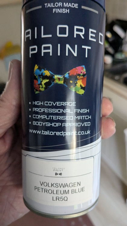

The code on the rattle can saya it's LR5Q petrol blue?

Graham that washer cap looks painted in a totally different color 😁

Here is the offending aerosol can, I gave the supplier all the info on the car at the time of ordering as well.
Lr5q is VW petrol blue that was used on certain VWs. It may have the same name but could well e a different shade to the Skoda colour... Hence the different code.
