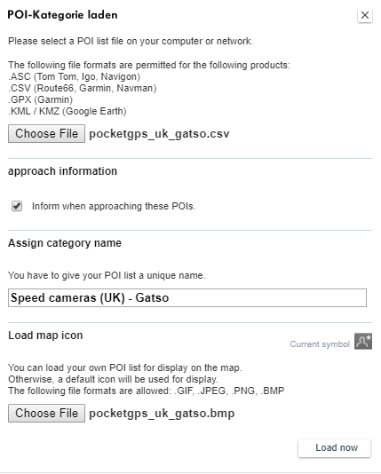

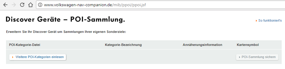

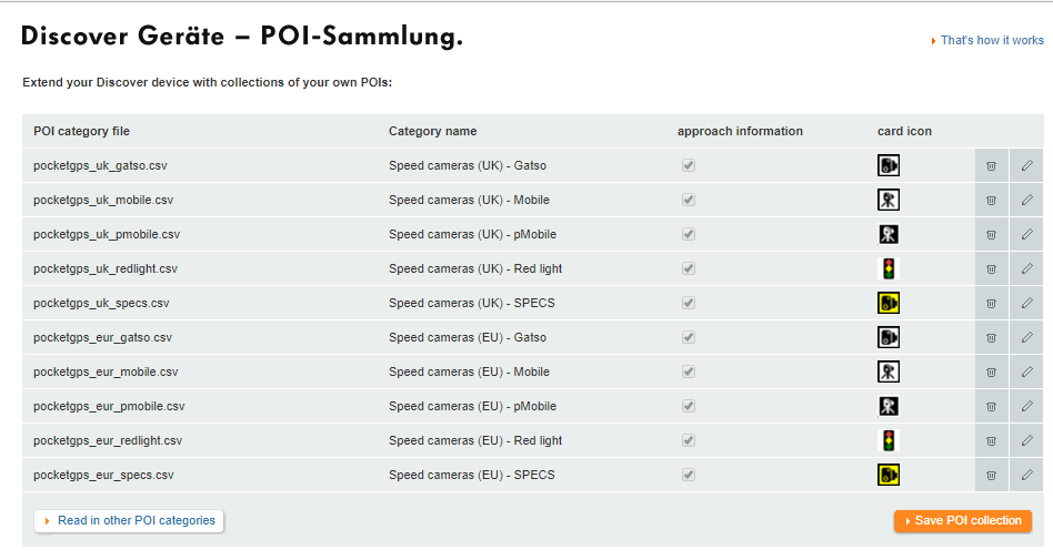

  • The format of the files is pretty simple, so it would be relatively easy to write a script which generated the database without needing to use the MyDestinations site, or 3rd party tools like POIBase.

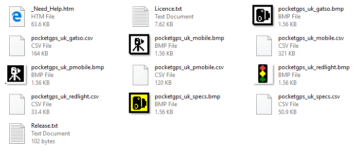

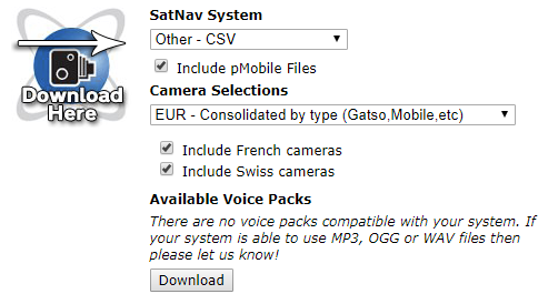

  • Since we now have a working process once again I thought I would summarise.  Below works on Windows 10.   1. Download the chosen files for your location from Pocket GPS World in ”Other

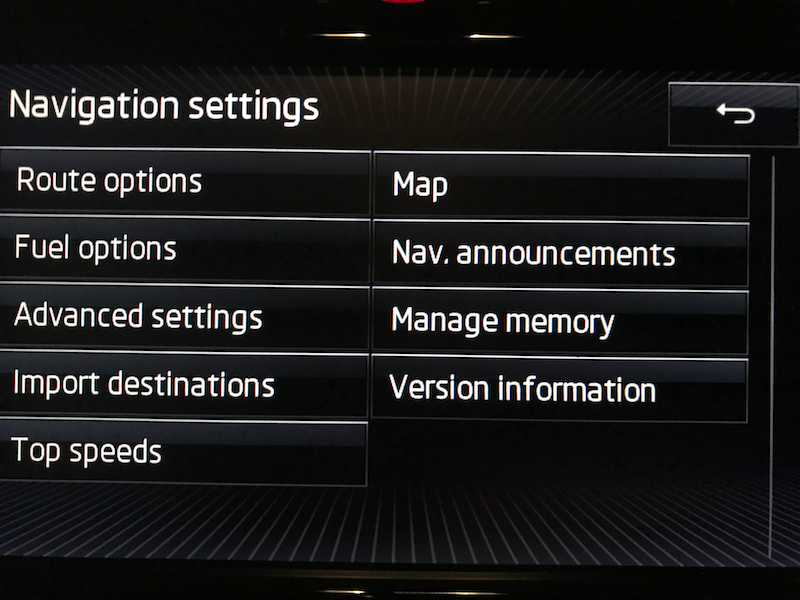

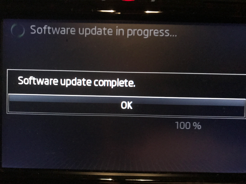

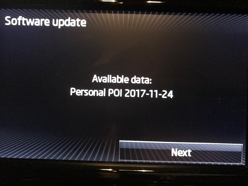

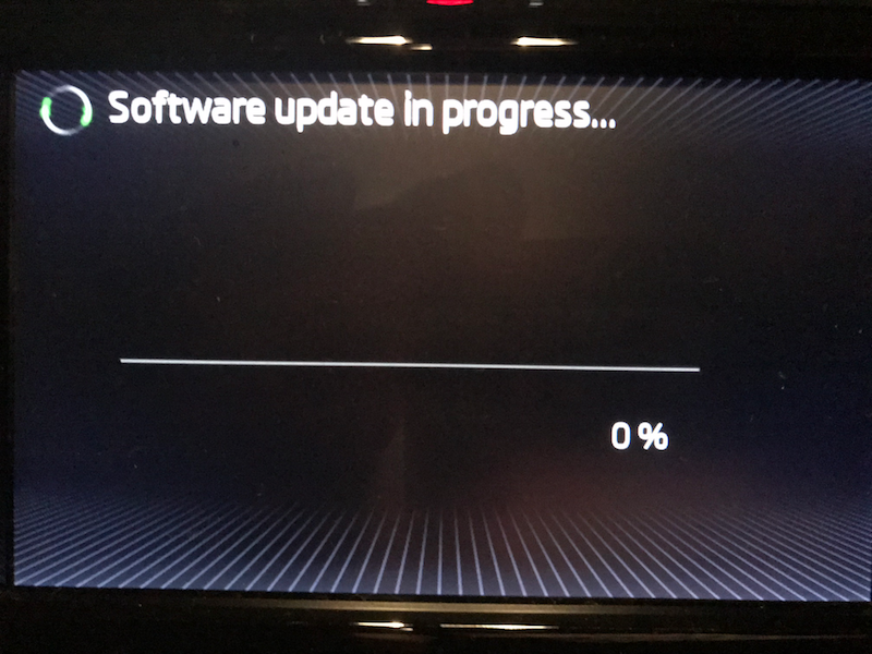

EDIT: Tried it and failed. Columbus searches for updates.
I popped in the SD and screen said 'update available'
Set it off to do the update, searched for ages
Error: No data available. Please insert a software source with software update.
Been through each step carefully. Shame that - would be handy.
Ta.

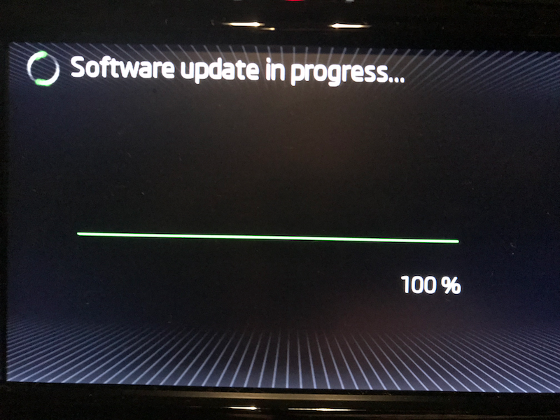

To whoever is reading. I had some troubles with this and went through a lot of trial & error. I went back and downloaded the files again, formatting the SD card repeatedly. Sometimes my car will find the POI files, sometimes it won't. I don't think there's anything wrong with the process, as long as you meet the prerequisites.
Maybe I was doing something wrong? I am quite methodical and fastidious. I didn't want to break anything. Suffice to say I persevered and got it working, but I wish I could tell you what the issue was...
Glad you got it sorted Jim. Could be a flaky SD card or hidden files (system volume information etc, if Windows) causing some issues perhaps. I do this every week for UK and EU cams and never have any issues these days, so probably just a mis-step or Gremlins as I said over PM. Either way you're up and away now so enjoy the peace of mind. Cheers. :thumbup:

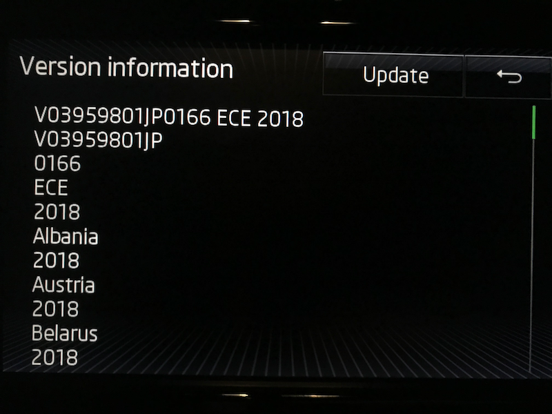

Thanks a lot, I've been trying to do it for a few days now and your instruction helped me a lot.

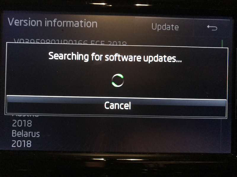

There is one thing - when I went to the update version menu, it took a very long time, after some 7 minutes of looking for updates, I went back. I went to the import destinations menu and from there it went fast.
Not something I’ve ever encountered but I’m glad you managed to follow the guide and get it working ok mate.

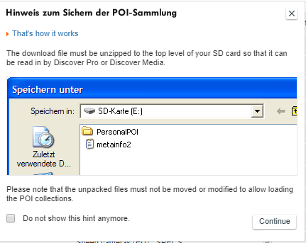

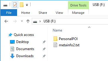

Thanks, Rainmaker, great guide.  One question. The PersonalPOI download has three subfolders, MIB2DE, MIB2HIGH and MIBTSD. Each of these subfolders contains a metainfo2.txt file. Do you delete these and replace them with your Skoda version or leave them as there are?
Thanks Mike. :thumbup:  You only delete/replace the one metainfo2.txt file that is outside of (or 'next to') the folder. You leave the others as they are. I hope you had a great Christmas, enjoy what's left of the festivities.

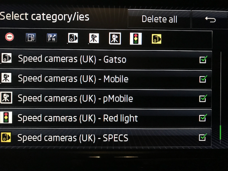

there is a flaw though....lol:sadsmile:.....after having downloaded the speed camera files onto the sytem,i decided to add some more Pois.i downloaded the caravan club site files and went through the same process as the guide and they were configured exactly the same,spot on i thought.
i inserted the sd card,it picked them up and installed them,brilliant i thought.....looked for them on the system,ticked them ....oops...wheres the speed cameras?????.
beware,if you install any other pois after installing the first set,the second set overwrite the first set,therefore deleting them.only way round this looks like configuring everything together in one batch...ie cameras caravan,caravanand camping etc etc,which can be done as i've tried it and it works.

it really is very simple,just remember at the end, to substitute the metainfo text file created by the programme,for the one you download at the end of the guide.once downloaded,put it in a folder so you can copy and paste onto the usb,sd card you use to put the pois on your system,that way its always there.
