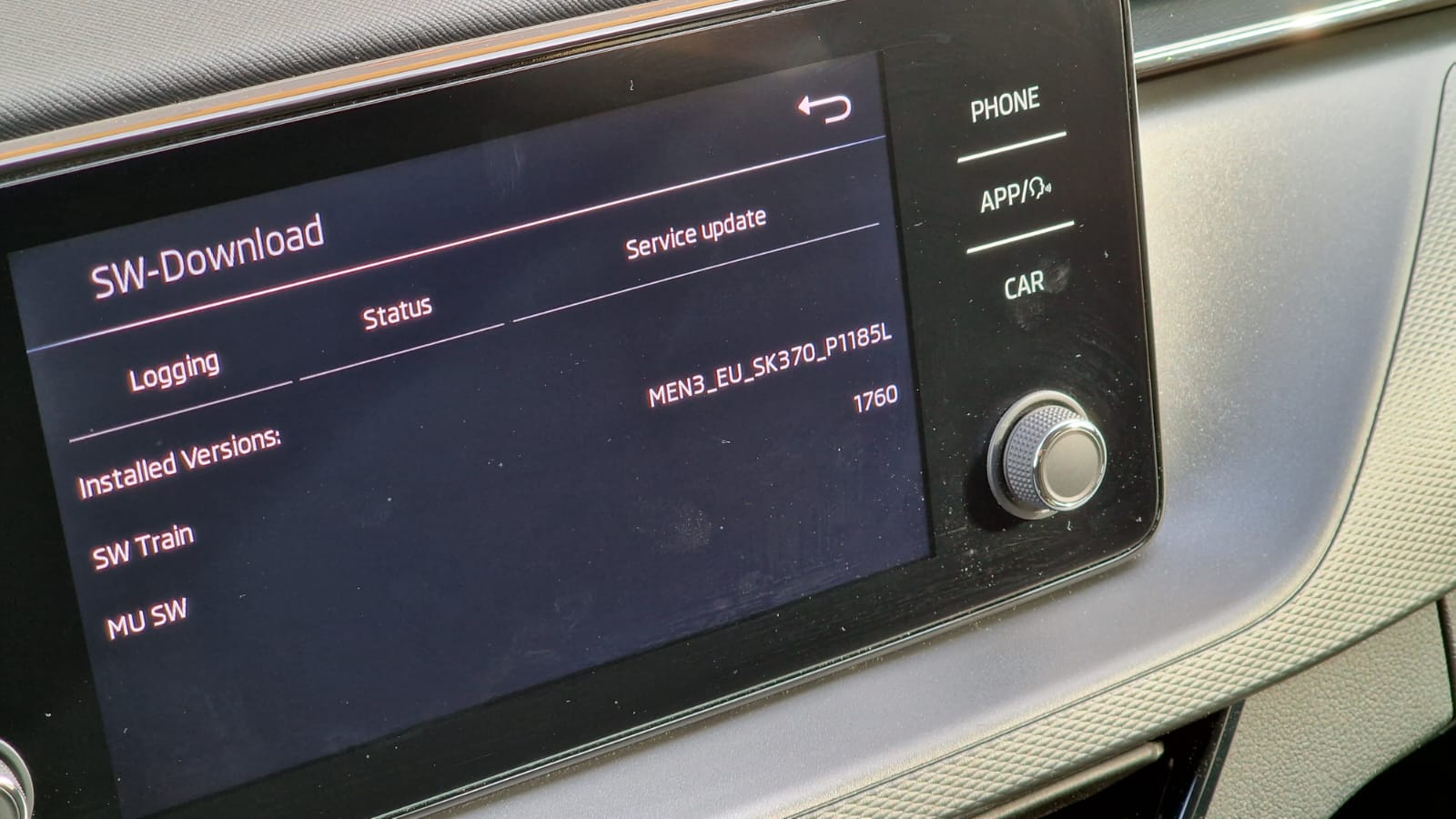

I got an answer (translated) from one of Skoda's dealer in Romania. Asked them if they could update with 1790 from 11.2022 When an update requested by the manufacturer and carried out by authorized personnel (representation service) appears, you will be notified. The other OVER THE AIR updates are carried out by the customer from the infotainment system.

So the warranty will not be voided ? Does it erase data ? Or just updates as eg mobile phones do when they upgrade?
Samsung Galaxy S22 series failes to connect to Android Auto
Not sure if that voids my warranty or not. I presume that they are protected from incorrect softwtare being applied.
Most likely not over OTA as i kept checking, will try my luck with the dealer. When i told them that i need to check for new software it's like they have seen ghosts Thanks
Can i get that from the service ? Do we have a change log on what it updates ? I have asked once my Skoda dealer if there is a new software and they say it does not. Also not sure if it fixes this.
