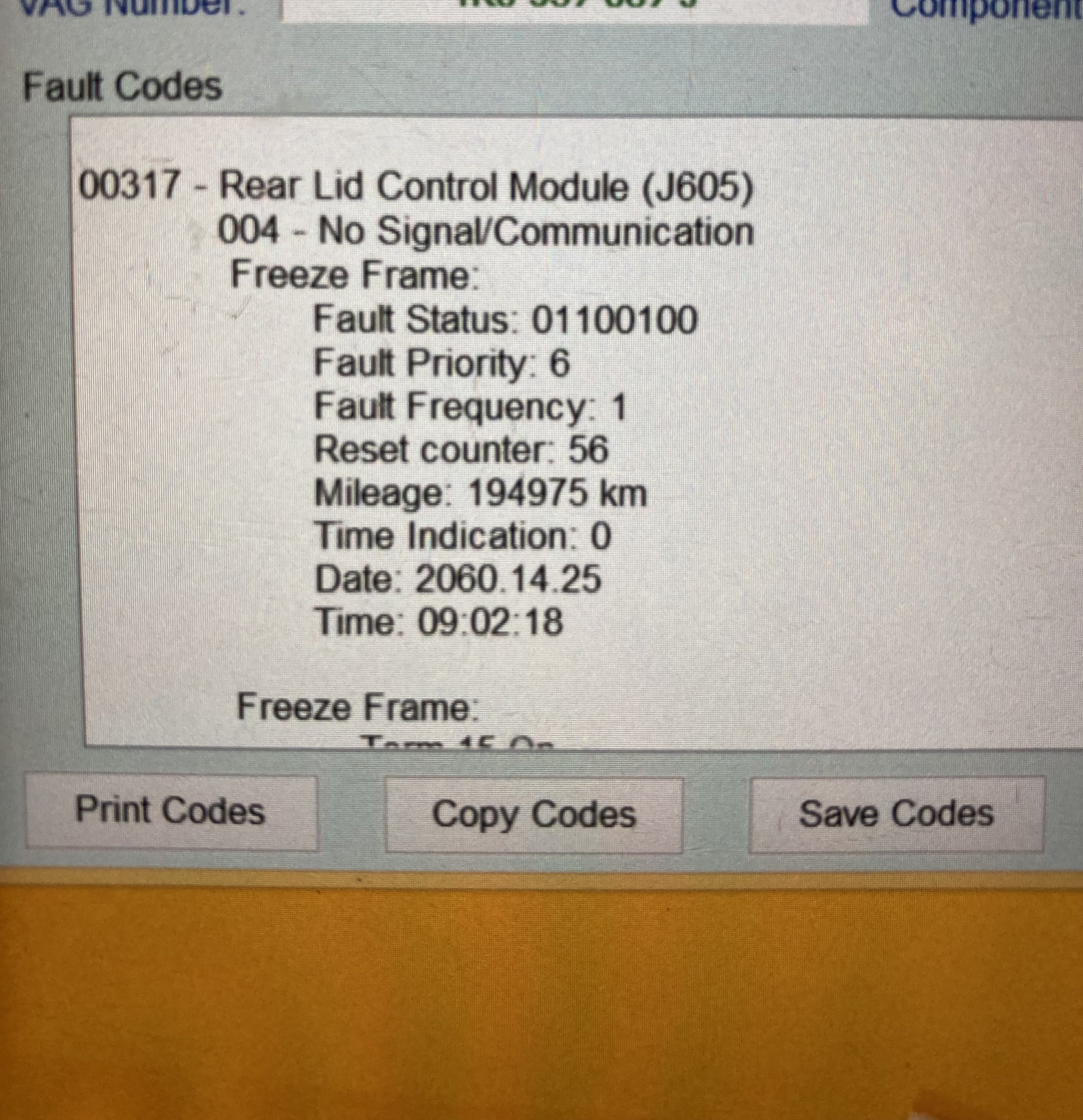

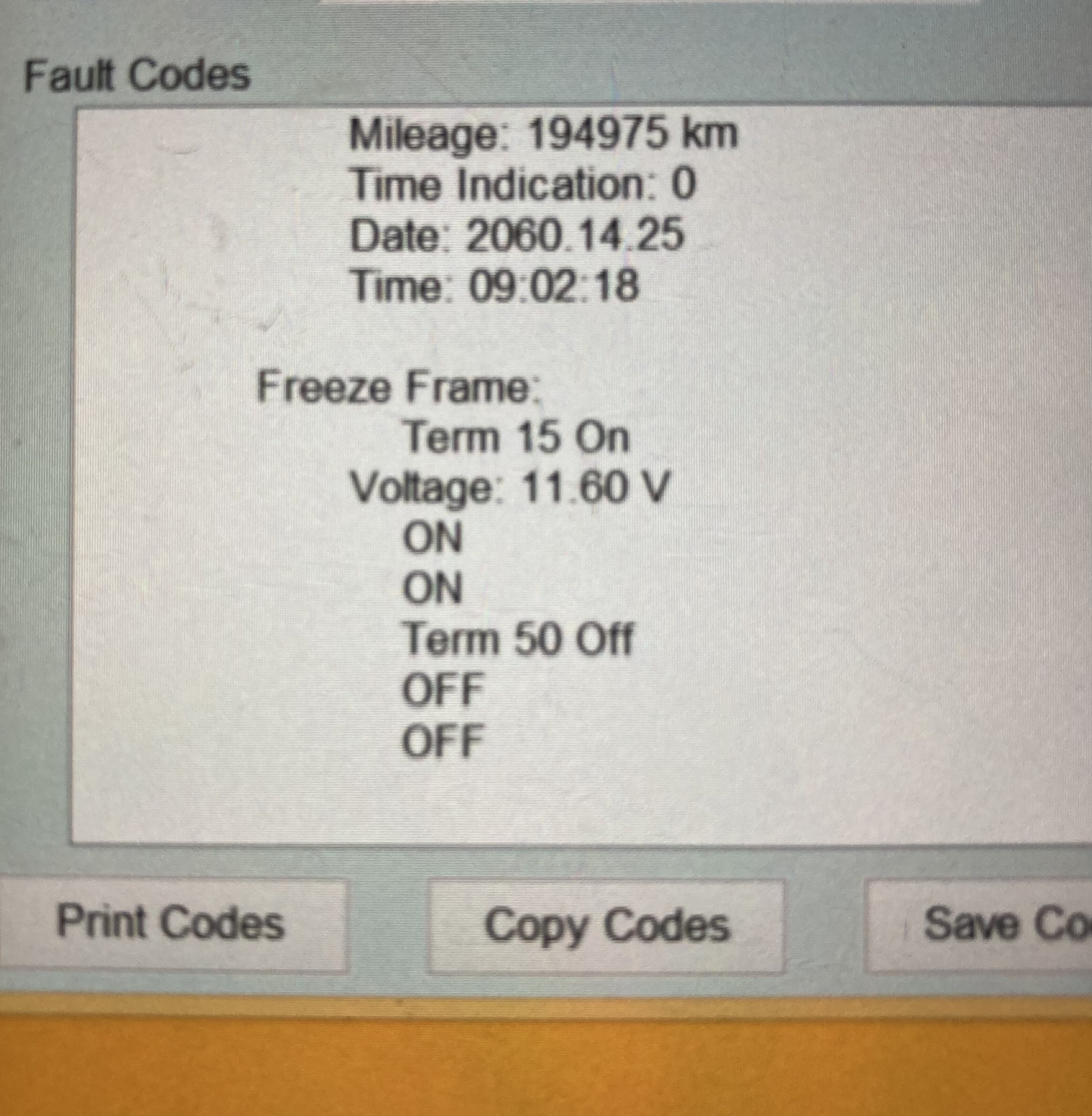

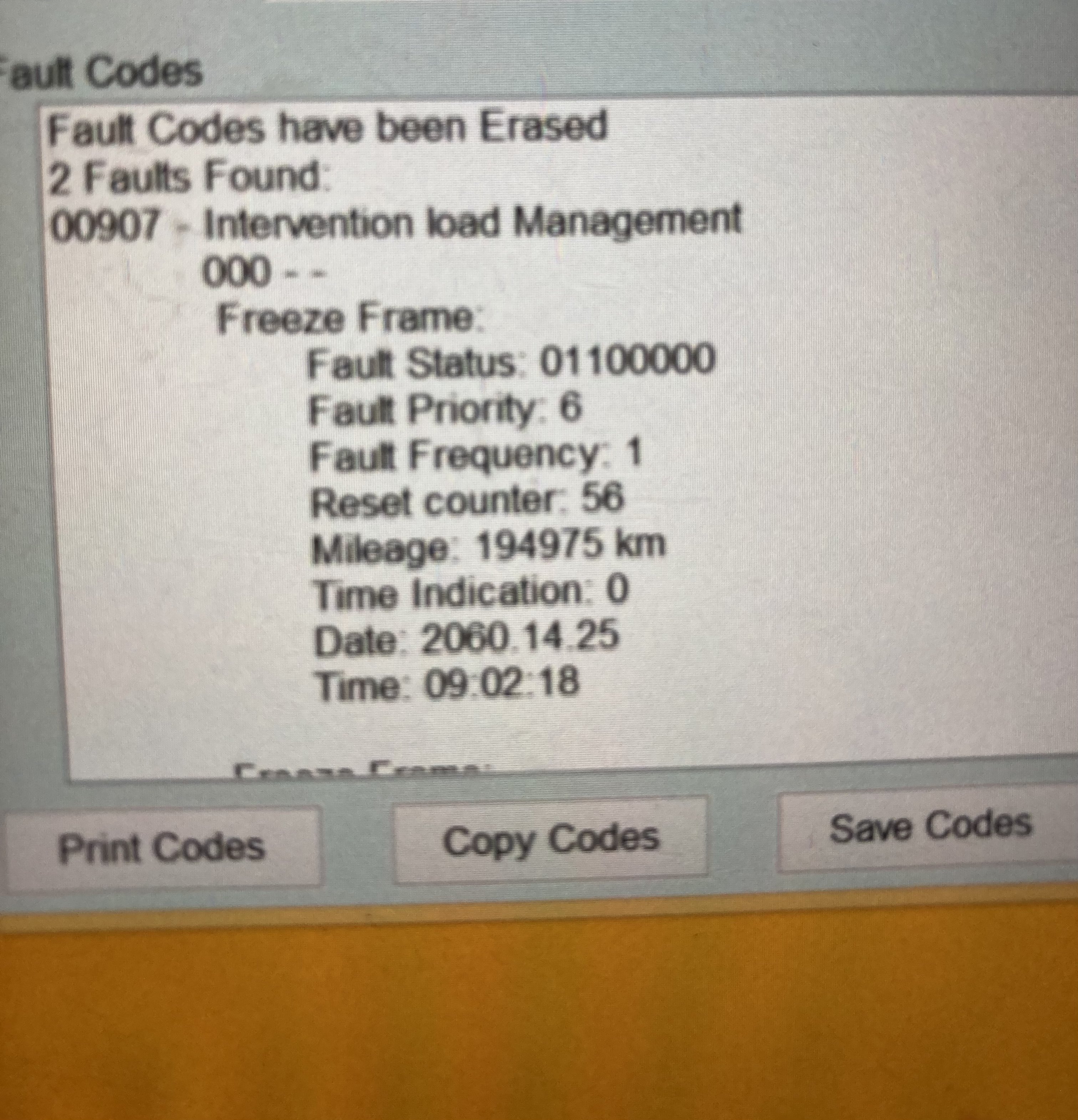

Many Thanks chaps for the help thus far,i have just had a spurt of water from the rear washer on the estate for the 1st time since owning the car!! I went out with the torch and vcds and following nige8021’s guidance I went in this path…. Installed 09- Central Electrics Output Tests -03 Select a Test Windscreen Washer Rear And it worked! Although not a fan shaped blast of washer fluid but the motor sounded strong. Now going back within vcds I checked fault codes in central electrics and 2 came up that will not stay cleared/erase. The photos are below J605 is Rear Lid Control Module Not sure what the other code is Any ideas what these are and where and how to replace the Rear Lid Control Module please folks? Or maybe I have to do an adaption with vcds?? I did,some months ago,replace the rear wiper motor and arm as that only ever seems to work once when I reverse the car. Maybe I have upset the system and would be great if I don’t have to keep throwing parts at the car too…. Please let me know your thoughts and I will deffo keep updating so as to hopefully help someone in future. Thanks very much

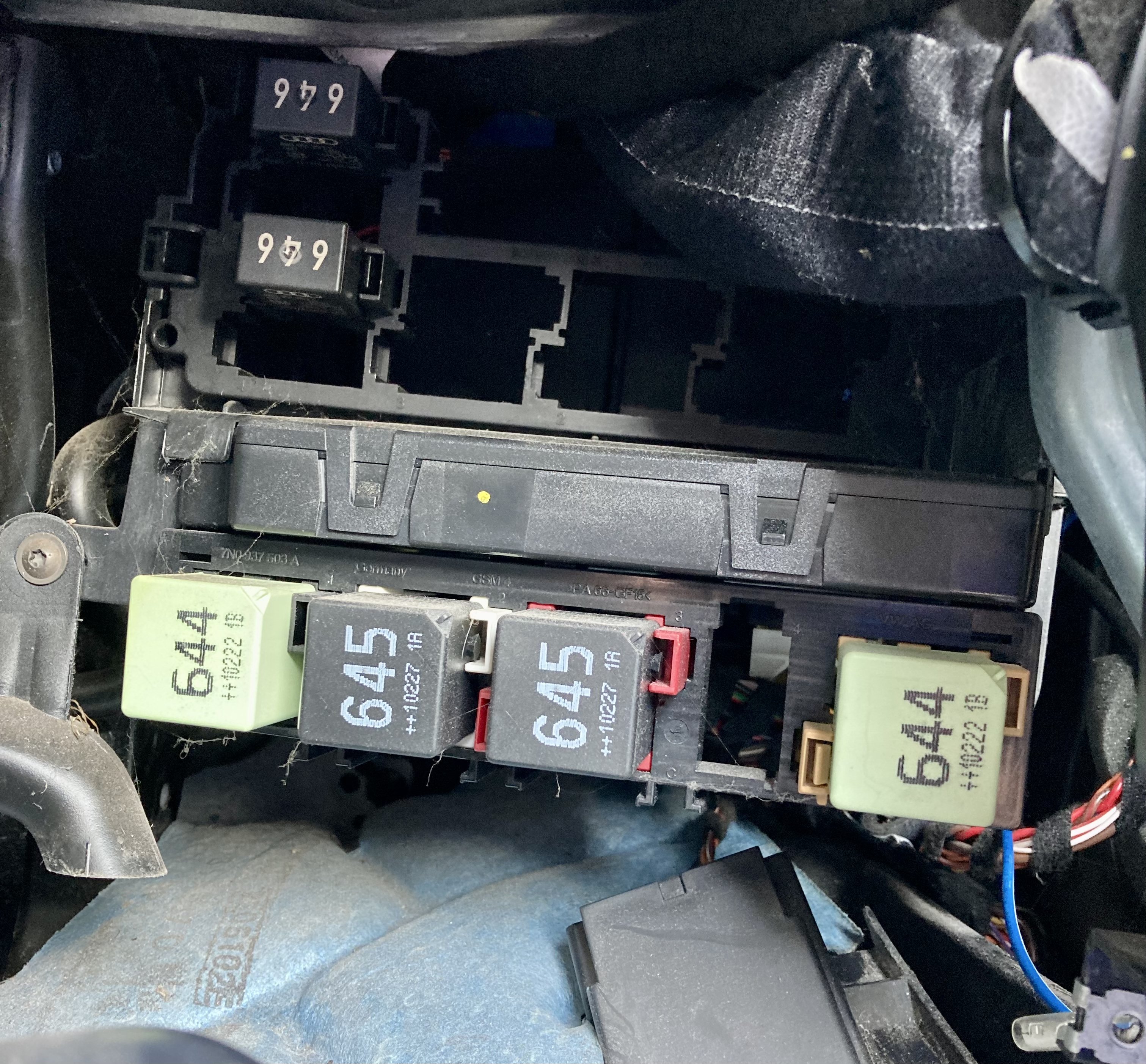

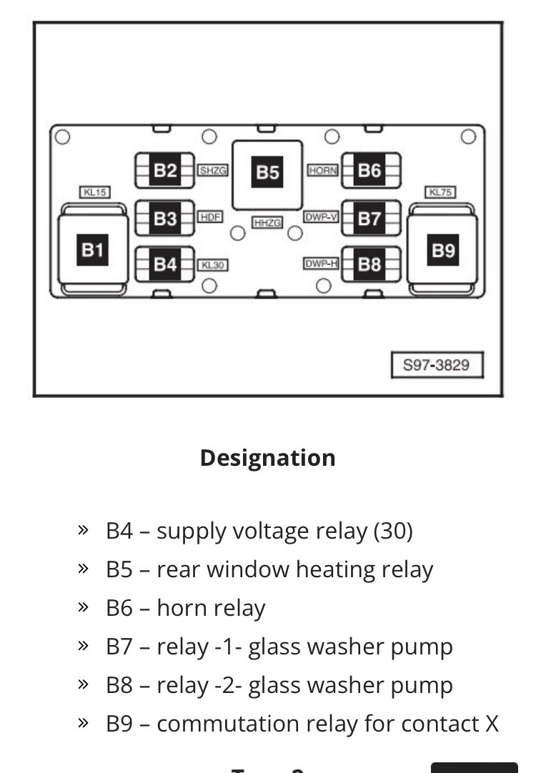

Well another update.There is no relay board on passenger side under the glove box. Went back to the relays under the steering wheel and swapped the 2 small 646 relays at the top on my photograph. Still no different.The front washer works but the rear screen washer does not. Any help or guidance how to find this with vcds would be great. Thanks everyone

Thank you very much MicMac. The rear wiper which I changed the motor out on a few months ago,does indeed work when I reverse but not the actual water jet at all,no noise,nothing. I swapped the pump out last night as well. Just taken the lower steering wheel dash apart to get to the relays abs they are not the cluster of relays I need. Now I’ll have to take apart the under glove box fascia off to get to the relay cluster I have shown in my above diagram. Aaarggh! Would be good if someone could guide me through using vcds to check the rear wiper if possible please. Thanks again,I will keep you all updated

I’m Still looking for some help but may I add this too as I Found this relay layout for my vehicle FL Mk2 …. Either B7 or B8 relay? hope that helps someone in future

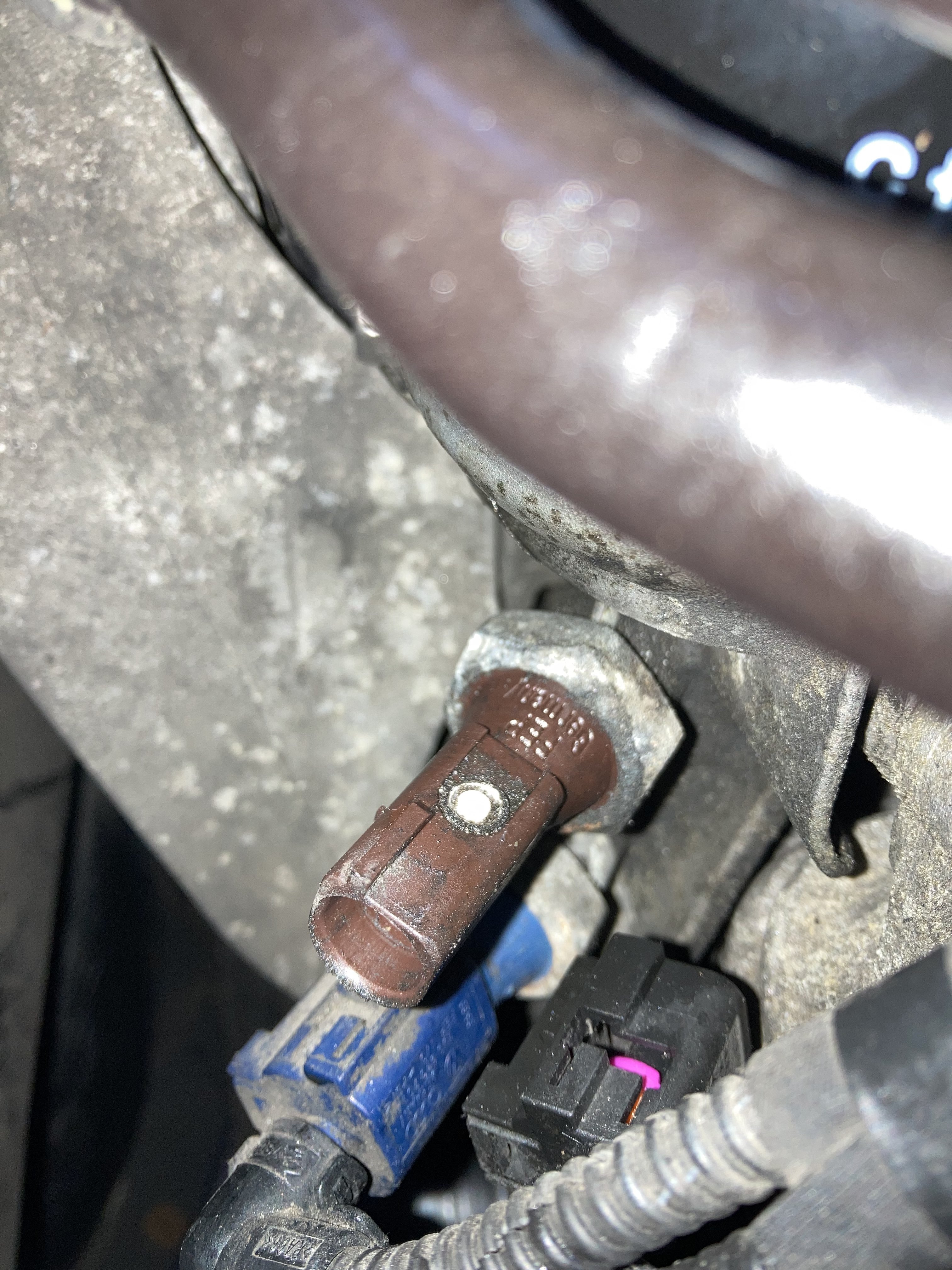

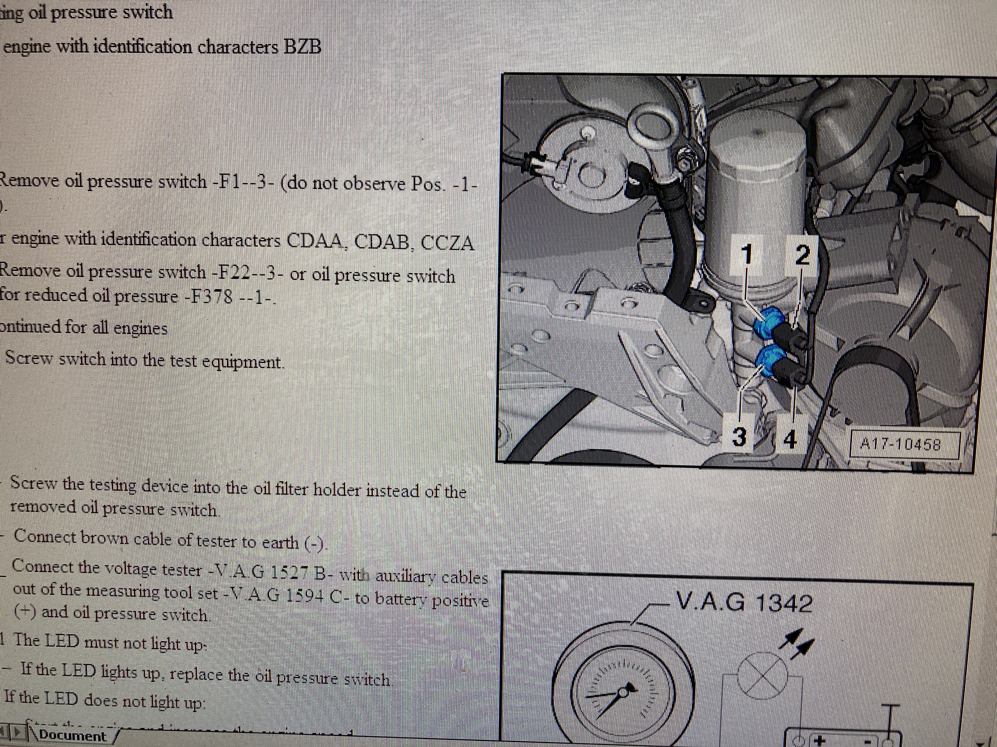

Found the oil pressure switch on the ccza engine guys. It is really easily accessible just underneath the oil filter,a brown colour switch/sensor which is above a blue one,but needs a deep 24mm socket which I’ve ordered. There was no oil leak present on mine,I’m a bit disappointed to be honest as I was hoping this was the cause of the oil leak on top of the turbo oil inlet.Like I say,I’ve just changed out the gasket for that so I will monitor it plus plug vcds into the car every few days plus keep an eye on oil levels. Thanks again and I hope this may help someone in future.

This has got me wondering now…. The oil leak further up and not a gearbox seal/flange at all……. The other day I was spiritedly putting the boot down as just coming into a dual carriageway.The car seemed to safety lunge slow down and go into a limp mode of sorts. I pulled in straight away and stuck vcds on it.It showed P164B-Oil Pressure switch-intermittent.Cleared the code and carried on. Friday morning I changed out the weeping with oil,turbo inlet gasket and car does seem to be better.Gasket was quite rusty/rotten. I now have a new genuine 038919081H(C or K) oil pressure switch.I have been reading a lot on this today and it could actually be the culprit.even spraying oil down as far as the driveshaft/gearbox area that has oil on it….. What do you think? I will change it out tomorrow morning anyway as it was only £7 odd.Apparently these are prone to leak either in the thread to engine join or inside the actual sensor wire region also. Today Just for luck I put a new Maan oil filter in,my previous Bosch had only done 3000 odd miles but it gave me some peace of mind and I also replaced the fuel tank area inline fuel filter as I’d only changed the engine fuel filter when I bought the car. Let me know your thoughts. Thank you for your help and I will post my results after swapping out the oil pressure sensor tomorrow. (It is located under the air intake pipes on the back of the engine right??)

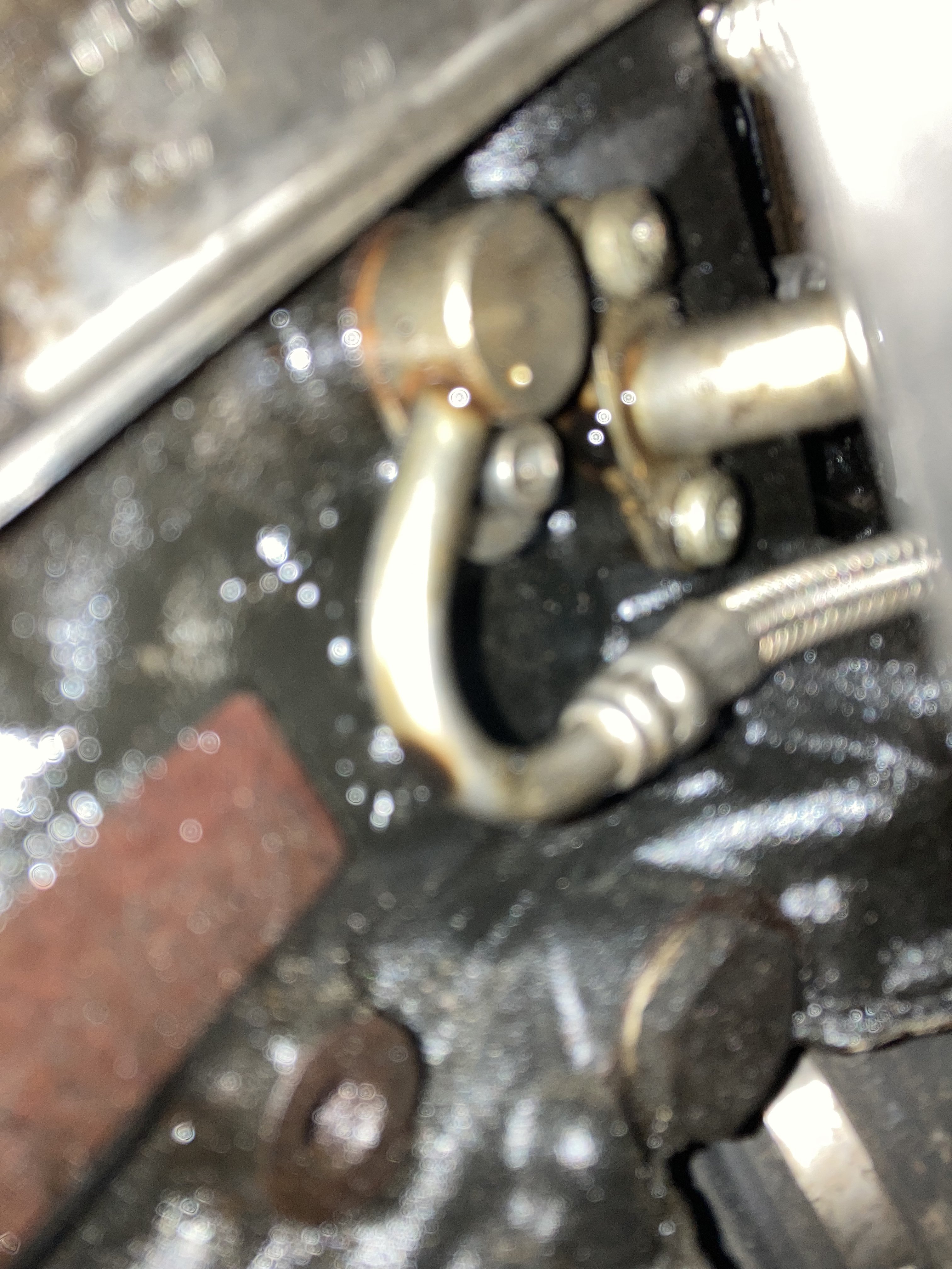

Does anybody know what this turbo oil feed? Gasket part number is please?
- Does anybody know what this turbo oil feed? Gasket part number is please?

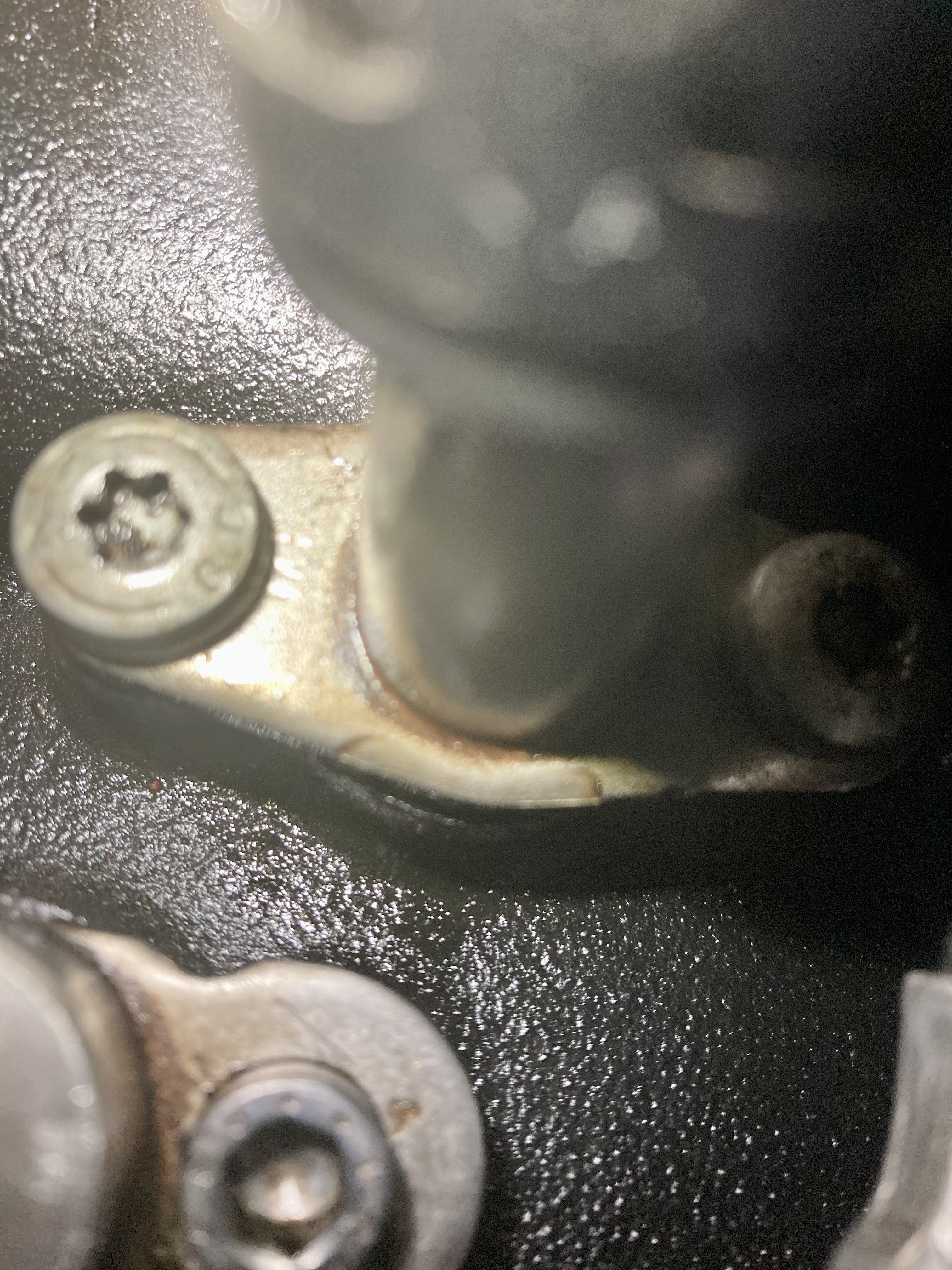

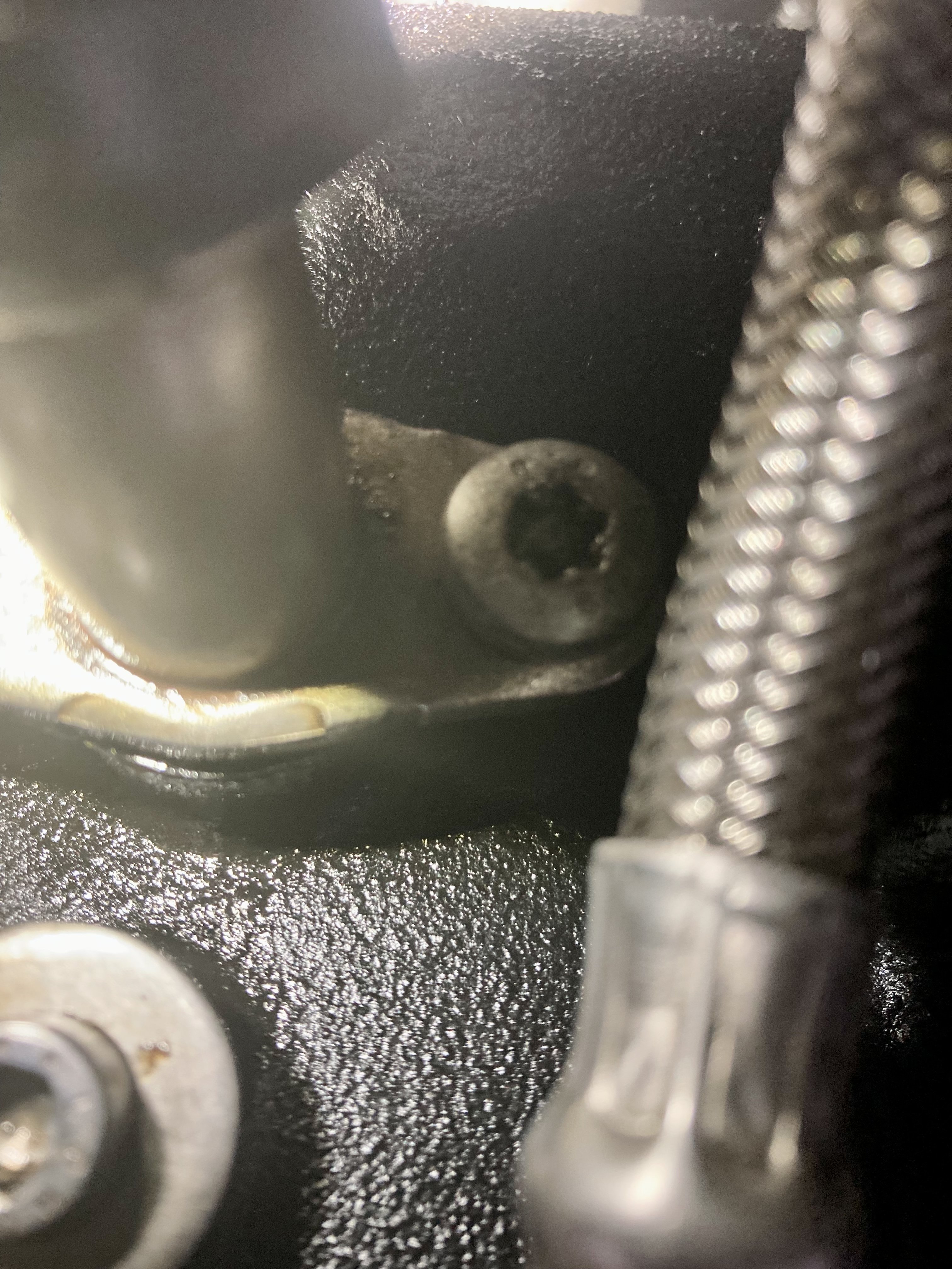

Been back under the car,it’s deffo a T30. I put my bit in again to give it an extra raunch. Heres a photo I just took. Also the XZN bolts photo I ordered these to replace the originals if too rounded off(Eyesights not so great close up,you have to approach these bolts head on straight or they will round off) Thanks everyone. Original gasket was rotten and car feels as if has lost a slight misfire now too after replacing.I first replaced all spark plugs and coil packs! This misfire became much more noticeable after the new stainless steel exhaust- Does anybody please know what this part/number is called please?FL Vrs mk2
That’s brilliant advice Thank You MicMac I will check that out before proceeding for sure- Does anybody know what this turbo oil feed? Gasket part number is please?
I’ll be going back under there in the next few days,I’ll get a photo. I was sure it was the XZN m8 but no dice.Paid £9.99 for fedex next day delivery of the 2x@33p each bolts too! My little Bahco mini ratchet set had the bit that fit-actually looks like a T30- Does anybody know what this turbo oil feed? Gasket part number is please?
An update here again.Those XZN bits are not needed for the bolts which hold the turbo oil return after all. They are regular Torx-I think T25? So now I have the XZN bit kit anyway,I’m sure will come in handy in future for our cars. Thanks again for all of your help chaos and ladies.- Does anybody please know what this part/number is called please?FL Vrs mk2

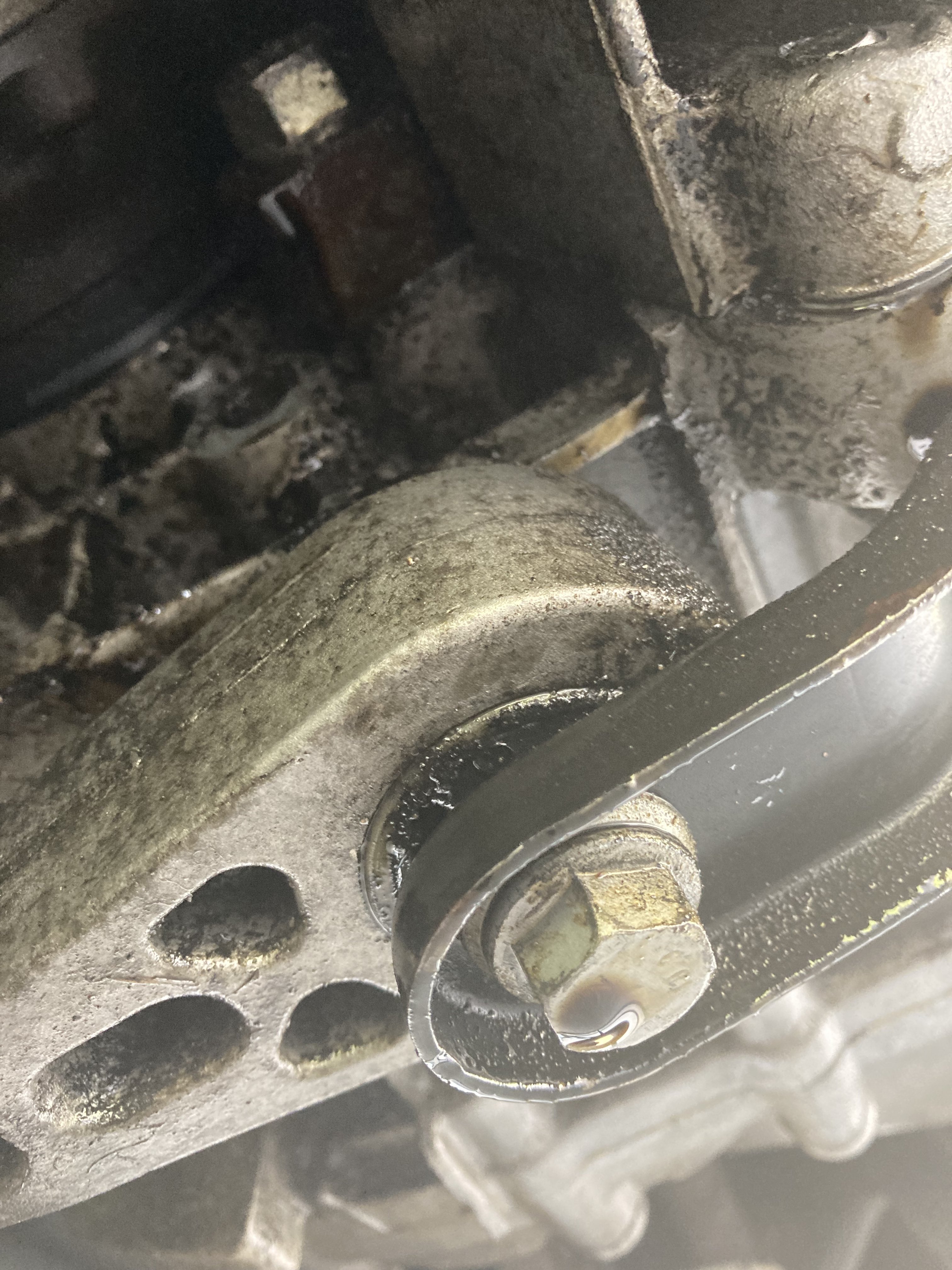

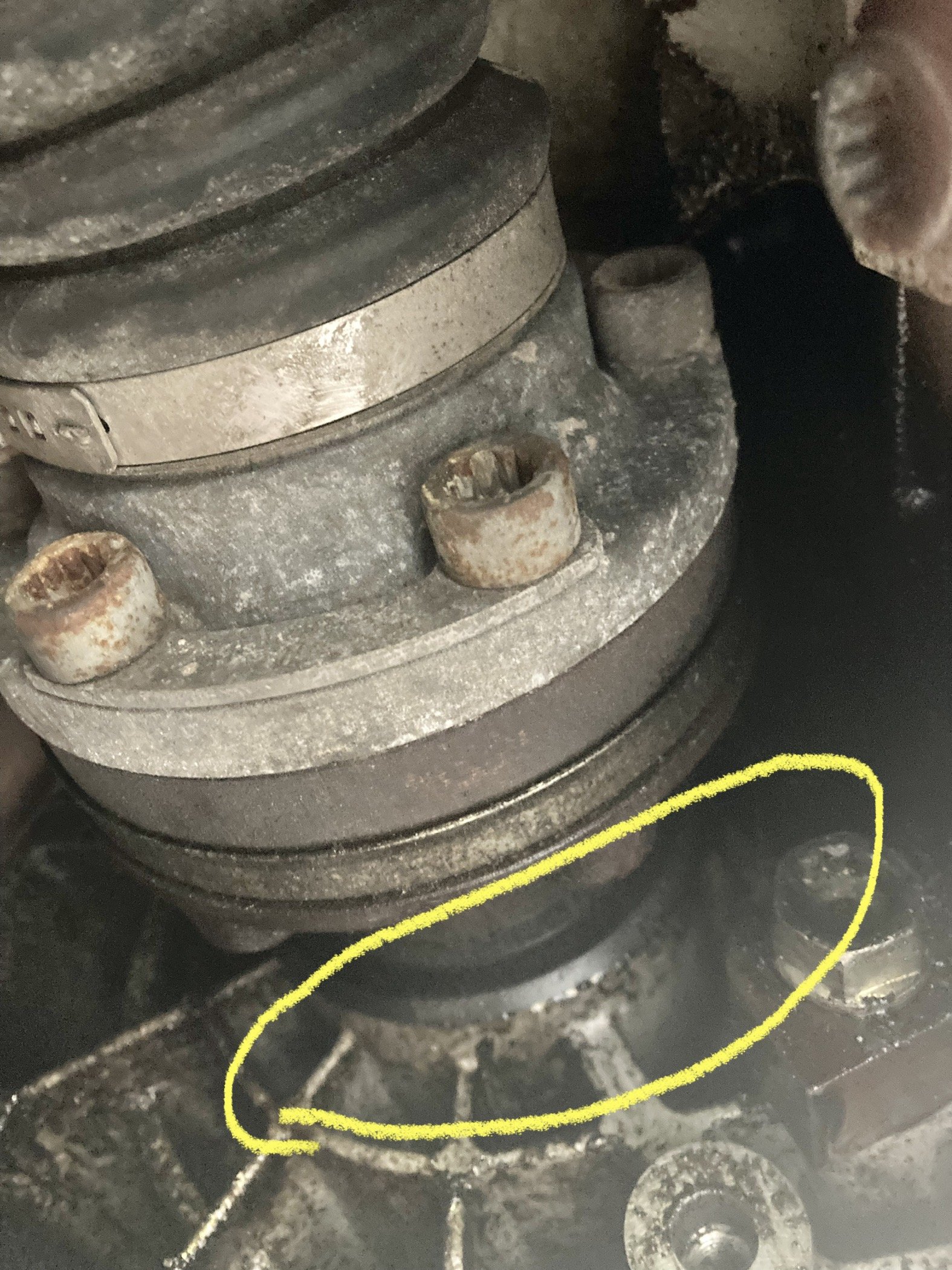

I have ordered from gsf a manual transmission flange seal-my right side driveshaft tha goes into the gearbox is weeping,as shown in my photo. Although now it’s just arrived in the post-part number 002301189c, it looks like it is a lot smaller than the part I need. Is there anything special I will need to do this job myself? Do I need more gaskets when I open her up?? Thanks so much for your help,this is the best auto forum I have used.- Does anybody know what this turbo oil feed? Gasket part number is please?

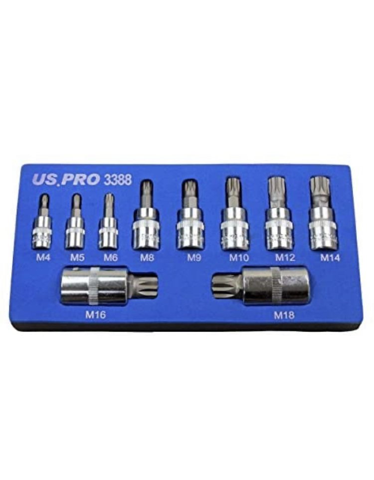

Thanks Wino im sure these bits will come in handy elsewhere on our cars in future,Driveshafts etc etc. This kit was £13.95 on the big A- Does anybody know what this turbo oil feed? Gasket part number is please?

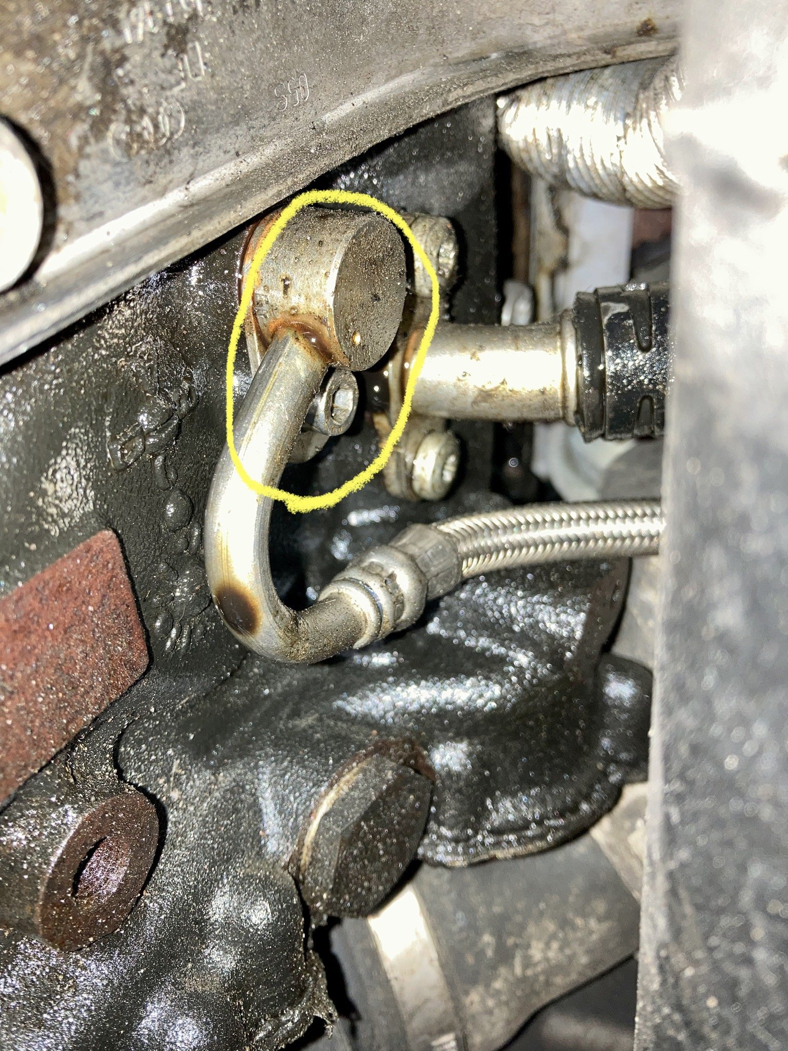

Also for anyones interest,the EA888 engines turbo oil feed pipe(circled in yellow above) uses a simple round copper washer rather than a gasket that is needed in the Return pipe. Cheers.- Does anybody know what this turbo oil feed? Gasket part number is please?

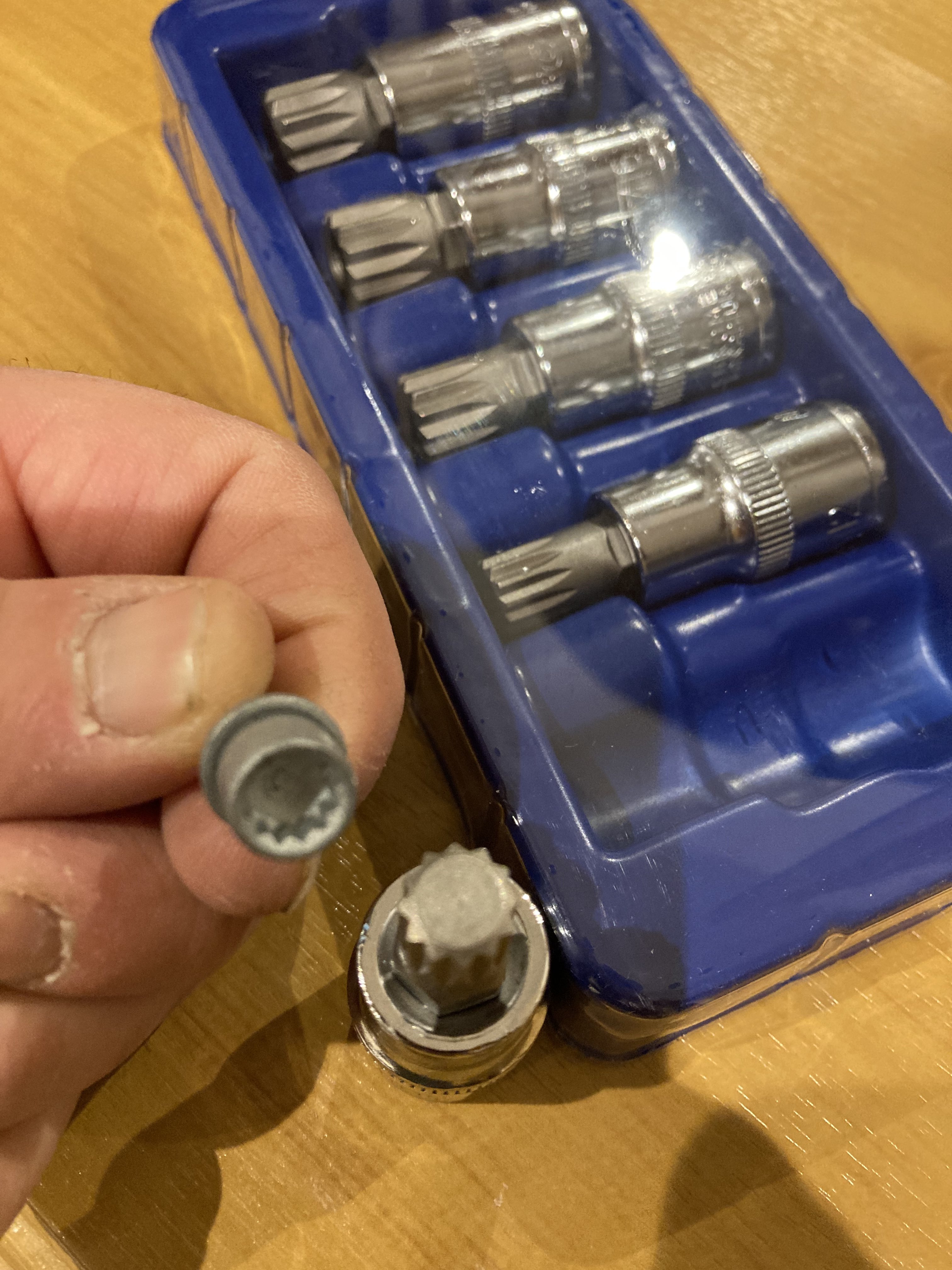

Hmm the vag -4 triple square kit,all are too big for these turbo oil bolts which are either M8 or M9. Now another kit is on the way from Amazon. Wish this VAG group kept things simple with sockets and the odd Allen key fittings!- Does anybody know what this turbo oil feed? Gasket part number is please?
Anyone that is interested,these turbo oil return bolts are indeed XZN type,I bought 2 at 33p each from all car parts fast uk The XZN bits for VAG,I bought a kit of 4 bits,Us Pro on Amazon for under a tenner.- Does anybody know what this turbo oil feed? Gasket part number is please?
Ah Wino to the rescue again! Thank you for your quick,detailed reply and as always,a wealth of knowledge Regards- Does anybody know what this turbo oil feed? Gasket part number is please?
Hello to you all and I hope you are well CCZA engine 1z5 vrs octavia estate 2010 model. Does anybody know what this weeping turbo oil feed? Gasket is please? I already have the gasket 06F145757L for the turbo oil return to replace which is quite bad indeed but think the one underneath it with the banjo? Fitting should also be replaced.Want to do this asap before I blow the turbo!! I’ve taken some photos,1st one with yellow crayon is the one I’m quizzing about,2nd photo (Oil return)is the part number I already have. P.S I think I will renew the torx? Bolts for the oil return if anyone knows their size please,they seem a bit soft when I put a socket in there ….. Thank You very much for your help - Does anybody know what this turbo oil feed? Gasket part number is please?
