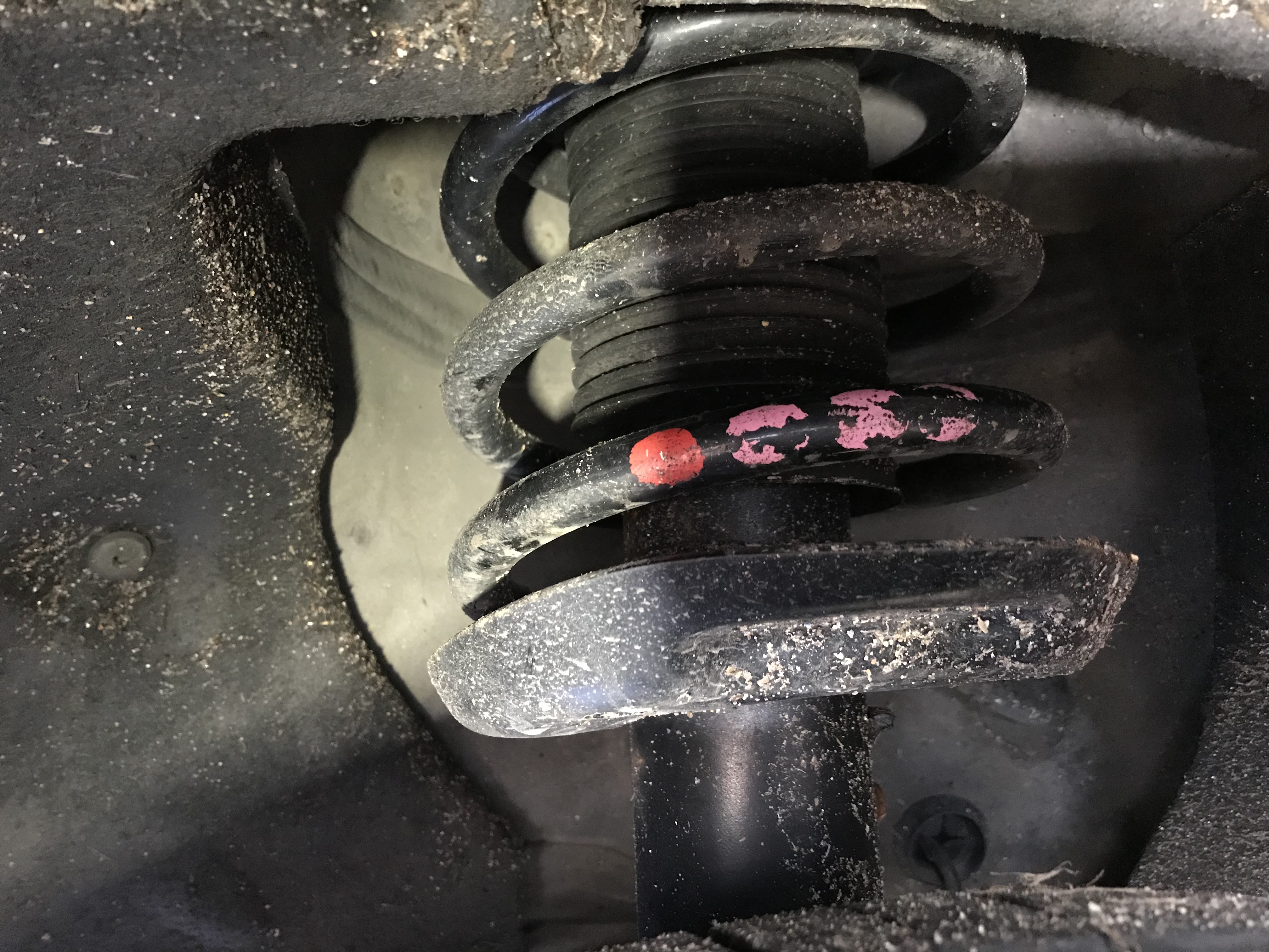

Rear coil spring (1 blue 1 yellow) part number needed to replace on a 1Z5 2010 Mk2 Octavia Vrs Estate
Brilliant info Thank You.Yes I know what you mean- the suspension parts are a minefield of lots of different variations. I’ve gone ahead and ordered Vogtland 35mm lowering springs for all 4 corners, seeing as I have to do the whole job all over again. Thanks again.
Thank you very much indeed for your help again Carlston
Sorry just seen end of your post Carlston,I meant B4 struts and shocks I’ve been looking at suspension part numbers for way too long!!
Bloody gutted the new mechanic I paid £365 for labour only to fit my new front Bilstein B3 struts and top mount/bearing kit plus Whiteline Rarb didn’t point this out,before I myself fitted the rear B3’s and new springs then a 4 wheel alignment and it STILL looking like a tractor!! Just hoping this helps some other folk in the future
1K0411105DB front coil spring Is for an automatic estate as heavier front end 1K0411105DA is for a manual estate As I say I’ve just found your info but I am baffled as of the correct dot colours on there and what I actually need ...... Also 1K0411105DA is saying incorrect/won’t fit my vrs estate Very weird indeed
Yes sir, that’s what came on the car.I am baffled too! Been looking for hours.Just seen your post reference part number for petrol manual estate vrs mk2 200bhp (1z5) but I am still confused as when I input that part number,says not compatible for my car!
