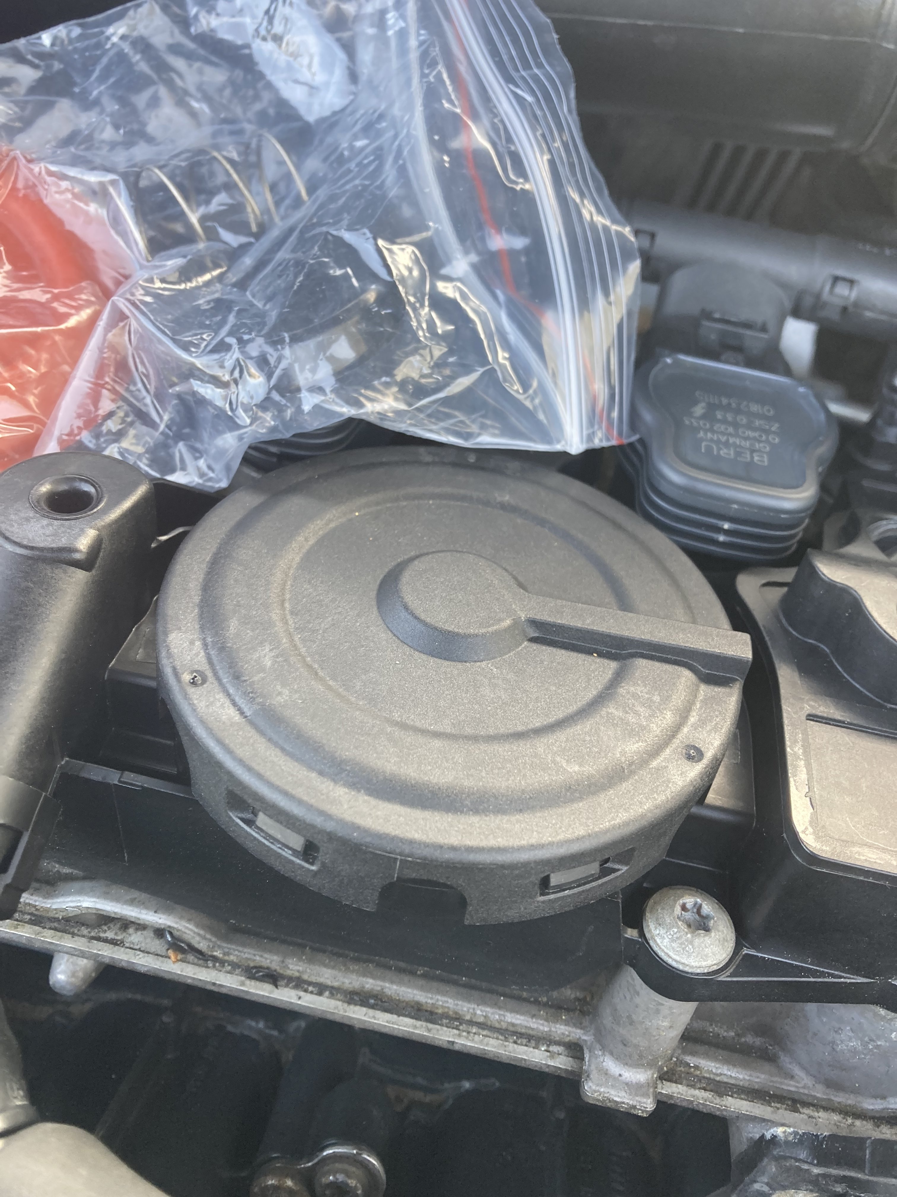

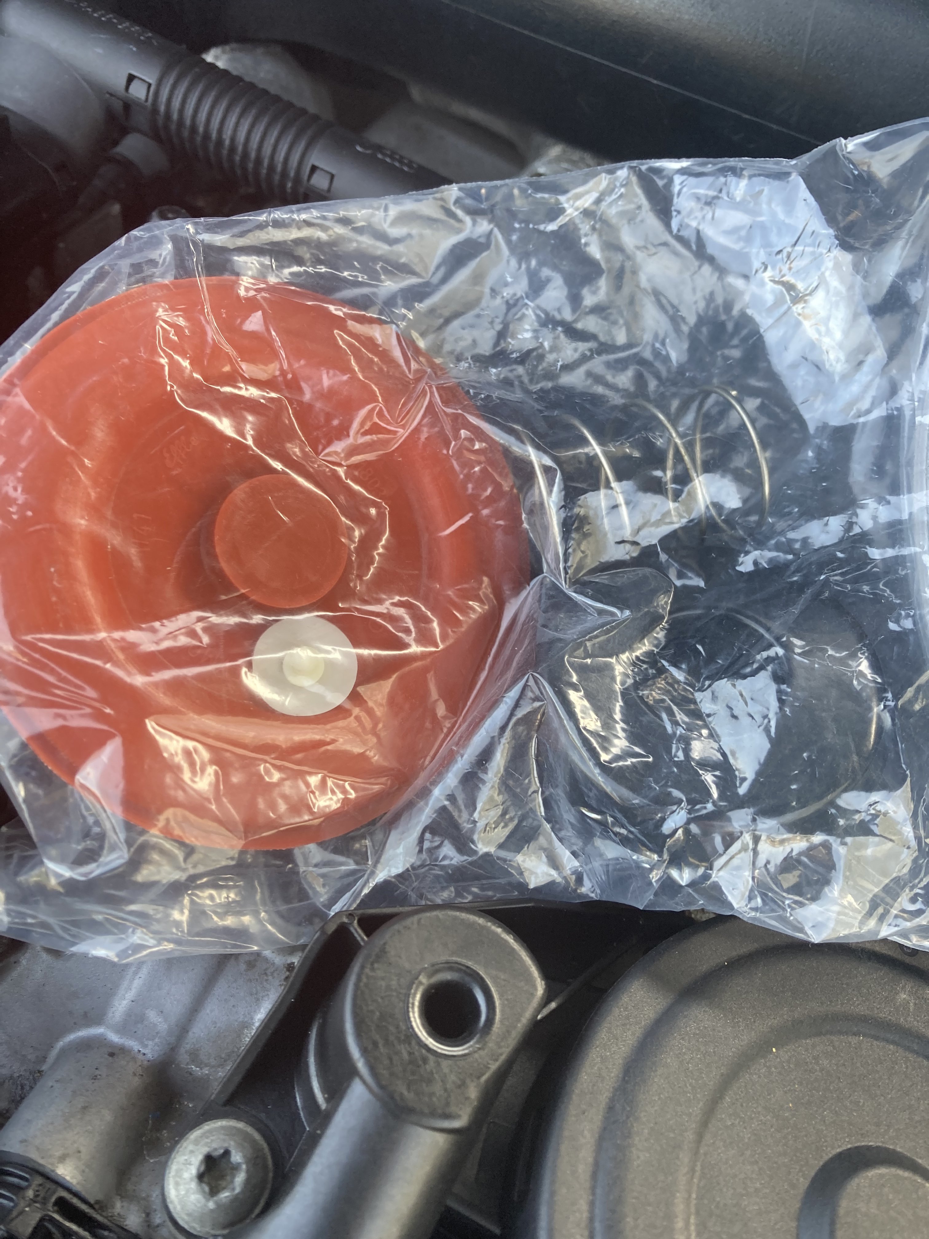

Anybody know how to remove the top disc of the PCV valve/Oil seperator?
Great help thanks so much MicMac. got it in the end with the help of a VAG sensor clip tool. The diaphragm was fine/not torn after all but was peace of mind to check it. There is an “Audi PCV diaphragm “ video on YouTube also to help anyone in future.
Hello all and I hope you are well. I have bought a repair kit for the PCV valve (AH) revision. Does anyone know how to remove the round disc part so I can replace the gasket and spring inside please? it has various grey clips underneath,thought I could spin it loose but no dice. Thanks so much

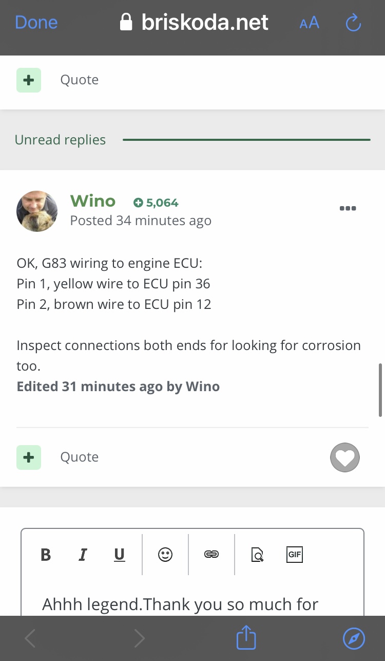

Aha! That would make sense,as also on my vcds,the cooling fans,both 1 and 2 keep coming up now, too. I was going to upgrade the fans…. I have looked everywhere for this sensor,spent hours trying to find it including online. My car is a petrol Mk2 vrs estate.Will it have an egr valve? Do you have a photo of this sensor please? Many Thanks again
Still! Cannot see/find this coolant temperature sensor( 06A 919 501 A ) location
Hello there. Yes this is an ongoing issue,4 original sensors and a rewire and still showing on vcds as faulty but the car does not overheat at all,always bang on 90 on the gauge. Thank you very much. I will look into your findings,If it solves the issue I will post up for people in the future who may need that help.

Good morning to you Sir I hope you are well. Yes I have a new 15a in slot 41.I put a 15a in slot 42 also just to cover those bases. No clicks from the drivers right stalk. I do really think it a relay issue now. If I can again slip outside and start tearing the dash apart that is my next port of call for sure. Wino has already been a fantastic help with regards the pins ecu- coolant temp sensor(Yellow and brown) I don’t feel confident removing the ecu after reading horror stories on here though I am more than comfortable doing a continuity test on rack of those wires to see if I get 5v on my now cut at radiator end sensor cable. Gotta go- wife is not impressed -I’ve already had the front wheels off and spacers fitted today!! chat soon thank you very much again
