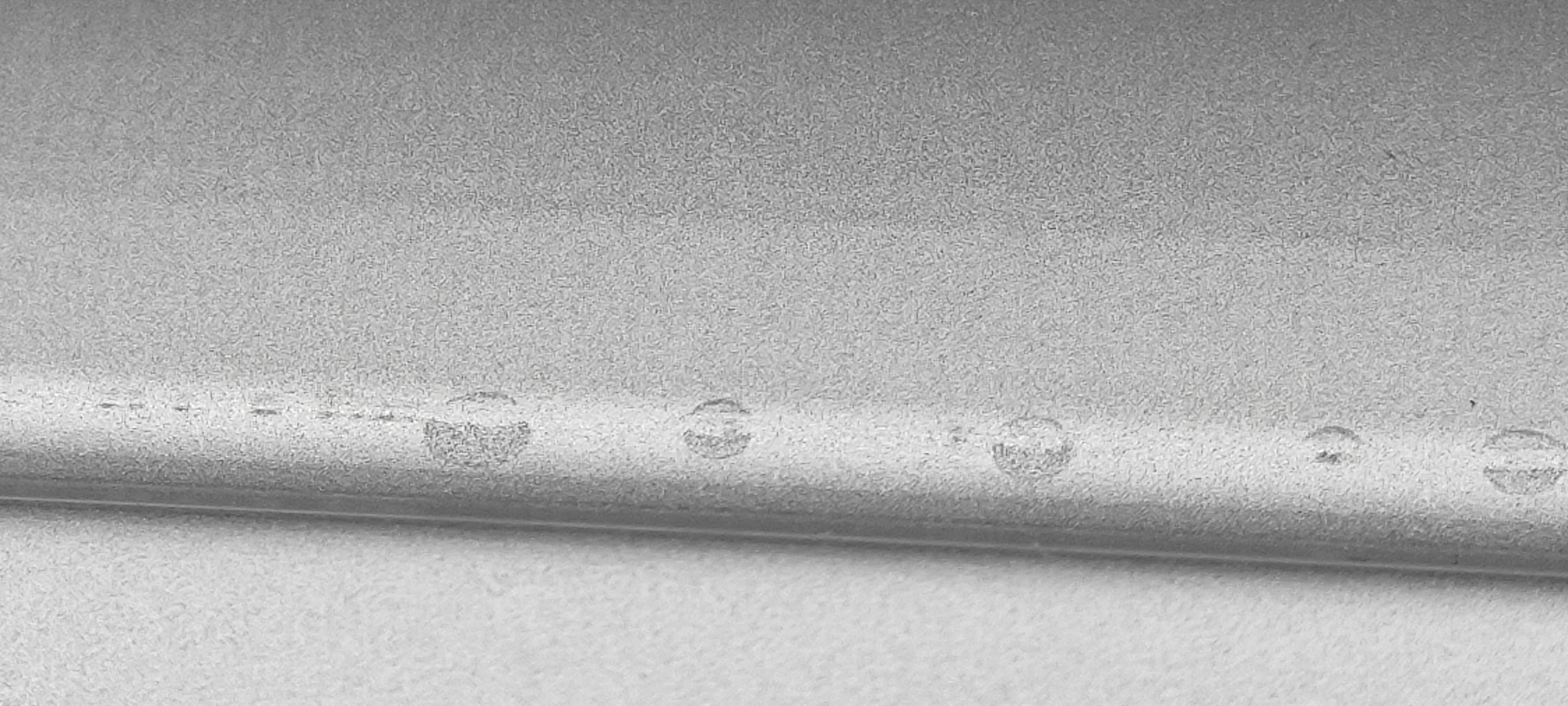

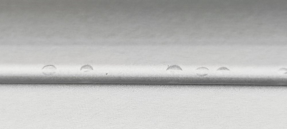

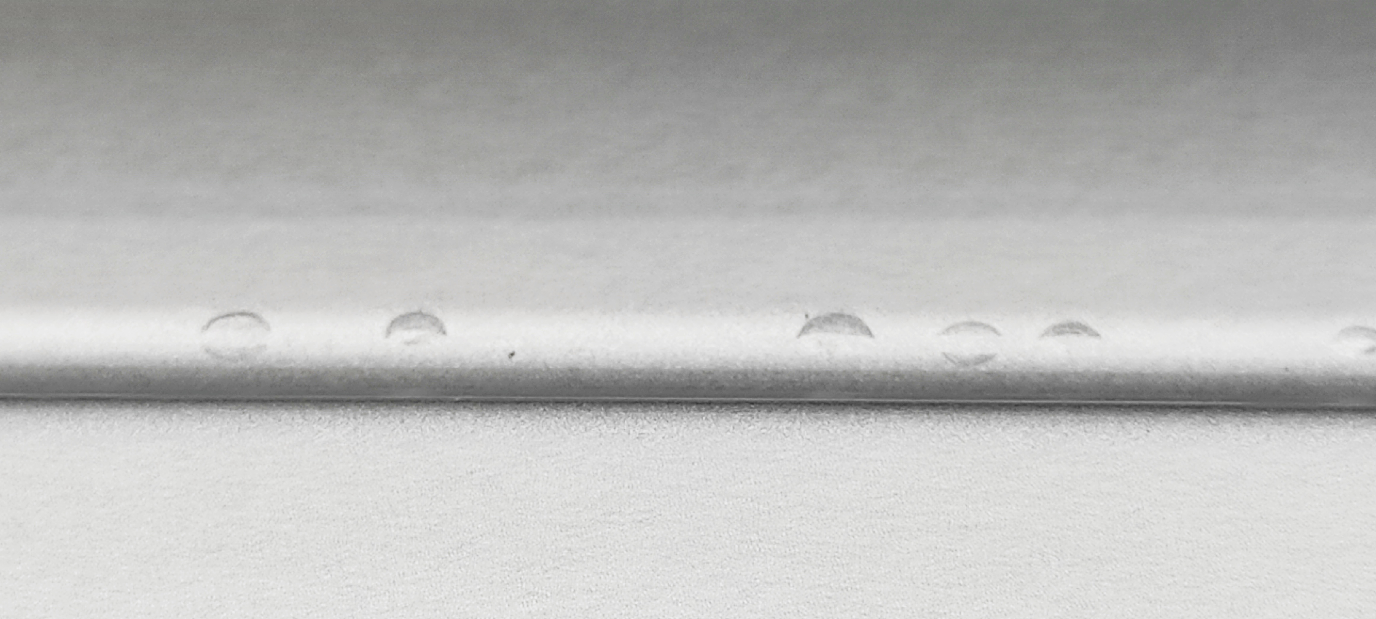

  1. Finally located photos of the paint blemishes. You'll notice the similarity to those of "Aviation nut". Clearly, a factory problem - not picked up by the manufacturer, importer or dealer.
  2. After handing the car back I'm afraid I deleted the photos from the phone. I'll check later to see whether I retained any on the computer back up file.
  3. I had the same on both sides of the roof, adjacent to the roof bars. The dealer acknowledged it as a flaw but we were negotiating the rejection of the car due to the technological glitches, so the issue was overtaken by the car's return. (Interestingly, my car was also silver - perhaps a blip in the paint shop that day?)
