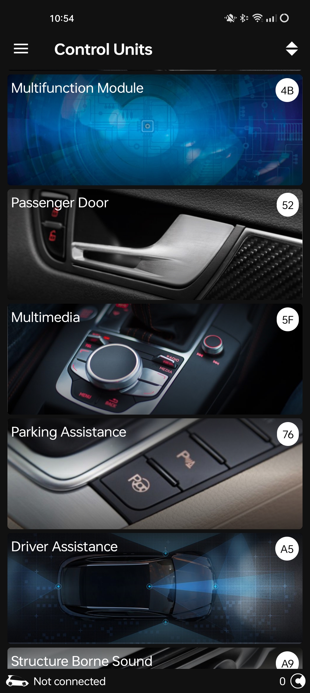

Anyone managed to get this working on a facelift car? I've followed several guides and end up with a maxi dot message saying dynamic road sign error. And it doesn't work, from what I can't tell this is something to do with the road information from the sat nav not being available or being able to be read. I have the A5 camera and it's 3Q0 starting I have the Amundsen standard sat nav I think. Is it a Multimedia issue or something else? Any ideas?

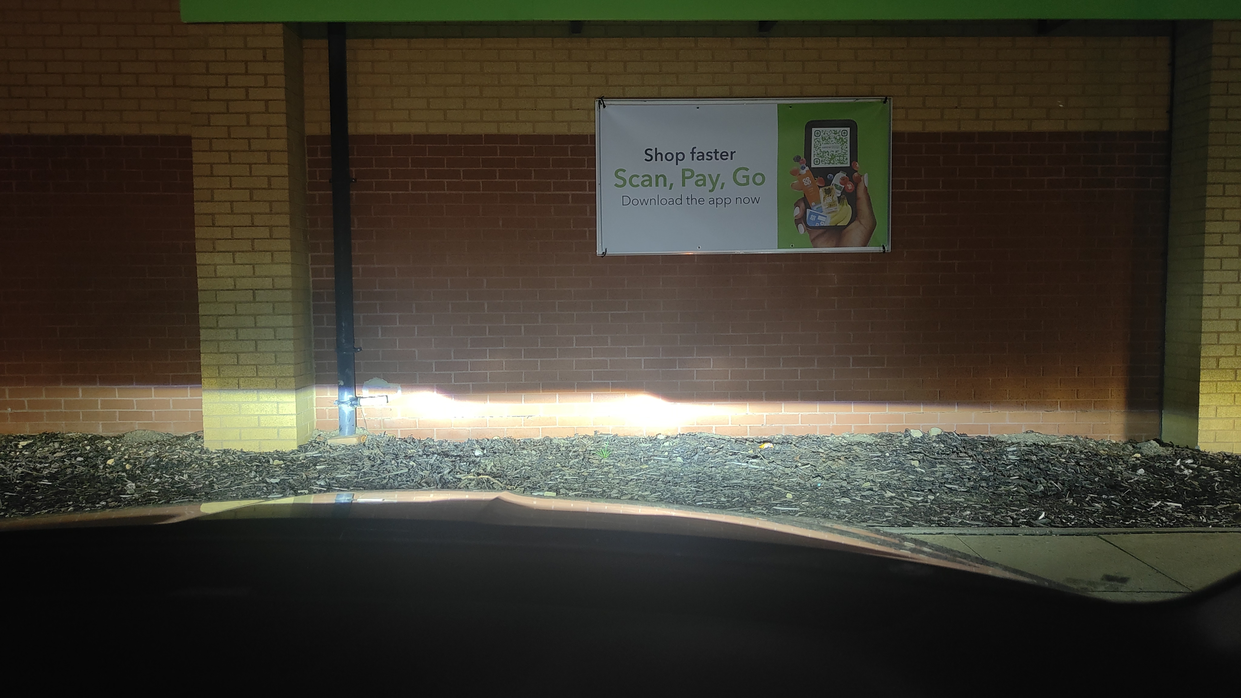

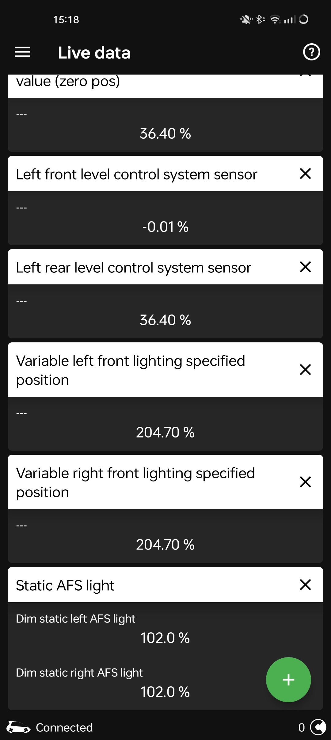

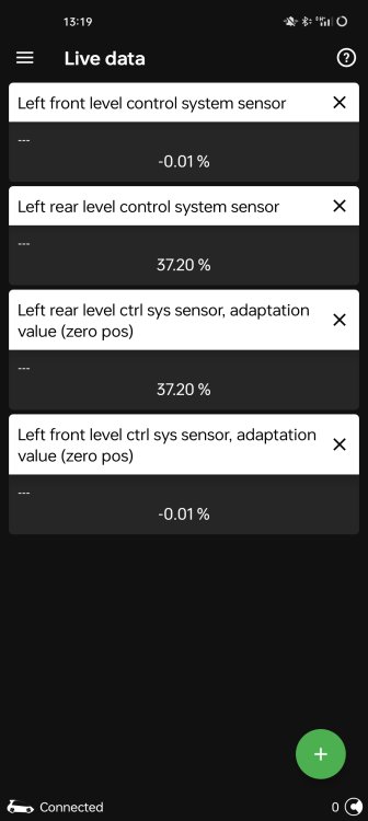

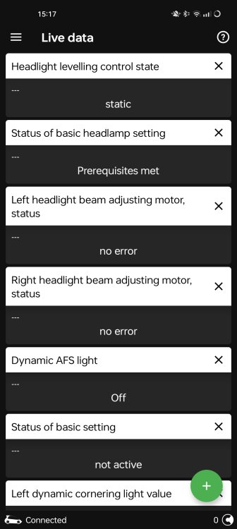

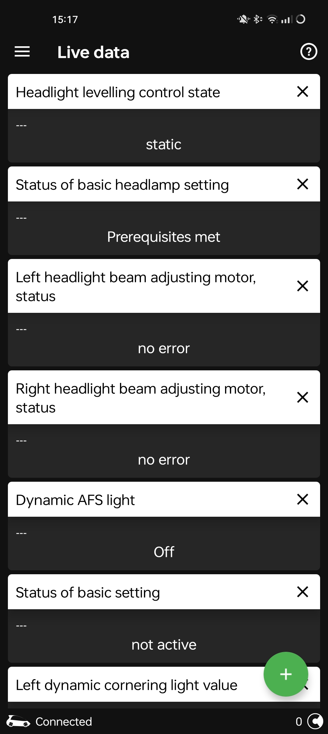

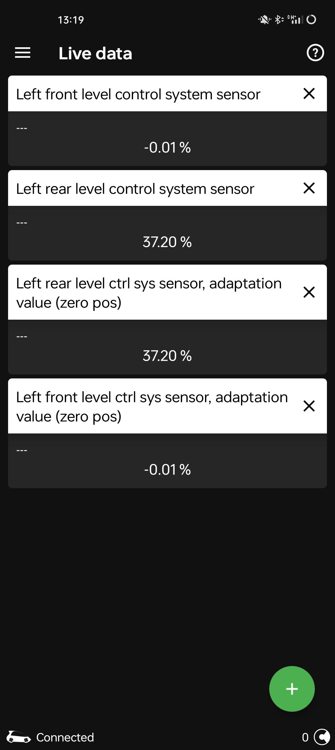

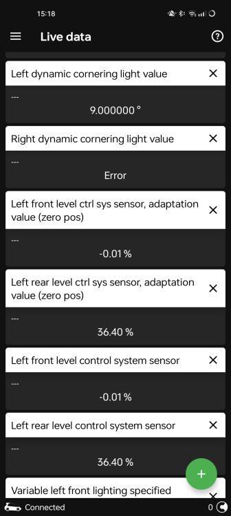

I've used that lcode you suggested and done the basic settings as suggested. It does seem marginally better maybe but only by a tiny fraction if it is. I can't tell if the static cornering lights are even coming on though, is there any way to activate them under a test mode in OBD11 like there is with the main headlight led sections at all? It's also hard to tell if they are adjusting up or down while driving etc, not sure if the slight changes are just due to bumps in the road and or acceleration or deceleration. A run up the motorway as it was doing a regen when I pulled back up at home, so took it up the motorway and the headlights seem to reach a little further maybe but again hard to tell. Think next plan is to take it to a garage with beam tester and check the height and see if they can be adjusted up just a touch, I'd say even a tiny height adjustment would make the world of difference. Maybe it's just me and the way they work with micro adjustments but dark lanes without main beam are still troublesome. If I hadn't activated the auto main beam I'd be constantly changing between dipped and main which I never had to do all the time in my previous rapid with normal halogen bulbs.

Yeah I get the hate of the output from OBD11. I just like trying stuff to see what can or can't be changed and getting my head around how it all works tbh. I'll have a look at your suggestions when I get chance later hopefully. I thought the superb had a facelift around 2017 but it seems it was 2019, I could have sworn theirs had LED lights but maybe it is Xenon's, bit doesn't seem to have the slight delay on turning the lights on that Xenon's usually have. No LED modules in OBD11 on theirs so maybe your right. Light output is better than mine though and possibly just a finger yellower.

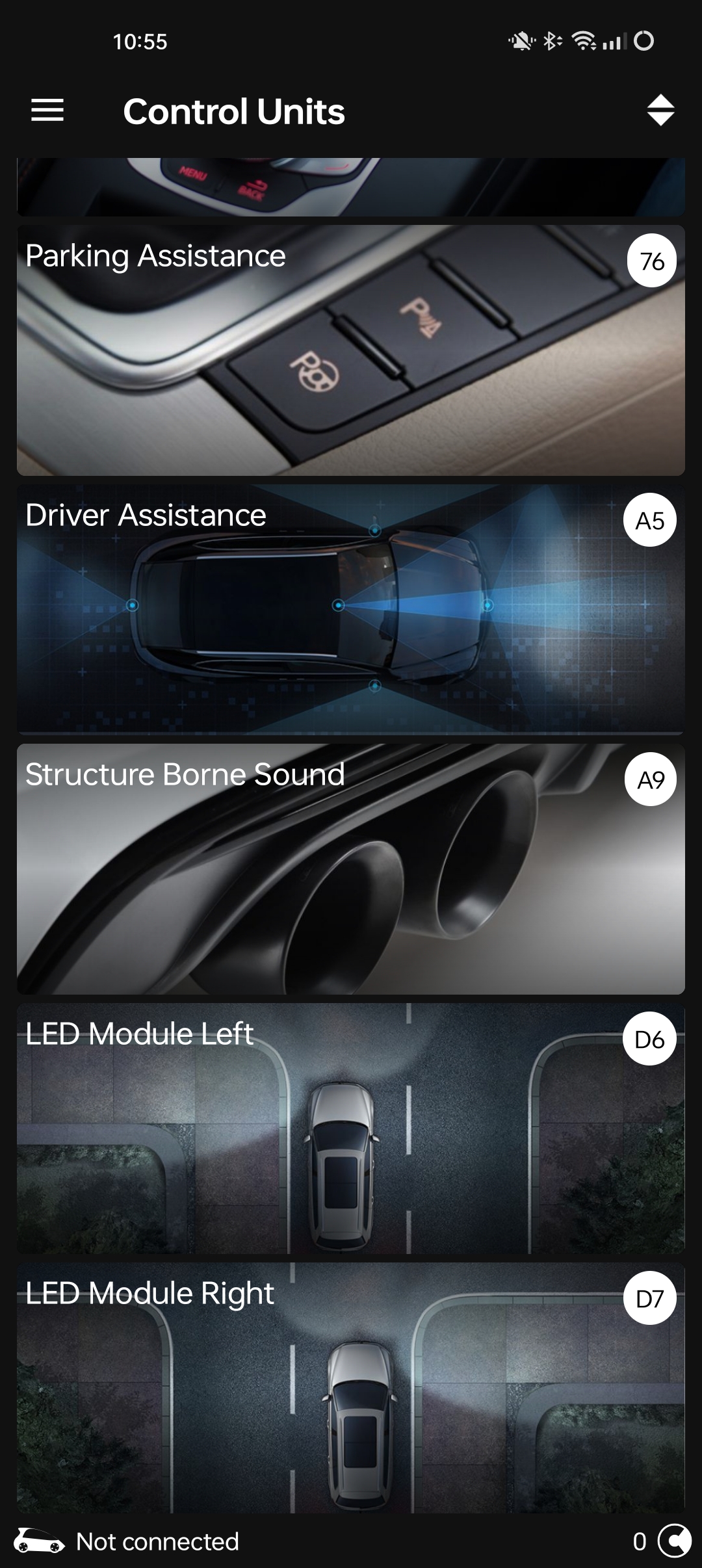

I assume the bit pattern led output menu is for the matrix lights as turning those led's on and off does nothing to my car. Seems odd to have an output test hat shows it is working but does nothing instead of saying function not activated or similar.
MK3 FL LED LIGHT ISSUES
One other odd thing I was trying to find a test to light up the static cornering lights so I could check if they both were working but cant seem to find a way to test those like other lights in OBD11. I also was not able to turn on cornering fog lights with OBD11 either oddly.
