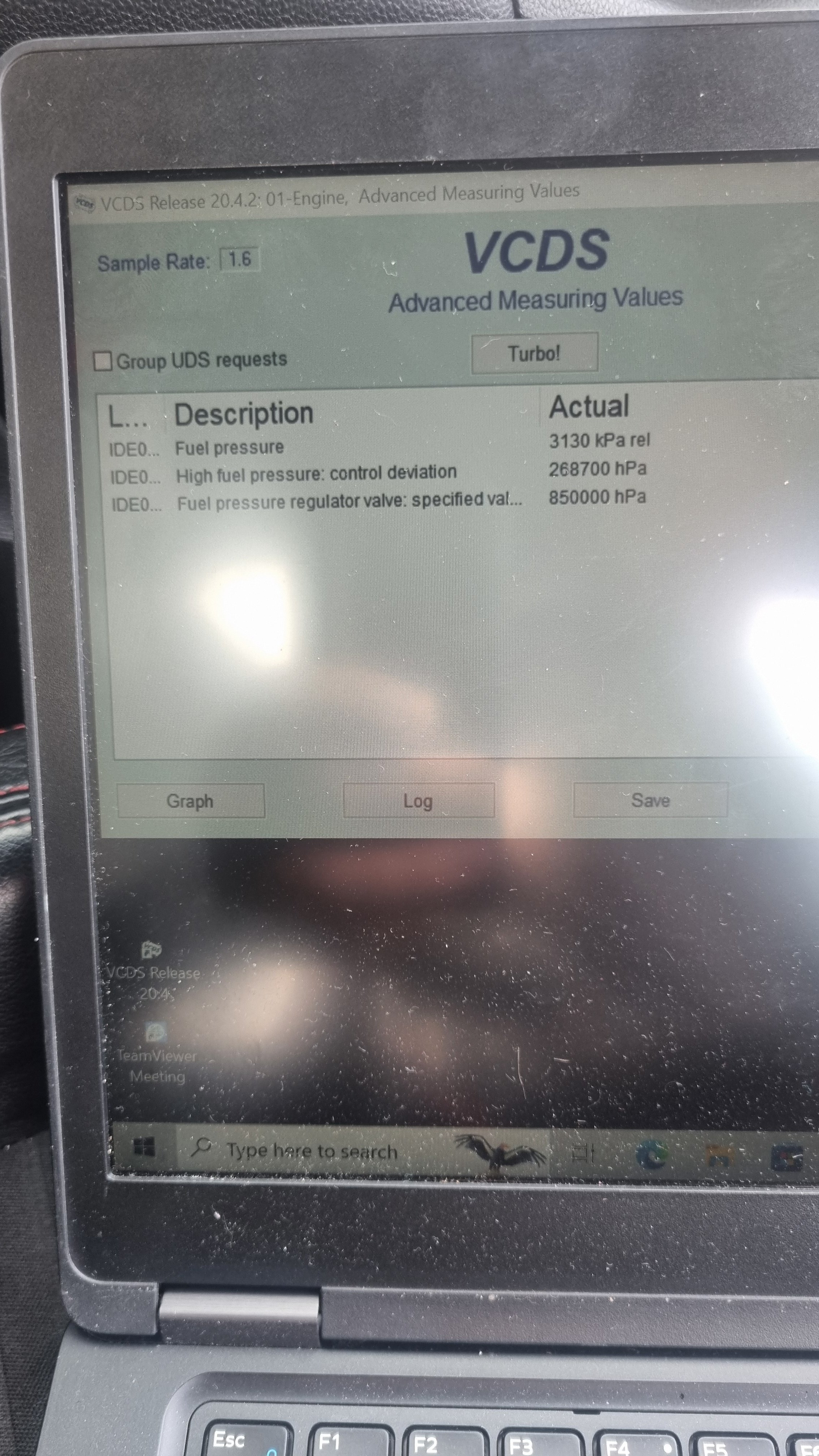

  2. Can the fuel regulator on right side of the rail be swapped without removing the fuel rail?? As took to a local garage after getting this fault code but wasn't very helpful
  3. Checked fuel filter today and no signs of metal shavings or particles
  4. That's it so wanted to know most common failures as maybe process of elimination

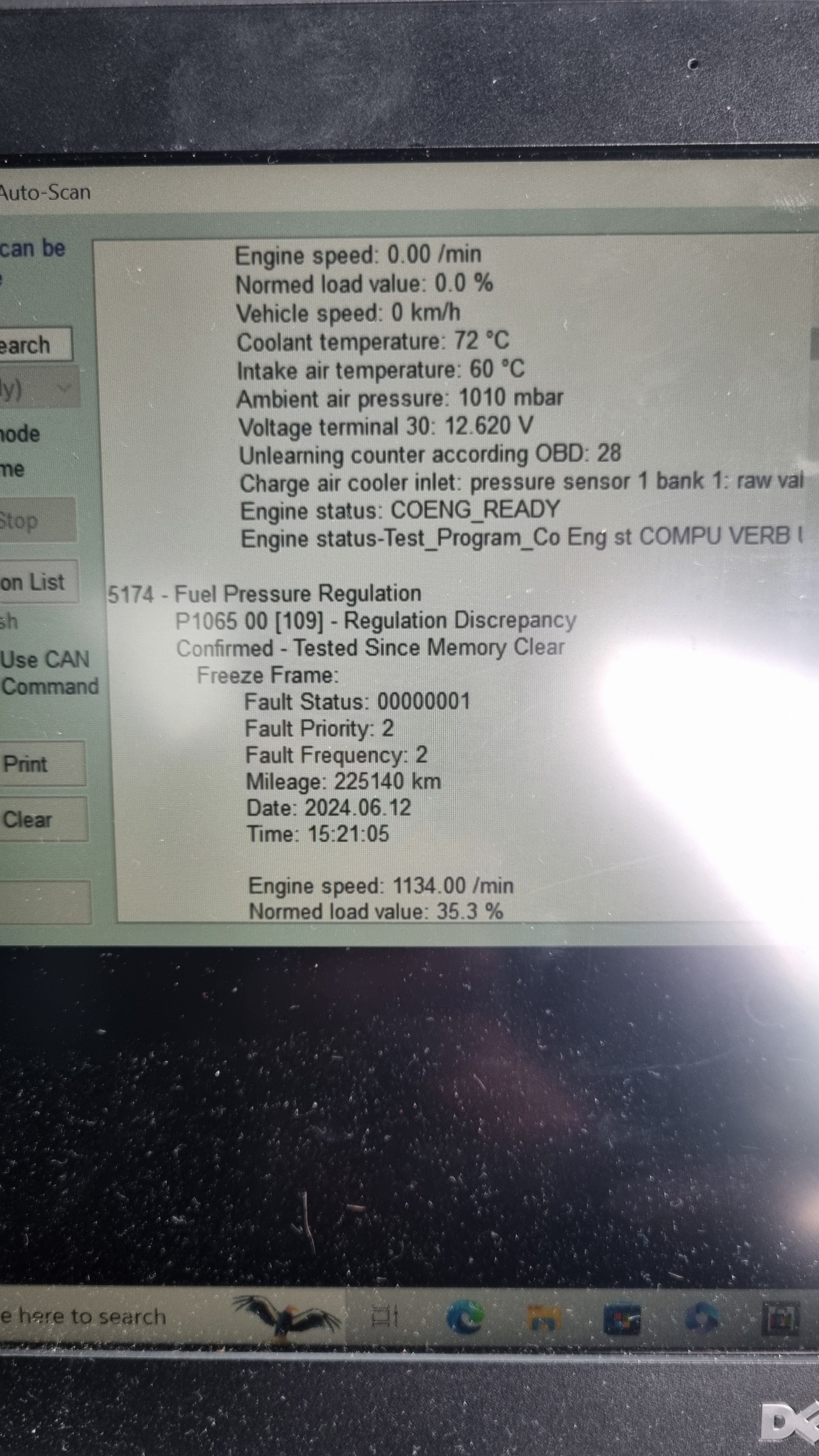

  5. Octavia mk3 vrs tdi the dpf keeps regenerating far to often and still regenerating when soot is at 3g so scanned car today and this popped up had mixed info saying maybe pressure sensor then maybe rail pressure regulator and also maybe 1 on the pump or even the pump so after bit more guidance... 👍🏻👍🏻

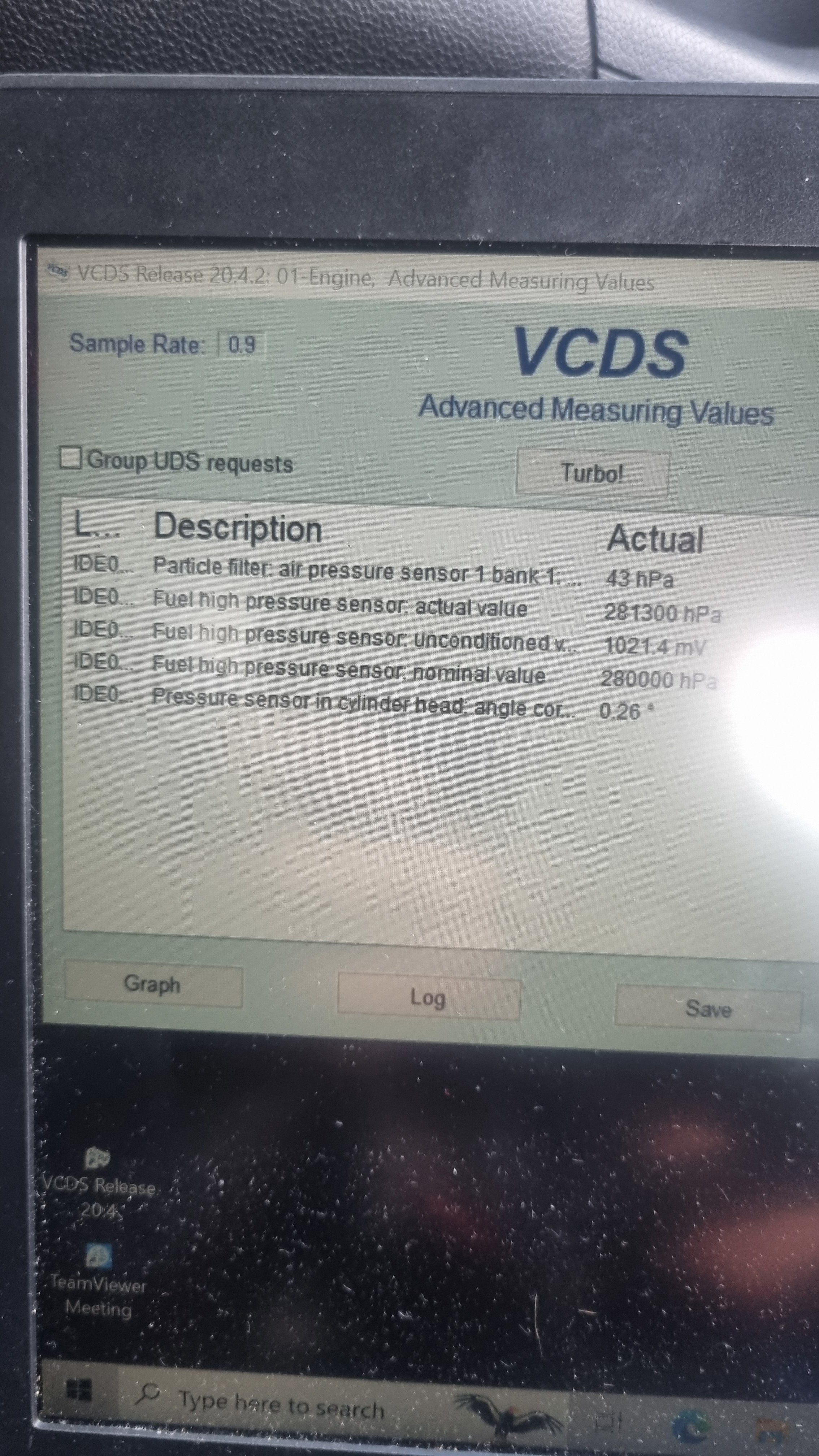

  10. Someone mentioned about resetting the dpf with vagcom too see if it resolves any underlying issues could anyone advise on this please?? No fault codes showing but I got the car I replaced the pre sensor but didn't reset anything at the time

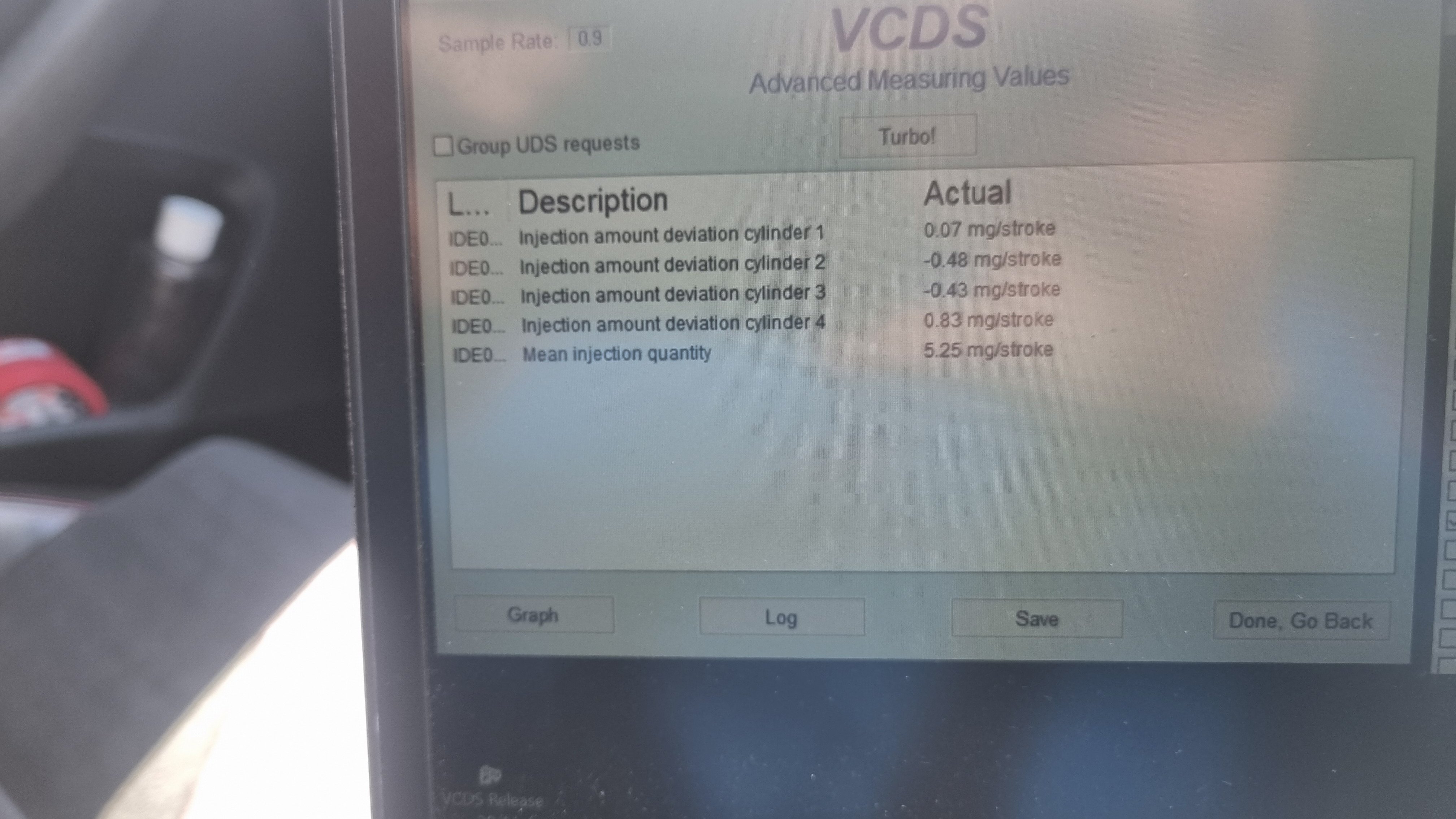

  11. Got access to vcds and shows pretty much same results it's constantly in regen soon as warm don't matter the soot level that's the issue I know the ash level is kinda high about 75% heard mentioned could be glow plugs as engine isn't warming up properly but no dash lights and no fault codes with vcds
  12. What I find weird is it I do a short journey and fan running when I get back in the soot level say 14g is the same and stays that way till warmed up then slowly comes down but if I go on long journey and soot level is st 2g and get out fan is still running then when get back in after few min soot level rockets too 20g+ then when warmed up comes down slowly
