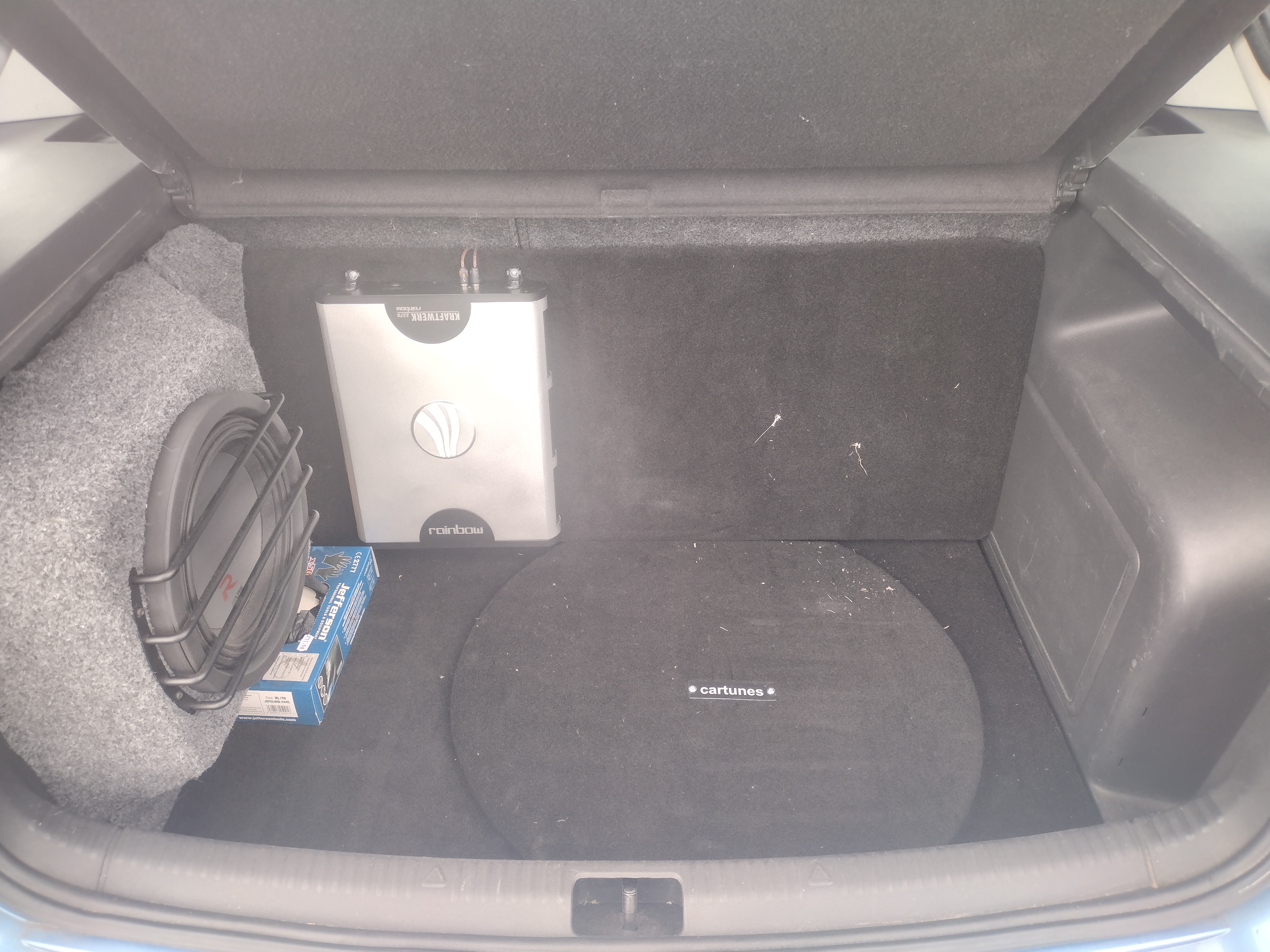

  1. I put a floating screen Sony in mine for around 650 including all trim, facia and steering wheel remote converter. £30 for a decent DAB antenna from the flea bays completes the Android auto system. One can purchase cheaper, but I've not come across any I would use. A decent set of speakers up front plus sound deadening material would set you back £125+. The amp and sub in my old Rapid spaceback are in the process of being reinstalled as I had a rattle! (Genesis five point one and Alpine Type R 10" DVC) Excuse the mess, and they added a couple of grand to the install! Go nuts by all means, but a brand name Android head unit plus fitting kit will set you back at least £600. Car stereo security in London are my go to guys for audio. 😅

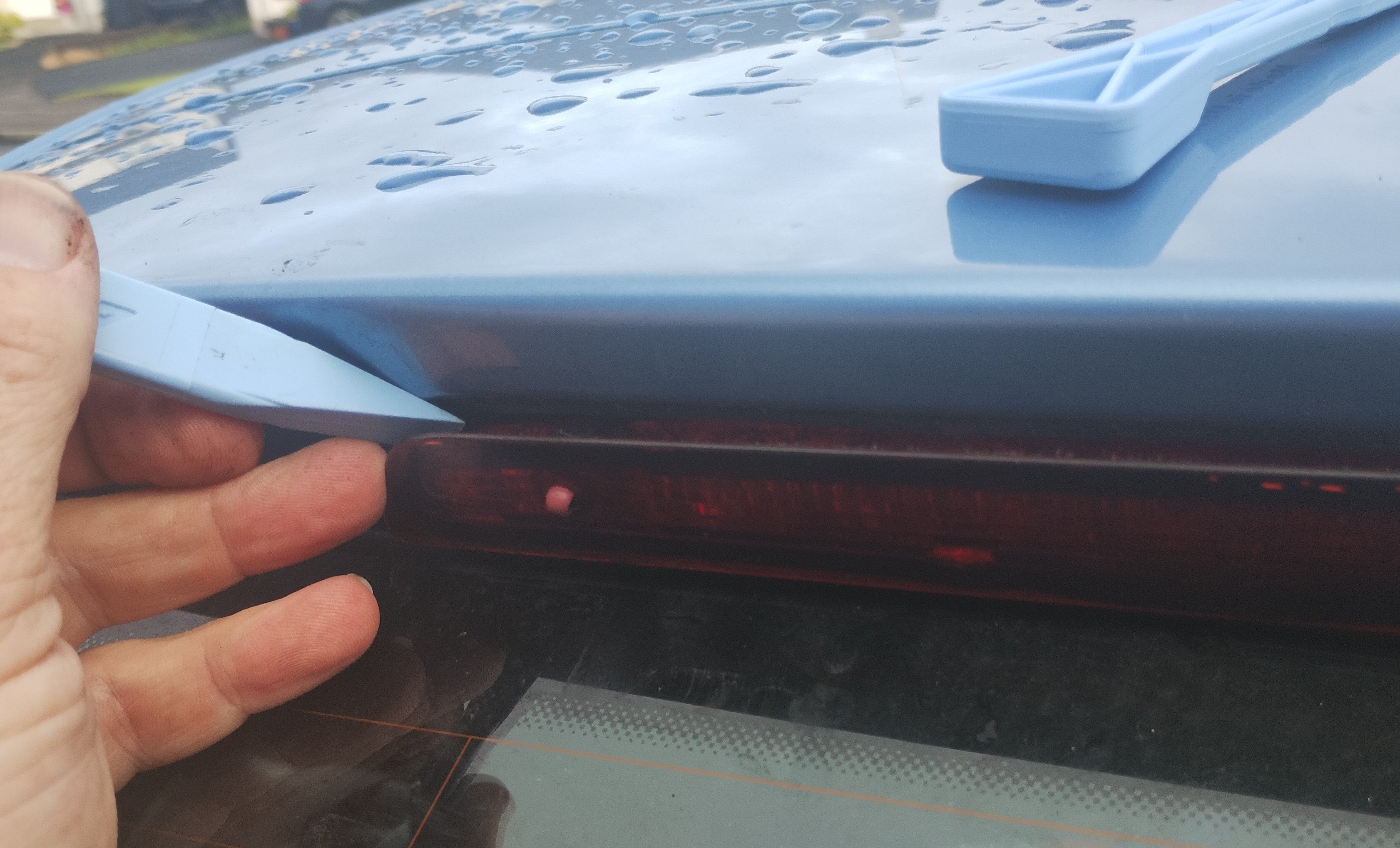

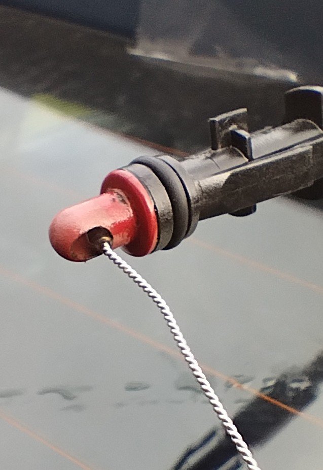

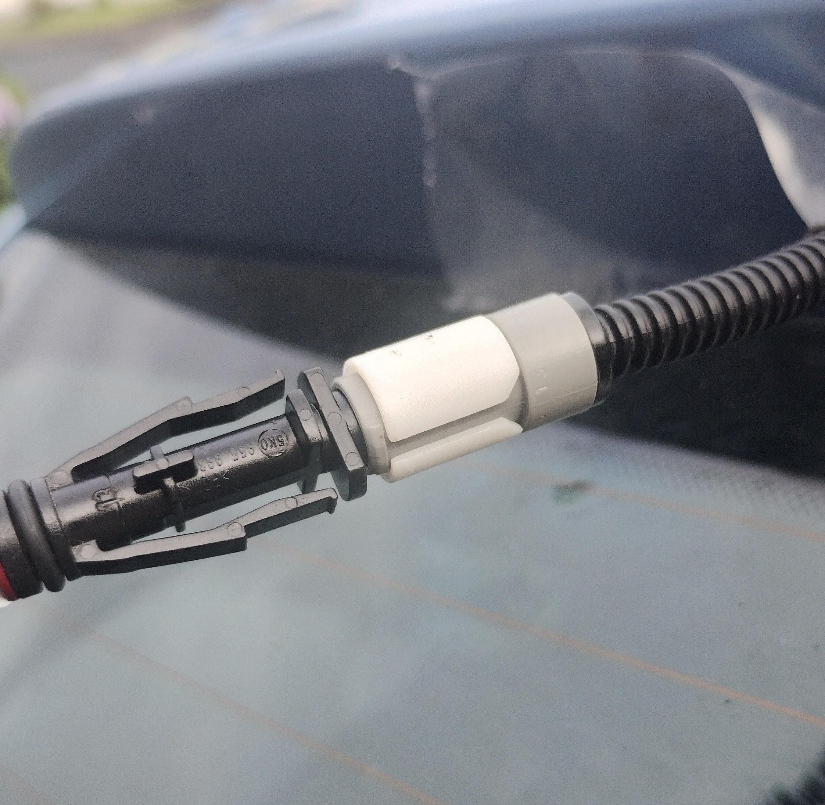

  3. All! I've suffered not having a rear screen wash for over two years now and despite working on many cars I over that period, rarely get looking at the many issues on my 10 year old, 140k mile Rapid Space back! The fix was simple with the correct tools. First, pop off the rear high level brake light with non scratch tools. Be brave, it is held in with sprung steel clips. Next, remove the white clip that holds the pipe to the nozzle: Lastly, get a small pipe cleaner tool pushed down the nozzle which should unblock it. A load of black gunge exited mine. Loosely refit and test, then push the unit back once happy with the operation. Job jobbed!

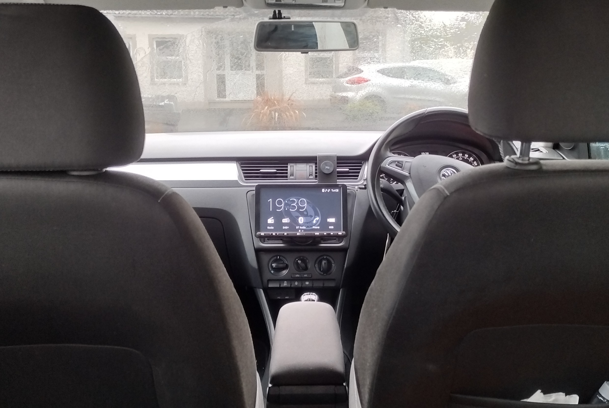

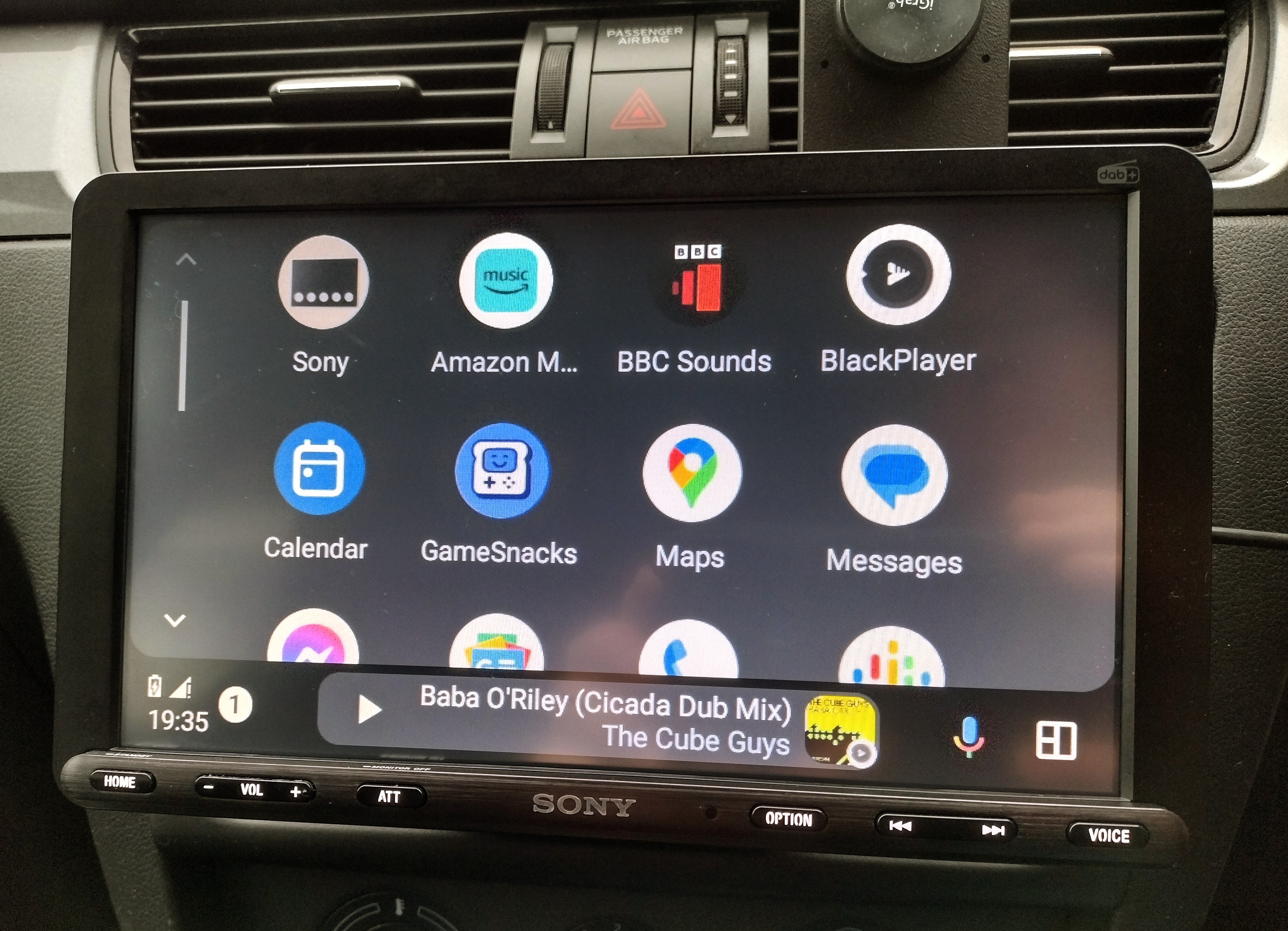

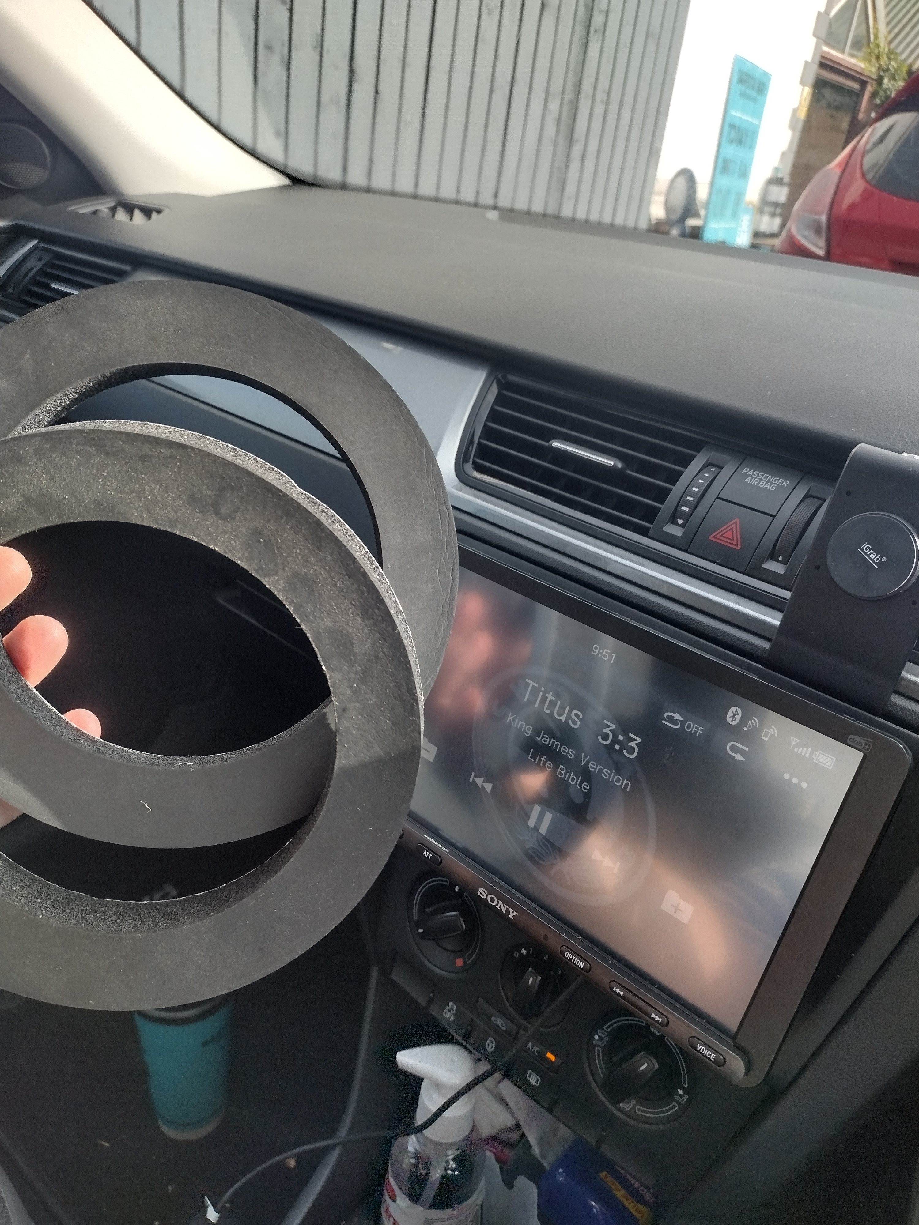

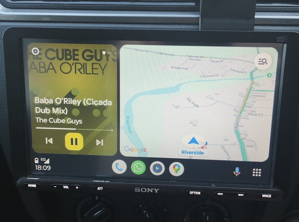

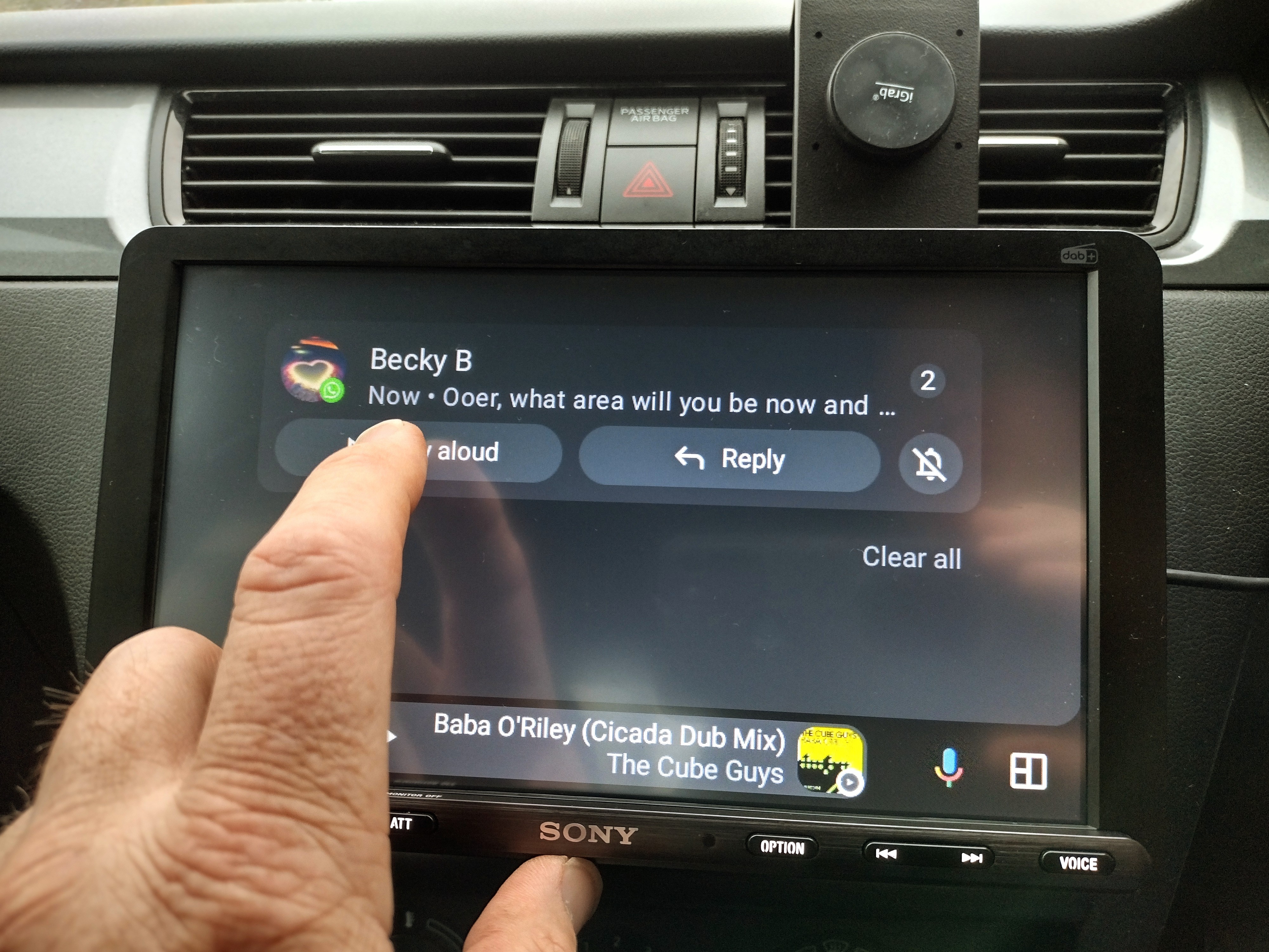

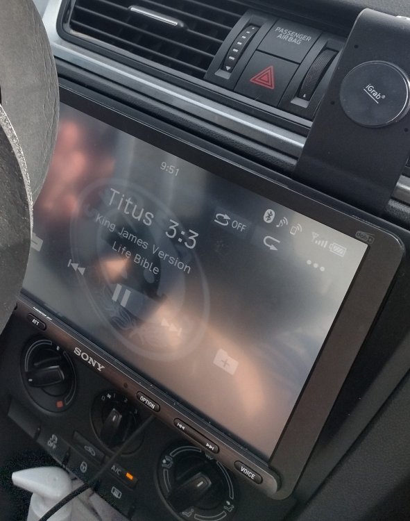

  5. I installed an Android Auto "floating screen" unit in my 2014 SpaceBack - Google maps than gave me satnav Costed around £590 all in for the Sony Head Unit, Facia, dab aerial and steering wheel remote converter A bit pricey, but I love the 9" screen with smartphone control. The pic shows the head unit, which fist in a single din slot - The pic was from when I was showing a friend what I used to seal speakers against a door panel!

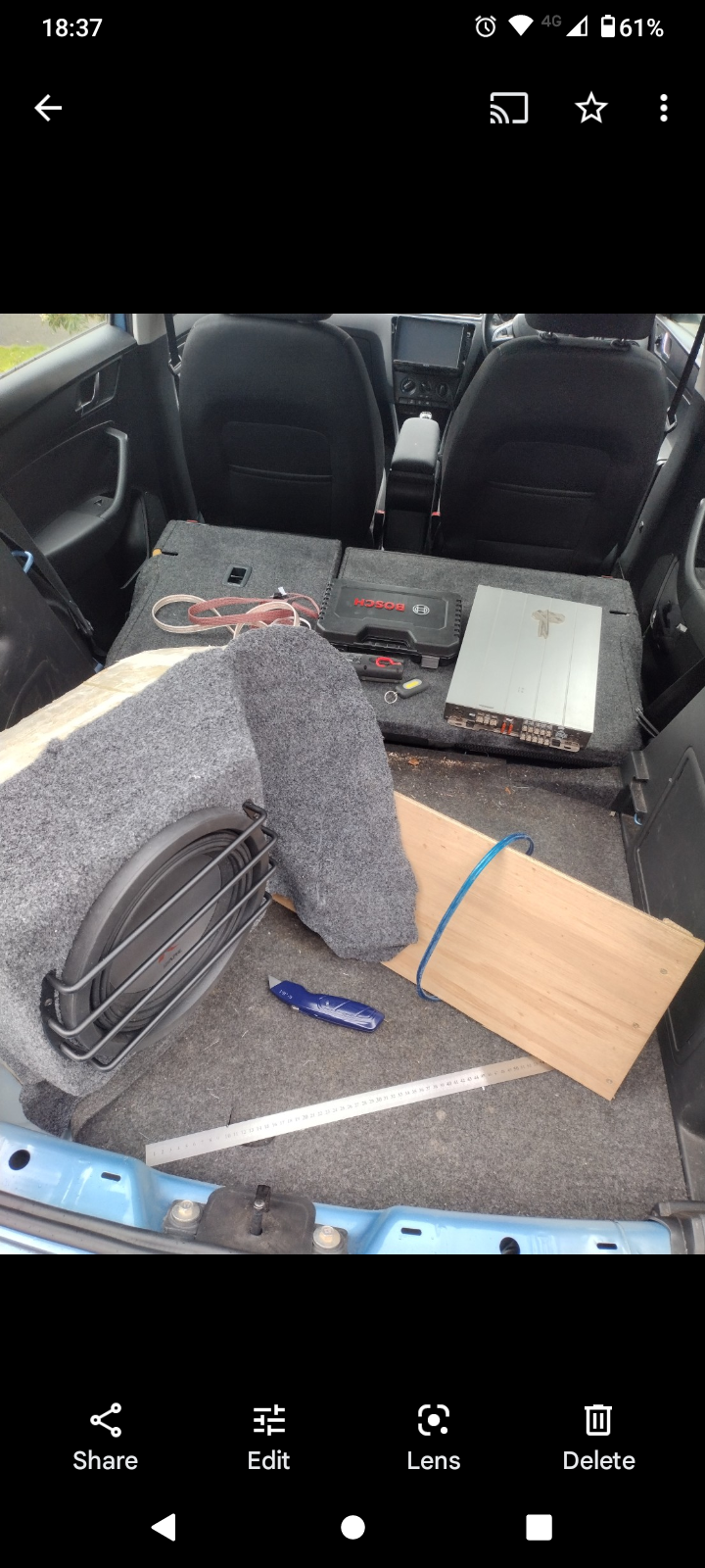

  6. Slightly better pictures. The amp and sub will be getting retrimmed after the new amplifier arrives!

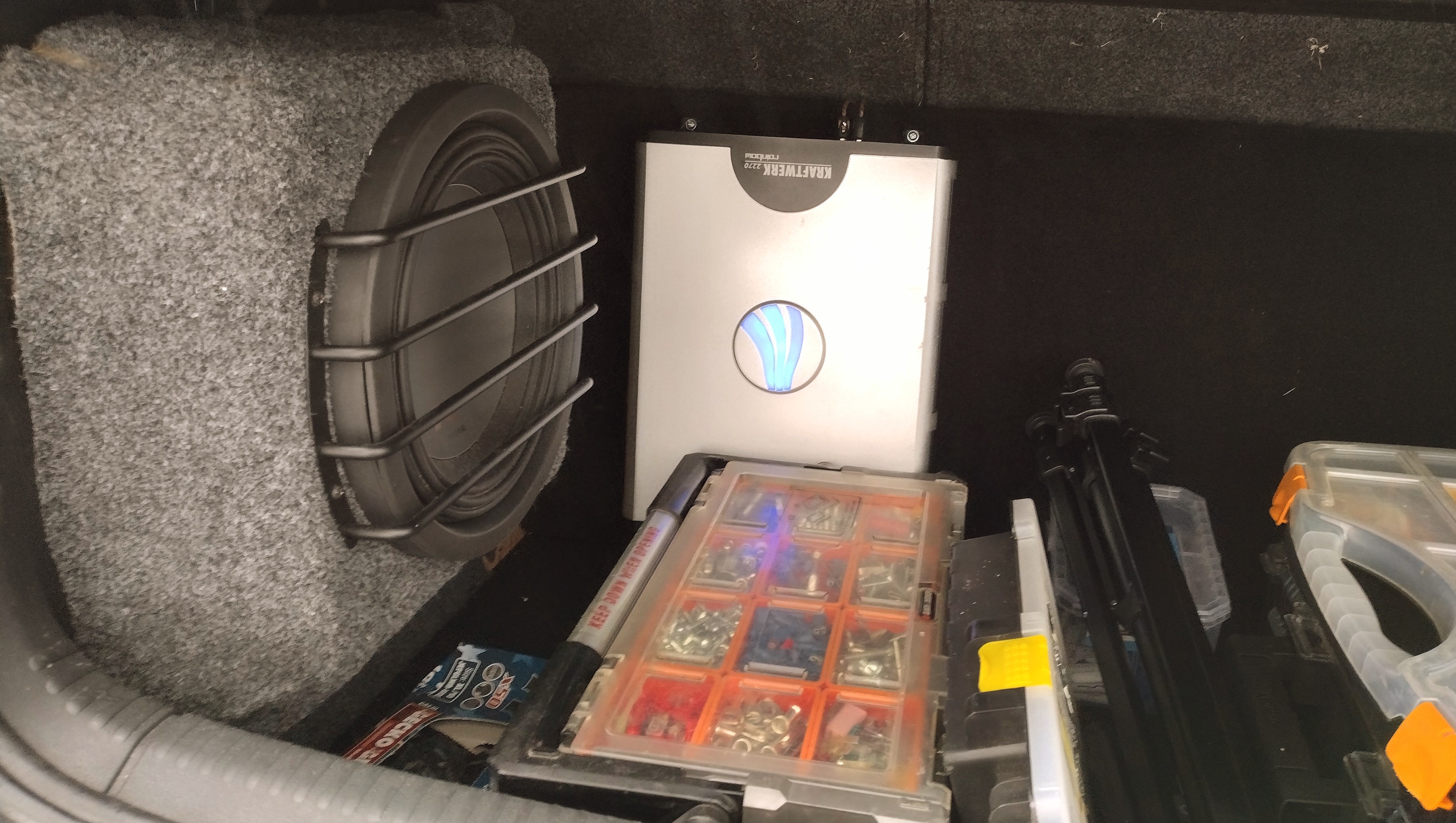

  7. I love the Sony unit, having recently fitted the old model of this: https://caraudiosecurity.com/xav-ax8150-8-95-dab-media-receiver-with-weblink-cast With the facia and trim - around another £40 and £60ish for the steering wheel remote control, it's not cheap but well worth the handiness and vastly superior to the Chinese cheapies. Excuse the dirty pics of the boot - it's a working car and I'm a Spark by trade. I hope to get a build thread up soon.

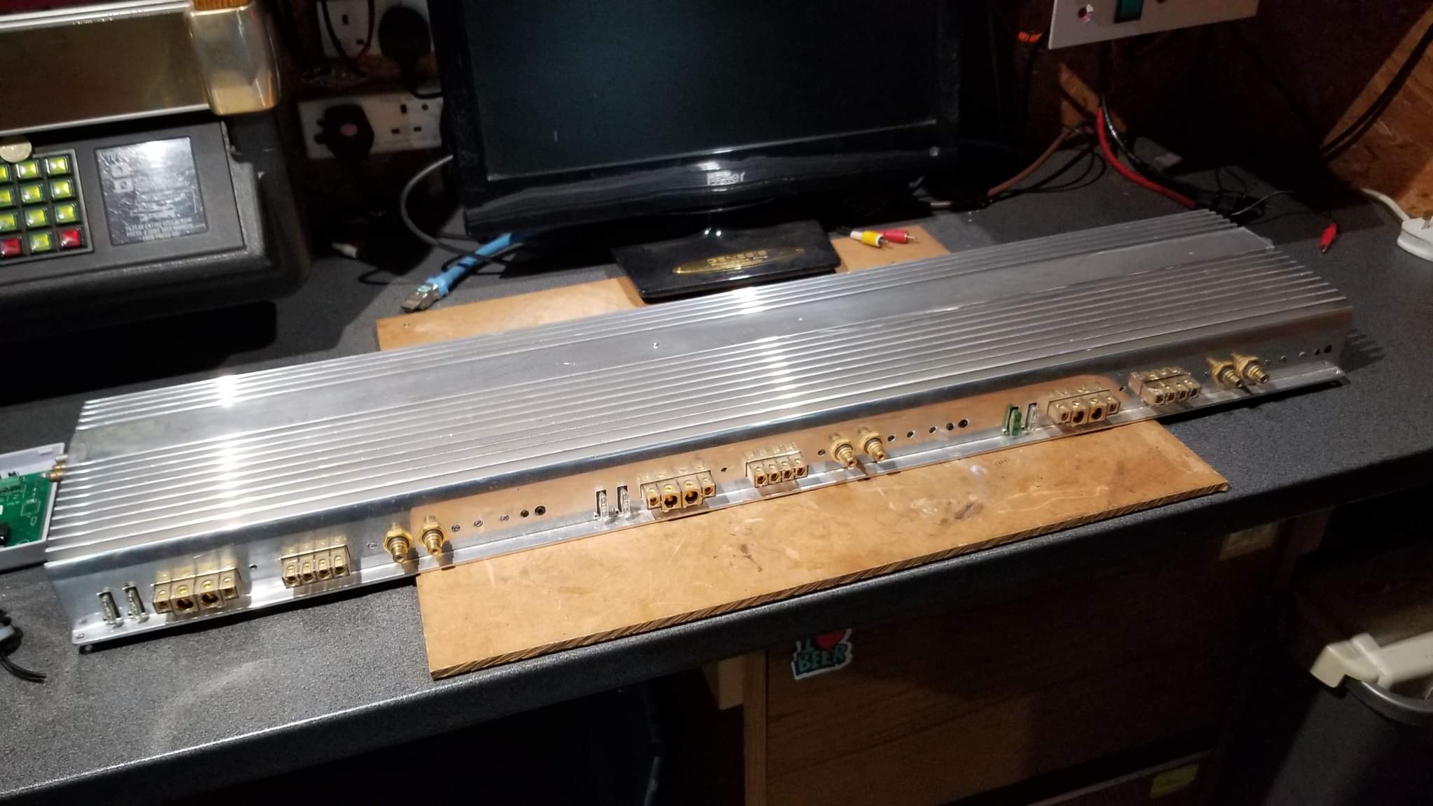

  10. Gordon Taylor (the Amp Doctor) has received it and will let me know in due time I'm sure after a platinum service!! 🤯 I'll probably make a post or two on the install when it's complete.
