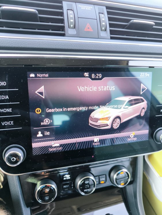

Hello, Superb 2.0 TDI 140kw dsg7 here.
During trip this error appeard and lose odd gears with eml light on, somehow manage to get on the location and swap OEM battery which was dead around 13% of life, but the error persists. Since I was on vacation and car been parked for 10 days with new battery, few times started for couple of mins only, EML light gone. After we had to back home and did 400km run without any problems.
P173600 clutch 2 position pressure sensor was stored and cleared via diag tool. This could be mechatronics problem for sure or bad battery cause electronic went crazy who knows. Want to check the clutch 1 and 2 valve pressures but need reference numbers for it, if somone know. Negative pressure is bad valve but how much in positive it goes, thank you !!!
