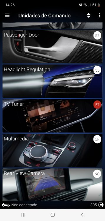

Hello i know this thread is old but i´m thinking in retrofitting the tv tuner, i know the correct part is 8v0919191 and the price is not that expensive on ebay , you can find it for 100€.
What more is needed does anyone know ? where is it placed in the car ?
tuner - 8v0919191
the cables - https://www.naviservice.it/cavo-collegamento-sintonizzatore-dvb-t-tv-audi-mmi-touch-8v0919191/
antena - 3V5035577 don't know what letters next
Edited by Camarao69

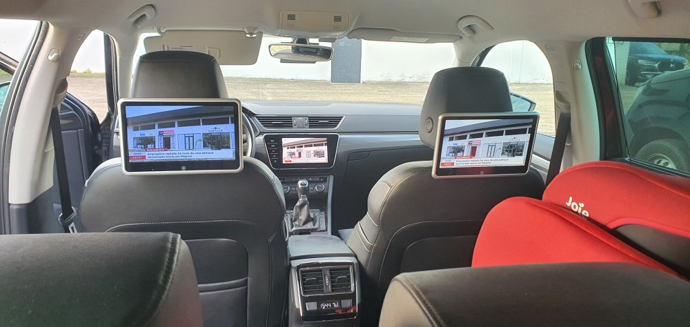

I don´t know if anybody knows this but the tv module will enable RSE (Rear Seat Entertainment) so we can add Rear seat Displays
