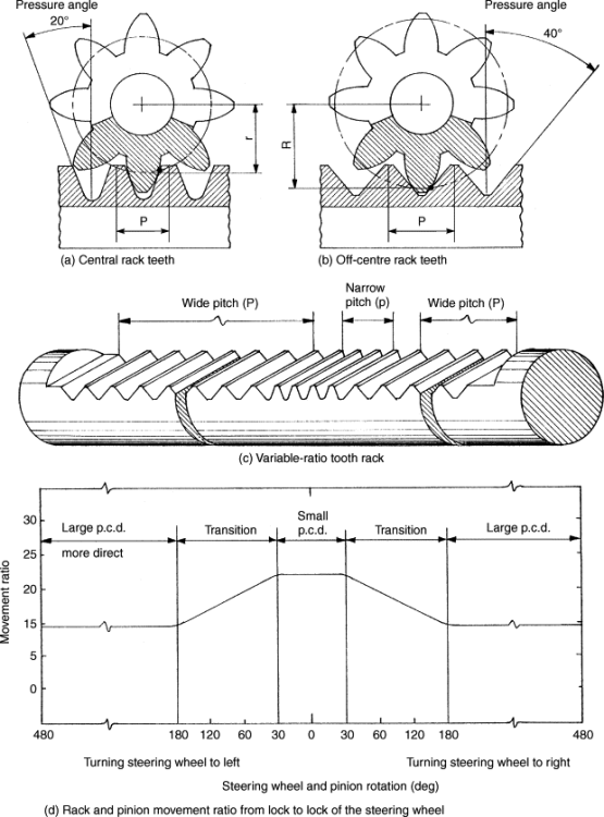

@numskull for the Skoda's, I think it's a variable ratio rack. It gives a more direct/sporty feel without making it twitchy or heavy in the center.

Progressive (VW) and Dynamic (Audi) is a variable ratio rack with variable steering assist.
The Progressive rack is 2.1 turns lock to lock whereas the Servotronic is 2.8 turns lock to lock. The Progressive is fitted to the Golf R & GTI, Passat R line (?) and RS3 and others.

I think its something like this but I haven't seen one appart. There are other designs as well.
