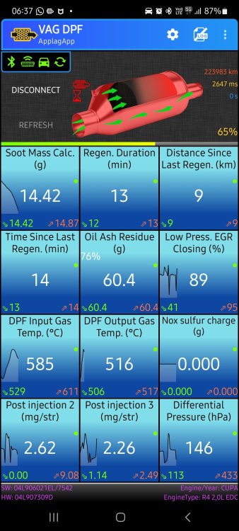

Got access to vcds and shows pretty much same results it's constantly in regen soon as warm don't matter the soot level that's the issue I know the ash level is kinda high about 75% heard mentioned could be glow plugs as engine isn't warming up properly but no dash lights and no fault codes with vcds

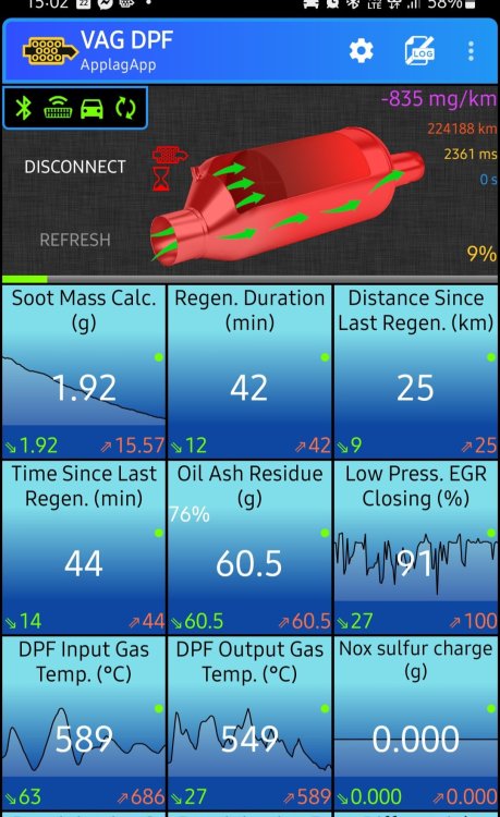

What I find weird is it I do a short journey and fan running when I get back in the soot level say 14g is the same and stays that way till warmed up then slowly comes down but if I go on long journey and soot level is st 2g and get out fan is still running then when get back in after few min soot level rockets too 20g+ then when warmed up comes down slowly

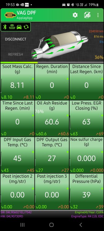

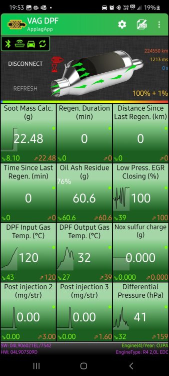

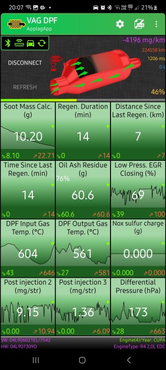

This is before then about few min in then about half way then when pulled back up as can see soon as dpf warms up it's in constant regen then when I turn car off the fan carries on for about 3-4min Also made sure app is setup too correct engine code etc

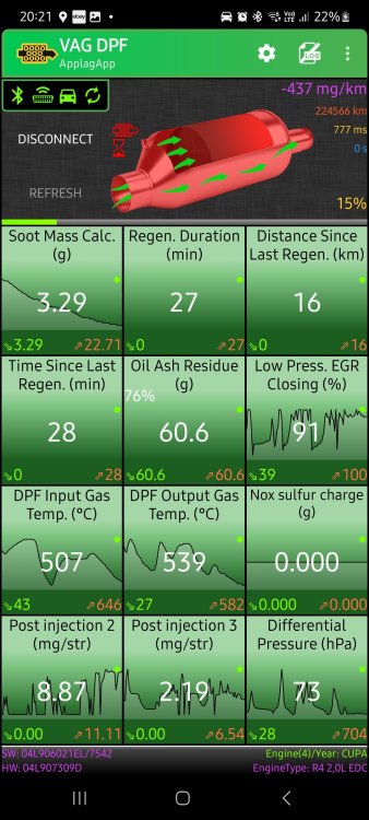

This is today 1 after iv been on 45min trip and below 2g soot but still in regen and when got out fan stayed on then got back in drove about 10min and soot shot up too 22g so unsure

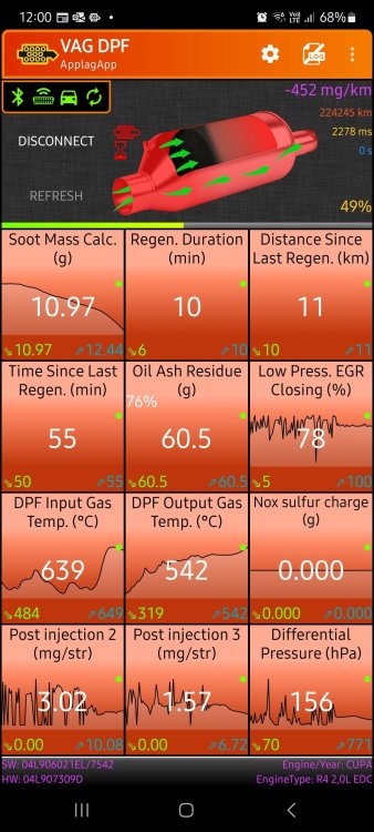

Was told when dpf is red at top it's under regen also I can get out the car and soot is a say 6 fan stays on for few min then get back in the car a hour later soon as car warms up soot rockets too 20+ in blink of a eye then slowly comes down

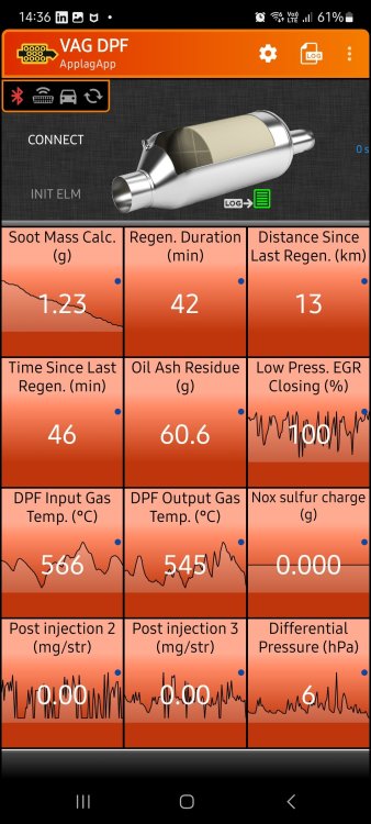

Dis you ever get to bottom of this I have same issue with my octavia so downloaded the vag dpf app and got a compatible dongle and shows dpf regenerating almost constantly
Dpf in constant regen
Seems common I have been told for the tdi but depends how they was drove from new
