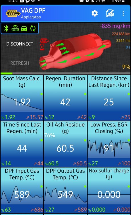

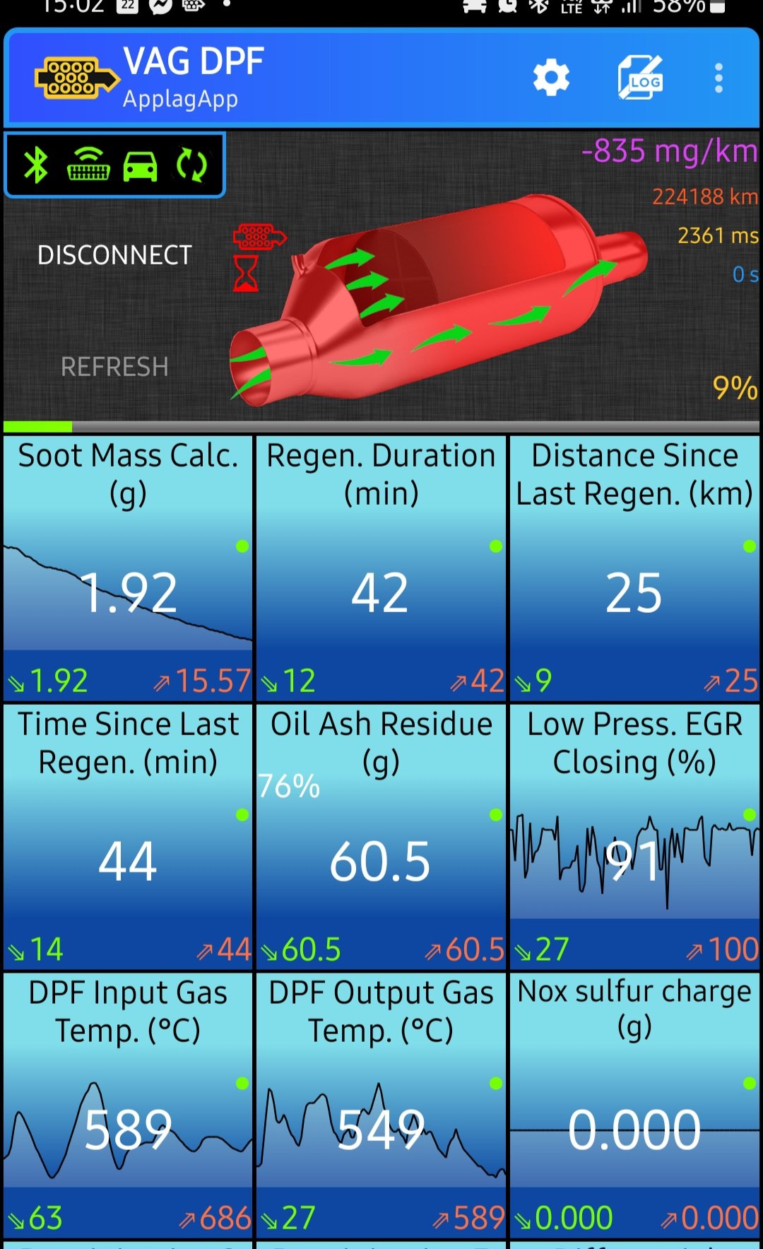

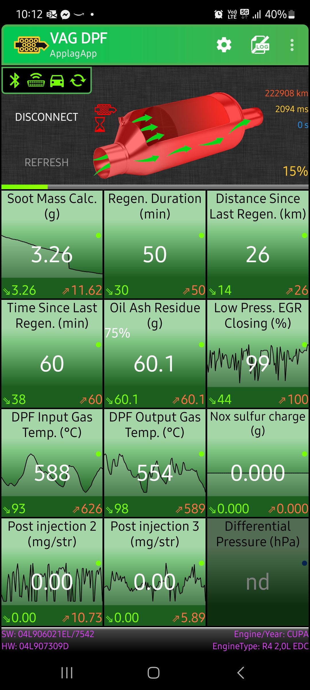

Screenshot_20240522_150205_VAGDPF.thumb.jpg.c6290e83a09604cb5c5e5ee8a5503a1a.jpgScreenshot_20240423_101228_VAGDPF.thumb.jpg.908f23133a66000450fc23d85dcade7e.jpgMy 2014 vrs tdi is constantly regenerating but no fault codes with vagcom I have also run the vag dpf app and shows the dpf lit red when upto temp I'm completely stumped what it could be my soot is slightly high at 76% I have took it for a spirited run for over 30min but still illuminated red but soot is down to around 4g when I pull up. The fan then keeps running and when I get back in a hr or so later soot is above 20g any suggestions would be appreciated???
Any advise on sensors to check 1st as with no fault codes I'm bit stumped
The fact that the "Oil Ash Residue" figure is relatively unchanged and high would suggest that your car is burning oil which in turn points to something else that I can't say for certain over the internet.
How frequently do you need to top up your oil? If quite a lot, you would need to sort the oil burning problem and either clean out the DPF or replace it unfortunately.
There are other threads related to this type of problem if you try a search on the site or through Google that might be able to give you some other things to check. Hope you get it sorted.

Iv searched the net but not really finding anything the ash level has been same for quite a while I suspect previous owner didn't use the correct oil or something but uses about 1l every 1k which I have been told is normal for the cr engine iv also checked turbo by feeling the shaft through the intake side and can't feel any movement so bit stumped at min
