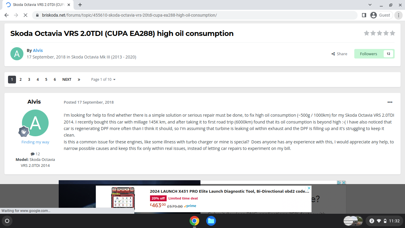

Is it the same engine as these in the Octavia?

I don't think it's the same engine mines a 2.0 TDI standard and not the vrs are you having similar issues?
