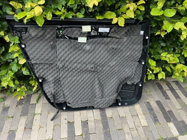

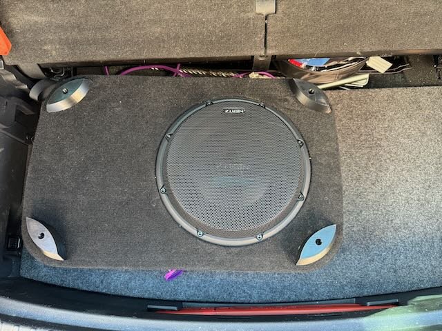

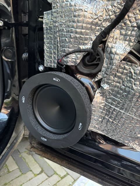

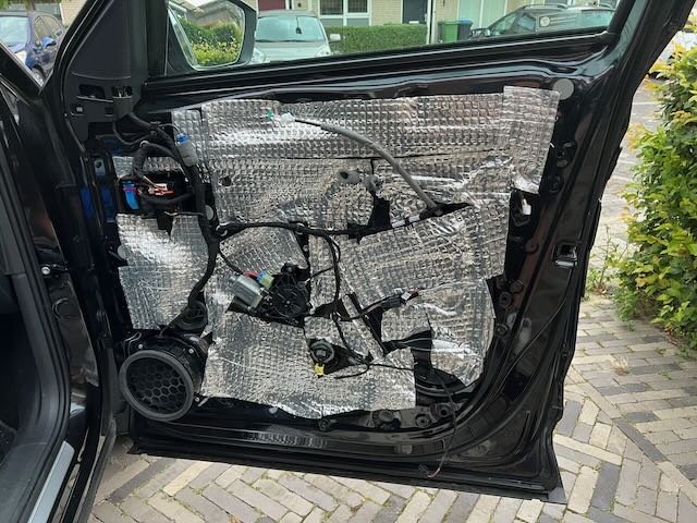

I've removed the spare wheel and placed new floor. Added the Hertz MPS 250 S4 enclosure. Doorpanels is just two screws in the doorhandles and one at the bottom. Deadening doors and most important inside doorpanel. Amp will be the Audison DSP M8.14. So 2 way front active and backdoors coaxial. Disabling Canton is coding: F5/47: change byte 04 to FF and byte 11 to 05 I made a special 38 pin cable to attach to the original Canton cable loom to connect to the speaker. I've build everything so that I can easily replace back to Canton if I would sell the car. When disabling Canton there will be speaker out on the MIB. So a Quadlock cable from the unit to the driver seat where the speaker wires are located is necessary.

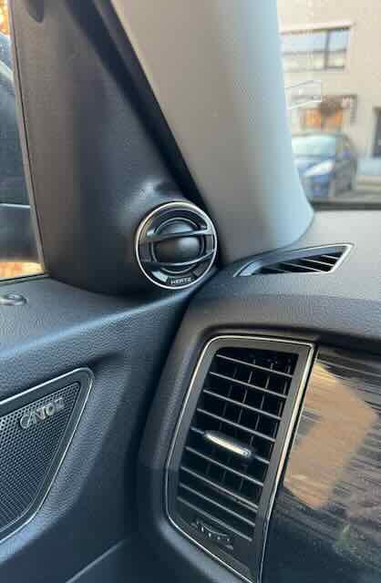

Yes it's two way. I've made a tweeter mount with the right angle and high quality tweeters. That's already way better. The woofers are also replaced.
Crossover frequencies Canton
Agree on that. I’ve replace the tweeters and woofers in front as first step and wanted to change the crossovers. The center (only mid there is) was also replace by more high end. but still as an audiophile it’s not okay. I’ve done all deadening doors and that is a must for good sound. I’ve installed better subwoofer also. Next step is disabling canton and place dsp amp. So that will be for me the best option.

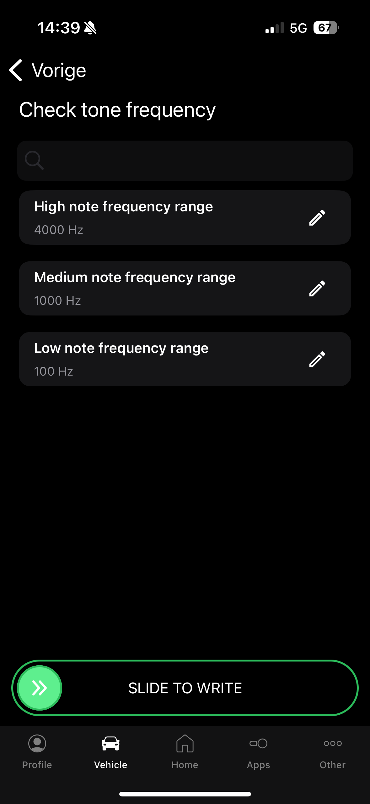

I’ve seen these values in the ‘sound system 47’ area of obd. Would this be the crossover frequencies for the speakers?

After not satisfied with all the options. I remove the spare wheel. Created a new floor and placed an Audison APBX 10 S4S. Used one positive from pair one and one negative from pair two. So 2x 8ohm will be 1x 4ohm. And oh my my my. What a tight full bass I have now.- Canton center speaker

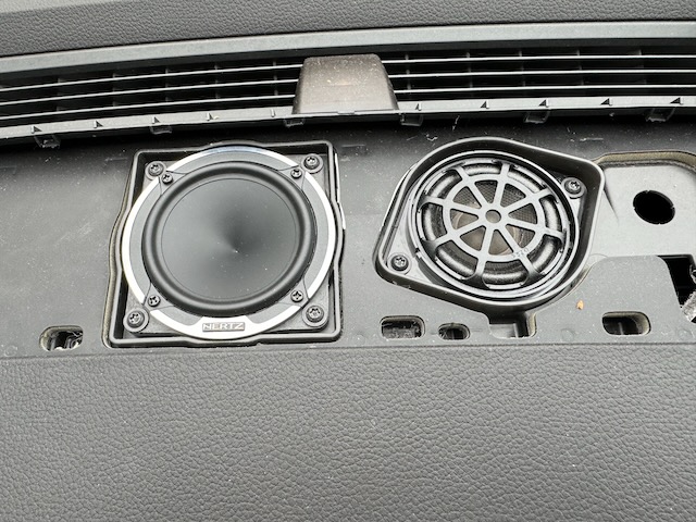

I will be replacing the Canton system later on with new amp and dsp. But for now I've upgraded the center speaker already with a Hertz ML700.3. I've made a speaker adapter that will fit perfectly. Speaker is also a 4 Ohm speaker. Sound quality is amazing. I will upgrade the tweeters in front doors soon. As they are also 4 Ohm.- Center Canton

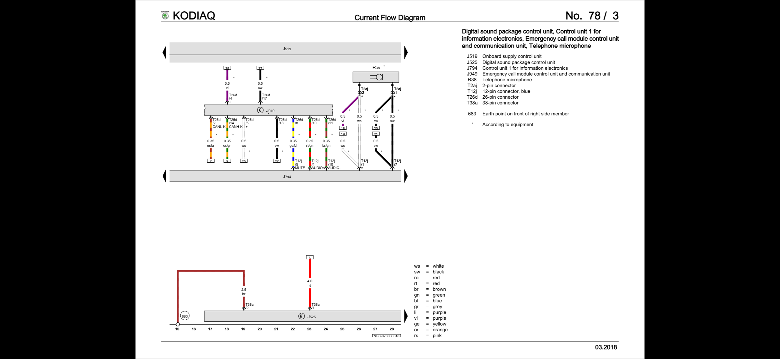

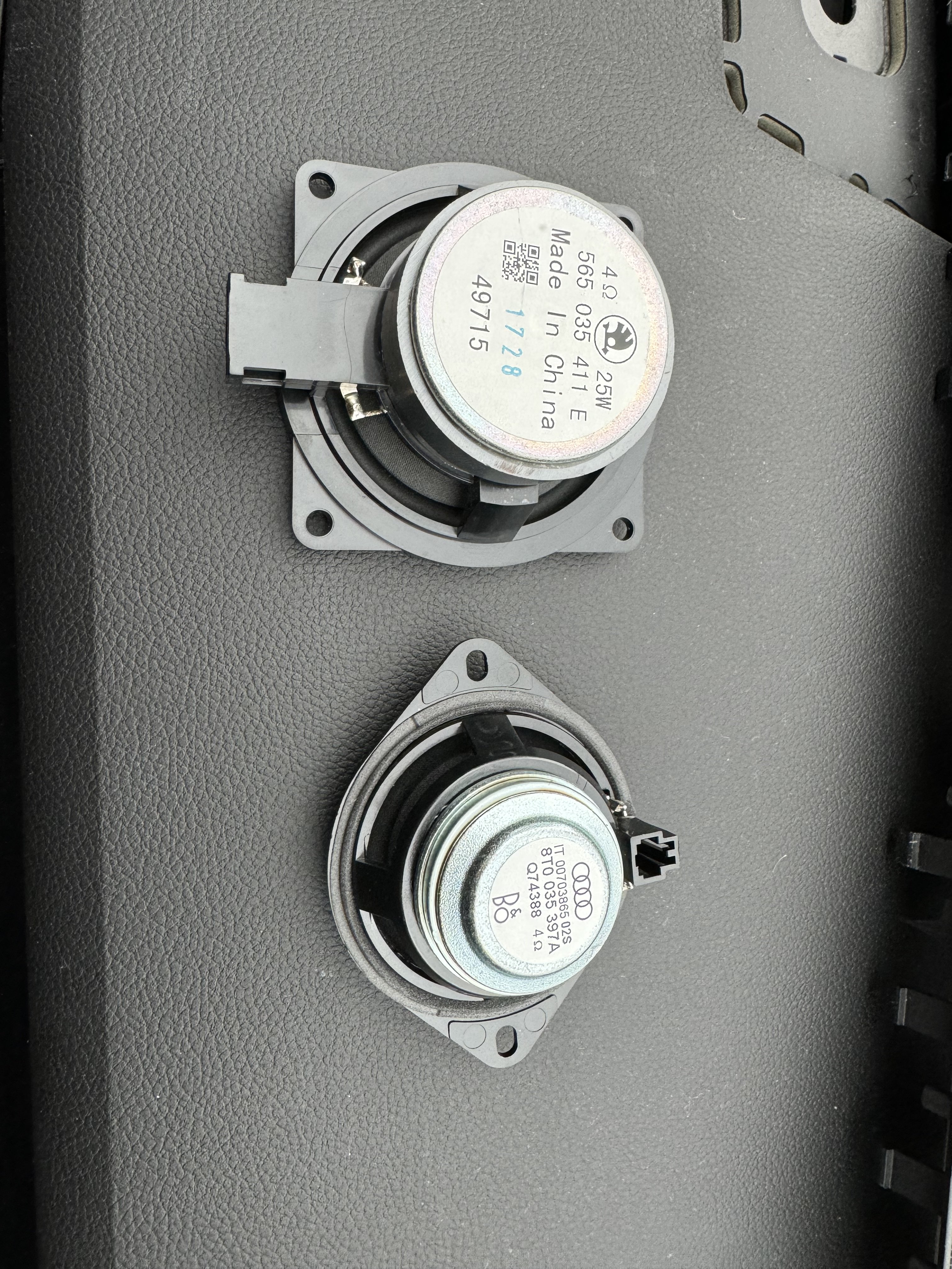

The canton sound system has a center speaker. The 565035411E is a mid-woofer 4ohm. I’m going to replace it with a higher quality speaker. The smaller is the 8T0035397A. Does the smaller one also play the music? Or is it only used for alarm and voice?- Wire diagram canton
Thanks. Yes agree. I have new cable from the headunit to the driver seat to the new amp. From there from the amp to the speaker connector. Do you know how many ampere is on the power? Maybe I could use it to feed the new amp.- Wire diagram canton
I’m planning to upgrade audio and disable canton. I want to make a contra connector for the T38a pin connector to the car speakers to connect it to my speaker out of the new dsp amp. I find the pins for the speakers (see file) as I’m reading it correct. Is pin 1 the power in and 2 the ground? and in the diagram the number on the wires (4.0/2.5/1.5/0.75) are these thickness of the wires? Bedrading.pdf.pdf- Head unit difference between Canton and normal stereo?
That’s great. Do you know how the canton is getting power? I’m planning to place new dsp amp and maybe I could get the power from the canton. - Head unit difference between Canton and normal stereo?
