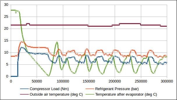

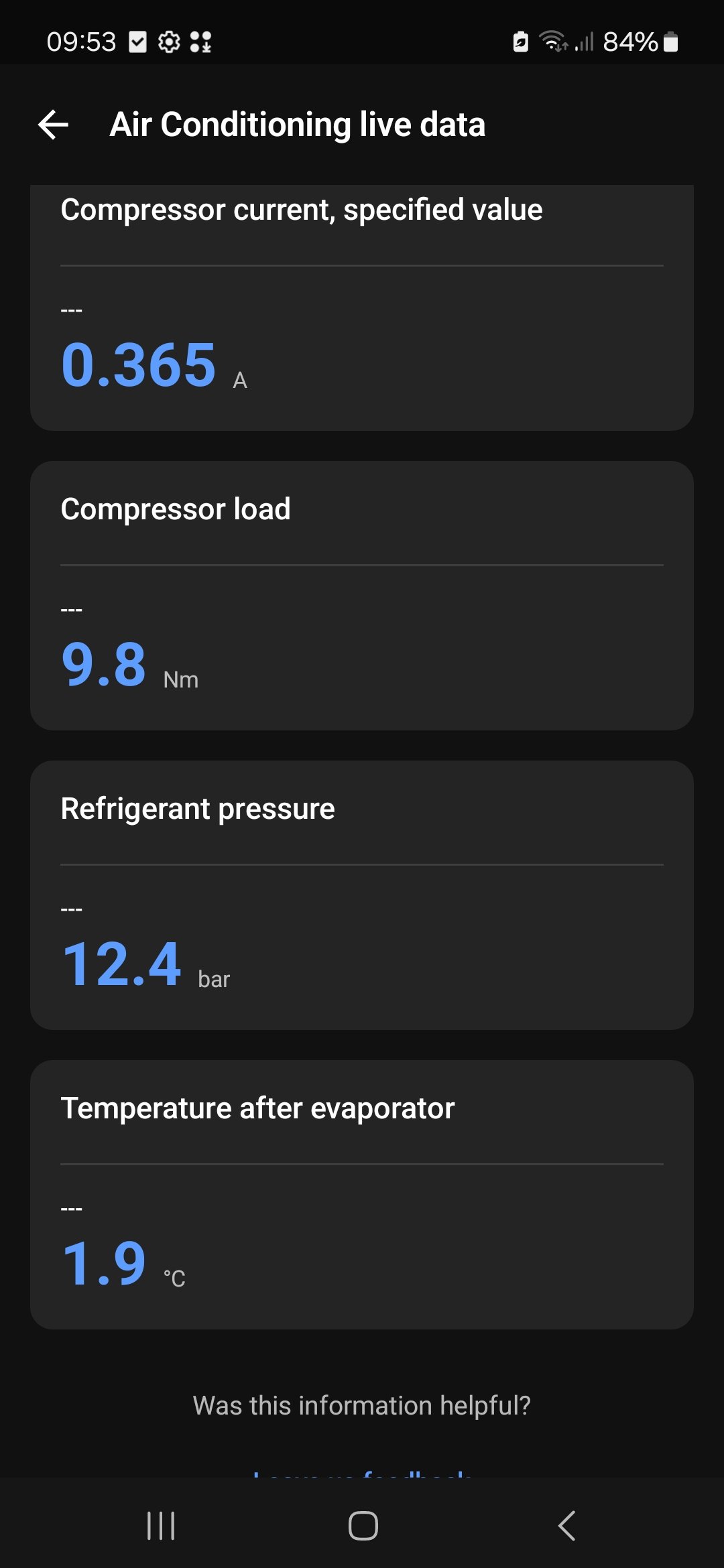

Hi, do you know anyone with an OBDeleven? The "Advanced Live Data" has some useful information, especially 'Refrigerant Pressure', which could indicate refrigerant loss (There's a temperature/ pressure table on page 17 of the manual provided by Arkaig here) Here's a screenshot from my car, which has manual AC:- Mystery flap under bonnet

r0b3rt, similar experience in my 23 plate 1.5 manual with manual AC. I believe it is due to the refrigerant (R1234yf) used in the AC system. Previous cars (2xVW Bora, 1xVW Golf) used R134a and while it was never as good as R12, it would do a passable job of keeping the inside of the car comfortable. R1234yf just doesn't cut it - it will take the internal temperature down a few degrees C but as you say, in the current mini heatwave, it isn't enough to give the level of comfort that you would expect from experience of older cars. Look on the bright side - the Global Warming Potential of R1234yf is much lower than that R134a or R12 (although this is only relevent if all your refrigerant somehow leaks out) so you're doing your bit for the environment. It's also much less likely to result in that disgusting smell that most older AC systems seem to acquire after a few years use.- Front Assist: sensor impaired

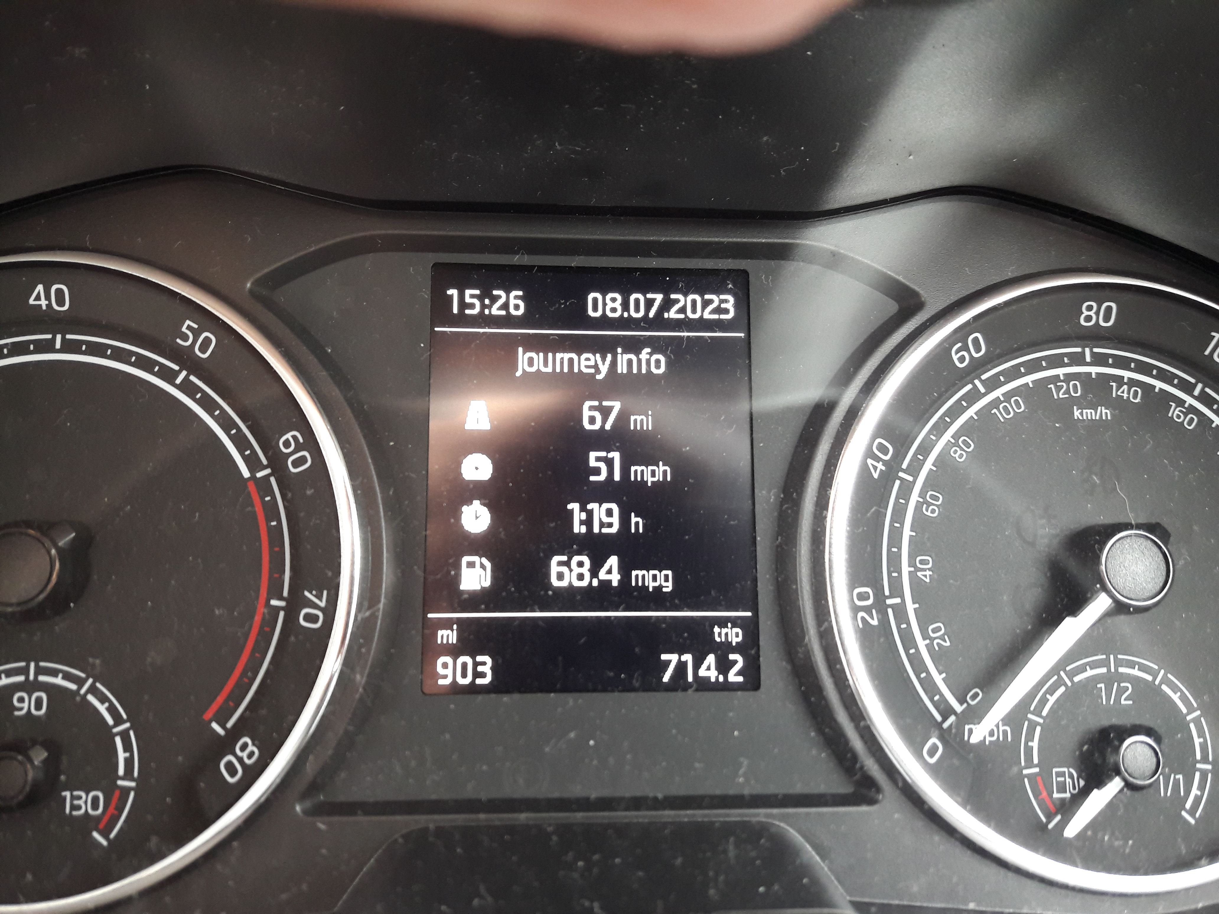

An update on 'Eco' mode; here is the dashboard summary following a journey from Birmingham Airport to Ross-on-Wye. The M42 had a 50mph limit for most of the distance from the airport to the M5, and there was heavy traffic round Birmingham Otherwise, speed was 60-70mph. I am quite impressed, as neither of my previous VAG diesels (1.6TDI Golf, 1.9 TDI PD Bora) managed a similar journey at better than 60mpg. The acid test would be to repeat the journey in the other modes but that will have to wait until next year's holiday. Also need to do a full tank to full tank test to determine if the display is accurate.- Driving mode select
