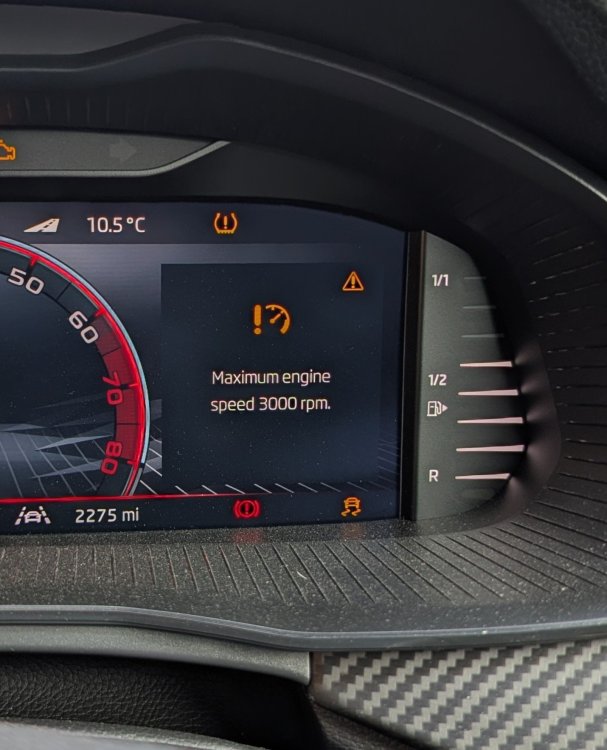

Yesterday the car would unlock but all the screens were blank and it wouldn't start. Called Skoda Assist who arrived surprisingly quickly. The battery had gone flat, he boosted it to get it running and then did a load of checks to see if there was a parasitic drain, his suspicion is one of the on board systems isn't shutting down. He advised I leave it hooked up to my Ctek box until it's been back in. So it's going in on the 26th for more investigation but I have lost all faith in it now and just want rid of it. Such a shame as my Octavia and my Kodiaq were good cars.

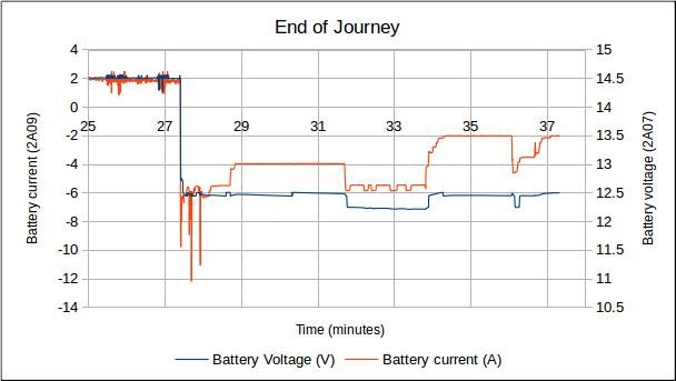

This piqued my interest enough to get an OBDeleven to keep an eye on the battery, amongst other things. According to 'live data', the battery drain (which I would expect to be close to zero with the ignition off) can be as much as 6 amps for several minutes after the engine is stopped and 2 amps after that. This is a graph of the 'live data' logged from the OBDeleven at the end of a recent trip:
For information, there is also a graph of the journey start here. Do you know anyone with one of these devices that could look at the battery drain on your car? I appreciate that this is Skoda's responsibility but from my experience very few dealer 'technicians' really understand much beyond what the training manual says. Forewarned is forearmed and all that.
P.S. Some of the other 'glitches' you mentioned in your first post have also happened on my car - Random Parking Sensor activation (annoying), Collision detection with braking (scary) and no accelerator response (even more scary) but the dealer attitude is to ignore them if you can't reproduce them and to remind you that if they do a diagnostic test and don't find anything then it's £130 + VAT thank you very much.

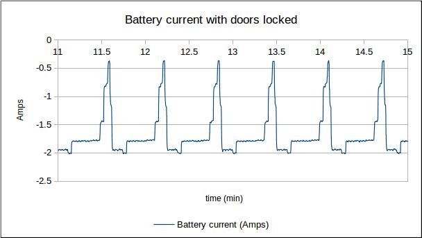

Further investigation using the OBDeleven suggests that the act of reading data has a price in terms of battery current. For this test, the vehicle was locked and just the battery current was recorded:
If this is (a) accurate and (b) continuous then the average current of 1.7 Amps would probably see the battery drained within 24 hours. When the test was ended and the OBDeleven removed, it was noticeably warmer than the ambient temperature. The advertised 'quiescent' current of the device is 45 - 100 mA which seems hardly sufficient to cause it to warm so, as nta16 has observed, probably best not to leave the device plugged in when not in use.
I'm on the lookout for a DC current clamp meter to get a non-invasive measurement.
I'm not sure how accurate current clamps are. A specifically designed battery monitor is what say motorhome owners might use. It has been suggested before to buy a secondhand, or new, good quality battery monitor, as per the last links I put up, use it as required then sell it on to get some of it's purchace price back.
My prefference is always to measure the battery directly, that is directly from the battery terminal posts or terminal post clamps if their connections have been confirmed as clean and secure with no (reasonable) drop between posts and clamps, as at this piont in time it is what is happening to the battery is what you want to know, then, if required, you will want to know the cause(s) of what is happening to the battery.
That's how I see it anyway.

So the car went in on the 15th June and I got it back today. After running loads of diagnostics the ECU was shown to be faulty, this had to come from Europe as they don't keep them on the shelf in the UK. They also found a loose pipe in the engine bay which seemed to be related to some of the errors we were having.
Drove 70 miles home without any errors but had to leave it in sport as the throttle response in D is still crap,bit like turbo lag from the good old days. Sport seems to almost stop it dropping in to two cylinder mode, which causes more issues than it's worth. They haven't replaced the 12v battery but if the car now behaves I will be swapping it myself for a better Yuasa AGM one and recoding it with my OBDELEVEN.
If the car doesn't behave then I will probably just sell it as being seven months old now, the amount of agro to now reject the car became very very obvious in conversations at the dealer plus there are other things in our lives at the moment much more important than wasting energy fighting an up hill battle.
