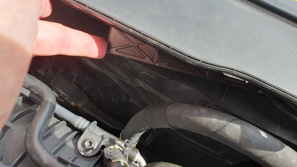

Enjoying my new (used) Scala 1.0; but there's an annoying intermittent rattle from the front at motorway speeds.
I'm no good with spanners, but a look under the bonnet reveals an unsprung/unrestrained small flap above the radiator - see pics. Photo and video are is taken with me by front right wheel, looking towards the front of the engine bay.
If I manually move it up and down, it makes a similar sound to the annoying rattle - I can imagine it flapping open and closed when moving at speed.
Anyone know what it is? OK to tape it open or closed?

It's a flap on your intake, gravity should drop it down when stationary, inrushing air keeps it open during driving to allow cooling air into the engine bay, it does look like yours has become detached on one side ?
Probably ok to tape up to see if it cures your rattle. then further investigation (top of intake off) and see if a clip has broken.
Should the flap (or something else?) occupy that small square hole(?).

I'm reluctant to take spanners etc. to the car at this stage, since I've only had it a few days, and it's under warranty for a year.
As far as I can tell the flap is just hinged on its top edge, and doesn't seem to have fixings for springs or any other kind of control.
I've been in touch with the dealer who sold it, and sent the same photo and video, so it will be interesing to see what they say.
For now I've also put felt pads in a few places to mute the noise it makes when it opens or closes.
I'll post an update if/when there is one.
Looks like the flap is disconnected at one end.
Thanks, Aldfort - but I'm pretty sure the flap is top-hinged at both ends; it only moves in the direction of being opened or closed.
Mike
Looking at your video it appears that the flap was stuck in the open (up) position until you touched it and then it fell down (the video ends with the flap partly down)
On my 23 plate 1.5 the flap is in the down position when stationary. It lifts easily to the up position and falls back when released without making any sound. (It appears to be slightly damped but I imagine that is caused by friction at the pivot points)
I don't know what road speed it is designed to open at but from the size of it and the intake scoop that feeds it, I can't imagine that it would open and close quickly enough to result in noise under normal driving.
Do you only hear the noise at low speed after a period of driving at a higher speed? That would be consistent with it sticking in the open position then falling back.

Hooray! Identified and fixed the rattle!
It spent a day at the dealer, but they couldn't identify the source of the noise. They suggested that it might emanate from inside the dash, and since the warranty doesn't cover the cost of eradicating squeaks and rattles, I wasn't prepared to pay who knows how much to have the IP removed, taken apart and reinstalled.
However, I'd noticed that the noise only became apparent at speeds above around 50mph, or when the weather was windy. This led me to think that it must be caused by the passage of air somewhere.
Then I began to wonder about the under-engine tray - what if it was that which was flapping under the right/wrong conditions? Feeling under the car revealed that though the tray was securely attached front and back, at the back there was still sufficient play for it to knock against the car floor. Wedging the rear of the tray in place has cured the problem - at last!
But I still don't know what that little flap inside the top of the bonnet is for...

That flap, as long as it opens and shuts I'd not worry about it, I could have a guess at what it might be but without seeing it in situ, or even then, it'd just be guessing. You have found you are better than the Dealer a working some of these things out so if you still want to know have a good look at it, where the air comes from and goes, and see if you can work it out.
