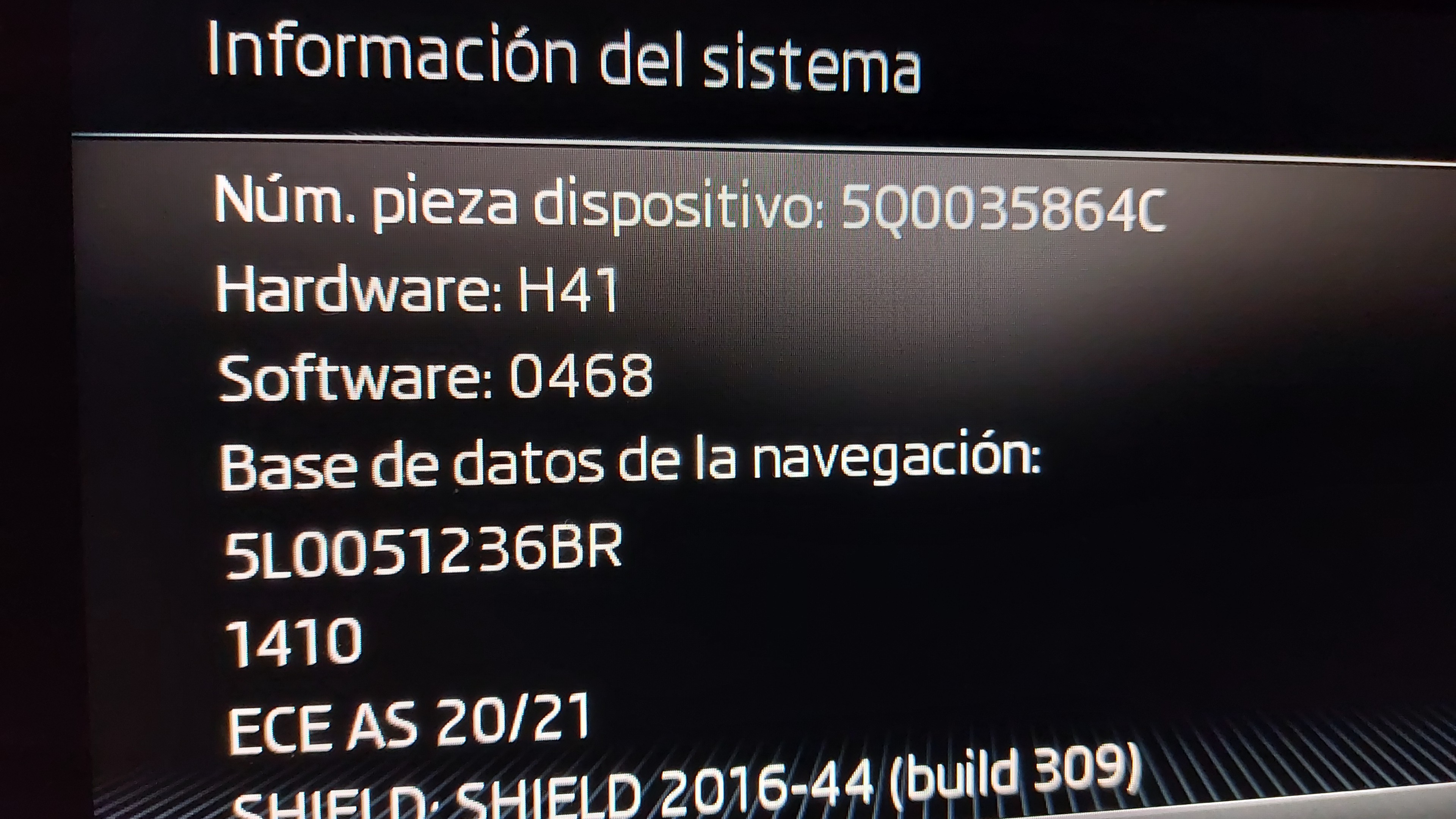

Afternoon!!
I want update the soft, I have this version, it's possible & recomended??
My "blind spot detector" only works around 8minutes, after that WARNING NOT VISIBILITY, before that the detector works perfect, I don't understand it, so confused to me.
N. Disp: 5Q0035864C
Hard: H41
Soft: 0468
Thanks for the all the info fellows!!!

You have PM for 0480 version
Thanks a lot!!
