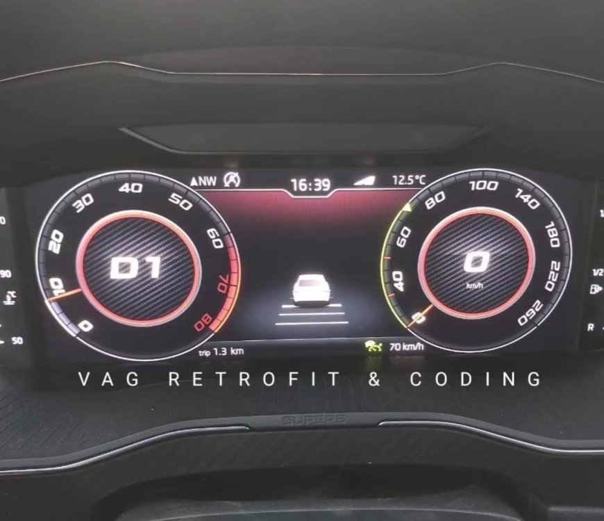

3 hours ago, deepshegde said:
I recently retrofitted virtual cockpit on my skoda superb 2017. How do i get sports dial something like in the picture?
That is the default display.
do you mean the theme/skin?
you have to mess with the variants in adaptations
