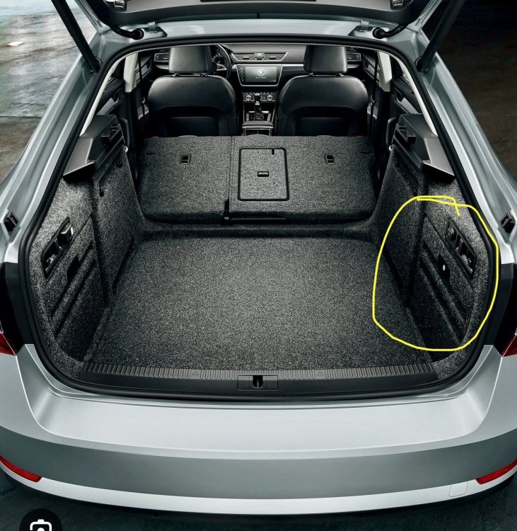

This is the cable i bought https://a.aliexpress.com/_mORqDsS
Yes, male connector goes to mib and female to canton and another one to VC..i can see red light too at the end of connector..not sure why it isnt working
