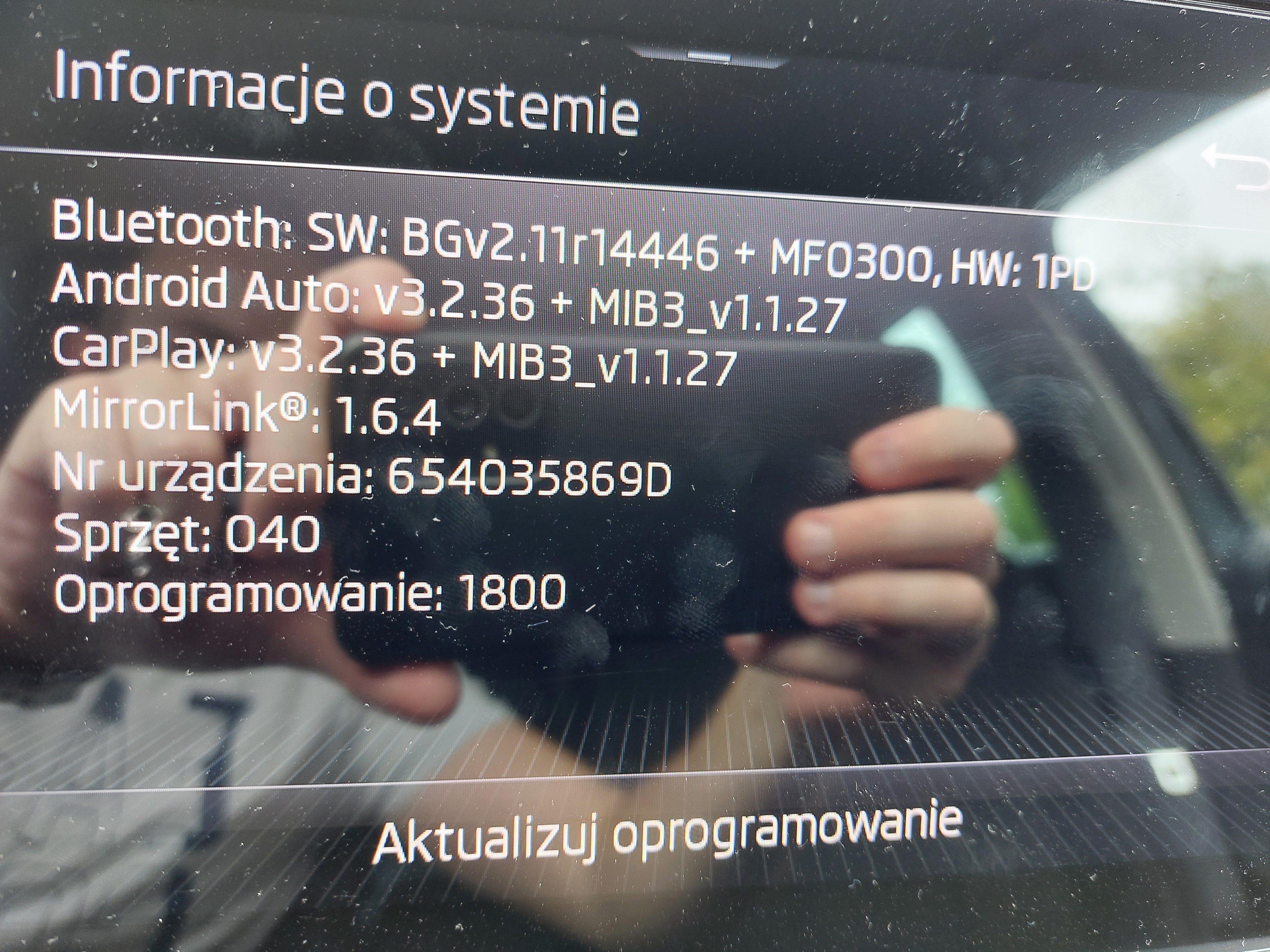

  14. Fw 1800 resolved android auto failure with samsung s23/+/ultra. I didnt see anything else with this fw. Yes. There is risk to brick your system. Update only if you have a reason, not for fun IT is no a game.
  15. Zero faults. All smooth.
  16. I confirm. I have just get a/c service and I had only 150 g of cooling gas. My a/c system should have 500g. Whistling noises in dashboard is symtopm of low cooling gas in system - as you said. But my problem is larger. I have change condenser last summer and I have checked cooling gas at spring, it was full. Now after 4 months seems to be leak, 350 g of cooling gas was missing. Another sympthom that I had was low metalic noises on idle when I accelerate, only with a/c on. It stops after last a/c services in winter. Someone has simmilar problem ?
  17. Hi, I have successfuly update sw directly from 1310 to 1800. Android auto works with s23u after update. It lasts about 20 minutes.
  18. Download FW https://easyupload.io/p9xaox MSTD_EU_SK_P6230 (0490) Unpack archive to sd card or pendrive (min 8 GB) fat32 file system Unpack files directly to root folder of mass storage so the car could see it Prepare charger for battery in your car Connect charger so battery will not lose voltage when update will proceed Turn ignition on, engine off Press menu button for about 3-5 sec Get into service menu Choose right mass storage usb/sd card Follow instructions DONT'T turn ignition off while update All at your own risk - there is small risk that you can brick your unit Good luck
