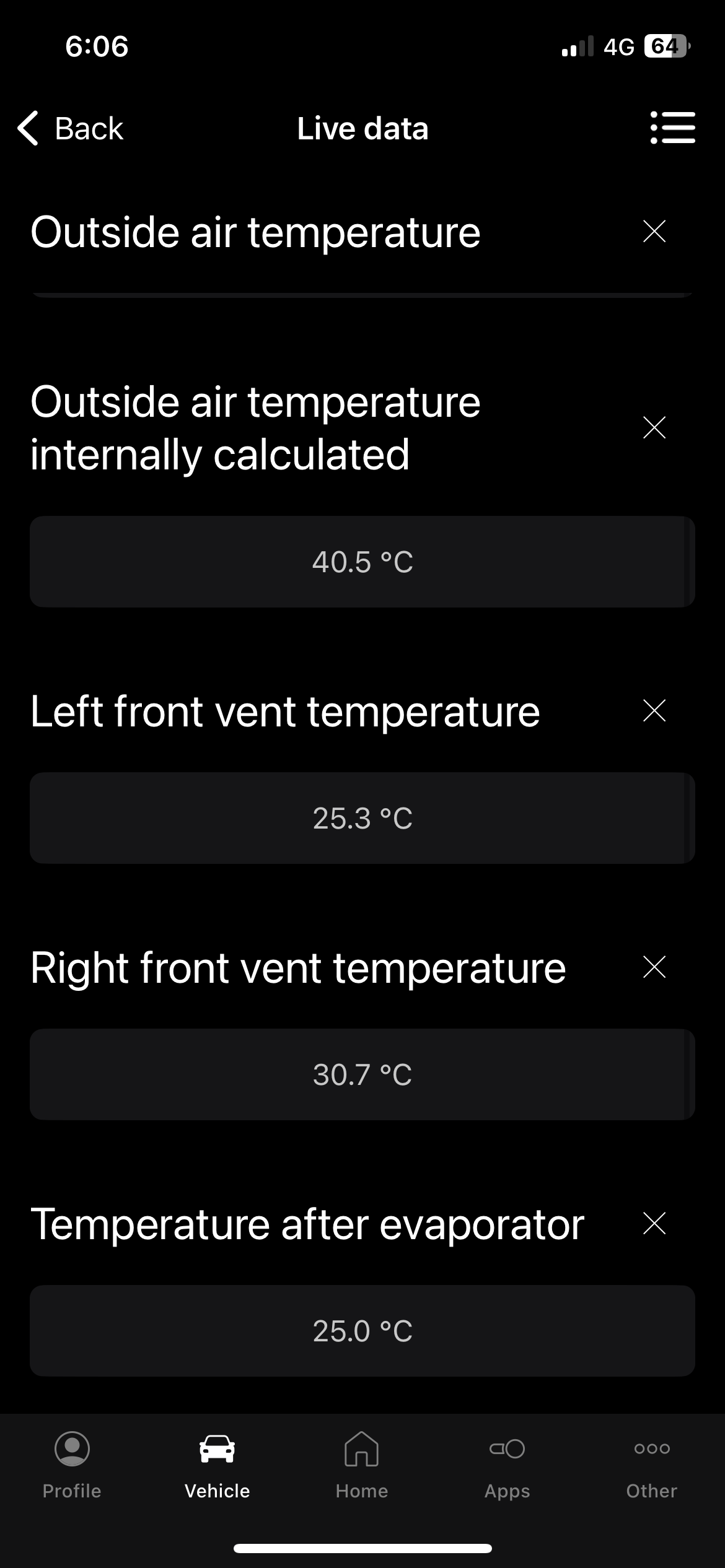

  • The key thing is the after evaporator temperature, 5.7°c with an outside air temp of 40°c is excellent, putting the fan on high increased it to 25°c confirming your thoughts that the system does not h
  • What J.R is getting at is if there is a sensor reading 10 degrees lower than it should be, the control module won’t know this is a bad reading and may output air significantly hotter than it needs to,

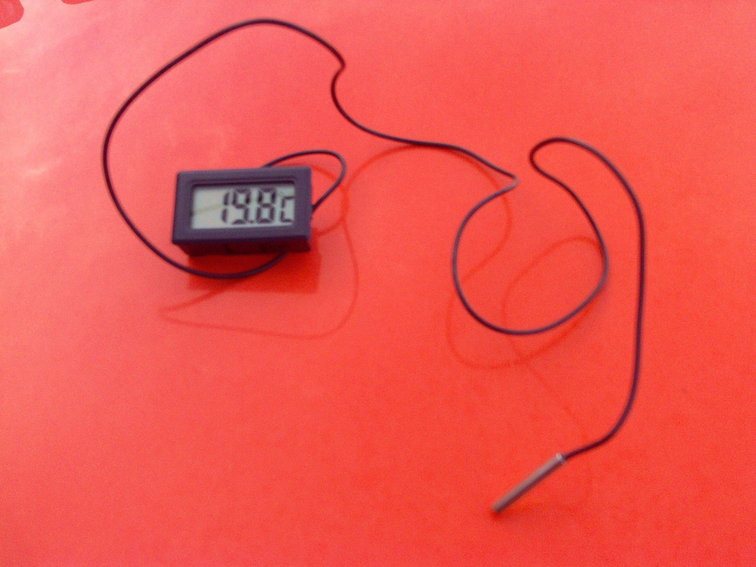

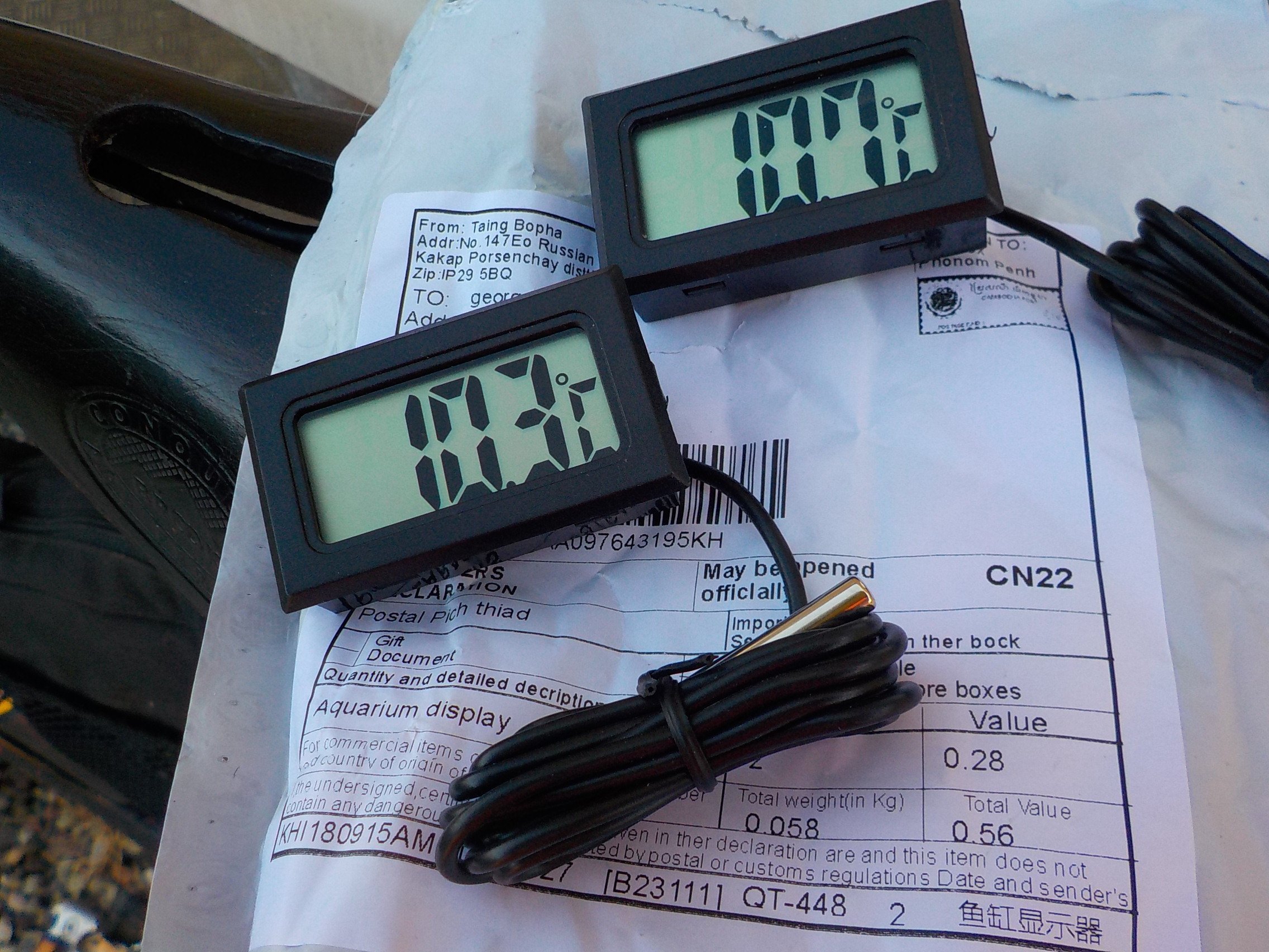

A Digital Fridge Thermostat is about 3 euro.
Then you will know how low a temperature the AC can get the cabin too.
(and tyre temps can get checked as well when doing pressures, maybe when there is a TPMS warning and it is a sticky brake caliper, or a bearing going and a wheel getting hot.)

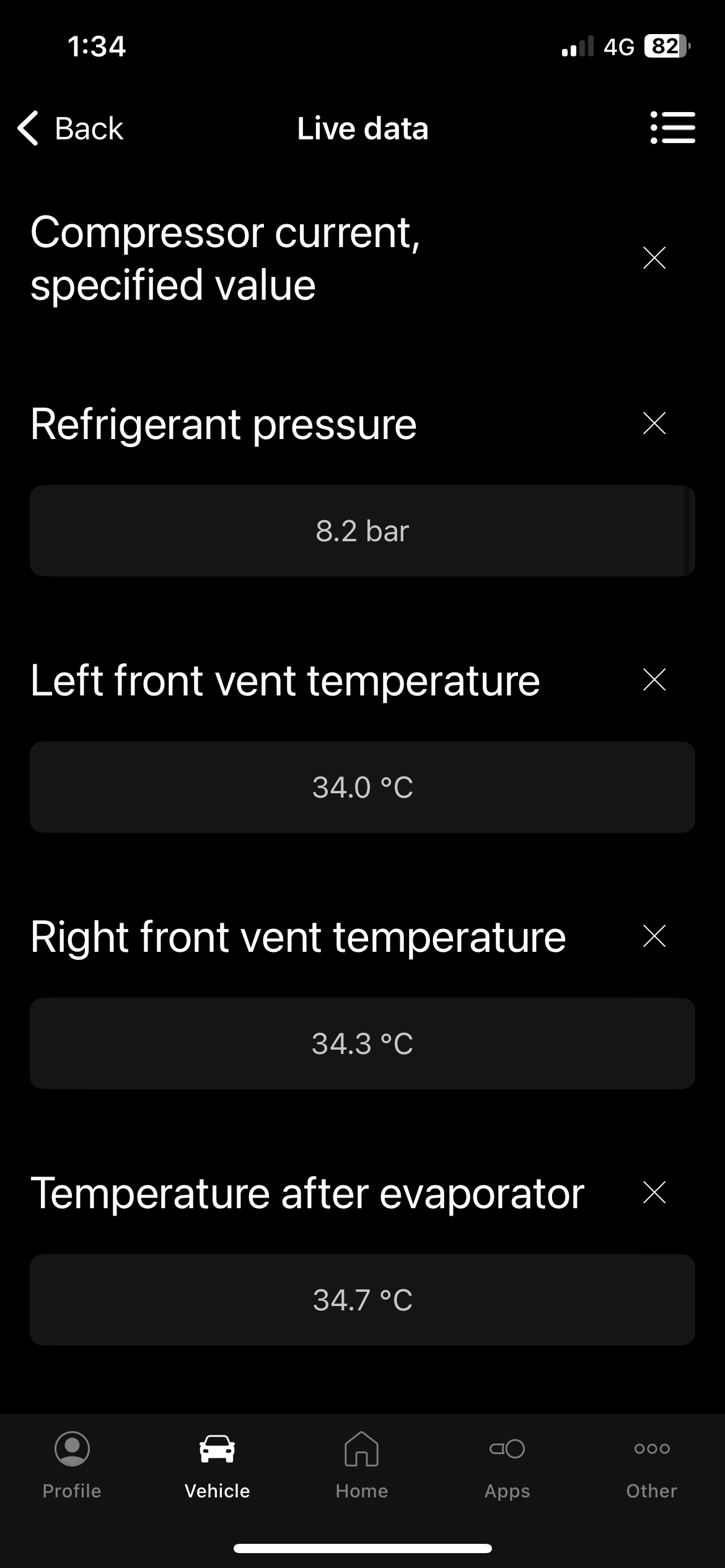

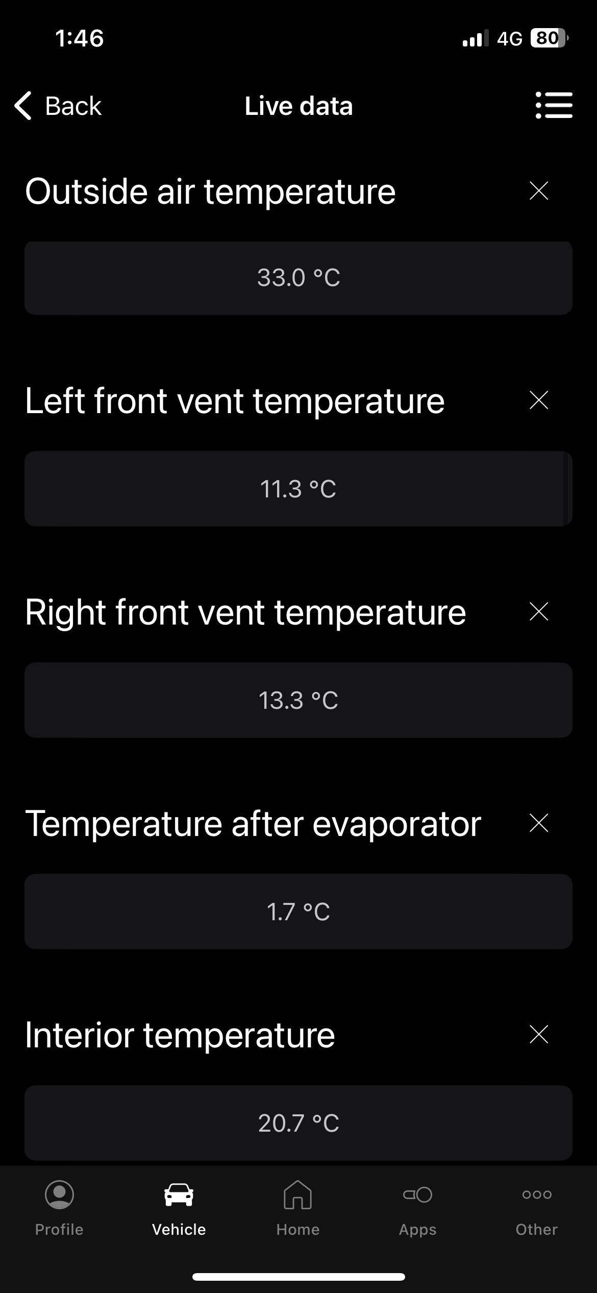

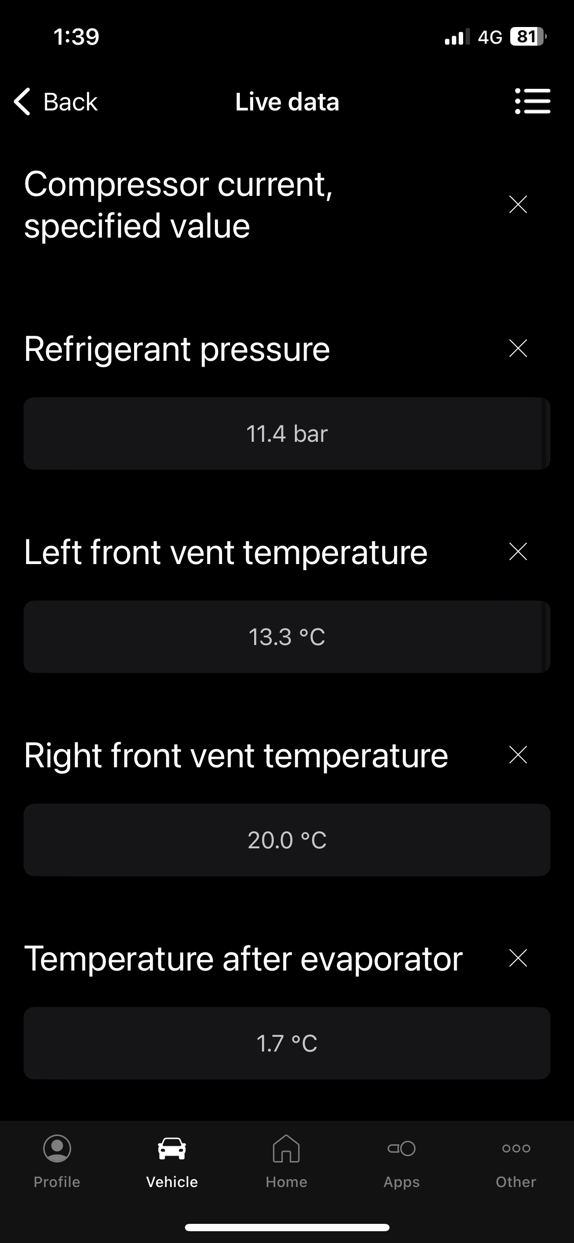

Well I checked live data and let me say this is not what I’m getting at day time!!
Data was taken at nighttime and the AC worked fine. At 31 to 33°C ambient temp I was getting pretty cool air from the AC. There was a minor difference in temperature from right side but later it settled at 2 degrees difference (see photos). IMG_0169.thumb.png.d79c1c8ef80f4c7a63e8d57b4453c9eb.pngIMG_0170.thumb.png.f2222b3a7a0060b863153babffd64adb.pngIMG_0169.thumb.png.d79c1c8ef80f4c7a63e8d57b4453c9eb.png
Im not sure about the refrigerant pressure (8.2 to 11.4 bar) IMG_0167.thumb.png.f6e92ec5d3fa865a16c856cbbd4f915a.pngbut it was a bit too high of what I saw on YouTube on VW group cars. (Around 6bars). Nvm, again this is not representative data of what I’m getting at day time with higher ambient temperatures.

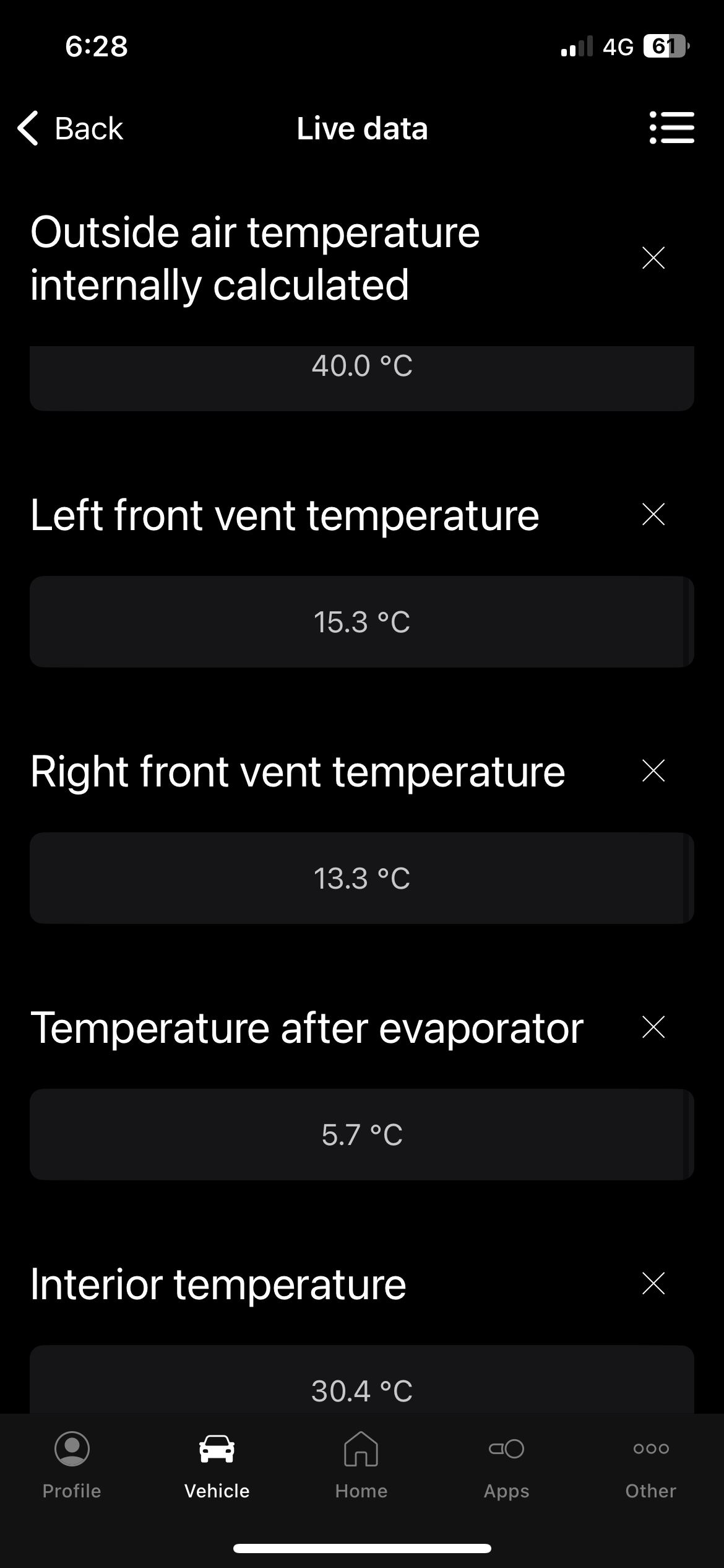

So, I checked the values at daytime and here is what i noticed.
When I set the AC at lowest temperature and the fan speed at maximum it never could produce enough cool air.
But when I reduced the fan speed to half speed I saw a big difference. The readings was nowhere near as before and the air was cool enough not ice cold though!
My theory is that due to low refrigerant on AC system it cannot compensate outside hot air to make it cold with the fan blowing on high setting. That’s why when I reduced the blower speed it manages to cool the air.
Last but not least the pressure of refrigerant seems a bit high at 16 bar(232PSI)!! Does it fit as a symptom of the fault??
I’m posting the live data here.
IMG_0202.thumb.png.123259e58f7205092d53da5b4d4866f1.pngIMG_0203.thumb.png.62608d5a2fe960b7a2446133f567ff4f.png

The key thing is the after evaporator temperature, 5.7°c with an outside air temp of 40°c is excellent, putting the fan on high increased it to 25°c confirming your thoughts that the system does not have enough power to cope with the refrigeration demand on full blower setting.
That could indicate a low refrigerant charge but I think that your pressure is correct, the stupid VAG/VCDS set up reports absolute pressure and not gauge pressure so you can deduct 1 bar/15psi from your figures, the figures that you have read on Youtube are almost certainly for an ambient temperature of 20°c.
R134a static system pressure (guage pressure not absolute pressure) will rise from 70psi at 20°c to 130psi at 40°c, the high side pressure when system running with an ambient temperature of 40°c will be between 180 and 225psi, that is a figure to cover all vehicles and the variable output VAG type with the modulating valve will be lower than this unless under maximum load, my gauge measurements at 20°c vehicle idling at standstill show the high side pressure rising to 150psi at which point the fans cut in and it drops to 100psi, this falls within the range given on the R134a tables of 100-150psi at 20°c.
Are the fans running correctly on your vehicle?
Your system will never have enough power to cool your car right down when idling with 40°c ambient temperature, if you look at the figures the air coming out of the vents has dropped by over 25°c at the lower fan setting, aside from the sticking flap mixing hot air to the left vents I say your system is working perfectly, it was designed for average European temperatures probably biased towards the cooler countries.
If you want maximum cooling on maximum fan speed you need to drive the car at speed.
Most of us have gradually worked these things out, we know high fan speeds at standstill create less cooling, when my car has stood in the sun I leave the windows open initially, use the AC on min temp and fan speed 1, once moving I will switch up to fan speed 2 and close the windows, when the interior temp has dropped enough I will switch to recirculation mode and put the fan on the highest setting.
I think you are expecting too much of your system and have a problem with the blending flap for the left hand side.
