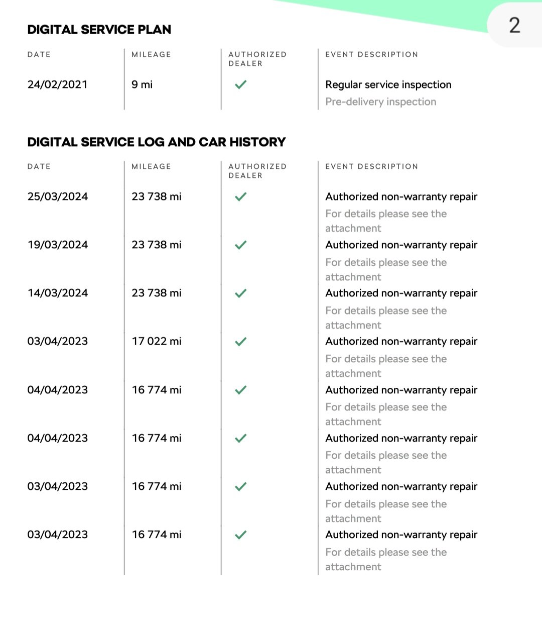

  2. I just found this in MyŠkoda App, unfortunately it not showing details
  3. So the reset helps. Thay told me that it's still not working, but I just tried in a case, and it does. Finally I'm a primary user.
