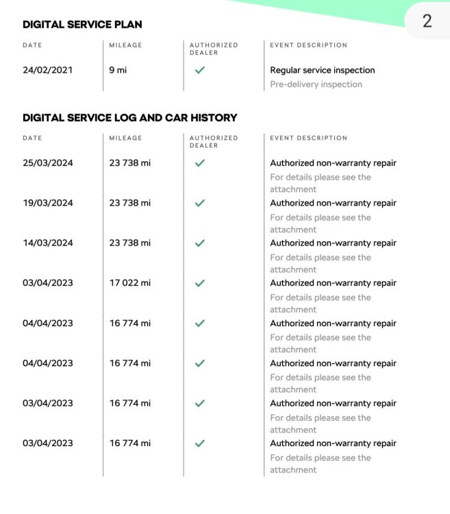

  2. I just found this in MyŠkoda App, unfortunately it not showing details

  4. The funny part is that I have this issue from first day, but thay are told me that it's not covered under the warranty, and asking lot money for fixing it. That why first I want to try 149 myself. And please update what is the solution with your car when they fix it.
  5. Yesterday my Karoq was with dealer, they done reset but it didn't help. They told technicians need to be involved. So if you have idea were from I can get 149, I would like to try myself.
