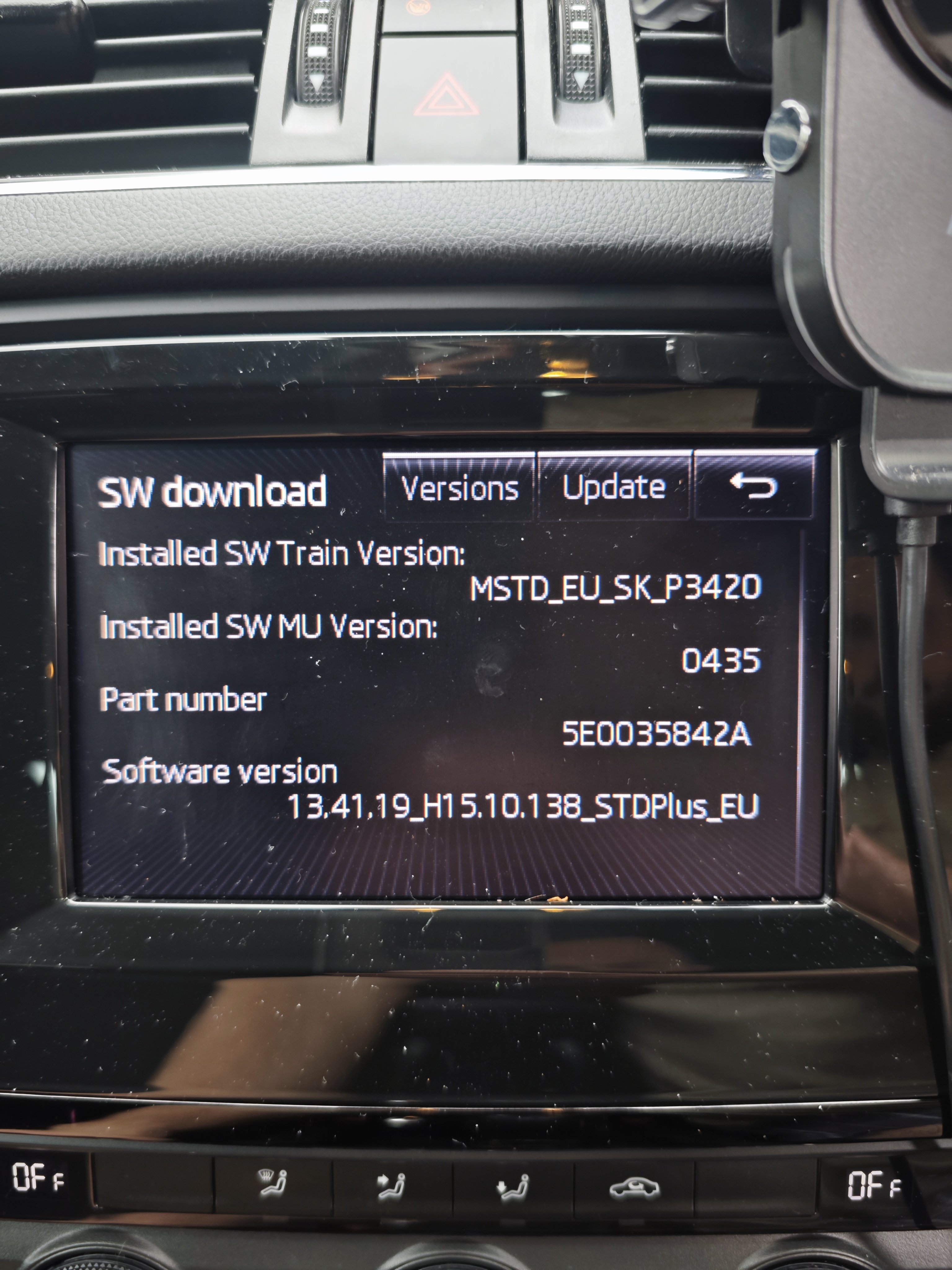

  4. Just curious if you've come across anything for our system. Mine's the same version: Part number 5E0035842A, Software 13.41.19_H15.10.138_STDPlus_EU. Any luck finding updates or info?

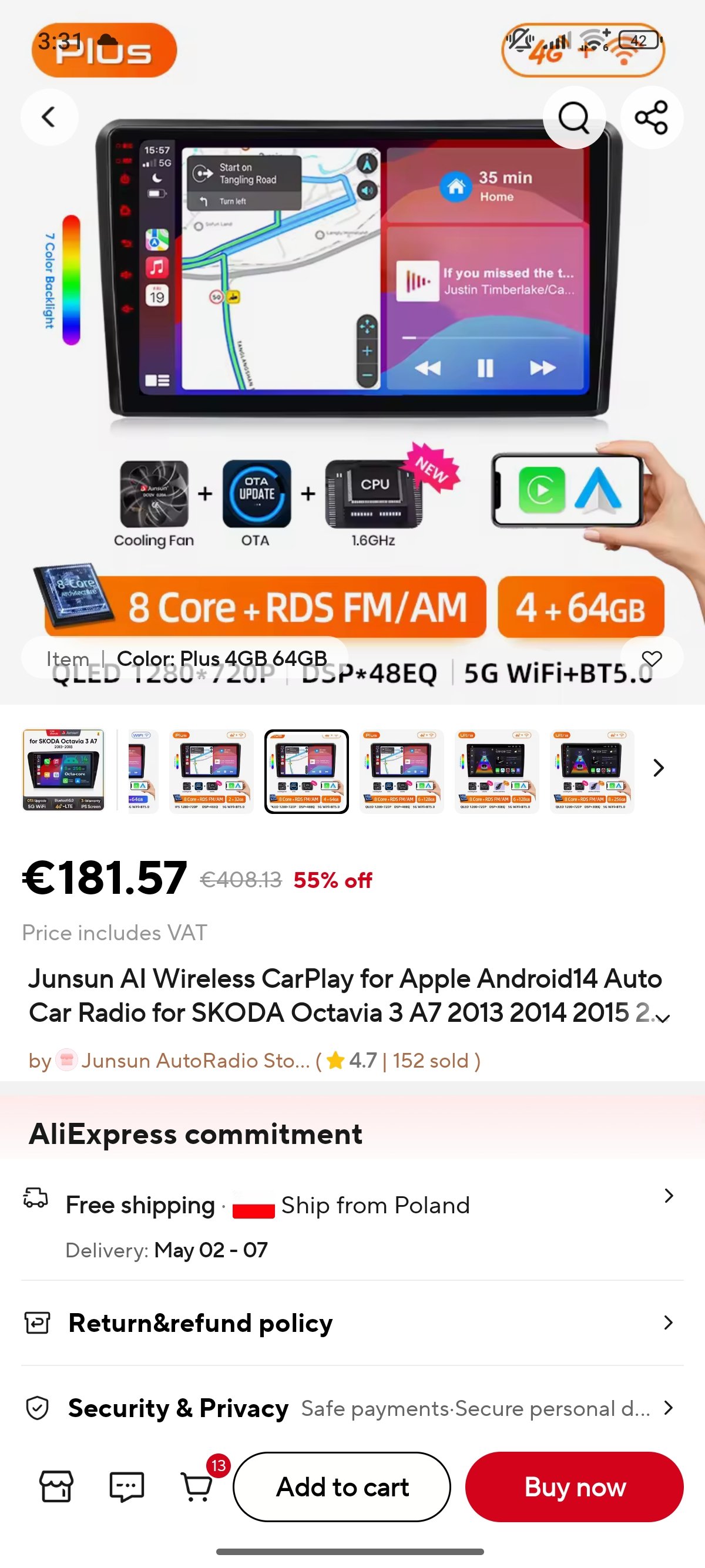

  5. Awesome that you found a better microphone! Was the new one installed in the same place as the original, next to the ceiling lights? I've noticed some Audi systems use 3.5mm aux FISCON mics, which I'd imagine are also good quality (and hopefully not cheap copies) https://kufatec.com/en/fiscon-microphone-for-audi-interior-light/36338-1 . I wondered if one of those could work with Double Take in the original location. It's a bummer, but it looks like I can't put an Android box in my MIB1, and 480p just won't cut it, as I've seen a comment that the person paying nearly £700 for the small, not even 6-inch screen, haha. Out of curiosity, did you go for the 4GB RAM version of the Android unit? I couldn't quite tell from what I saw.
  6. Man, I was so keen on getting one of those 4GB RAM / 64GB storage Android Auto screens after seeing it in my friend's Skoda. It seems decent, but he says the screen is crazy bright even at its dimmest at night. And you're totally right about the microphone being rubbish! It's annoying that you can't just connect it to the car's built-in one. I'm hoping there's a solution, like a decent external mic. Anyone know what kind of port the mic uses on these things? AUX, maybe?

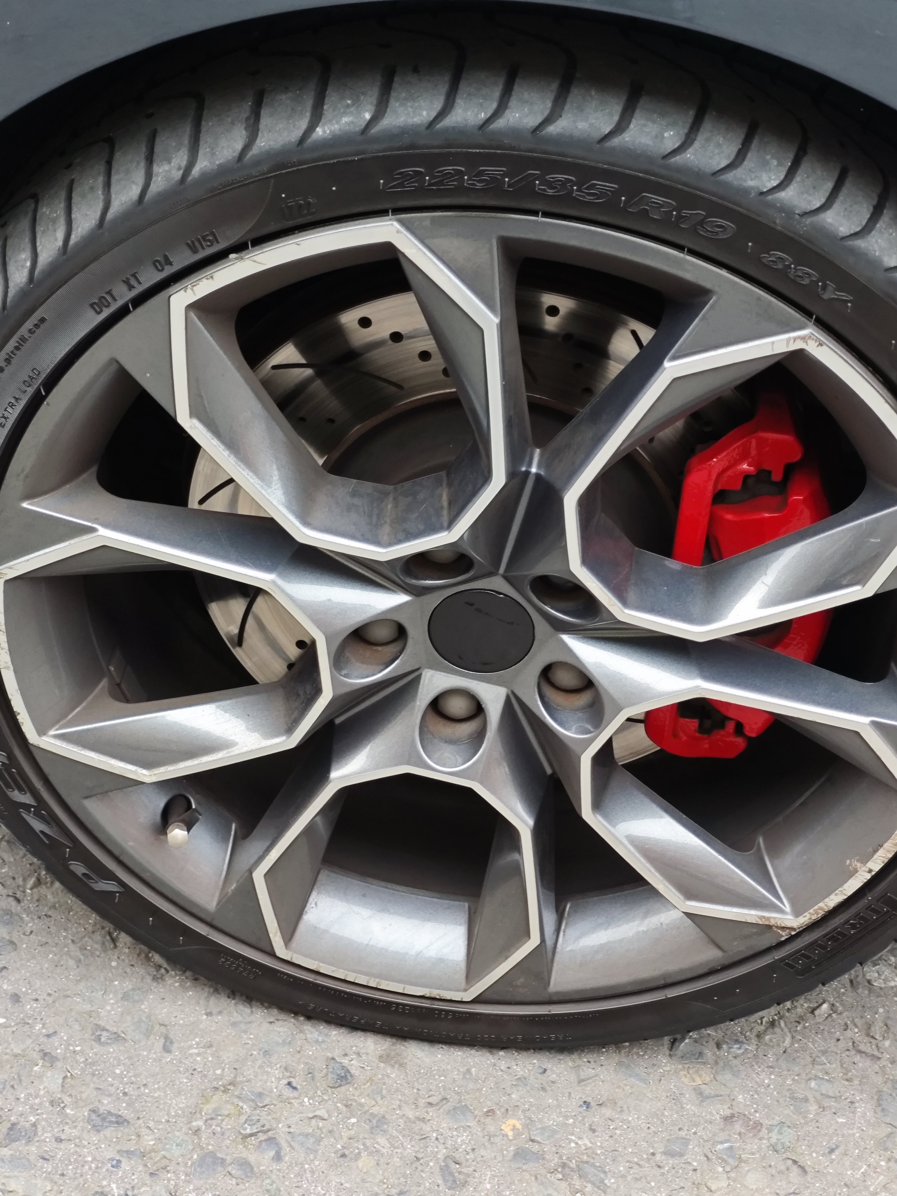

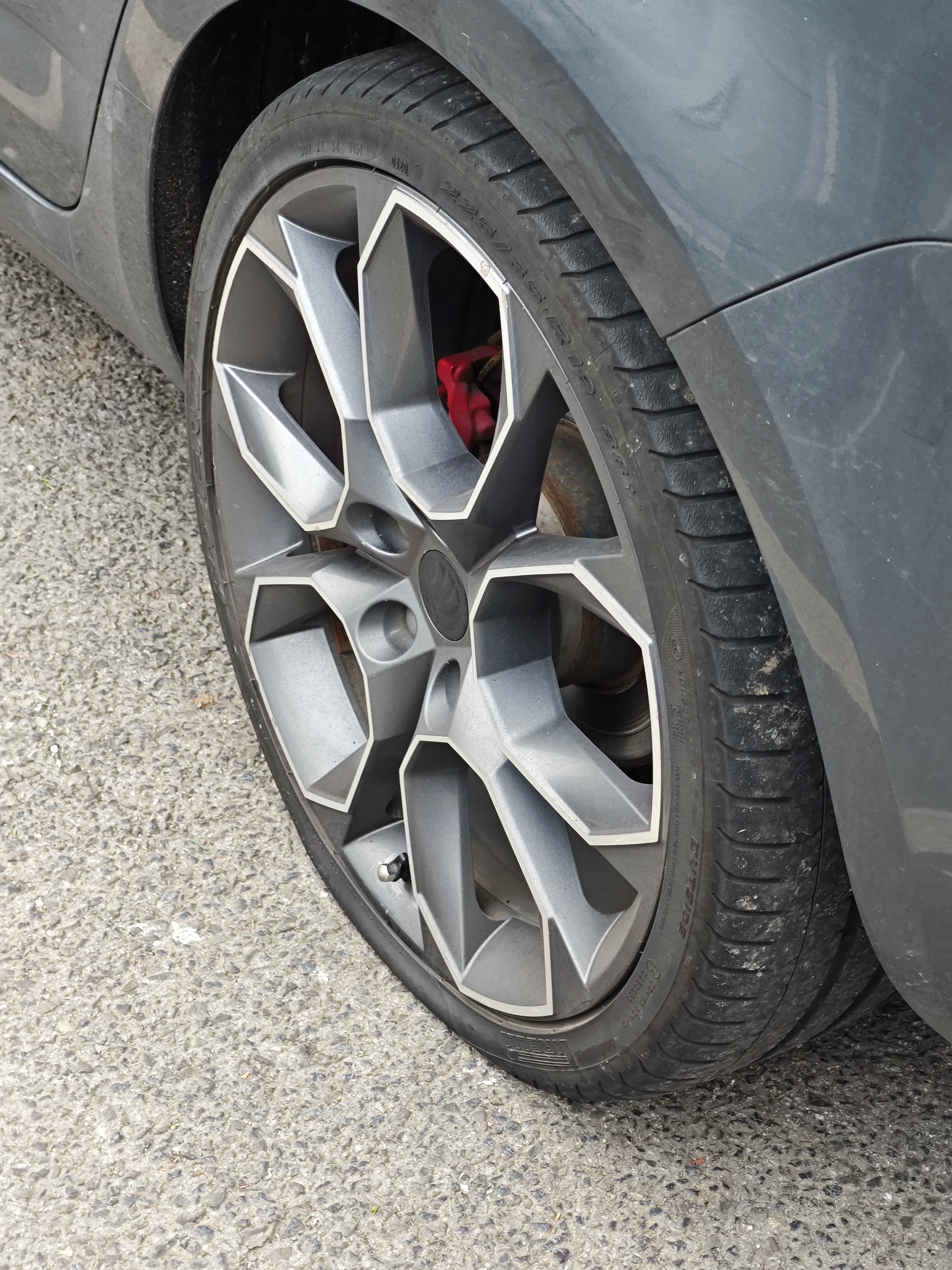

  7. Hi, so I will be soon I need of 4 new tyres My car is MK3 Octavia vrs 2.0 TDI on standard suspension but I do have 15mm spacers on front and 20mm rear. Bought this car about 2 months ago and urrently running Pirelli pzero but they are 5 years old and basically no grip under wet conditions. I live in Ireland which is filled with speed bumps and some potholes, currently running 225/35 R19 but wanting to get something to absorb better the potholes etc. I seen that most get the 235/35 R19 version. But I'm wondering if I can also go up with the higher sidewall like a 235/40 R19 tyre. Has anyone got them sizes on their car with spacers included? Or would it be better if I get 225/40 R19 Instead
  8. Another question here, if Im on 225/35/r19 I do want a higher side wall because of poor road conditions where I live, would it work if I put the 235/40/r19 Xtreme wheels. Also to mention I do have 15mm front and 20mm rear wheel spacers. Don't mind the puncture, it's fixed 🤣
