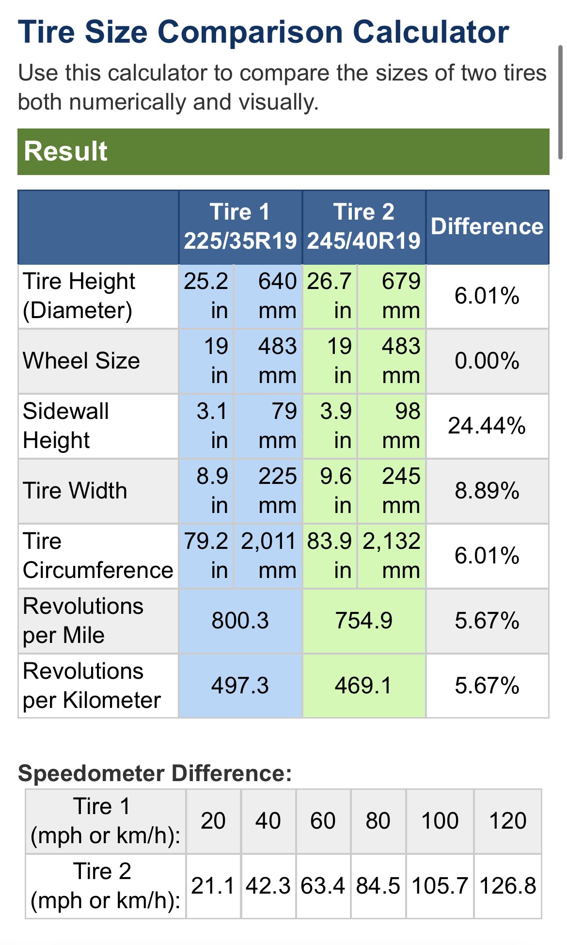

  12. The car has come with 225/35/R19 which I believe is the OEM size. I’ve added a comparison chart between the 2 sizes. I plan to get a dyno tune done and the gent doing it can recalibrate the car to accommodate a tyre size change for little to no extra cost.
