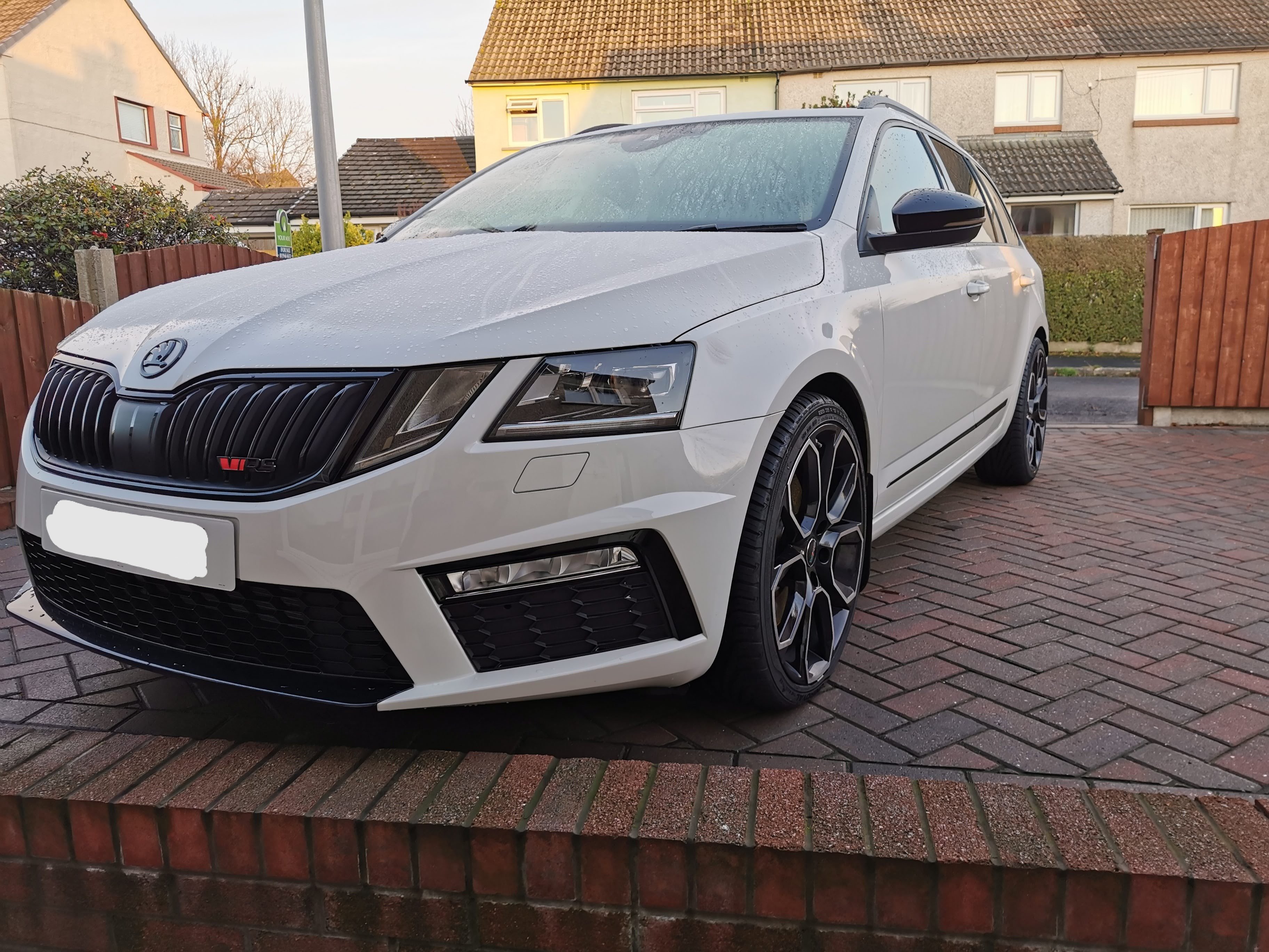

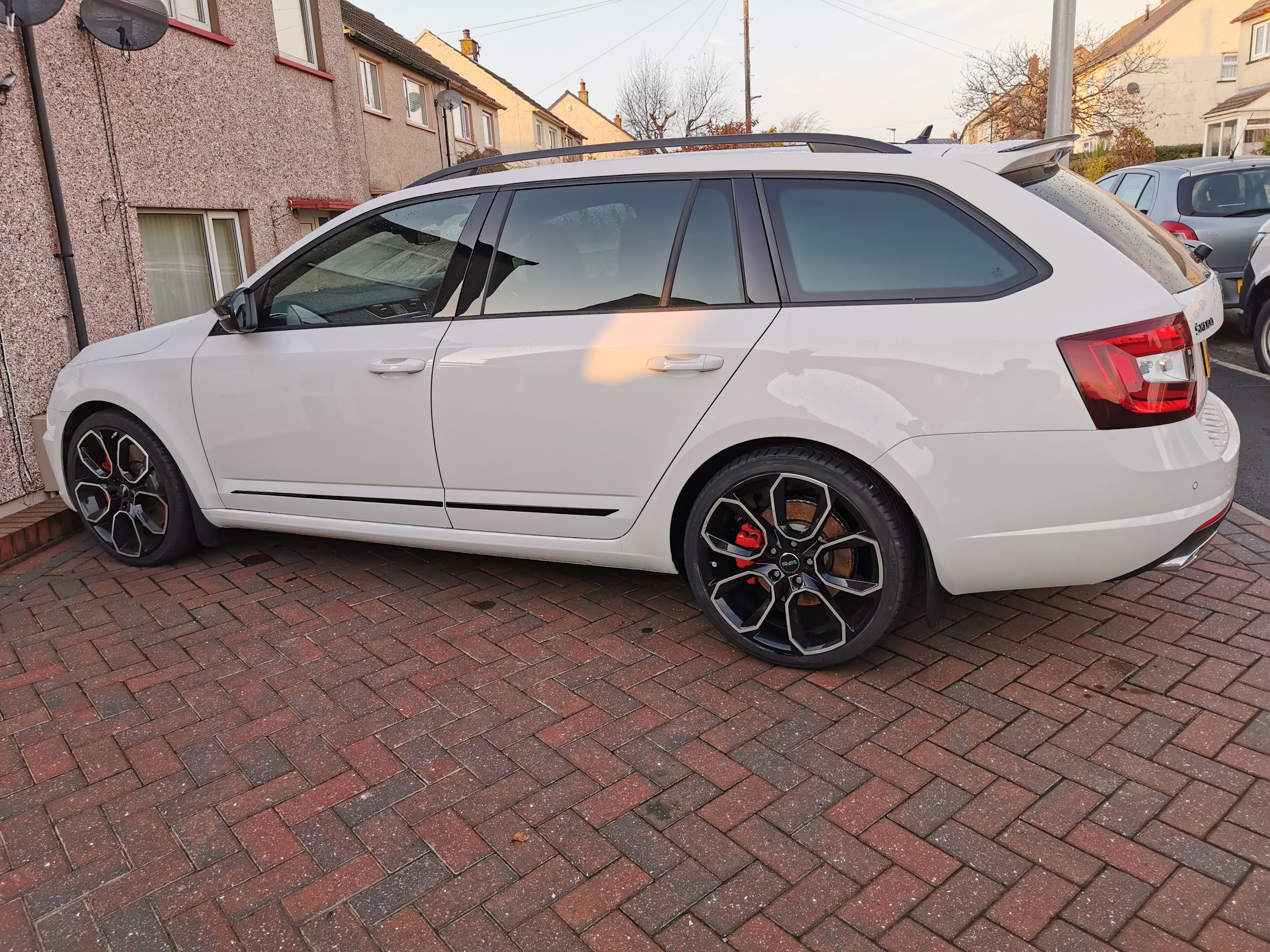

No problem at all. Plenty of space. Just upgraded from standard 18" VRS wheels on my 2019 245 to 19's with 225 35 19 and the ride is absolutely no different.
The tyres are Uniroyal Rainsport 3's which I absolutely love, but as the sidewall is probably a little softer than the standard tyres, maybe that's the case. The handling is perfect.

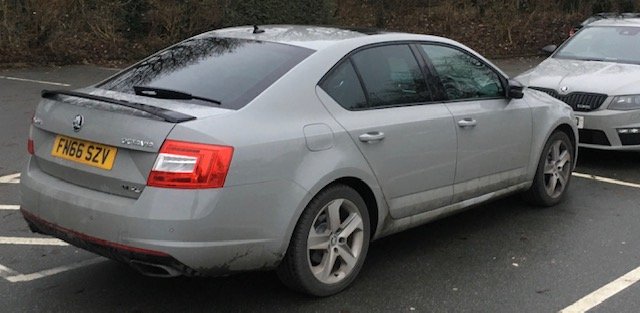

 A Cyprus Spec MKIII Vrs has 17" wheels as standard fit. 225/45/17 on Dorado Alloy wheels. I ran a set as winter wheels on my Ex 66 plate Vrs. They are a bit tight over the front callipers but they do fit.

What spacers/offset are you running? Looks mint!
