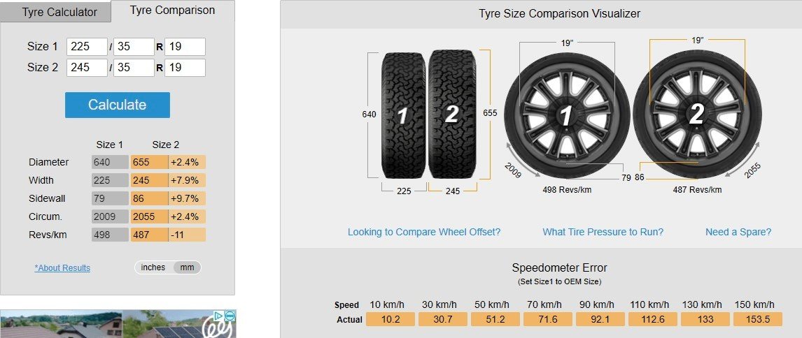

Comparing those tyres against 245/35/R19 -
