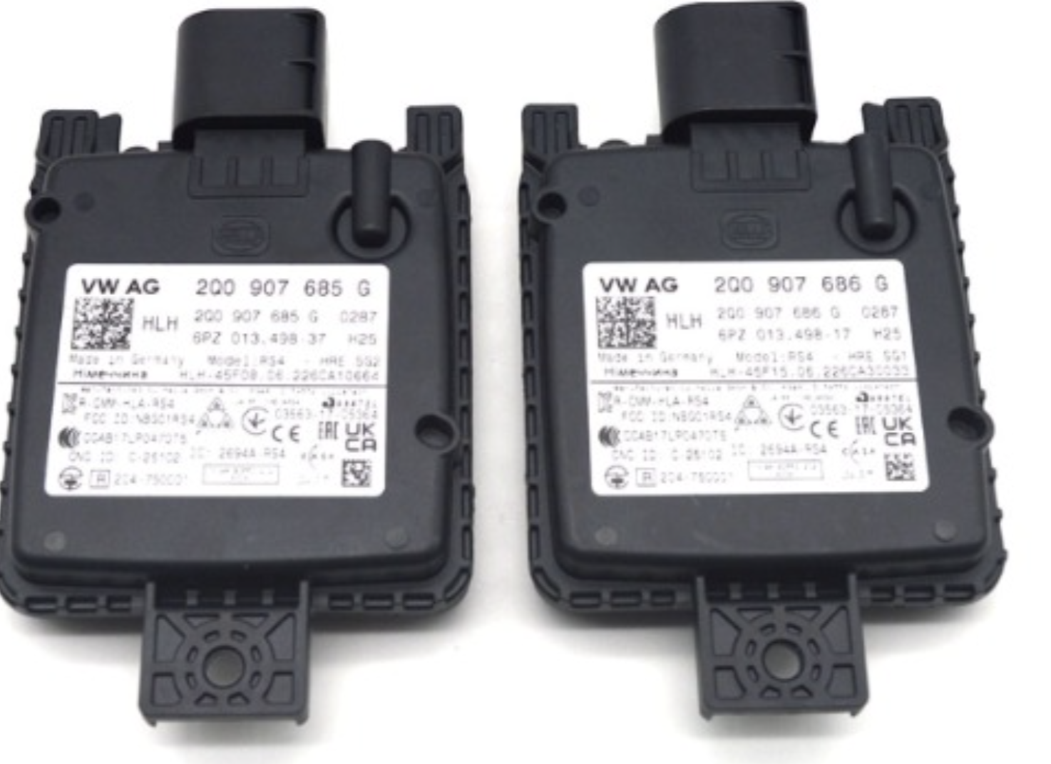

  21. Hello today i ordered set for blind spot assistent for Octavia mk4 with cableset only one think im missing is dataset? do you guys have good source of these files? I already have odis to flash these files and obdeleven to unlock SFD lock
