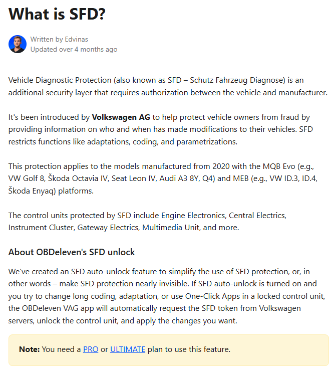

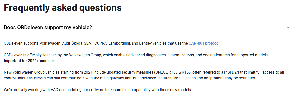

VAG OBDII
Some more info here: https://wiki.ross-tech.com/wiki/index.php/SFD So it looks like your 2023 car will have SFD but not SFD2.
- VAG OBDII
