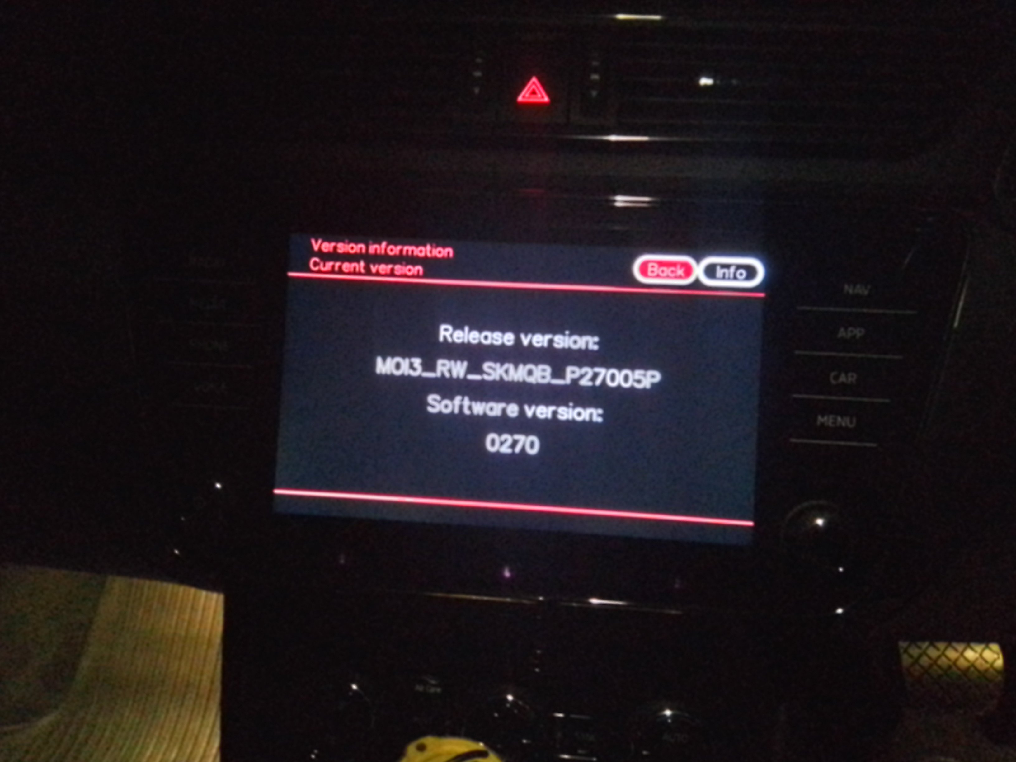

  3. Maybe. I started from this version exactly:
  4. The links on https://www.drive2.ru/l/695736324514133028/ appear to be working currently. Thats where I got the RW 308 and 330 from and have just updated my MIB. I'm in NZ.
  5. Please can I have a new link for the RW 308? The previous one says it's expired. Thank you
  6. I Have MOI3_RW_SKMQBP_27005P installed, and have downloaded 330 RW version. (Im in NZ) Since the only 308 version I can find is EU, are there any consequences in going to EU 308 and then to RW 330? I appreciate cross-region upgrades may not be wise but is it even possible? The radio unit was replaced prior to purchasing the vehicle and the navigation already says "This function is unavailable" anyway.
  7. Hi, I too am looking for RW 308. Can anyone assist? I am stuck at 270 and have the navigation issue "This function is unavailable"
