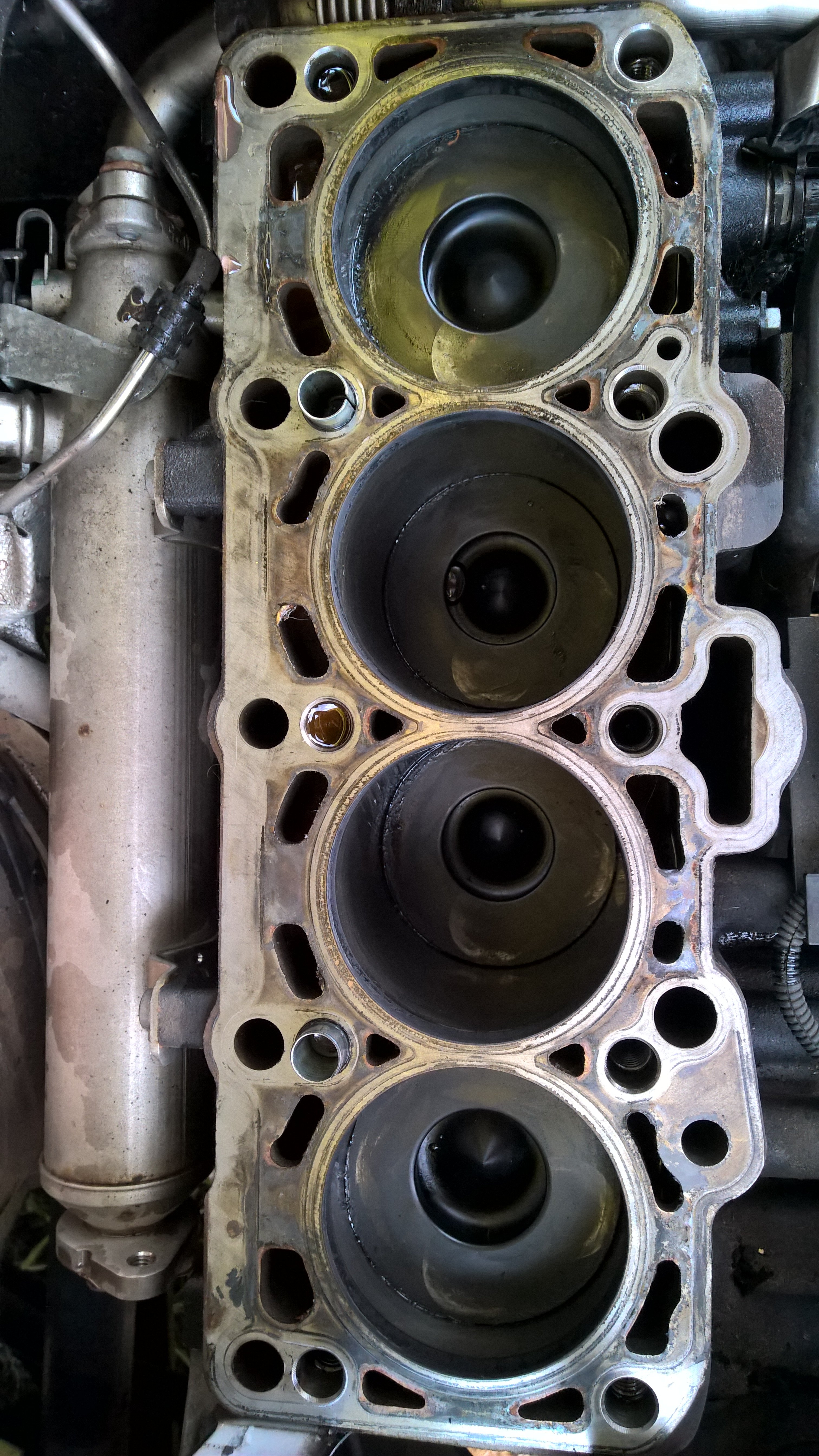

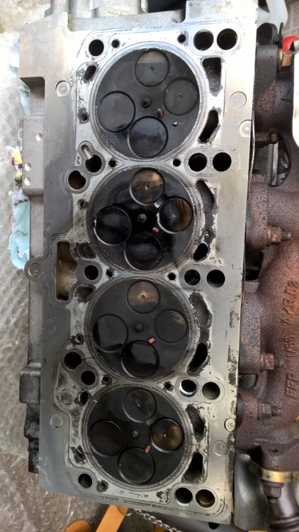

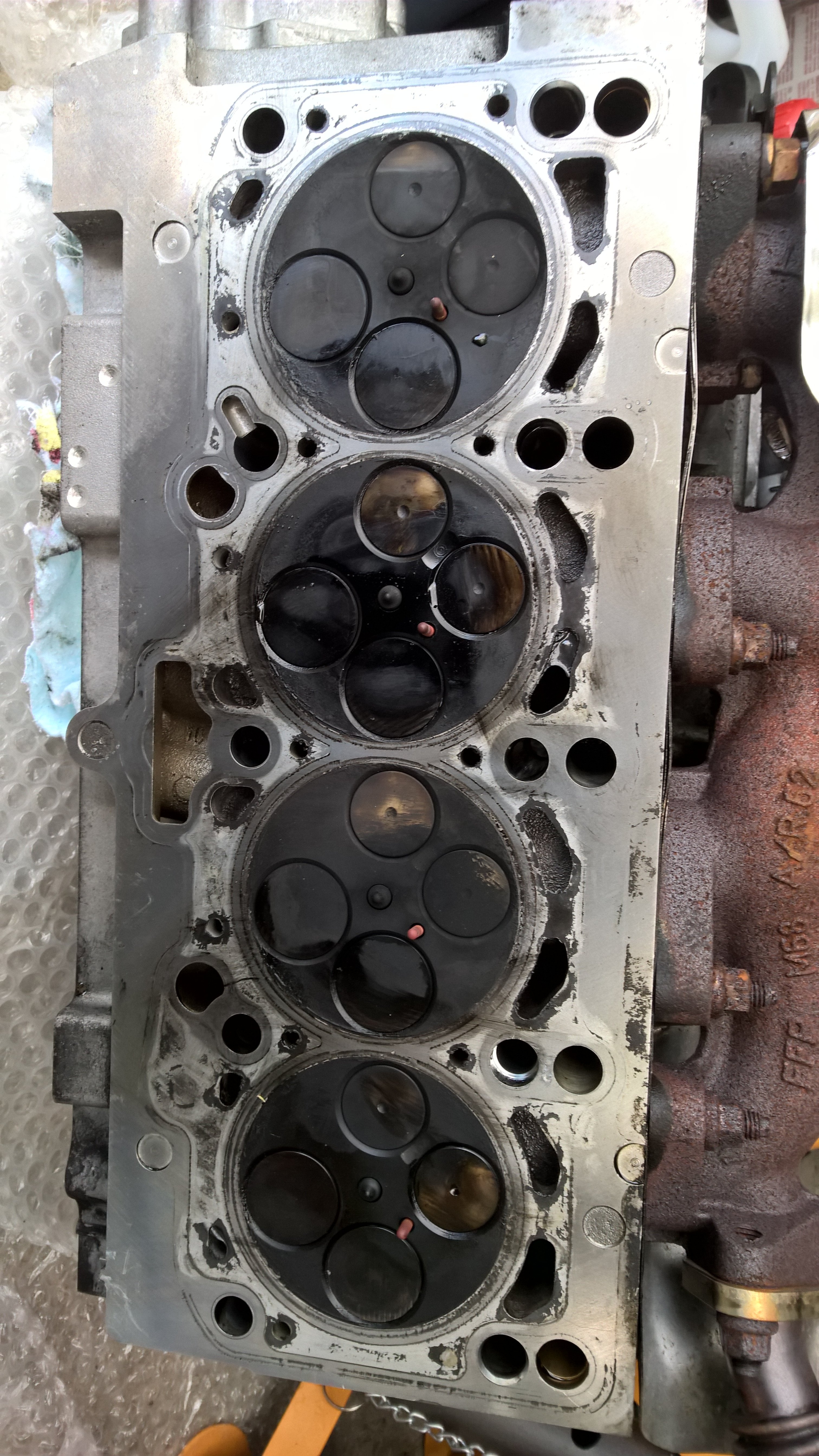

  1. DO NOT CHANGE THE TENSIONER STUD. I did and the thing stripped the thread, and the valves hit the pistons, lucky it did not do the engine, still had the head off to make sure, despite sticking my bore scope down to have a look, it's well documented on "Honest John" that this happens after the 3-4 cambelt change you have been warned. Hope this helps, Trev
