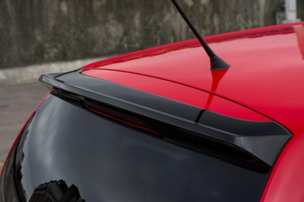

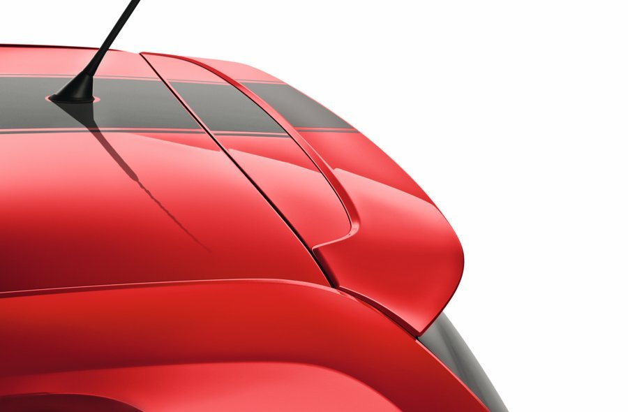

I realise you were only quoting 'Wings Skoda'. I guess it's their way of getting someone to buy both spoilers.
1ST 071 640 B is the Monte Carlo rear spoiler 1ST 071 640 A is a VW Up/Seat Mii rear spoiler What a load of nonsense! I have had a front spoiler fitted to my Elegance since 2017 with no issues whatsoever.
