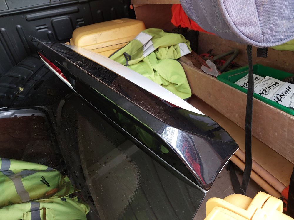

Monte Carlo tailgate spoiler
Bought a second hand Monte Carlo tailgate today, only want the spoiler from it. Anybody know the best way to remove without damaging it. Was thinking of using a heat gun on low setting and fishing line to cut through the adhesive.

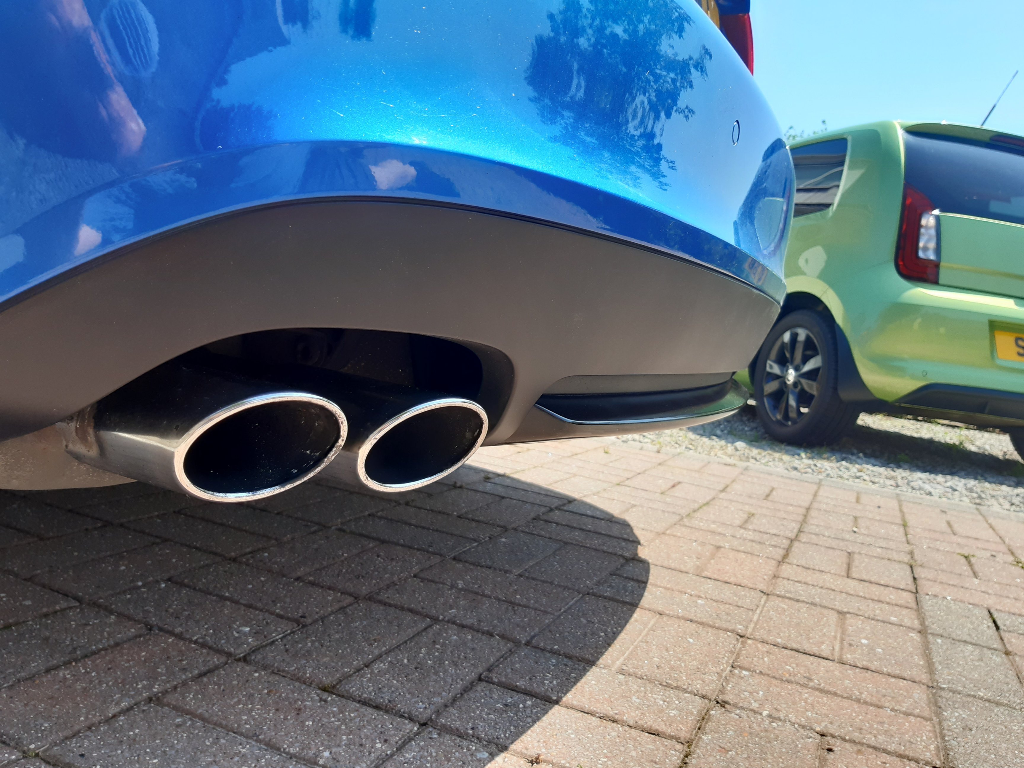

Sport rear bumper and diffuser
The rear diffuser is a separate part to the bumper, I had a diffuser fitted to my Elegance by local dealer. The one I have is matt black which I think is for a Sport, the Monte Carlo models have a gloss black diffuser. Not sure how easy they are to come by now

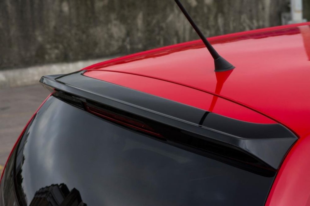

Monte Carlo Spoiler - Part Number?
I realise you were only quoting 'Wings Skoda'. I guess it's their way of getting someone to buy both spoilers.
1ST 071 640 B is the Monte Carlo rear spoiler 1ST 071 640 A is a VW Up/Seat Mii rear spoiler What a load of nonsense! I have had a front spoiler fitted to my Elegance since 2017 with no issues whatsoever.
