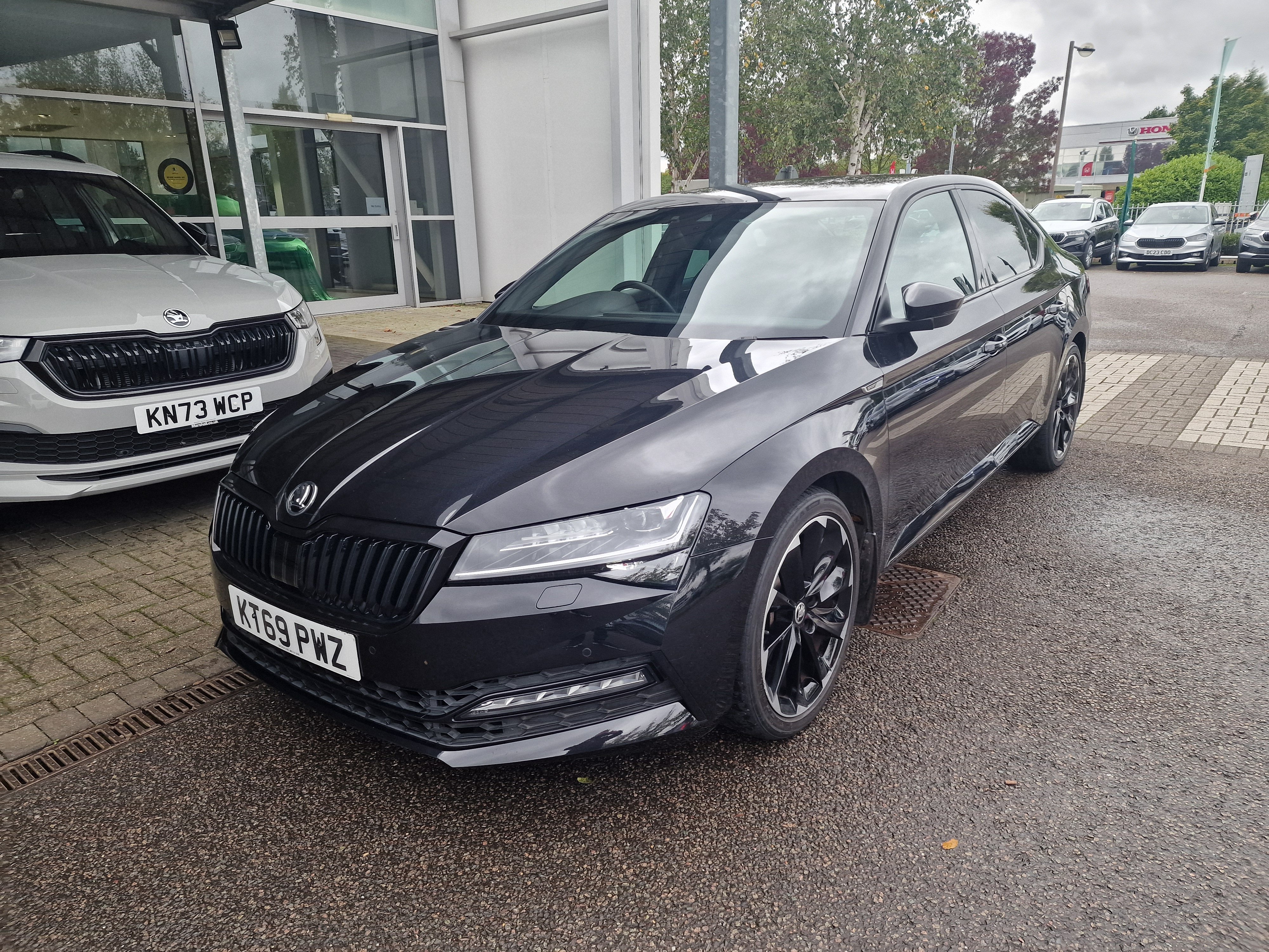

  22. Thanks for the reply. Car looks really good, I've always liked the white with black touches, I very nearly bought a MK3 vrs in the same colour, that's a car I regret letting get away. I think your right on the reliability side of things, I've read plenty of horror stories about kodiaqs but other than a dodgy passenger side wing mirror, mines been rock solid (saying that's probably tempting fate), but it still feels and drives life a new car after 35k miles. So I'm guessing the Superb should be similar, as they share a lot of the same parts like gearbox and 4x4 system. Anyhow, here's a pic of the potential purchase, it's pretty much the opposite of yours!!
