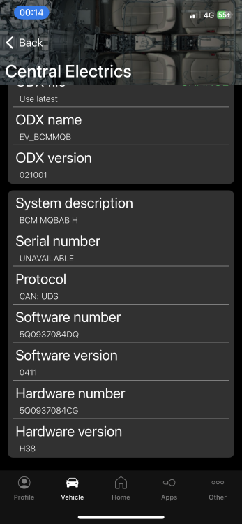

Hi guys, been trying to figure it out reading your posts - to get the animation on locking as well we just need an EC BCM or there is something else? I realised my BCM hardware no is CG but than the software no is DQ, so which one is the actual BCM number?

I’ll be honest with you , I have no idea what it is but I would be very curious to compare my coding with a original FL coding. The guys that did the upgrade on my car said that I should’ve had both unlock and lock animation and they will try to send me the coding. Still waiting. Anyway, this is my BCM

I gotta admit, that looks awesome, any way, acording to OBDeleven scan these are the part no for the BCM and Gateway. I'm a bit confused but I wouldn't mind upgrading both as it was sugested before by our friend in north London.
